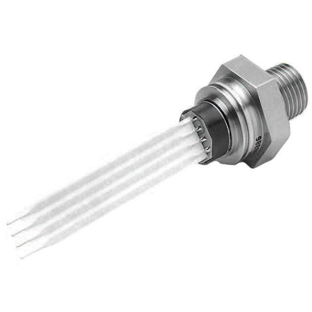

NPI-19 Series Medium Pressure Sensors Applications Features • Process control systems • Solid state, high reliability • Hydraulic systems and valves • 316L stainless steel, ISO sensor design • Biomedical instruments • ±0.5% static accuracy • Refrigeration and HVAC controls • Temperature compensated 32°F to 158°F (0°C to 70°C) • Appliances and consumer electronics • Ship and marine systems • High sensitivity, 100 mV FSO with 1.0 mA excitation • Aircraft and avionic systems • Linearity 0.1% FSO typical • Four standard ranges: 0 to 15 psig (0 to 1 bar), 0 to 250 psig (0 to 17 bar) available in gauge or absolute • Voltage driven ranges: 15, 30, 50, 100, 200 and 300 psi (1, 2, 3, 7, 14 and 20 bar) gauge and absolute • Standard configurations include: _ 1/2 in-20 UNF threaded male port with 1.0 in (25 mm) flange _ 0.74 in (18.8 mm) diameter x 0.28 in (7 mm) long cylinder with o-ring seals _ 1/4 in-18 NPT male port with 7/8 in (22 mm) flange _ 1/8 in-27 NPT male port with 7/8 in (22 mm) flange Amphenol Advanced Sensors • Custom configurations and other pressure ranges available. Please consult the factory. NPI-19 Series Specifications Current Driven Medium Pressure, Media Isolated Pressure Sensor The NovaSensor NPI Series incorporates state-ofthe-art IsoSensor technology, which gives the OEM user the best in price and performance. They are designed to operate in hostile environments and yet give the outstanding sensitivity, linearity, and hysteresis of a silicon sensor. The piezoresistive sensor chip is housed in a fluid filled cylindrical cavity and isolated from measured media by a stainless steel diaphragm and body. As with all NovaSensor silicon sensors, the NPI Series employs SenStable® processing technology, providing excellent output stability. A -Out The modular design allows for R1 a variety of pressure port modules, which are hermetically weldedD to the +In and sensor header module. Standard types A, B, H, 4 J are shown inside. R2 For compensation of temperature effects, a B complete resistor network is supplied on a hybrid +Out 5 ceramic design minimizes 3 substrate. The IsoSensor temperature errors to provide a maximum offset R5 error of 0.75% FSO over the 32°F to 158°F (0°C to C R3 2 1 70°C) compensated range. -In R4 A A -Out R1 -Out R1 D D +In +In 4 4 R6 R2 R2 B 5 3 B +Out R5 2 1 R3 +Out 5 3 R5 C -In 2 1 C R3 R7 R4 NPI-19 Series Constant Current schematic diagram R4 NPI-19 Series Constant Voltage schematic diagram -In NPI-19 Series Specifications Parameter Value Notes Pressure Range NPI 19 NPI-19VC Maximum Overpressure 0 to 100 kPa 0 to 200 kPa 0 to 700 kPa 0 to 1700 kPa 0 to 15 psi (0 to 1 bar) 0 to 30 psi (0 to 2.07 bar) 0 to 100 psi (0 to 6.89 bar) 0 to 250 psi (0 to 17.24 bar) 0 to 103.4 kPa 0 to 206.8 kPa 0 to 344.7 kPa 0 to 689.4 kPa 0 to 1379 kPa 0 to 2068 kPa 0 to 15 psi (0 to 1 bar) 0 to 30 psi (0 to 2.07 bar) 0 to 50 psi (0 to 3.44 bar) 0 to 100 psi (0 to 6.89 bar) 0 to 200 psi (0 to 14 bar) 0 to 300 psi (0 to 21 bar) 2x rated pressure 1.0 mA 10 VDC 108 Ω 4,000 Ω 4,000 Ω 5,000 Ω 5,000 Ω 1.5mA maximum 1.5 VDC maximum @50 VDC ± 20% ± 20% ± 20% Environmental Temperature Range Operating(6) Compensation Shock Life (Dynamic Pressure Cycle) -40°F to 257°F 32°F to 158°F 10 gRMs 100 g 1 x 106 Cycles (-40°C to 125°C) (0°C to 70°C) 20 to 2000 Hz 11 milliseconds Min. Typical Max. Notes Offset mV -2 1 2 mV FSO Output NPI-19 NPI-19VC mV mV 70 99 100 100 130 101 2 2 Linearity %FSO -0.25 0.1 0.25 3 Hysteresis and Repeatability %FSO -0.05 0.01 0.05 -0.75 -1.0 0.2 0.2 0.75 1.0 4 4 %FSO -0.75 02 0.75 4 %FSO -0.2 0.1 0.2 Thermal Accuracy of Offset NPI-19 NPI-19VC %FSO %FSO Thermal Hysteresis 5 Short-Term Stability of Offset µV/V Short-Term Stability of FSO µV/V 5 6 Long-Term Stability of Offset %FSO 0.1 7 Long-Term Stability of FSO %FSO 0.1 7 6 1. Performance with offset, thermal accuracy of offset, and thermal accuracy of FSO compensation resistors. Mechanical Weight 0.02 lb (10 g) 0.1 lb (45 g) Media Compatibility All corrosive media compatible with 316 L stainless steel Case and Diaphragm Material 316L stainless steel Recommended O-Ring Type A Type B Units Thermal Accuracy of FSO Electrical @ 77°F (25°C) unless otherwise stated Input Excitation NPI-19 NPI-19VC Insulation Resistance Input Impedance NPI-19 NPI-19VC Output Impedance Bridge Impedance Parameter Performance Parameters(5) Compensated(1) General(8) NPI-19A-XXX NPI-19B/H/J-XXX 0.66 in x 0.039 (16.76 mm x 1 mm) diameter 2-013 per ISO 3601/1 2. FSO with 1.0 mA input excitation, 10 VDC for NPI-19VC. 3. Linearity by best fit straight line. 4. 2°F to 158°F (0°C to 70°C) with reference to 77°F (25°C). 5. 32°F to 158°F (0 to 70°C), by design. 6. Normalized offset/bridge voltage—100 hours, typical value, not tested in production. 7. 1 year, typical value, not tested in production. 8. Consult factory for vacuum applications. Ordering Information NPI-19 Series Specifications NPI-19 NovaSensor Pressure Type (ISO Sensor) Code Pressure Port Type A No port, o-ring seal B 1/2-20 UNF H 1/4-18 NPT J 1/8-27 NPT Code Pressure Ranges 101 100 kPa, 1 mA 201 200 kPa, 1 mA 701 700 kPa, 1 mA 1700 kPa, 1mA 172 015 015 psi (1 bar), 10 V 030 30 psi (2.07 bar), 10 V 050 50 psi (3.44 bar), 10 V 100 100 psi (6.89 bar), 10 V 200 200 psi (14 bar), 10 V 300 300 psi (21 bar), 10 V Code Description A Absolute G Gauge Code Voltage H Constant Current Supply (1.0 mA) V Constant Voltage Supply (10 VDC) NPI-19 - ____ - ____ - ____ - ____ Typical model number NPI-19 Series dimensions Amphenol Advanced Sensors www.amphenol-sensors.com © 2015 Amphenol Corporation. All Rights Reserved. Specifications are subject to change without notice. Other company names and product names used in this document are the registered trademarks or trademarks of their respective owners. AAS-920-312C-10/2015

物料型号:NPI-19系列
器件简介:NPI-19系列传感器采用IsoSensor技术,适用于恶劣环境,提供硅传感器的高灵敏度、线性度和滞后性。传感器芯片被封装在充满液体的圆柱形腔体内,并通过不锈钢膜和体与被测介质隔离。
引脚分配:文档中提供了两种电路图,分别是恒定电流和恒定电压供电方式的引脚分配
参数特性: - 压力范围:0至100kPa至0至1700kPa,具体取决于型号。 - 最大过压:额定压力的2倍。 - 电气特性:输入激励为1.0mA或10VDC,输入阻抗约为4000欧姆,输出阻抗为5000欧姆。 - 环境特性:工作温度范围为-40°F至257°F,温度补偿范围为32°F至158°F。 - 机械特性:重量从10g至45g不等,兼容所有与316L不锈钢兼容的腐蚀性介质。
功能详解:NPI-19系列传感器具有高精度和高灵敏度,适用于多种应用,如过程控制系统、液压系统、生物医学仪器、家电、船舶和航空电子系统等。
应用信息:适用于需要精确压力测量的多种应用领域。
封装信息:标准配置包括1/2英寸20 UNF螺纹公头、0.74英寸直径x 0.28英寸长的圆柱形、1/4英寸18 NPT公头和1/8英寸27 NPT公头。还提供定制配置和其他压力范围。
