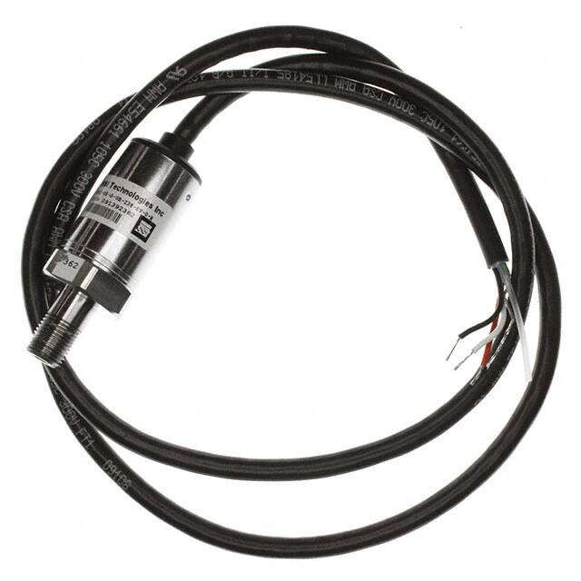

Data Sheet P51 Pressure Sensor Product Overview The MediaSensorTM (P51) family of bulk micromachined, absolute, sealed and gauge pressure sensors are for both harsh and benign media with superior accuracy over operating temperature. These compact, robust sensors are well suited for a variety of automotive, industrial and commercial applications. Typical Applications • Refrigeration • Hydraulics • HVAC • Pneumatics • Fuel Cells • Compressors • Process Controls • Spray Systems • Pumps • Flow • Agriculture • Robotics Technical Specifications Maximum Pressure Accuracy Maximum Operating Temp. 7,500 PSI < ± 1.00% FS 125 °C Output Type 0.5 - 4.5 V 1-5V 4 - 20 mA Accuracy 15-50 or 751-5,000 PSI (at 22 °C) < ± 1.00% FS < ± 1.00% FS < ± 1.00% FS Accuracy 51-750 PSI (at 22 °C) < ± 0.50% FS < ± 0.50% FS < ± 0.50% FS Temp Error 15-50 or 751-5,000 PSI (-40 °C to 105 °C) < ± 1.00% FS < ± 1.00% FS < ± 1.00% FS Temp Error 51-750 PSI (-40 °C to 105 °C) < ± 0.50% FS < ± 0.50% FS < ± 0.50% FS Zero Pressure Offset 0.50 V 1.0 V 4.0 mA Full Scale Output (at Pressure FS) 4.50 V 5.0 V 20.0 mA Operating Temperature -40 °C to 125 °C -40 °C to 125 °C -40 °C to 125 °C Storage Temperature -40 °C to 125 °C -40 °C to 125 °C -40 °C to 125 °C Operating Temp. (Harnessed Sensor) -40 °C to 105 °C -40 °C to 105 °C -40 °C to 105 °C Storage Temp. (Harnessed Sensor) -40 °C to 105 °C -40 °C to 105 °C -40 °C to 105 °C 2X FS 2X FS 3X FS Proof Pressure Burst Pressure - ABS/Sealed Gauge (lesser of two) 10X FS or 15,000 PSI 10X FS or 15,000 PSI Burst Pressure - Gauge 10X FS or 15,000 PSI 3X FS 3X FS 3X FS Reverse Voltage (± 16 V over 5 min.) Available Available Available Overvoltage (± 16 V over 5 min.) Available Not Available Not Available Copyright © 2019, SSI Technologies, LLC 1 Doc. P51-DS — Rev. 01 ssi-sensors.com Output Type 0.5 - 4.5 V 1-5V 4 - 20 mA 5 ± 0.5 Volts 8 to 30 Volts 8 to 30 Volts Current Draw < 6 mA < 3 mA Not Applicable Output Type 0.45 mA max (sink or source) 0.45 mA max (sink or source) 4 - 20 mA < 1 ms < 1 ms < 1 ms Supply Voltage Response Time (Pressure/Output) Parameter Pressure/Temperature Cycles Value Units > 1.8 x 10 Cycles Thermal Shock 250 Cycles Vibration 144 Hours EMC Compatibility 150 V/m Humidity 250 Hours Weight ≤ 85 Grams Chemical Compatibilities Any gas or liquid compatible with 304L and 316L stainless steel. (Including but not limited to motor oil, diesel, hydraulic fluid, brake fluid, water, wastewater, hydrogen, nitrogen, and air.) Designed to be used in media isolated mediums. Agency Approvals & Certifications Copyright © 2019, SSI Technologies, LLC 2 Doc. P51-DS — Rev. 01 ssi-sensors.com Dimensional Drawings Harness 1 2 Ports Vent Tube Gauge Only 3 7/8 HEX 7/8 HEX 0.20 [5.0] 1.2 [29.6] 16 mil PVC Harness Length 0.33 [8.5] 5/8 HEX 1.18 [30.0] 1.25 [31.8] B W A Z AI 24 mil PVC 5/8 HEX 0.89 [22.6] 1.08 [27.5] F V 5/8 HEX 1.05 [26.7] 0.54 [13.7] 5/8 HEX 0.98 [24.8] U I AA IS G Connectors DIN 43650 Form C DT06-3S 1 2 1 3 3 2 1 M12 DIN 43650 1.00 [25.5] 2 3 1 2 Deutsch 0.79 [20.0] NA Wide Pin 3 Metri-Pack 150 3 Pin Turck Eurofast RK 4.4T Packard 0.94 [24.0] 0.87 [22.0] 0.75 [19.0] Ø0.87 [22.2] TYP Pin Color 1-5 V 0.5-4.5 V 20 mA 1 Red Vin (8-30) Vin (5+/-0.1) Vin (8-30) 0.00 = Inches 2 Black GND GND NA [00.0] = Millimeters 3 White Vout Vout GND Tube Gauge Gauge Gauge Copyright © 2019, SSI Technologies, LLC 3 Measurement Units Doc. P51-DS — Rev. 01 ssi-sensors.com P51 MediaSensorTM Ordering System P51 - 50 - A - A - I6 - 4.5 V - Family Full Scale 000 - 000 Placeholder Pressure (15 - 7,500 PSI) Pressure Type A = Absolute (15 - 7,500 PSI) G = Gauge (25 - 300 PSI) S = Sealed Gauge (15 - 7,500 PSI) Port Configuration 304L 316L Hex Port A, AI B F, V G I U IS Z W 7/8" 7/8" 5/8" 5/8" 5/8" 5/8" 5/8" 1/4 NPT 1/8 NPT 1/4 NPT 1/8 NPT 7/16 - 20 7/16 - 20 (Female) 7/16 - 20 (Snubber) AA *Other port configurations may be available. Consult factory. MOQ's apply. Connector / Harness D = Deutsch P = Packard *Other harness lengths available - contact factory. MOQ's will apply. MD = DIN 43650 micro-mini connector with 90° mating connector M12 = 4 pin micro connector 24 Gauge Harness (Inner PVC: 16 mil) • I6 = 6" • I12 = 12" • I18 = 18" • I24 = 24" • I36 = 36' • I72 = 72" Harness Information • Stranded Copper: Tinned • Outer Jacket PVC: 24 mil • Vent Tube: 1.57 mil Diameter (Gauge Only) 18 Gauge Harness (Inner PVC: 9 mil) • X6 = 6" • X12 = 12" • X18 = 18" Output Options 4.5 V = 0.5 - 4.5 V (5 V input only) 4.5 OVP = 0.5 - 4.5 V (5 V input only) Includes over voltage protection 5 V = 1 - 5 V (8 to 30 V input only) 20 mA = 4 - 20 mA (8 to 30 V input only) MOV = Option for 5 V and 20 mA for voltage spike protection Copyright © 2019, SSI Technologies, LLC 4 Doc. P51-DS — Rev. 01 ssi-sensors.com Contact SSI Technologies, LLC 3200 Palmer Drive, Janesville, WI 53546 ssi-sensors.com 1 (608) 757-2000 Made In USA SSI Technologies, LLC is an Amphenol Advanced Sensors company. Warranty LIMITED WARRANTY: All SSI products are warranted against defective materials and workmanship for a period of one (1) year from the date of delivery to the original purchaser. Any product that is found to be defective within the one year period will be replaced at the discretion of SSI. THIS WARRANTY IS IN LIEU OF ALL OTHER WARRANTIES, EXPRESS OR IMPLIED, OF MERCHANTABILITY, FITNESS FOR PARTICULAR PURPOSE, PERFORMANCE, OR OTHERWISE. SSI is not an expert in the customer's technical field and therefore does not warrant the suitability of its products for the applications selected by the customer. SSI accepts no responsibility for misuse, misapplication or unauthorized modification of its products. LIMITATION OF LIABILITY: SSI's obligation under this limited warranty is strictly and exclusively limited to the repair or replacement free of charge of such articles as are found to be defective in material or workmanship on the condition that the purchaser gives prompt written notice to SSI of any claim to breach of warranty within the warranty period, and, if requested, returns the defective articles to SSI. SSI will not assume any expenses or liability for repairs made to its articles outside of its plant, without its prior written consent. SSI reserves the right to satisfy its warranty obligation in full, with respect to defective articles, by the payment to the purchaser of all sums paid by the purchaser to SSI for such articles. IN NO EVENT SHALL SSI BE LIABLE FOR CLAIMS (BASED UPON BREACH OF EXPRESS OR IMPLIED WARRANTY, NEGLIGENCE OR OTHERWISE) FOR ANY DAMAGES, WHETHER DIRECT, IMMEDIATE, INCIDENTAL, FORESEEABLE, CONSEQUENTIAL, OR SPECIAL. Terms & Conditions Please visit [https://www.ssi-sensors.com/contact/supplier-portal] for information regarding the SSI Technologies, LLC Terms & Conditions. Note: Specs are subject to change without notice. Copyright © 2019, SSI Technologies, LLC 5 Doc. P51-DS — Rev. 01 — 02/01/2019

物料型号:P51
器件简介:P51压力传感器是SSI Technologies, LLC生产的一款绝对压力传感器,采用微机械加工技术制造,适用于恶劣和温和的介质,具有出色的操作温度范围内的准确性。这些紧凑、坚固的传感器适用于各种汽车、工业和商业应用。
引脚分配:文档中提供了详细的引脚分配图,包括不同输出类型(0.5-4.5V、1-5V、4-20mA)的引脚定义,例如: - 红色引脚(1号):Vn(8-30)、V(5±0.5)、V(8-30) - 黑色引脚(2号):GND - 白色引脚(3号):Vout、Vout、GND
参数特性: - 最大压力:7,500 PSI - 精度:在15-50或751-5000 PSI范围内,精度为±1.00% FS;在51-750 PSI范围内,精度为±0.50% FS - 最大工作温度:125°C - 零点偏移:0.50V、1.0V、4.0 mA - 满量程输出:4.50V、5.0V、20.0 mA - 工作温度范围:-40°C至125°C - 存储温度范围:-40°C至125°C
功能详解:P51传感器能够承受压力/温度循环、热冲击、振动等测试,并具有EMC兼容性和湿度耐受性。它还兼容304L和316L不锈钢兼容的任何气体或液体。
应用信息:P51传感器适用于制冷、暖通空调、液压、气动、燃料电池、过程控制、泵、压缩机、喷雾系统、农业、流量和机器人技术等多种应用。
封装信息:文档提供了详细的尺寸图纸和连接器信息,包括Metri-Pack 150、Turck Eurofast、DT06-3S DIN 43650等连接器选项。
化学兼容性:与304L和316L不锈钢兼容的任何气体或液体,包括但不限于机油、柴油、液压油、制动液、水、废水、氢气、氮气和空气。
