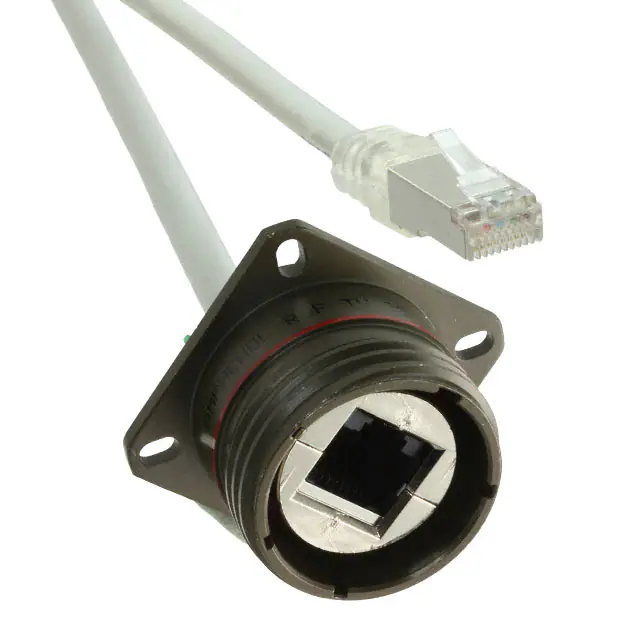

ROHS $0.1-*"/5 N & BZ RJF TV &UIFSOFU$PO &UIFSOFU$POOFDUJPO4ZTUFNGPS)BSTI&OWJSPONFOU RJFTV allows you to use an Ethernet Class D / Cat. 5e connection for 10 BaseT, 100 BaseTx or 1000 BaseT networks in harsh environments. With the patented RJStop system you can use a standard RJ45 cordset in a metallic plug which will protect it from shocks, dust and fluids. /PIB[BSEPVTPOGJFMEDBCMJOHBOEHSPVOEJOH Applications n Data Acquisition and Transmission in harsh environment n Railways n Radars n Shelters n Battlefield Communication n Systems n Navy Data Transmission 10 BaseT, 100 BaseTX and 1000 BaseT networks Cat 5e per TIA/EIA 568B and ClassD per ISO/IEC 11801 1BSU/VNCFS$PEF MAIN CHARACTERISTICS n Sealed against fluids and dusts (IP68) n Shock, Vibration and Traction resistant n No cabling operation in field and no tools required n Mechanical Coding / Polarization (4 positions) n Improved EMI protection n5SJ4UBSU5ISFBEDPVQMJOHNFDIBOJTN .*-%5-TFSJFT***UZQF XJUIBOUJEFDPVQMJOHEFWJDF n 3PCVTUNFUBMMJDTIFMMT n RJ45 cordset retention in the plug: 100 N in the axis n Mating cycles: 500 min n Compatible with cable diameter from 5,5 mm [0.216 in] to 13 mm [0.512 in] Environmental Protection n Sealing: IP68 n Salt Spray: 48 h with Aluminium shell - Nickel plating > 500 h with Aluminium shell - Olive Dran Cadmium plating 1000h with Marine bronze shell n Fire Retardant / Low Smoke: UL94 V0 and NF F 16 101 & 16 102 n Vibrations: 10 – 500 Hz, 10 g, 3 axes: no discontinuity > 10 nano s. n Compounded versions tested per NAS 1599 (5-3000 Hz, 20g, 12h) n Shocks: IK06: weight of 250 g drop from 40 cm [15.75 in] onto connectors (mated pair) n Humidity: 21 days, 43°C, 98% humidity n Thermal Shock: 5 cycles at - 40°C / +100°C n Temperature Range: - 40°C / +85°C RJF TV 4FSJFT 3+'JFME57 4IFMM5ZQF 6: 6M: 2: 2PE: 2PEM: 7: 7PE: 7PEM: 2SA, 7SA: 3+'57 2 2 ( #59 Plug with Plastic gland Plug with Metal gland Square Flange Receptacle Square Flange Receptacle, IP68 backshell, Plastic gland Square Flange Receptacle, IP68 backshell, Metal gland Jam Nut Receptacle Jam Nut Receptacle, IP68 backshell, Plastic gland Jam Nut Receptacle, IP68 backshell, Metal gland Transversally sealed receptacle (unmated) see page 22 Amphenol #BDL5FSNJOBUJPOT(Receptacles only) 1: Female RJ45 1RA: Right Angle Female RJ45 2: RJ45 Cordset 4IFMMTNBUFSJBM'JOJTI / Aluminium shell - nickel plating (receptacle inserts are metallized) - ROHS compliant ( Aluminium shell - olive drab cadmium plating (receptacle inserts are metallized) BZ: Marine bronze shell (receptacle inserts are metallized) - ROHS compliant $PSETFU-FOHUI(type 2 back termination only) #59 0.3m [11.81 inches] #59 0.5m 19.68 inches] #59 1m [39.37 inches] #59 1.5m [59.05 inches] 00: 8 tinned holes at the rear of the PCB to solder the cable 3FNBSL$BCMJOHDPOGJHVSBUJPO 100 BTX = 568B (Ethernet specification) Examples: 14 - Olive Drab Cadmium plug with plastic gland: RJF TV 6G - Olive Drab Cadmium Jam Nut Receptacle, female RJ45 back termination: RJF TV 71G - Nickel Jam Nut Receptacle, 1,5 m 100 BTX cordset back termination: RJF TV 72N 15 100BTX - Olive Drab Cadmium in line Square Flange Recept., 0,3 m 100 BTX cordset back termination: RJF TV 2PE 2 G 03 100BTX - Nickel Jam Nut Receptacle Solder termination 8 tinned holes: RJF TV 22 N 00 informations & contacts:XXXSKGJFMEDPNtDPOUBDU!SKGJFMEDPN 1MVH n Shell type 6 with Plastic or Metal Gland RJF TV 6 X 3FDFQUBDMFT n4RVBSFGMBOHFSFDFQUBDMFtNPVOUJOHIPMFT4IFMMUZQF RJFTV 21 X (Straight Female RJ45) RJFTV 21 RA X (Right Angle Female RJ45) Panel Drilling n +BNOVUSFDFQUBDMFt)FYBHPOBM/VUNPVOUJOH4IFMMUZQF RJFTV 71 RA X (Right Angle Female RJ45) Panel Drilling n 3FDFQUBDMFTXJUI*1CBDLTIFMMt4IFMMUZQF1&BOE1&XJUI1MBTUJDPS.FUBM(MBOE 92 [3.622] [3.622] 92 RJF TV RJFTV 71 X (Straight Female RJ45) Amphenol RJF TV 2PE/2PEM/7PE/7PEM #BDL5FSNJOBUJPOT Type 1: Female RJ45 /PUFT  Type 1RA: Right Angle Female RJ45 Type 2: RJ45 Cordset Type 2 - 00: Solder - 8 tinned holes Type 2 without RJ45 plug at the end of the cable is also available: consult factory informations & contacts:XXXSKGJFMEDPNtDPOUBDU!SKGJFMEDPN 15 "TTFNCMZJOTUSVDUJPOT *OTFSU$PEJOHT CONNECTION SIDE VIEW ."*/,&: "DDFTTPSJFT n .FUBMMJD$BQT RJF TV 3+'57$ Amphenol ( $POOFDUPS5ZQF 6: Plug 2: Square Flange Receptacle 7: Jam Nut Receptacle 4IFMM.BUFSJBMGJOJTI / Aluminium shell - nickel plating - ROHS compliant ( Aluminium shell - olive drab cadmium plating BZ: Marine bronze shell - ROHS compliant 16 2 n 1BOFM(BTLFUGPSTRVBSFGMBOHF SFDFQUBDMF 5IJDLOFTT NN +& Plug Cap Receptacle Cap n *OTFSUSFNPWBMUPPM3+'0%& informations & contacts:XXXSKGJFMEDPNtDPOUBDU!SKGJFMEDPN

- 物料型号:RJF TV 6G, RJF TV 71G, RJF TV 72N 15 100BTX, RJF TV 2PE 2 G 03 100BTX, RJF TV 22 N 00等。 - 器件简介:RJF TV Ethernet连接系统适用于恶劣环境,如铁路、雷达、战场通信、海军等,支持10 BaseT, 100 BaseTX和1000 BaseT网络。 - 引脚分配:文档中没有提供详细的引脚分配图,但提到了RJ45 cordset的使用。 - 参数特性:包括密封性(IP68)、抗冲击、抗振动、牵引力、无需现场布线和工具、机械编码/极化、增强的电磁干扰保护等。 - 功能详解:RJF TV系统使用专利的RJStop系统,允许在金属插头中使用标准的RJ45 cordset,提供保护以防止冲击、灰尘和液体。 - 应用信息:适用于恶劣环境下的数据采集和传输,如铁路、雷达、战场通信、海军等。 - 封装信息:提供了不同类型的外壳材料和表面处理,如铝壳镍镀层、橄榄色镉镀层、海洋青铜壳等,以及后端终止类型和电缆长度选项。
