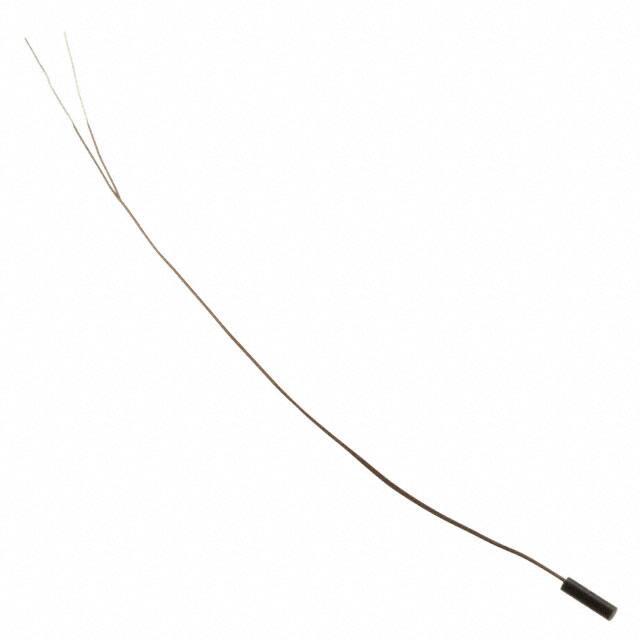

    THERM NTC 100KOHM 4252K BEAD
SC50G104WH 数据手册
NTC Interchangeable Thermistor Series Type SC Features • Precision, solid state temperature sensor • Ideal for medical applications • Epoxy filled sleeve for controlled diameter • Fully insulated • Interchangeability down to ±0.18°F (±0.10°C) • Polyimide sleeved for good mechanical strength and resistance to solvents • Suitable for use over the range of: -40°F to 221°F (–40°C to 105°C) • High sensitivity greater than: –4%/°C at 77°F (25°C) • Most popular Resistance (R) vs Temperature (T) curves are available • Suitable for temperature measurement, control and compensation Amphenol Advanced Sensors • 0.008 in (0.2 mm) diameter heavy isomid insulated bifilar copper lead wires for SC50 • 0.004 in (0.1 mm) diameter heavy isomid insulated bifilar nickel lead wires for SC30 Type SC30 Specifications Ø 0.032 in (0.81 mm) maximum Polyimide sleeve Epoxy fillet NTC Interchangeable Type SC30 38GA, nickel, alloy Bifilar leads Length from 0.09 to 0.26 in (2 to 7 mm) depending on resistance of thermistor Polyimide sleeved, interchangeable chip thermistors with heavy isomid insulated nickel lead-wires. 1.5 in (38 mm) minimum Options NTC Interchangeable Type SC30 dimensions Consult Factory for Availability of Options • Other resistance values in the range of 1000 Ω to 100 kΩ • Other tolerances or ranges • Alternative lead wires or lengths • Non standard R vs T curves • Controlled dimensions Thermal and Electrical Properties Dissipation Constant Still air: Stirred oil: 0.4 mW/°C 3 mW/°C Thermal Time Constant Still air: Stirred oil: 5 seconds 0.3 seconds Maximum Power at 77°F (25°C) ~30 mW De-rated from 100% at 77°F (25°C) to 0% at 212°F (100°C) Ordering Information Select appropriate part number below for resistance and temperature tolerance desired. R25°C Material System ±0.18°F (±0.1°C) 32°F to 158°F (0°C to 70°C) ±0.36°F (±0.2°C) 32°F to 158°F (0°C to 70°C) 2252 F SC30F232V SC30F232W 3000 F SC30F302V SC30F302W 5000 F SC30F502V SC30F502W 10000 F SC30F103V SC30F103W 10000 Y SC30Y103V SC30Y103W 30000 H SC30H303V SC30H303W 50000 G SC30G503V SC30G503W 100000 Y SC30Y104V SC30Y104W 100000 G SC30G104V SC30G104W Notes: 1. For RoHS compliant product, please add the suffix “N” to the part label. Example: SC30F103VN 2. For RoHS compliant product with applications below 0°C, please add the suffix “H” to the part label. Example: SC30F103VH Type SC50 Specifications Ø 0.050 in (1.5 mm) maximum Polyimide sleeve 32GA, copper Bifilar leads Epoxy fillet NTC Interchangeable Type SC50 Length from 0.04 to 0.12 in (1 to 3 mm) depending on resistance of thermistor Polyimide sleeved, interchangeable chip thermistors with heavy isomid insulated copper lead wires. 1.5 in (38 mm) minimum Options NTC Interchangeable Type SC50 dimensions Consult Factory for Availability of Options. • Other resistance values in the range of 1000 Ω to 100 kΩ • Other tolerances or ranges • Alternative lead wires or lengths • Non standard R vs T curves • Controlled dimensions Thermal and Electrical Properties Dissipation Constant Still air: Stirred oil: 0.5 mW/°C 0.4 mW/°C Thermal Time Constant Still air: Stirred oil: 8 seconds 0.5 seconds Maximum Power at 77°F (25°C) ~50 mW De-rated from 100% at 77°F (25°C) to 0% at 212°F (100°C) Ordering Information Select appropriate part number below for resistance and temperature tolerance desired. R25°C Material System ±0.18°F (±0.1°C) 32°F to 158°F (0°C to 70°C) ±0.36°F (±0.2°C) 32°F to 158°F (0°C to 70°C) 2252 F SC50F232V SC50F232W 3000 F SC50F302V SC50F302W 5000 F SC50F502V SC50F502W 10000 F SC50F103V SC50F103W 10000 Y SC50Y103V SC50Y103W 30000 H SC50H303V SC50H303W 50000 G SC50G503V SC50G503W 100000 Y SC50Y104V SC50Y104W 100000 G SC50G104V SC50G104W Notes: 1. For RoHS compliant product, please add the suffix “N” to the part label. Example: SC50F103VN 2. For RoHS compliant product with applications below 0°C, please add the suffix “H” to the part label. Example: SC50F103VH Amphenol Advanced Sensors www.amphenol-sensors.com © 2018Amphenol Corporation. All Rights Reserved. Specifications are subject to change without notice. Other company names and product names used in this document are the registered trademarks or trademarks of their respective owners. AAS-920-307E - 02/2018
