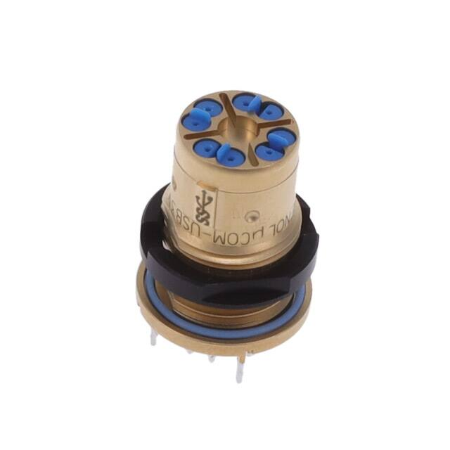

µCom & TVµCom USB3.0 Harsh Environment Connectors Description These specific adaptions of µCom and TVµCom are optimized for USB3.0 and intended for connection and disconnection in harsh environment military and aerospace application. Main Features Data Transmission : • USB speciation 3.0. • Data rate up to 5Gb/s for high speed USB. • 4 pairs totally insulated throughout the connector : minimum cross-talk between pairs. • Patented special interfacial shapes : minimum perturbation at the interface of each pair. µCom : • Environmental testing based on MIL-DTL-38999 series III military specifications (Thread version). • Environmental testing based on MIL-DTL-26482 military specifications (Push Pull version). • Miniature : 15 mm(.59˝) max external diameter. • Receptacle and in-line receptacle compatible with both thread and Push Pull plugs. • Machined Brass shells • Salt spray : • 500 h with Unplated brass shell • 500 h with Olive Drab Cadmium plating • 500 h with Black Nickel plating TVµCom : • Based on MIL-DTL-38999 series III – Shell size 11 • Aluminium shells • Salt spray : • 48 h with Nickel plating • 500 h with Olive Drab Cadmium plating • 500 h with Black Zinc Nickel plating • 500 h with Marine Bronze shell • 500 h with Passivated Stainless steel shell • • • • • Solder contact: max AWG24 Crimp contact: AWG 24 to 28 Temperature range : - 55°C / + 125°C IP68 sealing mated and unmated for PCB receptacles 1500 Vrms Dielectric Withstanding Voltage : RoHS compliant Markets & Applications C4ISR, Battlefield, Ground Vehicles Navy www.amphenol-socapex.com Due to technical progress, all information provided is subject to change without prior notice Designed by Amphenol Socapex Commercial Aerospace Railway µCom-USB3 Overall dimension Plug with banding platform Part number type: UCOM-USB3 P T X X B Thread version Part number type: UCOM-USB3 P P X X B Push-pull version Plug with cable gland backshell Part number type: UCOM-USB3 P T X X GA Thread version Part number type: UCOM-USB3 P P X X GA Push-pull version In-line receptacle Part number type: UCOM-USB3 L X X B Banding platform www.amphenol-socapex.com Due to technical progress, all information provided is subject to change without prior notice Designed by Amphenol Socapex Part number type: UCOM-USB3 L X X GA Cable gland backshell µCom-USB3 Overall dimension Panel mount receptacle with banding platform Part number type: UCOM-USB3 R X X Panel drilling PCB receptacle for printed circuit board Part number type: UCOM-USB3 R P X Panel drilling www.amphenol-socapex.com Due to technical progress, all information provided is subject to change without prior notice Designed by Amphenol Socapex µCom-USB3 Accesories CAPS for receptacles IP68 metallic cap IP68 neoprene cap - Part number: 31091 Nota: plan a type M3 hole on the panel x to be replaced by B for Black electrophoresis plating G for Olive drab cadmium plating U for Unplated brass 31057 x 31139 x Ø4,1 [0,161] IP68 metallic cap with metallic tie on panel Nota: plan a hole on the panel CAPS for plugs Cap in neoprene Part number: 31092 Ø12 [0,48] Or IP68 metallic cap with a 012 fixation ring CAPS for in line receptacles Dummy female receptacle Part number: 31131 Cap in neoprene x Part number: 31093 x to be replaced by B for Black nickel plating G for Olive drab cadmium plating U for Unplated brass Spares Crimp Pin (10 pcs) Part number: 31537 Crimp Socket (10 pcs) Part number: 31074 Tools • Nut clamping tool for receptacle • Insertion tool for crimp contacts Part number: 31055 Part number: 31056 Only for RPx receptacles Other tools: • Brazing tool for receptacle & in-line receptacle Part number: 31132 • Brazing tool for plug Part number: 31133 Nota: the cabling instructions are available upon demand (ref. N00-040190-00). www.amphenol-socapex.com Due to technical progress, all information provided is subject to change without prior notice Designed by Amphenol Socapex • Contact positioner for M22520/2-01 crimping tool Part number: 31095 TVµCom-USB3 Overall dimension Plug with banding platform Part number type: TV06 UCOM-USB3 X X -11 X X Jam nut receptacle with banding platform Part number type: TV07 UCOM-USB3 X X -11 X X Panel drilling Square flange receptacle with banding platform Part number type: TVP00 UCOM-USB3 X X -11 X X Panel drilling www.amphenol-socapex.com Due to technical progress, all information provided is subject to change without prior notice Designed by Amphenol Socapex TVµCom-USB3 Overall dimension Reduced flange - Jam nut receptacle with banding platform Part number type: TV07 UCOM-USB3 X X -11 X X F312 Panel drilling Stand off Reduced flange - Jam nut receptacle for PCB Part number type: TV07 UCOM-USB3 CI X -11 S X F059 Panel drilling PCB drilling www.amphenol-socapex.com Due to technical progress, all information provided is subject to change without prior notice Designed by Amphenol Socapex TVµCom-USB3 Accessories Special Backshells - Inclus - Included Part number type: TV UCOM X X Removal tool Part number: TV UCOM ODE Panel Gasket for TVP00 Part number: JE11 (thickness: 0,8 mm [.031]) Spares Crimp Pin (10 pcs) Part number: 31537 Crimp Socket (10 pcs) Part number: 31074 Tools • Insertion tool for crimp contacts Part number: 31056 Nota: the cabling instructions are available upon demand (ref. N00-040190-00). www.amphenol-socapex.com Due to technical progress, all information provided is subject to change without prior notice Designed by Amphenol Socapex • Contact positioner for M22520/2-01 crimping tool Part number: 31095 TVµCom-USB3 Accessories NEW Description Silicone protective caps against dust and water. - Compatible with Jam nut and Square flange receptacles IP67 (1m, 1 hour sealing) Protection against dust and water Silicone 200°C Nylon cord No noise (rubber material) DU ST Overall dimensions W AT ER Main features Overall dimensions Size 11 For Square flange receptacle For Jam nut receptacle Part number : RC00N11 Part number : RC07N11 Ø C +0,25 0 22,63 www.amphenol-socapex.com Due to technical progress, all information provided is subject to change without prior notice Designed by Amphenol Socapex ØA Max 22,55 ØB Max 17,2 D Max 140 TVµCom-USB3 Accessories Description The largest range of protective caps with IP68 protection level. EM I TU RE O IS M W AT ER Compatible with Plugs, Jam nut (Standard and Reduced Flange) and Square Flange receptacles IP 68 (permanent sealing) Protection again dust, water and moisture EMI function Nylon cord, stainless steel rope or metallic chain DU - ST Main features Overall dimensions For Square flange receptacle For Jam nut receptacle Part number type : BEC X TV X 11 Part number type : BER X TV X 11 For Jam nut Reduced flange receptacle Part number type : BER X TV X 11F057 For Plugs Part number type : BF X TV X 11 Part number type : BFROTV X 11 Lanyard (Attachment) Length Cap type Size 11 Metallic chain length Nylon cord length BEC/BER for receptacle 127 (+13,-7) BF for plug 160±5 A thread 0.1P-0.3L-TS Class 2A (External) Class 2B (Internal) (inch) .7500 Stainless steel rope length ØB Max (After Knurling) ØC Min ØN Max Ø C +0.2 0 Ø D +0.2 0 22,60 21.97 20.50 25.5 20.5 www.amphenol-socapex.com Due to technical progress, all information provided is subject to change without prior notice Designed by Amphenol Socapex TVµCom-USB3 Accessories Description High end protection with metallic self-closing function. - EM I TU RE ST DU O IS M - Compatible with Square flange receptacles - Material: Aluminum Overall dimensions - Platings: Olive drab cadmium, Black zinc nickel, Electroless nickel and Black electrophoresis W AT ER Main features IP67 (1m, 1 hour sealing) Protection against dust, water and moisture EMI function Fast self-closing function Space and weight saving: no need for Dummy receptacle No noise from pending cap Overall dimensions For Square flange receptacle Part number type : TV SCC11 X Size A B C D E F H J ØK Max L M N 11 43,0 27,2 27,2 20,62 18,26 3,25 26,19 31,2 19,05 27,0 16,0 20,62 www.amphenol-socapex.com Due to technical progress, all information provided is subject to change without prior notice Designed by Amphenol Socapex ØP Min ØQ ± 0,13 15,88 3,25 HIGH RELIABILITY USB3.0 CORDSETS Description This USB3.0 cable is specifically designed for fixed or portable military or industrial application. Design USB3.0 2 X Data Pair USB2.0 Data Pair Power Pair Conductors 2 x 28 AWG Stranded tinned copper wire (Ø0,39mm) Insulation Polyethylene (Ø1,0mm) Colors Pair 2 : Blue and yelloz Drain 2 x 28 AWG Stranded tinned copper drain wire (Ø0,39mm) Shield Aluminate foil and plastic tape overlapped Conductors 2 x 28 AWG Stranded tinned copper wire (Ø0,39mm) Insulation Polyethylene (Ø0,73mm) Colors Green and White Conductors 2 x 24 AWG Stranded tinned copper wire (Ø0,6mm) Insulation Polyethylene (Ø1,1mm) Colors Red and Black Overall Jacket Pair 1 : Purple and orange Fillers, Aluminate foil overlapped and 36 AWG shield braiding of tinned copper wires Insulation Polyurethane (Ø5,7±0,2mm) Color Black glossy finish Electrical characteristics at 20°c USB3.0 2 X Data Pair Test voltage 500 V Impedance 90±7% Ohm Attenuation (dB/100m) 625 MHz – 10 5 000 MHz – 36 1 250 MHz – 15 7 500 MHz – 47 2 500 MHz – 25 USB2.0 Data Pair Outer screen resistance ≤ 15 Ohm/km Test voltage 500 V Impedance 90±15% Ohm Attenuation (dB/100m) 1 MHz – 4,0 48 MHz – 27,0 4 MHz – 7,8 96 MHz – 38,0 8 MHz – 11,4 200 MHz – 64,0 12 MHz – 13,4 400 MHz – 116,0 24 MHz – 19,0 Power Wire Conductor resistance ≤ 85 Ohm/km Insulation resistance ≥ 200 MOhm*km Operating voltage ≤ 1 000 V Test voltage 500 V Other characteristics Halogen Free Flame Retardant Oil resitance acc. to 1584, sec. 480 (60°) Flame retardant acc. to UL 1581, sec. 1090 (H) Flame retardant acc. to IEC 60332-1-2 RoHS compliant (Directive 2011/65/EC) Resistance to microbial/fungus growth : MIL-STD-810G, method 508.6 = grade 1 Permissible temperature range for transport, installation and operating: -40°C up to 85°C Min. bending radius allowed : repeated 10 X Ø single 5 X Ø Weight : 46 kg/km www.amphenol-socapex.com Due to technical progress, all information provided is subject to change without prior notice Designed by Amphenol Socapex UCOM-USB3 & TVUCOM-USB3 How to order UCOM- USB3 1. 2. 3. 4. 5. Series Shell type Contact type (avoid for RP shell type) Shells material and finish Backshell type (avoid for receptacle) UCOM-USB3 PT C B B 4. Shell material & finish 1. Series B UCOM-USB3 µcom for USB3.0 Black Nickel G PP Thread version Plug L In line receptacle Panel mount receptacle Unplated brass 5. Backshell type (avoid for receptacle) Push-pull version R RP Olive drab cadmium U 2. Shells type PT Brass shell B Banding platform GA Gland backshell PCB receptacle for printed circuit board 3. Contact type (avoid for RP shell type) C Crimp version S Solder version How to order TVUCOM- USB3 1. 2. 3. 4. 5. 6. 7. 8. Shell type Series Contact type Shells material and finish Shell size Contact gender Coding Deviation (only for TV07 shell type) TV06 UCOM-USB3 C W 11 P - - 1. Shells type TV06 TV07 TVP00 5. Shell size Plug Receptacle 11 Square flange 2. Series UCOM-USB3 3. Contact type (avoid for RP shell type) C Crimp version S Solder version CI PCB contact (only with TV07 shell type and F059 deviation) 4. Shells material and finish F 6. Contact gender P Pin contact S Socket contact µcom for USB3.0 W ZN 7. Coding Coding N C Coding C A Coding A D Coding D B Coding B E Coding E 8. Deviation (only for TV07 shell type) Olive Drab Cadmium plating Aluminium shell Shells size 11 Jam nut Nickel plating Black Zinc Nickel B Marine bronze shell K Passivated stainless steel F312 Jam nut Reduced flange receptacle with banding platform F059 Stand off - Jam nut Reduced flange receptacle for PCB (mandatory with CI contact type) : RoHS compliant www.amphenol-socapex.com Due to technical progress, all information provided is subject to change without prior notice Designed by Amphenol Socapex UCOM-USB3 & TVUCOM-USB3 How to order - Special Backshells 1. 2. 3. Series Shell material and finish Backshell type TVUCOM W B 1. Series 3. Contact gender TVUCOM Backshell 2. Shells material and finish W B Backshell for heatshrink sleeve G Backshell for PG gland Olive Drab Cadmium plating F Aluminium shell Nickel plating ZN Black Zinc Nickel B Marine bronze shell How to order Protective caps - Silicone Caps 1. 2. 3. 4. Series Protection cap type Wire type Shell size RC 00 N 11 3. Wire type 1. Series RC N Rubber caps Nylon cord 4. Shell size 2. Protection cap type 00 For square flange receptacle 07 For jam nut receptacle 11 Shells size 11 How to order Protective caps - Standard Metallic Caps 1. 2. 3. 4. 5. 6. 7. Series Protection cap type Wire type Connector type Material and finish Corresponding connector shell size Deviation B EC N TV W 11 - 5. Material and finish 1. Series B Cap 2. Protection cap type EC For square flange receptacle ER For jam nut receptacle F Olive Drab Cadmium plating on aluminium (175°C) Black zinc nickel plated on aluminium (175°C) F Electroless nickel plated on aluminium (200°C) B Marine bronze (200°C) Z Green zinc cobalt plated on aluminium (175°C) For plug 6. Corresponding connector shell size 3. Wire type - Blank for metallic chain N Nylon cord R Jacketed stainless steel rope RO W ZN Jacketed stainless steel rope with washer end (only for plug) 11 Shells size 11 7. Deviation (only for Jam nut Reduced flange receptacle) F057 For Jam nut Reduced flange receptacle 4. Connector type TV Cap www.amphenol-socapex.com Due to technical progress, all information provided is subject to change without prior notice Designed by Amphenol Socapex : RoHS compliant UCOM-USB3 & TVUCOM-USB3 How to order Protective caps - Metallic Self-Closing Caps 1. 2. 3. 4. 5. Series Protection cap type Self closing type Shell size Material and finish TV - SCC 11 F 1. Series 4. Shell size TV 11 Metallic Self-Closing Caps 5. Material and finish 2. Protection cap type - Shells size 11 Blank for square flange receptacle 3. Self closing type W Olive Drab Cadmium plating on aluminium (175°C) ZN Black zinc nickel plated on aluminium (175°C) F Electroless nickel plated on aluminium (200°C) B Black electrophoresis on aluminium (125°C) Metallic Self-Closing Caps How to order HIGH RELIABILITY USB3.0 CORDSETS 1. 2. 3. 4. 5. Series Type USB3.0 wiring Length Mandatory USB3 AA CROSSED 050 PU HFFR 4. Length 1. Series USB3 USB3.0 Cordset 2. Shell type AA Cordset with overmoldded USB type A plug on each end 3. Wiring (USB3.0 cordset only) CROSSED Crossed wiring STRAIGHT Straight wiring Important note : - To define a crossed or straight USB3.0 cordset, please refer to p.61 - Crossed cordset will have a black overmolding while straight cordset will have a blue overmolding. - USB3.0 cordset will be out of his specification over 3,00m length. 050 0.5 m / 1,64 ft 100 1 m / 3.28 ft 150 1.50 m / 4.92 ft 180 1.80 m / 5.91 ft 200 2 m / 6.56 ft 250 2.50 m / 8.2 ft 300 3 m / 9.84 ft 350 3.50 m / 11.48 ft 400 4 m / 13.12 ft 450 4.5 m / 14.76 ft 500 5 m / 16.40 ft 600 6 m / 19,68 ft 700 7 m / 22.96 ft 800 8 m / 26.24 ft 900 9 m / 29.52 ft 1000 10 m / 32.80 ft 5. Mandatory PU HFFR Halogen Free Flame Retardant How to order HIGH RELIABILITY USB3.0 CABLE Part number USB Length 191-030943-00 USB3.0 300m Amphenol Socapex 948, promenade de l’Arve BP29 74311 Thyez Cedex - France Phone: +33 (0)4 50 89 28 00 contact@amphenol-socapex.fr We reserve the right to modify our products in any way we deem necessary. Any duplication is prohibited, unless approved in writing. www.amphenol-socapex.com Follow Amphenol Socapex on social media : Designed by Amphenol Socapex DOC-001032-ANG - August 2020

物料型号: - 系列名称包括UCOM-USB3和TVUCOM-USB3。 - 型号编码示例:UCOM-USB3 P T X X B(带螺纹版本)和UCOM-USB3 P P X X B(推拉版本)。
器件简介: - 这些是为USB3.0优化的µCom和TVµCom的特定版本,适用于恶劣环境的军事和航空应用。
引脚分配: - 提供了高速USB的数据传输,数据率高达5Gb/s,共有4对完全隔离的线路,以减少串扰。
参数特性: - 根据MIL-DTL-38999系列III进行环境测试。 - 尺寸小巧,最大外径为15毫米。 - 提供了不同材质和镀层的选项,包括黄铜、铝壳等,并具有不同的耐盐雾时间。
功能详解: - 提供了详细的安装和操作说明,包括螺纹和推拉式插头的兼容性。 - 提供了IP68等级的密封性能,以及1500 Vrms的介电强度。
应用信息: - 适用于C4ISR、战场、地面车辆、海军、商业航空和铁路等应用。
封装信息: - 提供了多种类型的外壳和后壳选项,例如带螺纹平台的插头、带电缆 gland 后壳的插头、面板安装插座等。
