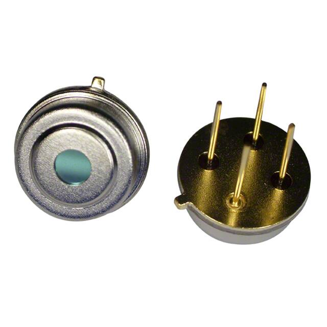

ZTP-101T Thermopile IR Sensor This thermopile sensor is used for non-contact surface temperature measuring. The ZTP -101T model consists of thermo-elements, flat IR filter, a thermistor for temperature compensation and a hermetically-sealed small-size package. There is also a variety of filters available to maximize performance in specific applications Features Applications • Included ambient temperature (thermistor) sensor for compensation • Non-contact measurement • Wider surface area measurement • Small-size sensor package • Patient monitoring • High sensitivity • Ear & Tympanic thermometers • Fast response time • Occupancy detection • Low cost • HVAC • Appliance Amphenol Advanced Sensors Specifications Thermopile Chip Parameter Thermistor Resistance (R-T Table) Limits Min Typ Units Chip Size 3.0 X 3.0 mm2 Diaphragm Size 1.5 x 1.5 mm2 Active Area 0.51 x 0.51 mm2 Internal Resistance 140 200 Resistance T.C Responsivity 77 110 T ambient (° C) Rmin (kW) Rcent (kW) Rmax (kW) -40 267 284.7 303.2 -35 197.2 209.6 222.5 -30 147.1 155.9 165 -25 110.8 117.1 123.6 -20 84.16 88.68 93.35 -15 64.46 67.73 71.11 -10 49.74 52.13 54.59 -5 38.65 40.41 42.21 0 30.24 31.54 32.86 5 23.81 24.77 25.75 10 18.86 19.58 20.3 15 15.03 15.56 16.1 R.M.S., 25°C 20 12.04 12.44 12.84 Condition Max 260 kW 0.10 %/°C 143 25°C V/W 500K, 1 Hz Responsivity T.C -0.11 %/°C Noise Voltage 62 nV rms 0.60 nW/Hz1/2 500K, 1 Hz 25 9.7 10 10.3 9.00 E07 cmHz1/2/W 500K, 1 Hz 30 7.823 8.082 8.342 22 ms 35 6.342 6.566 6.791 40 5.168 5.361 5.557 45 4.233 4.4 4.569 50 3.484 3.629 3.776 55 2.882 3.007 3.135 60 2.396 2.504 2.615 65 2.0009 2.095 2.192 70 1.679 1.7612 1.8458 75 1.4153 1.4871 1.5612 80 1.1984 1.261 1.3264 85 1.0193 1.0745 1.1317 90 0.8707 0.9193 0.9697 NEP Detectivity Time Constant Thermistor for Temperature Compensation Parameter Limits Min Resistance Beta - Value 29.1 3773 Typ 30 3811 Units Max 30.9 3849 kW K Absolute Maximum Ratings Operating Temperature -20°C ~ 100°C Storage Temperature -40°C ~ 120°C Condition Tol. :3%, @25°C Tol. :1%, Defined at 0°C/50°C 95 0.7469 0.7898 0.8344 100 0.6433 0.6812 0.7208 105 0.5562 0.5899 0.625 Sensitivity Field of View Parameter Limits 6 Min Field of View 5 45 Typ Units Condition Degree 50% of Maximum Output Max 50 55 1. 0 3 0. 9 2 0. 8 1 0. 7 Normaliz ed O utput Output[mV] 4 0 -1 -2 0 20 40 60 80 100 o 0. 6 0. 5 0. 4 0. 3 0. 2 o Object Temperature[ C] @Tamb.=25[ C] 0. 1 0. 0 -60 -50 -40 -30 -20 -10 0 10 De gr ee Transmission Data of Filter 100 T rans miss ion(%) 80 60 40 20 0 2 4 6 8 10 12 W avelength ( um) 14 16 18 20 20 30 40 50 60 Outline of Sensor Packaging and Pin Arrangement (unit = mm) Unit: mm Pin arrangement: 1. GND Thermistor 2 . Thermopile 3. GND Thermopile 4 . Thermistor Amphenol Advanced Sensors www.amphenol-sensors.com © 2014 Amphenol Corporation. All Rights Reserved. Specifications are subject to change without notice. Other company names and product names used in this document are the registered trademarks or trademarks of their respective owners. AAS-920-548A-03/2014
