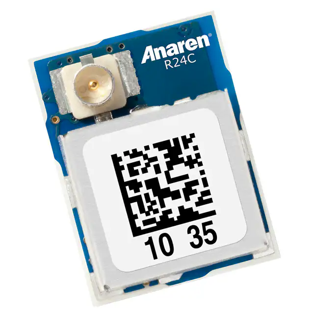

A2500R24C00GM 数据手册
Anaren Integrated Radio (AIR) Low-power RF modules, firmware & development tools that make it easy to ’go wireless’ 2500 Series The A2500R24C is a high-performance, FCC & IC certified and ETSIcompliant connectorized radio module that incorporates the Texas Instruments CC2500 transceiver chip, all in the industry’s smallest package: 9 x 12 x 2.5mm. A2500R24C Features   Frequency range: 2400-2483.5 MHz FCC, IC and ETSI compliant, shielded package    Digital RSSI output Programmable output power up to +1.0dBm High sensitivity (2.4 kBaud, 1% packet error rate)         Ultra-small package size: 9 x 12 x 2.5mm Industry-standard U.FL connector LGA footprint RoHS compliant Operating temperature -40 to +85˚C Impedance-controlled, multi-layer PCB 1.8 to 3.6 VDC Low current consumption (16 mA in RX, 250 kBaud, 2442 MHz) 400 nA sleep mode current consumption Efficient SPI interface; all registers can be programmed with one “burst” transfer Available in tape & reel and matrix tray Module weight approximately 0.4 grams FCC ID: X7J-A10030501 // IC: 8975A-A10030501 -104 dBm at 2442 MHz (compliant to FCC/IC/ETSI)     Block diagram Benefits              Minimal RF engineering experience necessary No additional “Intentional Radiator” certification required (FCC 15.247a2, IC RSS210, ETSI EN 300 328) Minimal real estate required Easily implemented on a two layer PCB No additional harmonic filtering required 100% RF-tested in production Common footprint for similar products in family No additional DC decoupling required Integrated analog temperature sensor Excellent receiver selectivity and blocking performance Suitable for frequency hopping systems, thanks to a fast-settling frequency synthesizer with 90 μs settling time Impedance-matched balun for optimized efficiency Support for asynchronous and synchronous serial receive/transmit mode for backwards compatibility with existing radio PLEASE NOTE: Additional information on the Texas Instruments CC2500 device can be found in the company’s latest datasheet release at http://www.ti.com This product is not to be used in any implantable medical device or external medical device intended to regulate or monitor biological functions, including but not limited to devices such as pacemakers, defibrillators, cardiac resynchronization devices, pressure sensors, biochemical stimulators and neurostimulators. ANAREN MAKES NO WARRANTY OF FITNESS OR MERCHANTABILITY OF THIS PRODUCT FOR ANY USE OF THIS TYPE. Anaren shall not be responsible for any consequential damages arising from the sale or use of this product for any use of this type. The ultimate user of the product assumes all risk of personal injury or death arising from a prohibited use. The item described in this product brief is part of our total AIR Support solution. To learn more, visit our website or just ask us! Anaren, Inc. | 6635 Kirkville Road | East Syracuse, NY 13057 800.411.6596 | www.anaren.com | AIR@anaren.com Anaren Integrated Radio (AIR) Low-power RF modules, firmware & development tools that make it easy to ’go wireless’ Product overview Layout Information The A2500R24C is a high-performance, FCC & IC certified and ETSI-compliant connectorized radio module that incorporates the Texas Instruments CC2500 transceiver chip in the industry’s smallest package (9 x 12 x 2.5mm) and is compatible with all TI-approved software stacks. Top 2 pads optional for compatibility with other modules. Refer to User’s Manual for additional layout guidelines. Dimensions in mm. With an LGA pad footprint and industry-standard U.FL button connector receptacle, this module is designed to effortlessly integrate into a wide range of applications, including: industrial control, building automation, low-power wireless sensor networks, lighting control, and automated meter reading. The A2500R24C has an RoHS-compliant ENIG finish and is packaged on tape & reel or in matrix trays for high-volume automated manufacturing. Footprint (PWB) Pin diagram Viewed from top side NC = “NO Connection” Pin is NOT connected internally. DNC = “Do Not Connect” Pin reserved for internal use, ensure mating footprint pads are isolated. Ground detail (corner) Ground detail (edge) Nomenclature GND = “Ground” Connect the maximum number possible (minimum one for proper operation). Caution! ESD sensitive device. Precautions should be used when handling the device in order to prevent permanent damage. The item described in this product brief is part of our total AIR Support solution. To learn more, visit our website or just ask us! For more information see product User’s Manual, available online. A 1 2 3 4 5 6 7 Chip series Function Frequency band Form factor Design ID Application Packaging (Anaren) (CC1101, CC110L, CC2500) (R = radio only) (x100MHz) (A = Internal Antenna, C = Connector) (00 = Default) (G = General) (R = Tape/Reel, M = Matrix Tray) 1308a Anaren, Inc. | 6635 Kirkville Road | East Syracuse, NY 13057 800.411.6596 | www.anaren.com | AIR@anaren.com
