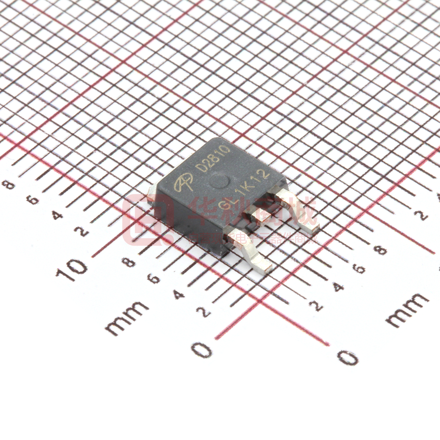

AOD2810
80V N-Channel MOSFET
General Description
Product Summary
The AOD2810 uses trench MOSFET technology that is
uniquely optimized to provide the most efficient high
frequency switching performance. Both conduction and
switching power losses are minimized due to an extremely
low combination of RDS(ON), Ciss and Coss. This device is
ideal for boost converters and synchronous rectifiers for
consumer, telecom, industrial power supplies and LED
backlighting.
VDS
ID (at VGS=10V)
80V
46A
RDS(ON) (at VGS=10V)
< 8.5mΩ
RDS(ON) (at VGS=6V)
< 12mΩ
100% UIS Tested
100% Rg Tested
TO252
DPAK
