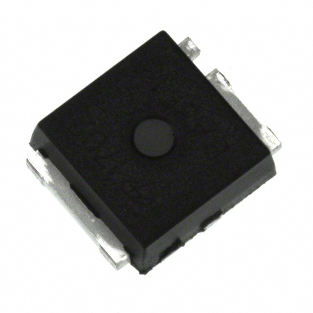

AOL1454G 40V N-Channel AlphaSGT TM General Description Product Summary • Trench Power AlphaSGTTM technology • Low RDS(ON) • Logic Level Driving • Excellent Gate Charge x RDS(ON) Product (FOM) • RoHS and Halogen-Free Compliant VDS Applications 100% UIS Tested 100% Rg Tested ID (at VGS=10V) 40V 46A RDS(ON) (at VGS=10V) < 5.9mΩ RDS(ON) (at VGS=4.5V) < 9.2mΩ • High Frequency Switching and Synchronous Rectification • DC-Motor Driver Top View UltraSO-8TM Bottom View D D G S G G S S Orderable Part Number Package Type Form Minimum Order Quantity AOL1454G Ultra SO8 Tape & Reel 3000 Absolute Maximum Ratings TA=25°C unless otherwise noted Parameter Drain-Source Voltage Symbol VDS Gate-Source Voltage VGS TC=25°C Continuous Drain Current G Pulsed Drain Current C Avalanche Current C Avalanche energy L=0.3mH TC=25°C Power Dissipation B C TA=25°C Power Dissipation A Junction and Storage Temperature Range Thermal Characteristics Parameter Maximum Junction-to-Ambient Maximum Junction-to-Ambient Maximum Junction-to-Case Rev.1.0: October 2017 IAS 20 A EAS 60 mJ 52 AD t ≤ 10s Steady-State Steady-State W 20.5 6.2 RqJA RqJC W 4.0 TJ, TSTG Symbol A A 20 PDSM TA=70°C A 25 PD TC=100°C V 155 IDSM TA=70°C ±20 46 IDM TA=25°C Continuous Drain Current Units V 46 ID TC=100°C Maximum 40 -55 to 150 Typ 15 40 1.9 www.aosmd.com Max 20 50 2.4 °C Units °C/W °C/W °C/W Page 1 of 6 AOL1454G Electrical Characteristics (TJ=25°C unless otherwise noted) Symbol Parameter STATIC PARAMETERS BVDSS Drain-Source Breakdown Voltage Conditions Min ID=250mA, VGS=0V Zero Gate Voltage Drain Current IGSS VGS(th) Gate-Body leakage current VDS=0V, VGS=±20V Gate Threshold Voltage VDS=VGS, ID=250mA TJ=55°C nA 2.0 2.5 V 4.8 5.9 7.3 8.9 VGS=4.5V, ID=20A 7.2 9.2 1.5 TJ=125°C gFS Forward Transconductance VDS=5V, ID=20A 70 VSD Diode Forward Voltage IS=1A, VGS=0V 0.7 Maximum Body-Diode Continuous Current G DYNAMIC PARAMETERS Ciss Input Capacitance Output Capacitance Crss Reverse Transfer Capacitance Rg Gate resistance μA 5 ±100 Static Drain-Source On-Resistance Coss Units V 1 VGS=10V, ID=20A IS Max 40 VDS=40V, VGS=0V IDSS RDS(ON) Typ VGS=0V, VDS=20V, f=1MHz mΩ mΩ S 1 V 46 A 1480 pF 245 pF 13 pF 1.8 2.7 Ω SWITCHING PARAMETERS Qg(10V) Total Gate Charge 20 30 nC Qg(4.5V) Total Gate Charge 8.5 14 nC Qgs Gate Source Charge Qgd Gate Drain Charge Qoss Output Charge tD(on) Turn-On DelayTime tr Turn-On Rise Time tD(off) Turn-Off DelayTime tf trr Turn-Off Fall Time Qrr f=1MHz VGS=10V, VDS=20V, ID=20A 0.9 5.5 nC 3 nC 10 nC 7.5 ns 2 ns 23 ns 3 ns IF=20A, di/dt=500A/ms 11 Body Diode Reverse Recovery Charge IF=20A, di/dt=500A/ms 21 ns nC Body Diode Reverse Recovery Time VGS=0V, VDS=20V VGS=10V, VDS=20V, RL=1.0W, RGEN=3W A. The value of RqJA is measured with the device mounted on 1in 2 FR-4 board with 2oz. Copper, in a still air environment with TA =25°C. The Power dissipation PDSM is based on R qJA t≤ 10s and the maximum allowed junction temperature of 150°C. The value in any given application depends on the user's specific board design. B. The power dissipation PD is based on TJ(MAX)=150°C, using junction-to-case thermal resistance, and is more useful in setting the upper dissipation limit for cases where additional heatsinking is used. C. Single pulse width limited by junction temperature TJ(MAX)=150°C. D. The RqJA is the sum of the thermal impedance from junction to case R qJC and case to ambient. E. The static characteristics in Figures 1 to 6 are obtained using or equal to 4.5V Figure 9: Maximum Forward Biased Safe Operating Area (Note F) 100 0 0.0001 0.001 0.01 0.1 1 10 100 Pulse Width (s) Figure 10: Single Pulse Power Rating Junction-toCase (Note F) ZqJC Normalized Transient Thermal Resistance 10 In descending order D=0.5, 0.3, 0.1, 0.05, 0.02, 0.01, single pulse D=Ton/T TJ,PK=TC+PDM.ZqJC.RqJC RqJC=2.4°C/W 1 0.1 PDM Single Pulse Ton T 0.01 1E-05 0.0001 0.001 0.01 0.1 1 10 100 Pulse Width (s) Figure 11: Normalized Maximum Transient Thermal Impedance (Note F) Rev.1.0: October 2017 www.aosmd.com Page 4 of 6 AOL1454G TYPICAL ELECTRICAL AND THERMAL CHARACTERISTICS 60 40 Current rating ID (A) Power Dissipation (W) 60 20 40 20 0 0 0 25 50 75 100 125 150 0 25 TCASE (°C) Figure 12: Power De-rating (Note F) 50 75 100 125 150 TCASE (°C) Figure 13: Current De-rating (Note F) 10000 1 TA=25°C Power (W) Eoss(uJ) 1000 100 0.5 10 0 0 10 20 30 40 1 1E-05 0.1 10 1000 Pulse Width (s) Figure 15: Single Pulse Power Rating Junctionto-Ambient (Note H) VDS (Volts) Figure 14: Coss stored Energy ZqJA Normalized Transient Thermal Resistance 0.001 10 1 In descending order D=0.5, 0.3, 0.1, 0.05, 0.02, 0.01, single pulse D=Ton/T TJ,PK=TA+PDM.ZqJA.RqJA RqJA=50°C/W 0.1 0.01 PDM Single Pulse Ton 0.001 0.0001 0.001 0.01 0.1 1 10 T 100 1000 Pulse Width (s) Figure 16: Normalized Maximum Transient Thermal Impedance (Note H) Rev.1.0: October 2017 www.aosmd.com Page 5 of 6 AOL1454G Figure A: Charge Gate Charge Test Circuit & Waveforms Gate Test Circuit & Waveform Vgs Qg 10V + + Vds VDC - Qgs Qgd VDC - DUT Vgs Ig Charge Figure B:Resistive ResistiveSwitching Switching Test Test Circuit Circuit&&Waveforms Waveforms RL Vds Vds DUT Vgs 90% + Vdd VDC - Rg 10% Vgs Vgs td(on) tr td(off) ton tf toff Figure C: UnclampedInductive InductiveSwitching Switching (UIS) Test Unclamped Test Circuit Circuit&&Waveforms Waveforms L 2 EAR= 1/2 LIAR Vds BVDSS Vds Id + Vdd Vgs Vgs I AR VDC - Rg Id DUT Vgs Vgs Figure D: Recovery Diode Recovery Test Circuit & Waveforms Diode Test Circuit & Waveforms Q rr = - Idt Vds + DUT Vds - Isd Vgs Ig Rev.1.0: October 2017 Vgs L Isd + Vdd t rr dI/dt I RM Vdd VDC - IF Vds www.aosmd.com Page 6 of 6
