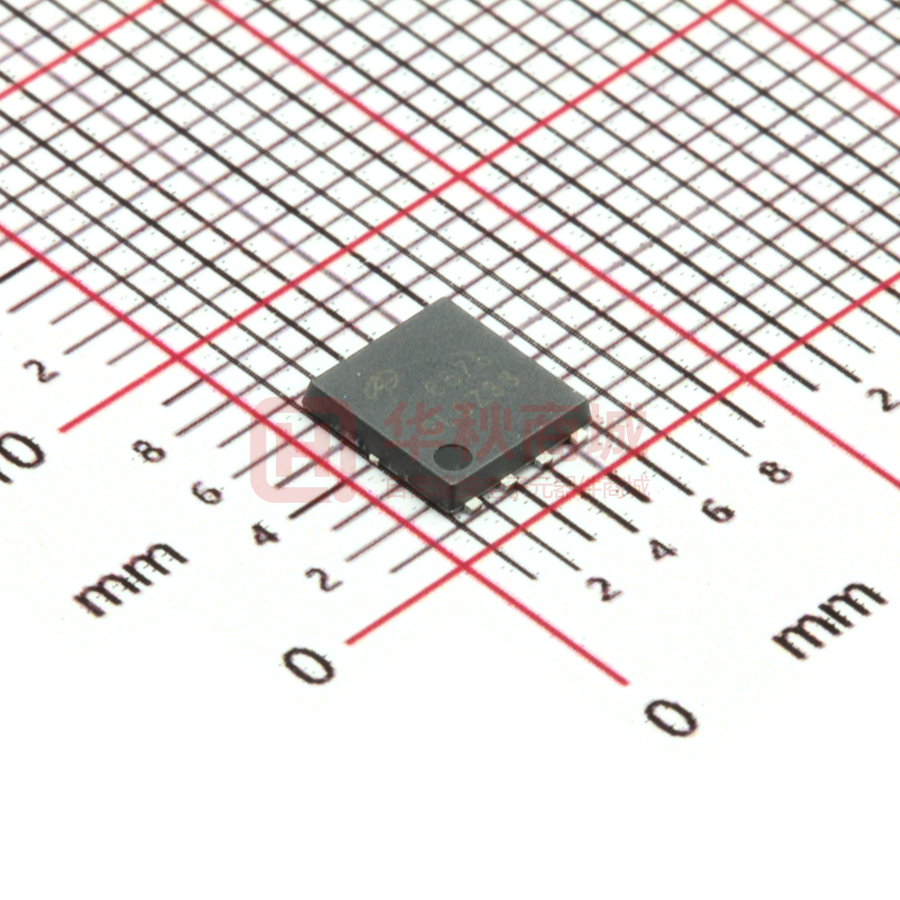

AON6576 30V N-Channel AlphaMOS General Description Product Summary VDS • Trench Power AlphaMOS (αMOS LV) technology • Low RDS(ON) • Low Gate Charge • High Current Capability • RoHS and Halogen-Free Compliant 30V 32A ID (at VGS=10V) Applications RDS(ON) (at VGS=10V) < 4.7mΩ RDS(ON) (at VGS=4.5V) < 7.2mΩ 100% UIS Tested 100% Rg Tested • DC/DC Converters in Computing, Servers, and POL • Isolated DC/DC Converters in Telecom and Industrial DFN5X6 Top View D Top View Bottom View PIN1 1 8 2 7 3 6 4 5 G PIN1 S Orderable Part Number Package Type Form Minimum Order Quantity AON6576 DFN 5x6 Tape & Reel 3000 Absolute Maximum Ratings TA=25°C unless otherwise noted Parameter Drain-Source Voltage Symbol VDS Gate-Source Voltage VGS TC=25°C Continuous Drain Current G Pulsed Drain Current Continuous Drain Current Avalanche Current C Avalanche energy VDS Spike L=0.05mH C 10µs TC=25°C Power Dissipation B TC=100°C Power Dissipation A TA=70°C Thermal Characteristics Parameter Maximum Junction-to-Ambient A Maximum Junction-to-Ambient A D Maximum Junction-to-Case Rev.1.0: January 2014 IAS 33 A EAS 27 mJ VSPIKE 36 V 26 Steady-State Steady-State W 10.4 5 RθJA RθJC W 3.2 TJ, TSTG Symbol t ≤ 10s A 21 PDSM Junction and Storage Temperature Range A 26 PD TA=25°C V 128 IDSM TA=70°C ±20 25 IDM TA=25°C Units V 32 ID TC=100°C C Maximum 30 -55 to 150 Typ 20 45 4 www.aosmd.com °C Max 25 55 4.8 Units °C/W °C/W °C/W Page 1 of 6 Electrical Characteristics (TJ=25°C unless otherwise noted) Symbol Parameter STATIC PARAMETERS BVDSS Drain-Source Breakdown Voltage Conditions Min ID=250µA, VGS=0V Typ Zero Gate Voltage Drain Current IGSS VGS(th) Gate-Body leakage current VDS=0V, VGS=±20V Gate Threshold Voltage VDS=VGS, ID=250µA V 1 TJ=55°C 1.4 ±100 nA 1.8 2.2 V 3.9 4.7 5.5 6.7 7.2 RDS(ON) Static Drain-Source On-Resistance VGS=4.5V, ID=20A 5.7 gFS Forward Transconductance VDS=5V, ID=20A 83 VSD Diode Forward Voltage IS=1A,VGS=0V 0.7 IS Maximum Body-Diode Continuous Current TJ=125°C DYNAMIC PARAMETERS Input Capacitance Ciss Output Capacitance Crss Reverse Transfer Capacitance Rg Gate resistance VGS=0V, VDS=15V, f=1MHz f=1MHz µA 5 VGS=10V, ID=20A Coss Units 30 VDS=30V, VGS=0V IDSS Max 0.7 mΩ mΩ S 1 V 30 A 1320 pF 530 pF 70 pF 1.4 Ω 2.1 SWITCHING PARAMETERS Qg(10V) Total Gate Charge 18.8 27 nC Qg(4.5V) Total Gate Charge 8.8 15 nC VGS=10V, VDS=15V, ID=20A Qgs Gate Source Charge 3.7 nC Qgd Gate Drain Charge 4 nC tD(on) Turn-On DelayTime 7 ns tr Turn-On Rise Time tD(off) Turn-Off DelayTime tf trr Turn-Off Fall Time 4 ns IF=20A, dI/dt=500A/µs 13.5 Qrr Body Diode Reverse Recovery Charge IF=20A, dI/dt=500A/µs 20.6 ns nC Body Diode Reverse Recovery Time VGS=10V, VDS=15V, RL=0.75Ω, RGEN=3Ω 3 ns 21 ns A. The value of RθJA is measured with the device mounted on 1in2 FR-4 board with 2oz. Copper, in a still air environment with TA =25°C. The Power dissipation PDSM is based on R θJA t≤ 10s and the maximum allowed junction temperature of 150°C. The value in any given application depends on the user's specific board design. B. The power dissipation PD is based on TJ(MAX)=150°C, using junction-to-case thermal resistance, and is more useful in setting the upper dissipation limit for cases where additional heatsinking is used. C. Single pulse width limited by junction temperature TJ(MAX)=150°C. D. The RθJA is the sum of the thermal impedance from junction to case RθJC and case to ambient. E. The static characteristics in Figures 1 to 6 are obtained using or equal to 4.5V Figure 9: Maximum Forward Biased Safe Operating Area (Note F) 0 1E-05 0.0001 0.001 100 0.01 0.1 1 10 Pulse Width (s) Figure 10: Single Pulse Power Rating Junction-toCase (Note F) Zθ JC Normalized Transient Thermal Resistance 10 D=Ton/T TJ,PK=TC+PDM.ZθJC.RθJC In descending order D=0.5, 0.3, 0.1, 0.05, 0.02, 0.01, single pulse RθJC=4.8°C/W 1 0.1 PD Single Pulse Ton T 0.01 1E-05 0.0001 0.001 0.01 0.1 1 10 Pulse Width (s) Figure 11: Normalized Maximum Transient Thermal Impedance (Note F) Rev.1.0: January 2014 www.aosmd.com Page 4 of 6 TYPICAL ELECTRICAL AND THERMAL CHARACTERISTICS 30 40 Power Dissipation (W) 30 Current rating ID(A) 20 10 20 10 0 0 0 25 50 75 100 125 150 0 25 TCASE (° °C) Figure 12: Power De-rating (Note F) 50 75 100 125 150 TCASE (° °C) Figure 13: Current De-rating (Note F) 10000 TA=25°C Power (W) 1000 100 10 1 1E-05 0.001 0.1 10 1000 Zθ JA Normalized Transient Thermal Resistance Pulse Width (s) Figure 14: Single Pulse Power Rating Junction-to-Ambient (Note H) 10 1 D=Ton/T TJ,PK=TA+PDM.ZθJA.RθJA RθJA=55°C/W In descending order D=0.5, 0.3, 0.1, 0.05, 0.02, 0.01, single pulse 0.1 0.01 PD Single Pulse Ton 0.001 0.0001 T 0.001 0.01 0.1 1 10 100 1000 Pulse Width (s) Figure 15: Normalized Maximum Transient Thermal Impedance (Note H) Rev.1.0: January 2014 www.aosmd.com Page 5 of 6 Gate Charge Test Circuit & Waveform Vgs Qg 10V + + Vds VDC - Qgs Qgd VDC - DUT Vgs Ig Charge Resistive Switching Test Circuit & Waveforms RL Vds Vds DUT Vgs 90% + Vdd VDC - Rg 10% Vgs Vgs td(on) tr td(off) ton tf toff Unclamped Inductive Switching (UIS) Test Circuit & Waveforms L 2 EAR= 1/2 LIAR Vds BVDSS Vds Id + Vdd Vgs Vgs I AR VDC - Rg Id DUT Vgs Vgs Diode Recovery Test Circuit & Waveforms Q rr = - Idt Vds + DUT Vgs Vds Isd Vgs Ig Rev.1.0: January 2014 L Isd + Vdd t rr dI/dt I RM Vdd VDC - IF Vds www.aosmd.com Page 6 of 6

物料型号:AON6576 器件简介:30V N-Channel AlphaMOS,采用Trench Power AlphaMOS (αMOS LV)技术,具有低RDS(ON)、低栅极电荷、高电流能力和符合RoHS及无卤要求。
引脚分配:DFN5X6封装,PIN1为漏极(D)。
参数特性:VDS为30V,ID在VGS=10V时小于4.7mΩ,在VGS=4.5V时小于7.2mΩ。
功能详解:适用于计算、服务器和POL的DC/DC转换器,以及电信和工业的隔离式DC/DC转换器。
应用信息:100% UIS测试和100% Rg测试。
封装信息:DFN 5x6封装,胶带和卷轴形式,最小订购量为3000。
绝对最大额定值包括漏源电压、栅源电压等,其中漏源电压最大为32V,栅源电压最大为20V。
热特性包括最大结到环境热阻、最大结到外壳热阻等,其中结到环境热阻在稳态下最大为55°C/W。
电气特性包括静态参数、动态参数和开关参数,例如漏源击穿电压、栅体漏电流、栅阈值电压、静态漏源导通电阻、正向跨导、二极管正向电压、输入电容、输出电容、反向传输电容、栅源电荷、栅漏电荷、栅源电阻、总栅极电荷、开通延迟时间、开通上升时间、关断延迟时间、关断下降时间、体二极管反向恢复时间、体二极管反向恢复电荷等。
典型电气和热特性图表包括导通区域特性、转移特性、导通电阻与漏电流和栅源电压的关系、导通电阻与结温的关系、导通电阻与栅源电压的关系、体二极管特性、栅极电荷特性、电容特性、单脉冲功率额定值、最大正向偏置安全工作区、单脉冲功率额定值(结到环境)、功率降额、电流降额、单脉冲功率额定值(结到环境)、最大瞬态热阻抗(结到环境)等。
