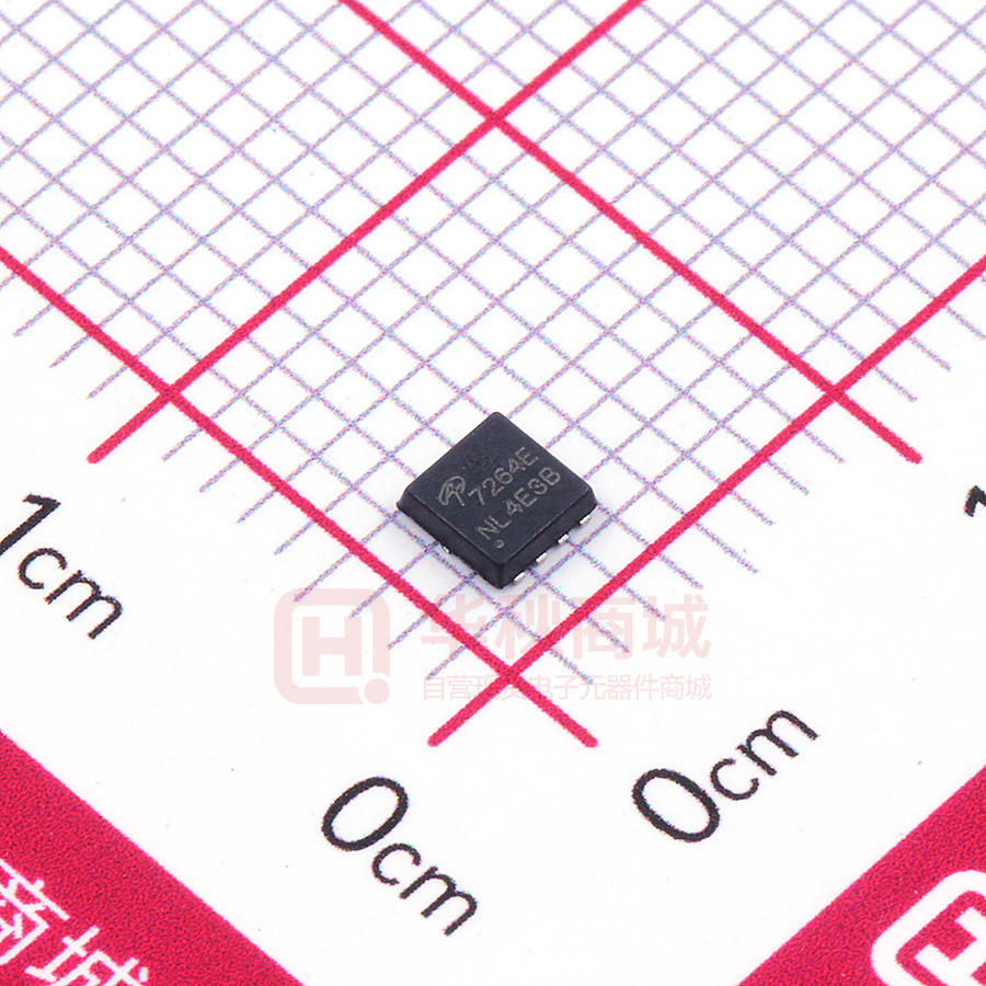

AON7264E
60V N-Channel AlphaSGT TM
General Description
Product Summary
VDS
• Trench Power AlphaSGTTM technology
• Low RDS(ON)
• Low Gate Charge
• ESD protected
60V
28A
ID (at VGS=10V)
Applications
RDS(ON) (at VGS=10V)
< 9.5mΩ
RDS(ON) (at VGS=4.5V)
< 13.3mΩ
Typical ESD protection
HBM Class 2
100% UIS Tested
100% Rg Tested
• High efficiency power supply
• Secondary synchronous rectifier
Top View
DFN 3x3 EP
