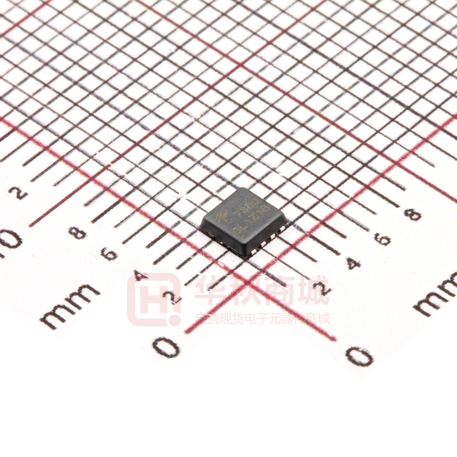

    N沟道MOSFET VDS=30V VGS=±20V ID=24A DFN8_3X3MM_EP
AON7380 数据手册
AON7380 30V N-Channel AlphaMOS General Description Product Summary VDS • Trench Power AlphaMOS (αMOS LV) technology • Low RDS(ON) • Low Gate Charge • High Current Capability • RoHS and Halogen-Free Compliant ID (at VGS=10V) 30V 24A RDS(ON) (at VGS=10V) < 6.8mΩ RDS(ON) (at VGS=4.5V) < 10.5mΩ 100% UIS Tested 100% Rg Tested Applications • DC/DC Converters in Computing • Isolated DC/DC Converters in Telecom and Industrial • See Note I DFN 3x3 EP Bottom View Top View D Top View 1 8 2 7 3 6 4 5 G Pin 1 S Pin 1 Orderable Part Number Package Type Form Minimum Order Quantity AON7380 DFN 3x3 EP Tape & Reel 5000 Absolute Maximum Ratings TA=25°C unless otherwise noted Parameter Drain-Source Voltage Symbol VDS Gate-Source Voltage VGS TC=25°C Continuous Drain Current G Pulsed Drain Current C Continuous Drain Current Avalanche Current C Avalanche energy L=0.001mH VDS Spike 10µs TC=25°C Power Dissipation B TC=100°C Power Dissipation A TA=70°C C Thermal Characteristics Parameter Maximum Junction-to-Ambient A Maximum Junction-to-Ambient A D Maximum Junction-to-Case Rev.2.0 : September 2017 IAS 60 A EAS 2 mJ VSPIKE 36 V 24 Steady-State Steady-State W 9.5 4.1 RθJA RθJC W 2.6 TJ, TSTG Symbol t ≤ 10s A 15 PDSM Junction and Storage Temperature Range A 20 PD TA=25°C V 80 IDSM TA=70°C ±20 24 IDM TA=25°C Units V 24 ID TC=100°C Maximum 30 -55 to 150 Typ 24 47 4.2 www.aosmd.com °C Max 30 60 5.2 Units °C/W °C/W °C/W Page 1 of 6 AON7380 Electrical Characteristics (TJ=25°C unless otherwise noted) Symbol Parameter STATIC PARAMETERS BVDSS Drain-Source Breakdown Voltage Conditions Min ID=250µA, VGS=0V Typ Zero Gate Voltage Drain Current IGSS VGS(th) Gate-Body leakage current VDS=0V, VGS=±20V Gate Threshold Voltage VDS=VGS, ID=250µA V 1 TJ=55°C 1.4 ±100 nA 1.8 2.2 V 5.6 6.8 8.1 9.8 10.5 RDS(ON) Static Drain-Source On-Resistance VGS=4.5V, ID=20A 8.2 gFS Forward Transconductance VDS=5V, ID=20A 40 VSD Diode Forward Voltage IS=1A, VGS=0V 0.7 IS Maximum Body-Diode Continuous Current G TJ=125°C DYNAMIC PARAMETERS Input Capacitance Ciss Output Capacitance Crss Reverse Transfer Capacitance Rg Gate resistance VGS=0V, VDS=15V, f=1MHz f=1MHz µA 5 VGS=10V, ID=20A Coss Units 30 VDS=30V, VGS=0V IDSS Max mΩ S 1 V 24 A 825 pF 335 pF 40 pF 1.2 1.8 Ω SWITCHING PARAMETERS Qg(10V) Total Gate Charge 13 25 nC Qg(4.5V) Total Gate Charge 6.2 12 Qgs Gate Source Charge Qgd Qgs Qgd Gate Drain Charge tD(on) Turn-On DelayTime tr Turn-On Rise Time tD(off) Turn-Off DelayTime tf trr Turn-Off Fall Time IF=20A, di/dt=500A/µs Qrr Body Diode Reverse Recovery Charge IF=20A, di/dt=500A/µs 17 VGS=10V, VDS=15V, ID=20A 0.6 mΩ nC 2.2 nC Gate Drain Charge 2.6 nC Gate Source Charge 2.2 nC 2.6 nC 5 ns Body Diode Reverse Recovery Time VGS=4.5V, VDS=15V, ID=20A VGS=10V, VDS=15V, RL=0.75Ω, RGEN=3Ω 3 ns 20 ns 3 ns 11 ns nC A. The value of RθJA is measured with the device mounted on 1in2 FR-4 board with 2oz. Copper, in a still air environment with TA =25°C. The Power dissipation PDSM is based on R θJA t≤ 10s and the maximum allowed junction temperature of 150°C. The value in any given application depends on the user's specific board design. B. The power dissipation PD is based on TJ(MAX)=150°C, using junction-to-case thermal resistance, and is more useful in setting the upper dissipation limit for cases where additional heatsinking is used. C. Single pulse width limited by junction temperature TJ(MAX)=150°C. D. The RθJA is the sum of the thermal impedance from junction to case RθJC and case to ambient. E. The static characteristics in Figures 1 to 6 are obtained using 1ms turn-on/turn-off, please consult AOS FAE for proper product selection. THIS PRODUCT HAS BEEN DESIGNED AND QUALIFIED FOR THE CONSUMER MARKET. APPLICATIONS OR USES AS CRITICAL COMPONENTS IN LIFE SUPPORT DEVICES OR SYSTEMS ARE NOT AUTHORIZED. AOS DOES NOT ASSUME ANY LIABILITY ARISING OUT OF SUCH APPLICATIONS OR USES OF ITS PRODUCTS. AOS RESERVES THE RIGHT TO IMPROVE PRODUCT DESIGN, FUNCTIONS AND RELIABILITY WITHOUT NOTICE. Rev.2.0 : September 2017 www.aosmd.com Page 2 of 6 AON7380 TYPICAL ELECTRICAL AND THERMAL CHARACTERISTICS 80 80 4V 10V VDS=5V 4.5V 60 60 ID (A) ID (A) 3.5V 40 40 125°C 25°C 20 20 VGS=3V 0 0 0 1 2 3 4 0 5 1 2 3 4 5 6 VGS (Volts) Figure 2: Transfer Characteristics (Note E) VDS (Volts) Figure 1: On-Region Characteristics (Note E) 10 1.6 Normalized On-Resistance VGS=4.5V RDS(ON) (mΩ) 8 6 VGS=10V 4 2 VGS=10V ID=20A 1.4 1.2 VGS=4.5V ID=20A 1 0.8 0 0 5 10 15 20 25 0 30 25 50 75 100 125 150 175 Temperature (°C) Figure 4: On-Resistance vs. Junction Temperature (Note E) ID (A) Figure 3: On-Resistance vs. Drain Current and Gate Voltage (Note E) 20 1.0E+01 ID=20A 1.0E+00 1.0E-01 125°C IS (A) RDS(ON) (mΩ) 15 10 125°C 25°C 1.0E-02 1.0E-03 5 25°C 1.0E-04 0 1.0E-05 2 4 6 8 10 VGS (Volts) Figure 5: On-Resistance vs. Gate-Source Voltage (Note E) Rev.2.0 : September 2017 www.aosmd.com 0.0 0.2 0.4 0.6 0.8 1.0 VSD (Volts) Figure 6: Body-Diode Characteristics (Note E) Page 3 of 6 AON7380 TYPICAL ELECTRICAL AND THERMAL CHARACTERISTICS 10 1200 VDS=15V ID=20A 1000 Capacitance (pF) VGS (Volts) 8 6 4 2 Ciss 800 600 Coss 400 200 0 Crss 0 0 3 6 9 12 15 0 Qg (nC) Figure 7: Gate-Charge Characteristics 10µs 20 25 30 RDS(ON) limited 10µs 100µs DC 1ms 10ms 1.0 TJ(Max)=150°C TC=25°C 120 Power (W) ID (Amps) 15 150 100.0 0.1 10 VDS (Volts) Figure 8: Capacitance Characteristics 1000.0 10.0 5 90 60 30 TJ(Max)=150°C TC=25°C 0.0 0.01 0.1 1 10 VDS (Volts) VGS> or equal to 4.5V Figure 9: Maximum Forward Biased Safe Operating Area (Note F) 100 0 0.0001 0.001 0.01 0.1 1 10 Pulse Width (s) Figure 10: Single Pulse Power Rating Junction-toCase (Note F) ZθJC Normalized Transient Thermal Resistance 10 In descending order D=0.5, 0.3, 0.1, 0.05, 0.02, 0.01, single pulse D=Ton/T TJ,PK=TC+PDM.ZθJC.RθJC RθJC=5.2°C/W 1 0.1 PDM Single Pulse Ton T 0.01 1E-05 0.0001 0.001 0.01 0.1 1 10 100 Pulse Width (s) Figure 11: Normalized Maximum Transient Thermal Impedance (Note F) Rev.2.0 : September 2017 www.aosmd.com Page 4 of 6 AON7380 Power Dissipation (W) TYPICAL ELECTRICAL AND THERMAL CHARACTERISTICS 30 30 25 25 Current rating ID (A) 20 15 10 20 15 10 5 5 0 0 0 25 50 75 100 125 150 0 25 TCASE (°C) Figure 12: Power De-rating (Note F) 50 75 100 125 150 TCASE (°C) Figure 13: Current De-rating (Note F) 10000 TA=25°C Power (W) 1000 100 10 1 1E-05 0.001 0.1 10 1000 ZθJA Normalized Transient Thermal Resistance Pulse Width (s) Figure 14: Single Pulse Power Rating Junction-to-Ambient (Note H) 10 D=Ton/T TJ,PK=TA+PDM.ZθJA.RθJA 1 In descending order D=0.5, 0.3, 0.1, 0.05, 0.02, 0.01, single pulse RθJA=60°C/W 0.1 0.01 PDM Single Pulse Ton 0.001 0.0001 0.001 0.01 0.1 1 10 T 100 1000 Pulse Width (s) Figure 15: Normalized Maximum Transient Thermal Impedance (Note H) Rev.2.0 : September 2017 www.aosmd.com Page 5 of 6 AON7380 Figure A: Charge Gate Charge Test Circuit & Waveforms Gate Test Circuit & Waveform Vgs Qg 10V + + Vds VDC - Qgs Qgd VDC - DUT Vgs Ig Charge Figure B:Resistive ResistiveSwitching Switching Test Test Circuit Circuit&&Waveforms Waveforms RL Vds Vds Vgs 90% + Vdd DUT VDC - Rg 10% Vgs Vgs td(on) tr td(off) ton tf toff Figure C: UnclampedInductive InductiveSwitching Switching (UIS) Test Unclamped TestCircuit Circuit&&Waveforms Waveforms L 2 EAR= 1/2 LIAR Vds BVDSS Vds Id + Vdd Vgs Vgs I AR VDC - Rg Id DUT Vgs Vgs Figure D: Recovery Diode Recovery Test Circuit & Waveforms Diode Test Circuit & Waveforms Q rr = - Idt Vds + DUT Vds - Isd Vgs Ig Rev.2.0 : September 2017 Vgs L Isd + Vdd t rr dI/dt I RM Vdd VDC - IF Vds www.aosmd.com Page 6 of 6
