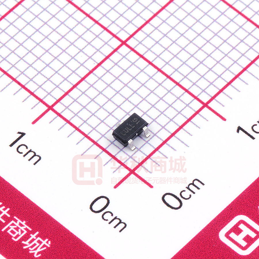

    表面贴装型 P 通道 30 V 2.8A(Ta) 1.3W(Ta) SOT-23-3
AOSS21319C 数据手册
AOSS21319C 30V P-Channel MOSFET General Description Product Summary • Trench Power MOSFET technology • Low RDS(ON) • Low Gate Charge • RoHS and Halogen-Free Compliant VDS ID (at VGS=-10V) -30V -2.8A RDS(ON) (at VGS=-10V) < 100mΩ RDS(ON) (at VGS=-4.5V) < 150mΩ ESD protection Applications • This device is ideal for Load Switch SOT23 Top View D Bottom View D G S S G Orderable Part Number Package Type Form Minimum Order Quantity AOSS21319C SOT23-3 Tape & Reel 3000 Absolute Maximum Ratings TA=25°C unless otherwise noted Parameter Drain-Source Voltage Symbol VDS Gate-Source Voltage VGS TA=25°C Continuous Drain Current TA=70°C Pulsed Drain Current Power Dissipation B Junction and Storage Temperature Range Thermal Characteristics Parameter Maximum Junction-to-Ambient A Maximum Junction-to-Ambient A D Maximum Junction-to-Lead Rev.1.0: August 2019 Steady-State Steady-State A 1.3 W 0.8 TJ, TSTG Symbol t ≤ 10s V -10 PD TA=70°C ±20 -2.1 IDM TA=25°C Units V -2.8 ID C Maximum -30 RqJA RqJL -55 to 150 Typ 70 100 63 www.aosmd.com °C Max 90 125 80 Units °C/W °C/W °C/W Page 1 of 5 AOSS21319C Electrical Characteristics (TJ=25°C unless otherwise noted) Symbol Parameter STATIC PARAMETERS BVDSS Drain-Source Breakdown Voltage Conditions Min ID=-250mA, VGS=0V -30 Zero Gate Voltage Drain Current IGSS VGS(th) Gate-Body leakage current VDS=0V, VGS=±20V Gate Threshold Voltage VDS=VGS, ID=-250mA TJ=125°C VGS=-4.5V, ID=-2.4A Forward Transconductance VDS=-5V, ID=-2.8A VSD Diode Forward Voltage IS=-1A, VGS=0V IS Maximum Body-Diode Continuous Current DYNAMIC PARAMETERS Ciss Input Capacitance Coss Output Capacitance Crss Reverse Transfer Capacitance Rg Gate resistance VGS=0V, VDS=-15V, f=1MHz μA -5 -1.2 VGS=-10V, ID=-2.8A gFS Units -1 TJ=55°C Static Drain-Source On-Resistance Max V VDS=-30V, VGS=0V IDSS RDS(ON) Typ ±10 μA -1.7 -2.2 V 70 100 102 145 103 150 mΩ mΩ 8 -0.8 S -1 V -2 A 320 pF 40 pF 35 pF 18 27 Ω SWITCHING PARAMETERS Qg(10V) Total Gate Charge 6 12 nC Qg(4.5V) Total Gate Charge 3 6 nC Qgs Gate Source Charge Qgd Gate Drain Charge tD(on) Turn-On DelayTime tr Turn-On Rise Time tD(off) Turn-Off DelayTime tf trr Turn-Off Fall Time Qrr f=1MHz VGS=-10V, VDS=-15V, ID=-2.8A VGS=-10V, VDS=-15V, RL=5.357W, RGEN=3W 1 nC 1.6 nC 8 ns 5 ns 25 ns 9.5 ns IF=-2.8A, di/dt=500A/ms 9 Body Diode Reverse Recovery Charge IF=-2.8A, di/dt=500A/ms 13 ns nC Body Diode Reverse Recovery Time A. The value of RqJA is measured with the device mounted on 1in 2 FR-4 board with 2oz. Copper, in a still air environment with TA =25°C. The value in any given application depends on the user's specific board design. B. The power dissipation PD is based on TJ(MAX)=150°C, using ≤ 10s junction-to-ambient thermal resistance. C. Repetitive rating, pulse width limited by junction temperature TJ(MAX)=150°C. Ratings are based on low frequency and duty cycles to keep initialTJ=25°C. D. The RqJA is the sum of the thermal impedance from junction to lead R qJL and lead to ambient. E. The static characteristics in Figures 1 to 6 are obtained using or equal to -4.5V Figure 9: Maximum Forward Biased Safe Operating Area (Note F) 1 1E-05 100 0.001 0.1 10 1000 Pulse Width (s) Figure 10: Single Pulse Power Rating Junction-toAmbient (Note F) D=Ton/T TJ,PK=TA+PDM.ZqJA.RqJA In descending order D=0.5, 0.3, 0.1, 0.05, 0.02, 0.01, single pulse RqJA=125°C/W 0.1 PDM 0.01 0.001 1E-05 Single Pulse Ton 0.0001 0.001 0.01 0.1 1 10 T 100 1000 Pulse Width (s) Figure 11: Normalized Maximum Transient Thermal Impedance (Note F) Rev.1.0: August 2019 www.aosmd.com Page 4 of 5 AOSS21319C Gate Charge Test Circuit & Waveform Vgs Qg -10V - - VDC + VDC Qgd + DUT Qgs Vds Vgs Ig Charge Resistive Switching Test Circuit & Waveforms RL Vds toff ton td(on) Vgs - DUT Vgs VDC td(off) tr tf 90% Vdd + Rg Vgs 10% Vds Unclamped Inductive Switching (UIS) Test Circuit & Waveforms 2 L EAR= 1/2 LIAR Vds Vds Id - Vgs Vgs VDC BVDSS Vdd + Rg Id I AR DUT Vgs Vgs Diode Recovery Test Circuit & Waveforms Q rr = - Idt Vds + DUT Vgs Vds Isd Vgs Ig Rev.1.0: August 2019 L -Isd + Vdd t rr dI/dt -I RM Vdd VDC - -I F -Vds www.aosmd.com Page 5 of 5
