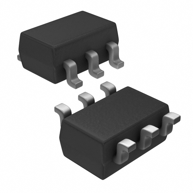

    N沟道 MOSFET,电流:3.8A,耐压:30V
AOTS32338C 数据手册
AOTS32338C 30V N-Channel MOSFET General Description Product Summary • Trench Power MOSFET technology • Low RDS(ON) • Low Gate Charge • RoHS and Halogen-Free Compliant ID (at VGS=10V) 30V 3.8A RDS(ON) (at VGS=10V) < 50mΩ RDS(ON) (at VGS=4.5V) < 57mΩ RDS(ON) (at VGS=2.5V) < 72mΩ VDS ESD protection Applications • Ideal for Load Switching D TSOP6 Top View D Bottom View Top View G1 1 6 D1 S2 2 5 S1 G2 3 4 D2 G G S S Pin1 Orderable Part Number Package Type Form Minimum Order Quantity AOTS32338C TSOP-6 Tape & Reel 3000 Absolute Maximum Ratings TA=25°C unless otherwise noted Parameter Drain-Source Voltage Symbol VDS Gate-Source Voltage VGS TA=25°C Continuous Drain Current Pulsed Drain Current C Power Dissipation Junction and Storage Temperature Range Thermal Characteristics Parameter Maximum Junction-to-Ambient A Maximum Junction-to-Ambient A D Maximum Junction-to-Lead Rev.1.0: January 2019 Steady-State Steady-State RqJA RqJL www.aosmd.com A 1.2 W 0.8 TJ, TSTG Symbol t ≤ 10s V 22 PD TA=70°C ±12 2.9 IDM TA=25°C B Units V 3.8 ID TA=70°C Maximum 30 -55 to 150 Typ 82 111 56 °C Max 100 140 70 Units °C/W °C/W °C/W Page 1 of 5 AOTS32338C Electrical Characteristics (TJ=25°C unless otherwise noted) Symbol Parameter STATIC PARAMETERS BVDSS Drain-Source Breakdown Voltage Conditions Min ID=250μA, VGS=0V Zero Gate Voltage Drain Current IGSS VGS(th) Gate-Body leakage current VDS=0V, VGS=±12V Gate Threshold Voltage VDS=VGS, ID=250mA V TJ=55°C ±10 μA 1 1.5 V 40 50 58 73 VGS=4.5V, ID=3.6A 42 57 mΩ VGS=2.5V, ID=3.2A 50 72 mΩ 0.5 TJ=125°C Forward Transconductance VDS=5V, ID=3.8A 20 VSD Diode Forward Voltage IS=1A, VGS=0V 0.7 IS Maximum Body-Diode Continuous Current DYNAMIC PARAMETERS Ciss Input Capacitance Output Capacitance Crss Reverse Transfer Capacitance Rg Gate resistance μA 5 gFS Coss Units 1 VGS=10V, ID=3.8A Static Drain-Source On-Resistance Max 30 VDS=30V, VGS=0V IDSS RDS(ON) Typ VGS=0V, VDS=15V, f=1MHz mΩ S 1 V 2 A 340 pF 30 pF 25 pF 8 12 Ω SWITCHING PARAMETERS Qg(10V) Total Gate Charge 8 16 nC Qg(4.5V) Total Gate Charge 4 8 nC f=1MHz VGS=10V, VDS=15V, ID=3.8A Qgs Gate Source Charge Qgd Gate Drain Charge tD(on) Turn-On DelayTime tr Turn-On Rise Time tD(off) Turn-Off DelayTime tf trr Turn-Off Fall Time Qrr Body Diode Reverse Recovery Charge IF=3.8A, di/dt=500A/ms Body Diode Reverse Recovery Time VGS=10V, VDS=15V, RL=3.95W, RGEN=3W IF=3.8A, di/dt=500A/ms 4 1 nC 1.2 nC 2.5 ns 3 ns 30 ns 5 ns 5.5 ns nC 4 A. The value of RqJA is measured with the device mounted on 1in2 FR-4 board with 2oz. Copper, in a still air environment with TA =25°C. The value in any given application depends on the user's specific board design. B. The power dissipation PD is based on TJ(MAX)=150°C, using ≤ 10s junction-to-ambient thermal resistance. C. Repetitive rating, pulse width limited by junction temperature TJ(MAX)=150°C. Ratings are based on low frequency and duty cycles to keep initialTJ=25°C. D. The RqJA is the sum of the thermal impedance from junction to lead RqJL and lead to ambient. E. The static characteristics in Figures 1 to 6 are obtained using or equal to 4.5V Figure 9: Maximum Forward Biased Safe Operating Area (Note F) 100 0.1 1E-05 0.001 0.1 10 Pulse Width (s) Figure 10: Single Pulse Power Rating Junction-toAmbient (Note F) ZqJA Normalized Transient Thermal Resistance 10 D=Ton/T TJ,PK=TA+PDM.ZqJA.RqJA 1 In descending order D=0.5, 0.3, 0.1, 0.05, 0.02, 0.01, single pulse RqJA=140°C/W 0.1 PDM 0.01 Single Pulse Ton T 0.001 1E-05 0.0001 0.001 0.01 0.1 1 10 100 Pulse Width (s) Figure 11: Normalized Maximum Transient Thermal Impedance (Note F) Rev.1.0: January 2019 www.aosmd.com Page 4 of 5 AOTS32338C Figure A: Charge Gate Charge Test Circuit & Waveforms Gate Test Circuit & Waveform Vgs Qg 10V + + Vds VDC - Qgs Qgd VDC - DUT Vgs Ig Charge Figure B: ResistiveSwitching Switching Test Test Circuit Resistive Circuit &&Waveforms Waveforms RL Vds Vds DUT Vgs 90% + Vdd VDC - Rg 10% Vgs Vgs td(on) tr td(off) ton tf toff Figure C: Unclamped InductiveSwitching Switching (UIS) (UIS) Test Unclamped Inductive Test Circuit Circuit&&Waveforms Waveforms L 2 EAR= 1/2 LIAR Vds BVDSS Vds Id + Vdd Vgs Vgs I AR VDC - Rg Id DUT Vgs Vgs Figure D:Recovery Diode Recovery Test Circuit & Waveforms Diode Test Circuit & Waveforms Q rr = - Idt Vds + DUT Vds - Isd Vgs Ig Rev.1.0: January 2019 Vgs L Isd + Vdd t rr dI/dt I RM Vdd VDC - IF Vds www.aosmd.com Page 5 of 5
