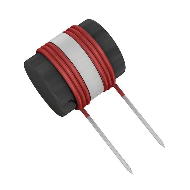

    插件,D28.6xL23.8mm
    FIXED IND 27UH 10A 18 MOHM TH

er w Po s or ct du In HCR HC SERIES High Current Filter Chokes Actual Size (Max.) NU MB ER IN * DU ±1 C 0% TAN CU @ CE R 1 ( MA RE kHz µH) XI NT ** M R DC UM AT ( IN MA RES Am G X. IST ps) ( A IN OHM NC CR E CU EM S) RR EN EN TA T L (A MP S) *** Current Rating based on continuous operation at room temperature ambient. Derating is required at elevated ambient temperatures in accordance with the derating curve. For more detailed graphs, contact factory DIMENSIONS Inches [Millimeters] A (Max.) B (Max.) PA RT 3HC-5 3HC-10 3HC-27 3HC-50 3HC-100 3HC-150 3HC-200 3HC-250 3HC-500 5HC-5 5HC-10 5HC-27 5HC-50 5HC-68 5HC-100 5HC-150 5HC-250 10HC-5 10HC-10 10HC-15 10HC-27 10HC-50 10HC-68 10HC-100 15HC-5 15HC-10 15HC-27 15HC-50 15HC-100 5 10 27 50 100 150 200 250 500 5 10 27 50 68 100 150 250 5 10 15 27 50 68 100 5 10 27 50 100 3 3 3 3 3 3 3 3 3 5 5 5 5 5 5 5 5 10 10 10 10 10 10 10 15 15 15 15 15 0.015 0.018 0.035 0.050 0.065 0.075 0.080 0.090 0.130 0.012 0.015 0.025 0.030 0.035 0.050 0.060 0.075 0.010 0.012 0.015 0.018 0.025 0.027 0.030 0.008 0.010 0.015 0.020 0.030 SERIES HC FERRITE 19 0.875 [22.23] 17 1.125 [28.58] 15 0.875 [22.23] 12 1.125 [28.58] 8 1.125 [28.58] 5 1.375 [34.93] 4 1.625 [41.28] 3 1.625 [41.28] 1 1.625 [41.28] 20 0.875 [22.23] 18 1.125 [28.58] 15 0.875 [22.23] 10 1.125 [28.58] 9 1.125 [28.58] 7 1.375 [34.93] 5 1.625 [41.28] 1.625 [41.28] 3 1.125 [28.58] 19 1.375 [34.93] 17 1.625 [41.28] 16 1.125 [28.58] 15 1.375 [34.93] 9 1.375 [34.93] 9 1.625 [41.28] 6 1.375 [34.93] 20 1.687 [42.85] 17 1.375 [34.93] 14 1.625 [41.28] 9 1.625 [41.28] 5 C D ± 0.062 inches ± 0.005 inches [± 1.59mm] [± 0.13mm] CORE 0.625 [15.88] 0.625 [15.88] 0.812 [20.62] 0.812 [20.62] 0.812 [20.62] 0.812 [20.62] 0.812 [20.62] 0.812 [20.62] 0.950 [24.13] 0.640 [16.26] 0.640 [16.26] 0.875 [22.23] 0.875 [22.23] 0.875 [22.23] 0.875 [22.23] 0.875 [22.23] 1.100 [27.94] 0.687 [17.45] 0.687 [17.45] 0.687 [17.45] 0.937 [23.80] 0.937 [23.80] 0.937 [23.80] 0.937 [23.80] 0.725 [18.42] 0.725 [18.42] 1.000 [25.40] 1.000 [25.40] 1.500 [38.10] 0.500 [12.70] 0.687 [17.45] 0.437 [11.10] 0.750 [19.05] 0.937 [23.80] 1.062 [26.97] 1.050 [26.67] 1.312 [33.32] 0.990 [25.15] 0.750 [19.05] 1.000 [25.40] 0.562 [14.27] 0.750 [19.05] 0.875 [22.23] 1.000 [25.40] 1.250 [31.75] 0.900 [22.86] 0.812 [20.62] 1.218 [30.94] 1.415 [35.94] 0.687 [17.45] 0.937 [23.80] 1.125 [28.58] 1.312 [33.32] 0.937 [23.80] 1.500 [38.10] 0.937 [23.80] 1.125 [28.58] 1.312 [33.32] 0.042 [1.07] 0.042 [1.07] 0.042 [1.07] 0.042 [1.07] 0.042 [1.07] 0.042 [1.07] 0.042 [1.07] 0.042 [1.07] 0.042 [1.07] 0.053 [1.35] 0.053 [1.35] 0.053 [1.35] 0.053 [1.35] 0.053 [1.35] 0.053 [1.35] 0.053 [1.35] 0.053 [1.35] 0.065 [1.65] 0.065 [1.65] 0.065 [1.65] 0.065 [1.65] 0.065 [1.65] 0.065 [1.65] 0.065 [1.65] 0.082 [2.08] 0.082 [2.08] 0.082 [2.08] 0.082 [2.08] 0.082 [2.08] Dimension E 1.0 inches ± 1⁄16 inches; 25.4mm ± 1.59mm Notes ** Inductance measured with zero DC current. *** Incremental current reduces inductance by 10% or less. Average current must not exceed specified rated current. Packaging Bulk only *Complete part # must include series # PLUS the dash # 270 Quaker Rd., East Aurora NY 14052 • Phone 716-652-3600 • Fax 716-652-4814 • E-mail: apisales@delevan.com • www.delevan.com 9/2021

1. 物料型号:文档列出了多个型号,如3HC-5, 3HC-10, 3HC-27, 3HC-50, 3HC-100, 3HC-150, 3HC-200, 3HC-250, 3HC-500, 5HC-5, 5HC-10, 5HC-27, 5HC-50, 5HC-68, 5HC-100, 5HC-150, 5HC-250, 10HC-5, 10HC-10, 10HC-15, 10HC-27, 10HC-50, 10HC-68, 10HC-100, 15HC-10, 15HC-5, 15HC-27, 15HC-50, 15HC-100。
2. 器件简介:文档描述了HCR系列的高电流滤波器电感器,它们是RoHS系列的一部分。
3. 引脚分配:文档中没有提供具体的引脚分配信息,但通常这类电感器会有至少两个引脚用于连接电路。
4. 参数特性: - 尺寸:提供了最大尺寸限制。 - 额定电流与温度的关系:提供了一个图表,显示了在不同环境温度下的电流额定值。 - 电感值:列出了不同型号的电感值,单位为微亨(µH),并注明了±10%的公差。 - 增量电流:增量电流会使得电感值降低10%或更少。 - DC电阻:列出了最大直流电阻值。 - 电流额定值:列出了不同型号的最大电流额定值。
5. 功能详解:文档中没有提供详细的功能解释,但可以推断这些电感器用于高电流滤波和电磁干扰(EMI)抑制。
6. 应用信息:文档没有明确列出应用信息,但通常这类电感器用于电源管理、电源转换和滤波电路。
7. 封装信息:提供了封装的尺寸信息,包括最大尺寸限制。
