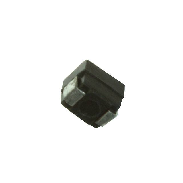

    固定电感器 1210 68nH ±10% 580mA 360mΩ 700MHz 30@50MHz
1210R-680K 数据手册
F R NG TI ) RA A T (m EN UM RR IM CE CU AX M AN ) ST S SI HM RE (O M DC MU )** XI Hz MA (M M MU NI ) MI Hz F (M SR Y NC UE M EQ MU FR NI MI ST Q TE E NC RA LE TO Surface Mount Inductors Actual Size Physical Parameters Inches Millimeters A 0.118 to 0.138 3.00 to 3.51 B 0.085 to 0.105 2.16 to 2.67 C 0.081 to 0.101 2.06 to 2.57 D 0.016 (Min.) 0.41 (Min.) E 0.041 to 0.061 1.04 to 1.55 F 0.070 (Ref. only) 1.78 (Ref. only) G 0.054 (Ref. only) 1.37 (Ref. only) Dimensions “A” and “C” are over terminals Weight Max. (Grams) 0.1 Operating Temperature Range –55°C to +125°C Current Rating at 90°C Ambient 35°C Rise Maximum Power Dissipation at 90°C Ambient Phenolic: 0.168 W Iron: 0.287 W Ferrite: 0.287 W **Note Self Resonant Frequency (SRF) values are calculated and for reference only. Marking Delevan; dash number; date code (YYWWL). Note: An R before the date code indicates a RoHS component. Example: 1210-018M DELEVAN 018 1822C Packaging Tape & reel (8mm): 7" reel, 2000 pieces max.; 13" reel, 7000 pieces max. Made In the U.S.A. Optional Tolerances: J = 5% H = 3% G = 2% F = 1% -018M -022M -027M -033M -039M -047M -056M -068M -082M -100K -120K -150K -180K -220K -270K -330K -390K -470K -560K -680K -820K 0.0018 0.0022 0.0027 0.0033 0.0039 0.0047 0.0056 0.0068 0.0082 0.010 0.012 0.015 0.018 0.022 0.027 0.033 0.039 0.047 0.056 0.068 0.082 -101K -121K -151K -181K -221K -271K -331K -391K -471K -561K -681K -821K 0.10 0.12 0.15 0.18 0.22 0.27 0.33 0.39 0.47 0.56 0.68 0.82 -102J -122J -152J -182J -222J -272J -332J -392J -472J -562J -682J -822J -103J -123J -153J -183J -223J -273J -333J -393J -473J -563J -683J -823J -104J 1.0 1.2 1.5 1.8 2.2 2.7 3.3 3.9 4.7 5.6 6.8 8.2 10 12 15 18 22 27 33 39 47 56 68 82 100 SERIES 1210 PHENOLIC CORE 2700** ± 20% 40 50.0 2700** ± 20% 40 50.0 2700** ± 20% 40 50.0 2700** ± 20% 40 50.0 2700** ± 20% 40 50.0 2700** ± 20% 40 50.0 2700** ± 20% 40 50.0 2700** ± 20% 40 50.0 2700** ± 20% 40 50.0 2000** ± 10% 30 50.0 1850** ± 10% 30 50.0 1700** ± 10% 30 50.0 1550** ± 10% 30 50.0 1300** ± 10% 30 50.0 1150** ± 10% 30 50.0 1000** ± 10% 30 50.0 900** ± 10% 30 50.0 800** ± 10% 30 50.0 750** ± 10% 30 50.0 700** ± 10% 30 50.0 625** ± 10% 30 50.0 SERIES 1210 IRON CORE 550 ± 10% 30 25.0 500 ± 10% 30 25.0 450 ± 10% 30 25.0 400 ± 10% 30 25.0 350 ± 10% 30 25.0 320 ± 10% 30 25.0 300 ± 10% 30 25.0 250 ± 10% 30 25.0 220 ± 10% 30 25.0 180 ± 10% 30 25.0 160 ± 10% 30 25.0 140 ± 10% 30 25.0 SERIES 1210 FERRITE CORE 120 ± 5% 30 7.9 100 ± 5% 30 7.9 85 ± 5% 30 7.9 75 ± 5% 30 7.9 70 ± 5% 30 7.9 65 ± 5% 30 7.9 58 ± 5% 30 7.9 50 ± 5% 30 7.9 45 ± 5% 30 7.9 42 ± 5% 30 7.9 40 ± 5% 30 7.9 35 ± 5% 30 7.9 30 ± 5% 30 7.9 28 ± 5% 30 2.5 25 ± 5% 30 2.5 23 ± 5% 30 2.5 20 ± 5% 30 2.5 18 ± 5% 30 2.5 15 ± 5% 30 2.5 14 ± 5% 30 2.5 13 ± 5% 30 2.5 11 ± 5% 30 2.5 10 ± 5% 30 2.5 9 ± 5% 30 2.5 8 ± 5% 30 2.5 s or ct du In E MB NU H) (µ CE AN CT DU IN R* 1210R 1210 SH DA SERIES 0.050 0.050 0.050 0.050 0.050 0.050 0.050 0.050 0.050 0.13 0.14 0.16 0.18 0.20 0.22 0.24 0.27 0.30 0.33 0.36 0.40 1562 1562 1562 1562 1562 1562 1562 1562 1562 966 931 871 821 779 743 711 670 636 606 580 551 0.20 0.22 0.25 0.28 0.32 0.36 0.40 0.45 0.50 0.55 0.60 0.67 1018 971 910 860 805 759 720 679 644 614 588 556 0.70 0.75 0.85 0.90 1.0 1.1 1.2 1.3 1.5 1.6 1.8 2.0 2.1 2.5 2.8 3.3 3.7 5.0 5.6 6.4 7.0 8.0 9.0 10.0 13.0 515 497 467 454 431 411 393 378 352 341 321 305 297 272 257 237 224 193 182 170 163 152 144 136 120 *Complete part # must include series # PLUS the dash # 270 Quaker Rd., East Aurora NY 14052 • Phone 716-652-3600 • Fax 716-652-4814 • E-mail: apisales@delevan.com • www.delevan.com 8/2021
1210R-680K
物料型号:AI2S 1210系列,包括不同的电感值和公差等级。
器件简介:文档描述了RoHS兼容的射频电感器,具有不同的自谐振频率(SRF)和直流电阻。
引脚分配:尺寸参数以英寸和毫米为单位提供,包括电感器的实际尺寸和重量。
参数特性:列出了不同型号的电感器的电感值、公差、直流电阻、电流额定值、自谐振频率和功率耗散。
功能详解:提供了电感器的物理参数和操作温度范围,以及在特定环境温度上升时的电流额定值和最大功率耗散。
应用信息:文档中没有明确提供应用信息,但通常这类电感器用于射频电路和电源管理。
封装信息:提供了封装的详细信息,包括尺寸和重量,以及包装选项,如胶带和卷轴。
