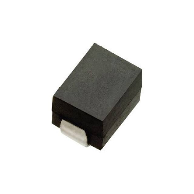

    固定电感器 SMD-2 150nH ±2% 1.23A 100mΩ 600MHz 38@25MHz
1330R-00G 数据手册
0.10 0.12 0.15 0.18 0.22 0.27 0.33 0.39 0.47 0.56 0.68 0.82 1.00 -22K -24K -26K -28K -30K -32K -34K -36K -38K -40K -42K -44K -46K -48K -50K -52K -54K 1.20 1.50 1.80 2.20 2.70 3.30 3.90 4.70 5.60 6.80 8.20 10.00 12.0 15.0 18.0 22.0 27.0 Weight Max (Grams) 0.30 Operating Temperature Range Phenolic: –55°C to +125°C Iron and Ferrite: –55°C to +105°C Current Rating at 90°C Ambient Phenolic: 35°C Rise Iron and Ferrite: 15°C Rise Maximum Power Dissipation at 90°C Ambient Phenolic: 0.210 W Iron: 0.090 W Ferrite: 0.073 W Marking Delevan; dash number; date code (YYWWL). Note: An R before the date code indicates a RoHS component. Example: 1330-42K DELEVAN 42 1818A Packaging Tape & reel (16mm): 7" reel, 500 pieces max.; 13" reel, 2200 pieces max. 33.0 39.0 47.0 56.0 68.0 82.0 100.0 120.0 150.0 180.0 220.0 270.0 330.0 390.0 470.0 560.0 680.0 820.0 1000.0 SERIES 1330 PHENOLIC CORE 40 25.0 680.0 40 25.0 640.0 38 25.0 600.0 35 25.0 550.0 33 25.0 510.0 33 25.0 430.0 30 25.0 410.0 30 25.0 365.0 30 25.0 330.0 30 25.0 300.0 28 25.0 275.0 28 25.0 250.0 25 25.0 230.0 SERIES 25 28 30 30 37 45 45 45 50 50 55 55 45 45 45 45 45 1330 IRON CORE 7.9 150.0 7.9 140.0 7.9 125.0 7.9 115.0 7.9 100.0 7.9 90.0 7.9 80.0 7.9 75.0 7.9 65.0 7.9 60.0 7.9 55.0 7.9 50.0 2.5 40.0 2.5 35.0 2.5 30.0 2.5 25.0 2.5 20.0 SERIES 1330 FERRITE CORE 35 2.5 24.0 35 2.5 22.0 35 2.5 20.0 35 2.5 18.0 35 2.5 15.0 35 2.5 14.0 35 2.5 13.0 30 0.79 12.0 30 0.79 11.0 30 0.79 10.0 30 0.79 9.0 30 0.79 8.0 30 0.79 7.0 30 0.79 6.5 30 0.79 6.0 30 0.79 5.0 30 0.79 4.2 30 0.79 3.8 30 0.79 3.4 0.08 0.09 0.10 0.12 0.14 0.16 0.22 0.30 0.35 0.50 0.60 0.85 1.00 1380 1300 1230 1120 1040 975 830 710 660 550 500 420 390 0.18 0.22 0.30 0.40 0.55 0.85 1.00 1.20 1.80 2.00 2.70 3.30 2.70 2.80 3.10 3.30 3.50 620 560 480 415 355 285 263 239 195 185 160 144 160 157 149 144 140 3.40 3.60 4.50 5.70 6.70 7.30 8.00 13.00 15.00 17.00 21.00 25.00 28.00 35.00 42.00 46.00 60.00 65.00 72.00 130 125 110 100 92 88 84 66 61 57 52 47 45 40 36 35 30 29 28 s or ct du In -94K -96K -00K -02K -04K -06K -08K -10K -12K -14K -16K -18K -20K -56K -58K -60K -62K -64K -66K -68K -70K -72K -74K -76K -78K -80K -82K -84K -86K -88K -90K -92K F R Millimeters 7.62 to 8.26 2.67 to 3.18 3.18 to 3.68 0.508 Min. 1.02 to 1.52 4.83 (Ref. only) 1.78 (Ref. only) NG TI ) RA A T (m EN UM RR M I CU AX M CE AN ) ST S SI HM RE (O M DC U M XI ) MA Hz (M M MU NI MI F ) SR Hz (M Y NC UE EQ M FR MU NI MI Physical Parameters Inches A 0.300 to 0.325 B 0.105 to 0.125 C 0.125 to 0.145 D 0.020 Min. E 0.040 to 0.060 F 0.190 (Ref. only) G 0.070 (Ref. only) Q Actual Size ST TE Unshielded Surface Mount Inductors 0% ±1 H) (µ CE AN * CT ER DU MB IN NU 1330R 1330 SH DA SERIES Optional Tolerances: J = 5% H = 3% G = 2% F = 1% *Complete part # must include series # PLUS the dash # Made In the U.S.A. 270 Quaker Rd., East Aurora NY 14052 • Phone 716-652-3600 • Fax 716-652-4814 • E-mail: apisales@delevan.com • www.delevan.com 8/2021

物料型号:1330R
器件简介:该系列电感器是无屏蔽表面贴装电感器。
引脚分配:文档未明确提供引脚分配信息。
参数特性: - 尺寸参数以英寸和毫米为单位列出,包括A至G的不同尺寸。 - 重量最大为0.30克。 - 工作温度范围根据材料不同而有所差异,酚醛:-55°C至+125°C,铁和铁氧体:-55°C至+105°C。 - 在90°C环境温度下,不同材料的电流额定值随温度上升而变化。
功能详解:文档列出了不同型号的电感器,包括电感值、品质因数(Q)、最小测试频率、自谐振频率(SRF)、直流电阻、电流额定值等。
应用信息:文档未明确提供应用信息
封装信息:提供了封装的物理参数和重量信息。
