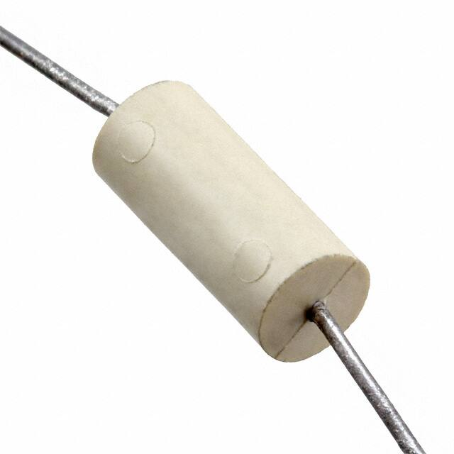

    固定电感器 Axial 1mH ±5% 88mA 16.5Ω 2.8MHz 60@790KHz
2500-28J 数据手册
F R ZE SI LD MO ING T ) RA A T (m EN UM RR IM CE CU AX AN ) M ST S SI HM RE M (O DC MU ) Hz XI (M MA M MU NI ) MI F Hz SR (M Y NC UE M EQ MU FR NI MI ST Q TE % ±5 H) (µ CE # AN SH CT DA DU L IN MI R* L I TA R Y PP ROVE D Molded Unshielded RF Coils Actual Size (Mold Size B) Military Specifications MS90539 (LT10K); MS90540 (LT10K); MS90541 (LT10K); g No MS # Issued Physical Parameters Mold Size A Length Inches ± .010 0.440 mm ± .25 11.18 Diameter Inches ± .010 0.190 mm ± .25 4.83 Lead Type & Size AWG # #22 TCW ± .002 Inches 0.025 [TCW ± .051 mm] 0.635 Lead Length Inches ± .12 1.44 mm ± 3.05 36.58 Maximum Power Dissipation at 90°C W 0.166 Weight Max. (Grams) 0.95 B C 0.560 14.22 0.740 18.80 0.215 5.46 0.240 6.10 #21 0.028 0.711 #20 0.032 0.813 1.44 36.58 1.44 36.58 0.182 0.213 1.5 2.5 Current Rating at 90°C Ambient 15°C Rise Operating Temperature Range –55°C to +105°C Core Material Iron (LT10K) Marking DELEVAN; inductance with units and tolerance; date code (YYWWL). Note: An R before the date code indicates a RoHS component. Example: 2500-16J Front: Reverse: DELEVAN 560uH±5% 560uH±5% 0824C s or ct du In MI A E MB NU 2500R 2500 SH DA SERIES -00J -02J -04J -06J -08J -10J -12J -14J -15J -16J -18J -20J -22J -24J -26J -28J MS90539 • SERIES 2500 IRON CORE 1 270 65 0.790 5.60 2 300 65 0.790 5.3 3 330 65 0.790 5.0 4 360 65 0.790 4.7 5 390 65 0.790 4.5 6 430 65 0.790 4.3 7 470 65 0.790 4.0 g 500 65 0.790 3.7 8 510 65 0.790 3.8 9 560 65 0.790 3.6 10 620 60 0.790 3.5 11 680 60 0.790 3.4 12 750 60 0.790 3.3 13 820 60 0.790 3.1 14 910 60 0.790 2.9 15 1000 60 0.790 2.8 (LT10K) 8.2 8.7 9.1 9.6 10.0 10.6 11.0 11.3 11.6 12.3 13.0 13.7 14.4 15.1 15.8 16.5 126 122 120 115 114 111 108 106 105 104 101 97 95 92 91 88 A A A A A A A A A A A A A A A A -30J -32J -34J -36J -38J -40J -42J -44J -46J -48J -50J -52J -54J MS90540 • SERIES 2500 IRON CORE 1 1100 60 0.250 2.8 2 1200 60 0.250 2.7 3 1300 60 0.250 2.6 4 1500 65 0.250 2.4 5 1600 65 0.250 2.3 6 1800 65 0.250 2.2 7 2000 65 0.250 2.1 8 2200 70 0.250 2.0 9 2400 70 0.250 1.9 10 2700 70 0.250 1.8 11 3000 70 0.250 1.7 12 3300 70 0.250 1.6 13 3600 70 0.250 1.5 (LT10K) 21.0 22.0 23.0 25.0 26.0 28.0 29.0 30.0 31.0 33.0 35.0 38.0 40.0 81 79 78 76 74 71 69 68 67 65 63 61 59 B B B B B B B B B B B B B -56J -58J -60J -62J -63J -64J -66J -68J -70J -72J -74J -76J MS90541 • SERIES 2500 IRON CORE 1 3900 80 0.250 1.45 2 4300 80 0.250 1.40 3 4700 80 0.250 1.35 4 5000 80 0.250 1.30 g 5100 80 0.250 1.30 5 5600 80 0.250 1.25 6 6200 80 0.250 1.20 7 6800 80 0.250 1.15 8 7500 80 0.250 1.10 9 8200 80 0.250 1.05 10 9100 80 0.250 1.0 11 10000 80 0.250 0.95 (LT10K) 44.0 46.0 48.0 50.0 50.0 53.0 56.0 59.0 62.0 65.0 68.0 72.0 62 60 59 58 58 56 55 54 52 51 49 48 C C C C C C C C C C C C Parts listed above are QPL/MIL qualified Optional Tolerances: H = 3% G = 2% F = 1% *Complete part # must include series # PLUS the dash # Packaging Tape & reel: Mold sizes "A" and "C": 12" reel, 2500 pieces max.; 14" reel, 3000 pieces max. Mold size "B": 12" reel, 1000 pieces max.; 14" reel, 1500 pieces max. Made in the U.S.A. 270 Quaker Rd., East Aurora NY 14052 • Phone 716-652-3600 • Fax 716-652-4814 • E-mail: apisales@delevan.com • www.delevan.com 8/2021
