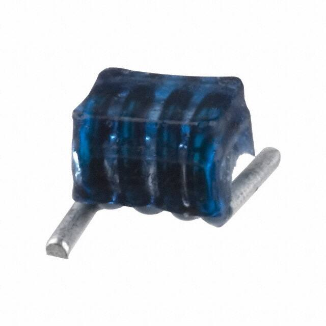

    固定电感器 Nonstandard 2.5nH ±10% 3A 3GHz 145@150MHz
4426R-1 数据手册
F R 1 2 3 4 5 6 7 8 9 11 DE CO ZE SI NG TI ) RA s T mp EN (A RR UM CU XIM n. Mi MA z, GH F SR ) Hz (M Y NC UE EQ n. FR Mi Q R* -1 -2 -3 -4 -5 -6 -7 -8 -9 -10 s or ct du In ST TE H) (n CE AN CT .) DU ef IN (R E MB NU Air Core Inductors S RN TU 4426R 4426 SH DA SERIES 2.5±10% 5.0±10% 8.0±5% 12.5±5% 18.5±5% 17.5±5% 22.0±5% 28.0±5% 35.5±5% 43.0±5% SERIES 145 140 140 137 132 100 102 105 112 106 4426 150 150 150 150 150 150 150 150 150 150 >3 >3 >3 >3 >3 >3 >3 2.6 1.8 1.5 3.0 3.0 3.0 3.0 3.0 3.0 3.0 3.0 3.0 3.0 A A A A A B B B B B *Complete part # must include series # PLUS the dash # Actual Size Size A in. A Max 0.120 B Max 0.125 C Max 0.145 D 0.115±.010 E 0.05±.015 F 0.165 G 0.110 H 0.130 I 0.050 J 0.065 Size A mm 3.05 3.18 3.68 2.92±.25 1.27±.38 4.19 2.79 3.30 1.27 1.65 Size B in. in. 0.120 0.125 0.270 0.230±.010 0.05±.015 0.285 0.110 0.130 0.050 0.185 Size B mm 3.05 3.18 6.86r 5.84±.25 1.27±.38 7.23 2.79 3.30 1.27 4.69 High Q, wire wound air cores Designed to operate over a wide frequency range. Standard flat cap top is suitable for automatic placement. *Ordering Suffix the dash number with RC to order optional water dissolvable flat top cap for applications requiring hand adjustment. The cap allows the part to be pick and placed onto the PCB, and will dissolve in almost all board cleaning solvents, leaving no residue. Suffix the dash number with NC to order option with no cap, for manual placement. Operating Temperature Range –55°C to +125°C Packaging Tape & reel Size A, (12mm): 7" reel, 650 pieces max.; 13" reel, 2500 pieces max.; Size B, (16mm): 7" reel, 400 pieces max.; 13" reel, 1400 pieces max. 270 Quaker Rd., East Aurora NY 14052 • Phone 716-652-3600 • Fax 716-652-4814 • E-mail: apisales@delevan.com • www.delevan.com 8/2021
