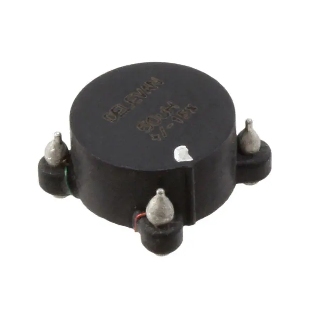

    去耦电感 Nonstandard ±15% 1.212Ω
4448R-128L 数据手册
Actual Size Test Methods Solderability per MIL-STD-202, Method 208. Inductance tested at 10 kHz and zero Amp DC. Tested at 25°C Mechanical Configuration A flat top surface mount case with excellent coplanarity of terminals. Millimeters 9.91 to 10.41 13.21 to 13.71 2.92 to 3.43 12.19 to 12.70 7.87 Max. 0.51 to 1.02 1.52 (Ref. only) Electrical Configuration Two inductors per unit; internal terminals: #1(start) – #2(finish) & #4(start) – #3 (finish). Series Externally connect #2 to #4. Parallel Externally connect #1 to # 4 and # 2 to # 3. s or ct du In er w Surface Mount High Current Power Toroids Physical Parameters Inches A 0.390 to 0.410 B 0.520 to 0.540 C 0.115 to 0.135 D 0.480 to 0.500 E 0.310 Max. F 0.020 to 0.040 G 0.060 (Ref. only) Po CE AN ) ST S SI HM RE (O M DC DC MU ES ) ES XI RI PS RI A SE M SE M D (A TE UM E RA XIM NC RA MA T LE EN TO ES RI ) RR SE µH CU ( DC E S C N . MP TA ST SI ) 0 ADUC RE MS IN DC H O ( EL M LL MU DC RA XI EL M PA MA LL MU RA XI PA A D TM E TE EN NC RA RR RA LE CU L TO LLE ) RA µH PA CE ( DC N S TA R* BE MP UC 0 A IND NUM H 4448R 4448 S DA SERIES -02M -04M -06M -08M -10M -12M -14L -16L -18L -20L -22L -24L -26L -28L -30L -32L -34L 0.47 0.68 1.00 2.00 5.00 8.00 10.0 15.0 20.0 25.0 33.0 50.0 68.0 100 150 200 300 SERIES 4448 POWDERED IRON CORE ± 20% 7.90 0.005 2.00 ± 20% ± 20% 7.20 0.006 3.00 ± 20% ± 20% 5.90 0.009 4.00 ± 20% ± 20% 4.60 0.014 8.00 ± 20% ± 20% 3.30 0.027 20.0 ± 20% ± 20% 3.00 0.033 32.0 ± 20% ± 15% 2.50 0.047 40.0 ± 15% ± 15% 2.30 0.057 60.0 ± 15% ± 15% 1.90 0.085 80.0 ± 15% ± 15% 1.60 0.116 100 ± 15% ± 15% 1.30 0.166 132 ± 15% ± 15% 1.20 0.202 200 ± 15% ± 15% 1.10 0.238 272 ± 15% ± 15% 0.72 0.565 400 ± 15% ± 15% 0.64 0.696 600 ± 15% ± 15% 0.60 0.810 800 ± 15% ± 15% 0.54 1.003 1200 ± 15% 3.95 3.60 2.95 2.30 1.65 1.50 1.25 1.15 0.95 0.80 0.65 0.60 0.55 0.36 0.32 0.30 0.27 0.020 0.024 0.036 0.056 0.108 0.132 0.188 0.228 0.340 0.464 0.664 0.808 0.952 2.260 2.784 3.240 4.012 -102M -104M -106M -108M -110M -112M -114L -116L -118L -120L -122L -124L -126L -128L -130L -132L -134L 0.47 0.68 1.00 2.00 5.00 8.00 10.0 15.0 20.0 25.0 33.0 50.0 68.0 100 150 200 300 SERIES 4448 FERROUS ALLOY CORE ± 20% 7.90 0.004 2.00 ± 20% ± 20% 7.00 0.005 3.00 ± 20% ± 20% 6.50 0.006 4.00 ± 20% ± 20% 5.90 0.007 8.00 ± 20% ± 20% 4.40 0.014 20.0 ± 20% ± 20% 3.50 0.019 32.0 ± 20% ± 15% 3.40 0.020 40.0 ± 15% ± 15% 3.00 0.024 60.0 ± 15% ± 15% 2.10 0.055 80.0 ± 15% ± 15% 2.00 0.064 100 ± 15% ± 15% 1.80 0.072 132 ± 15% ± 15% 1.50 0.111 200 ± 15% ± 15% 1.20 0.158 272 ± 15% ± 15% 0.92 0.303 400 ± 15% ± 15% 0.82 0.372 600 ± 15% ± 15% 0.64 0.545 800 ± 15% ± 15% 0.62 0.672 1200 ± 15% 3.95 3.50 3.25 2.95 2.20 1.75 1.70 1.50 1.05 1.00 0.90 0.75 0.60 0.46 0.41 0.32 0.31 0.016 0.020 0.024 0.028 0.056 0.076 0.080 0.096 0.220 0.254 0.288 0.444 0.632 1.212 1.488 2.180 2.688 *Complete part # must include series # PLUS the dash # Operating Temperature Range –55°C to +125°C Rated DC Current Based upon 20°C temperature rise from 25°C ambient. Maximum Power Dissipation at 25°C 0.313 Watts Inductance Tolerance Tolerance is specified by suffixing an alpha character to the part number as follows: K = 10%, L = 15%. M = 20%. Units are normally supplied to the tolerance indicated in the tables. Marking Delevan; inductance and tolerance. A white dot indicates the location of pin 1. Example: 4448-102M DELEVAN .47uH±20% Weight (Grams) 2.5 (Ref.) Inductance at Rated DC Current Minimum percent of measured zero Amp DC Inductance. -02M to -34L = 60%; -102M to134L = 50% Packaging Tape & reel (24mm): 13" reel, 350 pieces max.; 7" reel not available 270 Quaker Rd., East Aurora NY 14052 • Phone 716-652-3600 • Fax 716-652-4814 • E-mail: apisales@delevan.com • www.delevan.com 8/2021
4448R-128L
物料型号:4448R 4448,这是一款表面贴装高电流功率电感器。
器件简介:该电感器采用粉末铁芯或铁合金芯,具有高电流承载能力,适用于功率转换应用。
引脚分配:电感器有两个内部电感器,内部引脚分配为:#1(起始)- #2(结束)和#4(起始)- #3(结束)。外部连接方式有两种:串联和并联。串联时,#2连接到#4;并联时,#1连接到#4,#2连接到#3。
参数特性:电感值、直流电阻、额定直流电流、最大直流电流、电感公差等参数随不同型号而变化。例如,-02M型号的电感值为0.47μH,公差为±20%,额定直流电流为7.90A,最大直流电阻为0.020欧姆。
功能详解:电感器在电路中起到滤波、储能、抑制噪声等作用,有助于提高电源转换效率和稳定性。
应用信息:适用于高电流功率转换,如开关电源、电池充电器、LED照明等。
封装信息:电感器具有平坦的顶部表面贴装封装,具有优秀的端子共面性。封装尺寸和重量等物理参数也在文档中给出。
