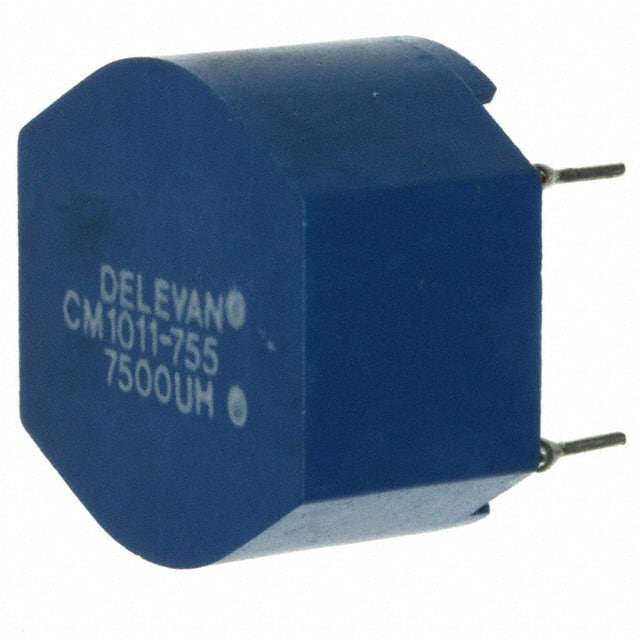

    COMMON MODE CHOKE 10A 2 LN T/H
CM1011-254 数据手册
PA RT Epoxy Potted Common Mode Chokes CM1011-104 CM1011-254 CM1011-504 CM1011-754 CM1011-105 CM1011-175 CM1011-255 CM1011-335 CM1011-505 CM1011-755 CM1011-106 100 250 500 750 1000 1700 2500 3300 5000 7500 10000 L (µ @ H), 1 K L1 Hz or L2 NU MB ER Series CM1011 Horizontal PC Mount 0.004 0.006 0.008 0.013 0.018 0.060 0.073 0.125 0.150 0.300 0.390 Physical Parameters Inches A 1.10 ± 0.03 B 1.10 ± 0.03 C 0.70 ± 0.03 D 1.00 ± 0.03 E 0.600 ± 0.03 F 0.200 Min. G 0.750 (Ref. Only) H 0.032 ± 0.004 Millimeters 27.9 ± 0.76 27.9 ± 0.76 17.8 ± 0.76 25.4 ± 0.76 15.2 ± 0.76 5.08 Min. 19.1 (Ref. Only) 0.81 ± 0.10 DC MA RES XI IST MU A M NC (O E hm CU s) RR MA E NT XI MU R M ATI (A NG LE m ps IN AKA ) DU G MA CT E XI AN MU CE M (µ H) 12 10 8.6 6.7 5.7 3.1 2.8 2.2 2.0 1.4 1.2 6 9 12 15 19 26 32 51 72 94 103 TRANSFORMERS Operating Temperature Range –55°C to +125°C Current Rating at 85°C Ambient 40°C Rise Mechanical Configuration Epoxy potted winding assembly. Case is high-temperature DAP. Notes 1) Inductance in table is for either L I or L2. 2) Leakage Inductance tested at L I with L2 shorted or at L2 with L I shorted. 3) Windings balanced within 2% Packaging Bulk only www.delevan.com E-mail: apisales@delevan.com 270 Quaker Rd., East Aurora NY 14052 • Phone 716-652-3600 • Fax 716-652-4814 PAGE 2/ 2002 129
