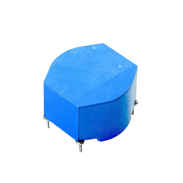

SERIES CM1011 FERRITE CORE 100 0.004 12 250 0.006 10 500 0.008 8.6 750 0.013 6.7 1000 0.018 5.7 1700 0.060 3.1 2500 0.073 2.8 3300 0.125 2.2 5000 0.150 2.0 7500 0.300 1.4 10000 0.390 1.2 s er -104 -254 -504 -754 -105 -175 -255 -335 -505 -755 -106 m or sf an Tr R* Actual Size E MB NU Horizontal PC Mount Epoxy Potted Common Mode Chokes CE AN ) CT (µH DU IN UM E IM AG AX AK M LE NG TI ) RA S T MP EN (A RR UM CU XIM MA CE AN ) ST S SI HM RE M (O DC U M XI MA 2 rL 1o % , L 25 H) ± (µ z L 1 kH @ CM1011R CM1011 SH DA SERIES 6 9 12 15 19 26 32 51 72 94 103 *Complete part # must include series # PLUS the dash # Marking DELEVAN; part number; inductance with units. Example: CM1011-104 DELEVAN CM1011-104 100uH Packaging Bulk only Weight (Grams) 25.0 (Ref.) Physical Parameters Inches A 1.10 ± 0.03 B 1.10 ± 0.03 C 0.70 ± 0.03 D 1.00 ± 0.03 E 0.600 ± 0.03 F 0.200 Min. G 0.075 (Ref. only) H 0.032 ± 0.004 Millimeters 27.9 ± 0.76 27.9 ± 0.76 17.8 ± 0.76 25.4 ± 0.76 15.2 ± 0.76 5.08 Min. 1.91 (Ref. only) 0.81 ± 0.10 Operating Temperature Range –55°C to +125°C Current Rating at 85°C Ambient 40°C Rise Mechanical Configuration Epoxy potted winding assembly. Case is high-temperature DAP. Notes 1) Inductance in table is for either L I or L2. 2) Leakage Inductance tested at L I with L2 shorted or at L2 with L I shorted. 3) Windings balanced within 2% 270 Quaker Rd., East Aurora NY 14052 • Phone 716-652-3600 • Fax 716-652-4814 • E-mail: apisales@delevan.com • www.delevan.com 9/2021
