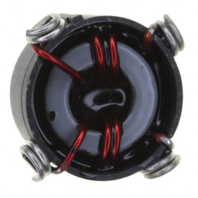

SERIES CM6296 FERRITE CORE 25 0.014 10.0 50 0.014 10.0 100 0.016 9.5 150 0.016 9.5 200 0.016 8.5 300 0.020 7.5 450 0.024 6.5 650 0.030 5.5 1000 0.050 3.5 1500 0.090 2.5 2500 0.162 2.2 s er R* -253 -503 -104 -154 -204 -304 -454 -654 -105 -155 -255 m or sf an Tr E MB NU Common Mode Choke/IsolationTransformer CE AN ) CT (µH DU L IN A E PIC AG TY AK LE T EN RR UM CU M S AXI RM M D S) TE P M RA (A CE AN ) ST S SI HM RE M (O DC MU XI MA CE AN ) CT (µH DU % IN 25 L2 ± or L1 CM6296R CM6296 SH DA SERIES 0.7 0.8 1.4 1.8 2.2 3.3 4.6 6.2 9.3 14.5 21.8 *Complete part # must include series # PLUS the dash # Actual Size Physical Parameters Inches A 1.058 ± 0.010 B 0.870 ± 0.010 C 0.210 Typ. D 0.200 Typ. E 0.430 Max. Millimeters 26.87 ± 0.25 22.10 ± 0.25 5.33 Typ. 5.08 Typ. 10.74 Max. Mechanical Configuration Flat top surface mount case with excellent coplanarity of terminals Operating Temperature –55°C to +125°C Configuration Two inductors per unit; internal terminals: #1 (start)-#2 (finish) & #4 (start) -#3 (finish) Electrical Configuration 1) Inductance and DCR in table is for either L1 or L2 2) Leakage Inductance tested at L1 with L2 shorted or at L2 with L1 shorted. 3) Windings balanced within 2% 4) Inductance tested @ 1.0kHz Marking DELEVAN; part number, inductance with units. A white dot indicates the location of pin 1. Example: CM6296R-155 DELEVAN CM6296R-155 1500 uH Packaging Bulk only Weight (Grams) 9.0 (Ref.) Rated RMS Current Per Winding Based Upon 20°C temperature rise from 25°C ambient Maximum Power Dissipation at 25°C 2.5 Watts Dielectric Withstanding Voltage 500 V RMS, 60Hz 270 Quaker Rd., East Aurora NY 14052 • Phone 716-652-3600 • Fax 716-652-4814 • E-mail: apisales@delevan.com • www.delevan.com 9/2021
CM6296-154
物料型号:CM6296R
器件简介:共模扼流圈/隔离变压器
引脚分配:两个电感器,内部端子配置为#1(起始)-#2(结束)和#4(起始)-#3(结束)
参数特性: - 漏感典型值:不同型号在2.2uH至21.8uH之间 - 额定RMS电流:不同型号在3.5A至10A之间 - DC电阻最大值:不同型号在0.7欧姆至14.5欧姆之间 - 物理尺寸:A(26.87±0.25mm)、B(22.10±0.25mm)、C(5.33mm典型值)、D(5.08mm典型值)、E(10.74mm最大值)
功能详解: - 电气配置:电感和直流电阻(DCR)表格适用于L1或L2 - 漏感测试:在L1上测试,L2短路,或在L2上测试,L1短路 - 绕组平衡度:在2%以内 - 电感测试频率:1.0kHz
应用信息: - 工作温度范围:-55°C至+125°C - 标记:DELEVAN; 部件编号,单位为微亨的电感。一个白点表示引脚1的位置
封装信息: - 机械配置:平面顶部表面安装,端子具有极好的共面性 - 包装:仅散装 - 重量:9.0克(参考)
其他信息: - 额定RMS电流:基于从25°C环境温度上升20°C - 最大功率耗散在25°C:2.5瓦特 - 介质耐压:500 V RMS,60Hz
制造商信息: - 地址:270 Quaker Rd., East Aurora NY 14052 - 电话:716-652-3600 - 传真:716-652-4814 - 电子邮件:apisales@delevan.com - 网站:www.delevan.com
