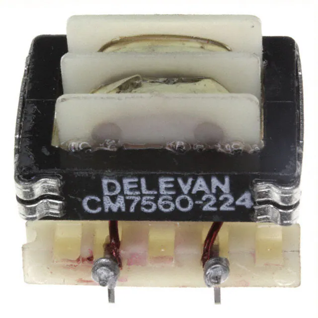

    COMMON MODE CHOKE 4.5A 2 LN T/H
CM7560-224 数据手册
SERIES CM7560 FERRITE CORE 56 0.013 5.5 68 0.013 5.5 82 0.013 5.5 100 0.013 5.5 120 0.015 5.5 150 0.015 5.5 180 0.019 4.5 220 0.020 4.5 270 0.025 4.5 330 0.025 3.5 470 0.030 3.5 560 0.035 3.5 680 0.040 3.5 820 0.060 2.8 1000 0.065 2.8 1200 0.095 2.2 1500 0.115 1.7 1800 0.125 1.7 2200 0.170 1.4 2700 0.180 1.4 3300 0.320 1.1 3900 0.400 1.1 4700 0.450 0.88 5600 0.500 0.88 6800 0.600 0.88 8200 0.750 0.88 10000 0.800 0.70 12000 0.900 0.70 15000 1.00 0.70 18000 1.30 0.55 22000 1.50 0.55 27000 1.80 0.44 33000 2.20 0.44 39000 2.60 0.44 47000 3.00 0.44 56000 4.00 0.35 68000 5.00 0.27 82000 5.50 0.27 100000 6.40 0.27 120000 7.80 0.22 150000 9.00 0.22 s er Millimeters 21.8 ± 0.64 27.2 ± 1.27 21.1 ± 0.76 26.9 (Ref. only) 1.0 ± 0.64 0.64 Sq. (Typ.) 10.2 ± 0.3 4.4 ± 0.38 26.2 (Ref. only) 10.2 ± 0.3 16.0 ± 0.3 -563 -683 -823 -104 -124 -154 -184 -224 -274 -334 -474 -564 -684 -824 -105 -125 -155 -185 -225 -275 -335 -395 -475 -565 -685 -825 -106 -126 -156 -186 -226 -276 -336 -396 -476 -566 -686 -826 -107 -127 -157 m or sf an Tr Physical Parameters Inches A 0.860 ± 0.025 B 1.070 ± 0.050 C 0.830 ± 0.030 D 1.060 (Ref. only) E 0.040 ± 0.025 F 0.025 Sq. (Typ.) G 0.400 ± 0.010 H 0.175 ± 0.015 J 1.03 (Ref. only) K 0.400 ± 0.010 L 0.630 + 0.010 CE AN ) CT (µH DU IN UM E IM AG AX AK M LE NG TI ) RA S T MP EN (A RR UM CU XIM MA CE AN ) ST S SI HM RE M (O DC MU XI MA 2 rL 1o % , L 25 H) ± (µ z L 1 kH @ Actual Size R* PC Mount Common Mode Choke E MB NU CM7560R CM7560 SH DA SERIES 3.5 3.5 3.5 3.5 4.5 6.0 7.0 7.5 9.0 12 14 18 20 24 30 35 40 45 55 75 90 100 130 175 220 230 250 300 350 425 475 550 650 800 900 1100 1300 1800 2100 2600 3000 *Complete part # must include series # PLUS the dash # Marking DELEVAN; part number. Operating Temperature Range –55°C to +125°C Example: CM7560-563 DELEVAN CM7560-563 Current Rating at 85°C Ambient 40°C Rise Packaging Bulk only Mechanical Configuration Tape wrapped winding sections; varnish impregnated assembly Notes 1) Inductance in table is for either Ll or L2. 2) Leakage Inductance tested at Ll with L2 shorted or at L2 with Ll shorted. 3) Windings balanced within 1%. 270 Quaker Rd., East Aurora NY 14052 • Phone 716-652-3600 • Fax 716-652-4814 • E-mail: apisales@delevan.com • www.delevan.com 9/2021
CM7560-224
物料型号:CM7560R CM7560
器件简介:RoHS兼容的PC安装共模扼流圈。
引脚分配:文档中没有提供引脚分配信息。
参数特性: - 尺寸参数:A至G的尺寸数据,包括英寸和毫米。 - 工作温度范围:-55°C至+125°C。 - 电流额定值:在85°C环境温度下,温度上升40°C时的电流额定值。 - 机械配置:胶带包裹的绕组部分;浸渍漆的组装。
功能详解: - 共模扼流圈的电感值,包括L1或L2在1kHz时的电感值,以及漏电感和直流电阻的最大值。
应用信息:文档中没有提供应用信息
封装信息:提供了实际尺寸的物理参数,包括英寸和毫米。
注意: 1. 表中的电感值适用于L1或L2。 2. 漏电感在L1短路L2或L2短路L1时测试。 3. 绕组平衡在1%以内。
产品系列包括不同型号的CM7560 FERRITE CORE,具有不同的电感值、电流额定值和尺寸。
包装信息:仅散装。
制造商信息:API Delevan,提供了联系地址、电话、传真和电子邮件信息。
