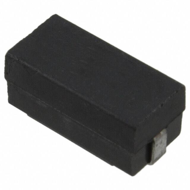

    固定电感器 Nonstandard 3.3µH ±15% 3.23A 38mΩ
M27/367-15 数据手册
er w Po L I TA R Y ROVE D Operating Temperature Range –55°C to +130°C Current Rating at 85°C Ambient 45°C Rise Maximum Power Dissipation at 85°C 0.55 W Inductance Measured at 1 VAC open circuit with no DC current Incremental Current The current at which the inductance will decrease by a maximum of 5% from its initial DC value Lead Finish Sn63 Pb37 (Tin-Lead), Hot Solder Dipped Weight 1.5 grams MAX DMV 1000 Vrms at Sea Level 500 Vrms at 70,000 feet altitude IR 1000 Mohms MIN at 500 Vdc Vibration MIL-STD-202, Method 204, Test Condition D Moisture Resistance MIL-STD-202, Method 106 Bond Strength Force 2 lbs. Marking Military PIN (Part or Identifying Number) API Delevan Part Number API Delevan Cage Code Date/Lot Code (YYWWL) Marking Example M27/367-38T MIL4922-30LT 99800 1328A Packaging Tape & reel (24mm): 13" reel, 800 pieces max.; 7" reel not available Made In the U.S.A. SH DA Military QPL Approval M27/367 T Level, Grade 5, encapsulted Level T Magnetics are 100% Tested per MIL-PRF-27 Group A Subgroup I which includes: 1) Thermal Shock, 25 cycles 2) Burn In, 96 hours 3) Radiographic (X-Ray) Inspection L MI Physical Parameters Inches Millimeters A 0.490 to 0.520 12.44 to 13.21 B 0.230 to 0.250 5.84 to 6.35 C 0.210 to 0.230 5.33 to 5.84 D 0.050 Min. 1.27 Min. E 0.055 to .075 1.40 to 1.91 F 0.330 (Ref. only) 8.38 (Ref. only) G 0.120 (Ref. only) 3.04 (Ref. only) Dimensions “A” and “C” are over terminals R* Actual Size E MB NU MIL-PRF-27/367, T Level Qualified Surface Mount Power Inductors M27/367 - SERIES MIL4922 T LEVEL FERRITE CORE -01T 0.22 0.0080 7.00 -221LT -02T 0.27 0.0085 6.75 -271LT -03T 0.33 0.0090 6.50 -331LT -04T 0.39 0.0095 6.25 -391LT -05T 0.47 0.0100 6.00 -471LT -06T 0.56 0.0105 5.80 -561LT -07T 0.68 0.0110 5.70 -681LT -08T 0.82 0.0120 5.60 -821LT -09T 1.00 0.013 5.50 -01LT -10T 1.20 0.018 4.69 -02LT -11T 1.50 0.020 4.45 -03LT -12T 1.80 0.021 4.34 -04LT -13T 2.20 0.029 3.70 -05LT -14T 2.70 0.034 3.41 -06LT -15T 3.30 0.038 3.23 -07LT -16T 3.90 0.042 3.07 -08LT -17T 4.70 0.047 2.90 -09LT -18T 5.60 0.051 2.79 -10LT -19T 6.80 0.058 2.61 -11LT -20T 8.20 0.063 2.51 -12LT -21T 10.0 0.071 2.36 -13LT -22T 12.0 0.079 2.24 -14LT -23T 15.0 0.089 2.11 -15LT -24T 18.0 0.119 1.82 -16LT -25T 22.0 0.152 1.61 -17LT -26T 27.0 0.179 1.48 -18LT -27T 33.0 0.222 1.33 -19LT -28T 39.0 0.315 1.12 -20LT -29T 47.0 0.362 1.04 -21LT -30T 56.0 0.397 1.00 -22LT -31T 68.0 0.418 0.97 -23LT -32T 82.0 0.604 0.81 -24LT -33T 100 0.672 0.76 -25LT -34T 120 0.735 0.73 -26LT -35T 150 0.998 0.63 -27LT -36T 180 1.370 0.53 -28LT -37T 220 1.580 0.50 -29LT -38T 270 1.770 0.47 -30LT -39T 330 2.510 0.39 -31LT -40T 390 2.730 0.38 -32LT -41T 470 3.250 0.35 -33LT -42T 560 3.750 0.33 -34LT -43T 680 4.310 0.30 -35LT -44T 820 6.040 0.26 -36LT -45T 1000 6.900 0.24 -37LT -46T 1200 10.00 0.200 -38LT -47T 1500 12.50 0.178 -39LT -48T 1800 16.00 0.157 -40LT -49T 2200 20.00 0.141 -41LT -50T 2700 23.00 0.131 -42LT -51T 3300 25.00 0.126 -43LT -52T 3900 33.00 0.110 -44LT -53T 4700 37.00 0.103 -45LT -54T 5600 40.00 0.100 -46LT -55T 6800 62.00 0.080 -47LT -56T 8200 66.00 0.077 -48LT -57T 10000 74.00 0.071 -49LT -58T 12000 93.00 0.065 -50LT -59T 15000 105.0 0.061 -51LT -60T 18000 143.0 0.052 -52LT -61T 22000 160.0 0.050 -53LT s or ct du In PP L TA EN s) EM mp CR (A IN T EN RR NG CU TI ) RA s T mp EN (A RR M U CU IM X CE MA AN ) ST S SI HM RE M (O DC MU XI Hz MA 1k @ 15% CE ) ± AN (µH CT DU IN MI A SH DA SERIES MIL4922 7.00 6.75 6.50 6.25 6.00 5.80 5.70 5.60 5.50 4.69 4.45 4.34 3.70 3.41 3.23 3.07 2.90 2.79 2.61 2.51 2.36 2.24 2.11 1.82 1.61 1.48 1.33 1.12 1.04 1.00 0.97 0.81 0.76 0.73 0.63 0.53 0.50 0.47 0.39 0.38 0.35 0.33 0.30 0.26 0.24 0.200 0.178 0.157 0.141 0.131 0.126 0.110 0.103 0.100 0.080 0.077 0.071 0.065 0.061 0.052 0.050 *Complete part # must include series # PLUS the dash # Mechanical Configuration Units are encapsulated in a Surface Mount package, using an epoxy molded case. Leads are pretinned. A high resistivity ferrite core, allows for high inductance with low DC resistance. 270 Quaker Rd., East Aurora NY 14052 • Phone 716-652-3600 • Fax 716-652-4814 • E-mail: apisales@delevan.com • www.delevan.com 11/2013
