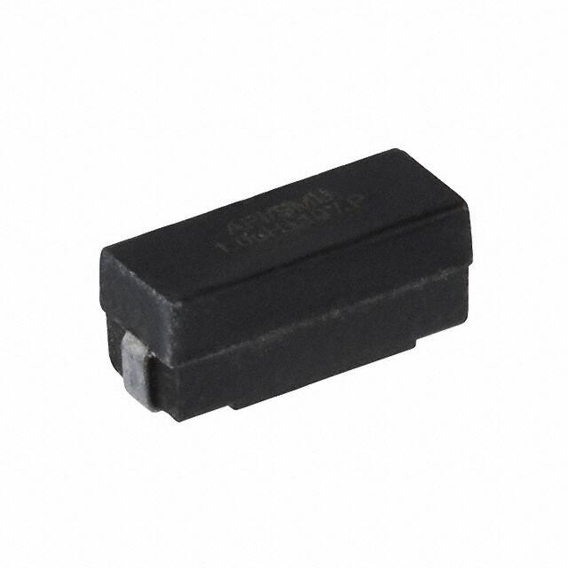

    固定电感器 Nonstandard 330µH ±5% 179mA 4.8Ω
P1330-334J 数据手册
Inches 0.300 to 0.325 0.105 to 0.125 0.125 to 0.145 0.020 Min. 0.040 to 0.060 0.190 (Ref. only) 0.070 (Ref. only) Millimeters 7.62 to 8.26 2.67 to 3.18 3.18 to 3.68 0.508 Min. 1.02 to 1.52 4.83 (Ref. only) 1.78 (Ref. only) Weight Max (Grams) 0.30 Operating Temperature Range –55°C to +125°C SERIES P1330 FERRITE CORE 1.0 0.045 2780 1.2 0.048 2690 1.5 0.053 2030 1.8 0.055 1950 2.2 0.075 1690 2.7 0.085 1550 3.3 0.108 1460 3.9 0.118 1390 4.7 0.130 1330 5.6 0.150 1110 6.8 0.165 1080 8.2 0.180 1020 10 0.216 946 12 0.252 912 15 0.288 858 18 0.328 817 22 0.384 694 27 0.425 657 33 0.538 568 39 0.600 488 47 0.792 467 56 0.900 442 68 1.020 384 82 1.380 362 100 1.680 347 120 1.800 327 150 2.040 272 180 2.400 261 220 2.648 223 270 4.320 191 330 4.800 179 390 5.640 171 470 6.000 161 560 6.960 138 680 8.760 130 820 9.960 113 1000 11.160 105 s or ct du In A B C D E F G -102K -122K -152K -182K -222K -272K -332K -392K -472K -562K -682K -822K -103K -123K -153K -183K -223K -273K -333K -393K -473K -563K -683K -823K -104K -124K -154K -184K -224K -274K -334K -394K -474K -564K -684K -824K -105K er w Po Physical Parameters L TA EN C) EM A D CR m IN NT ( E RR CU NG TI ) RA C T D EN (mA RR M CU MU XI MA CE AN ) ST S SI HM RE M (O DC MU XI MA H) (µ CE kHz AN 1 CT @ DU 0% IN ±1 Actual Size R* Surface Mount Power Inductors E MB NU P1330R P1330 SH DA SERIES 1526 1400 1291 1180 1104 936 840 732 720 612 600 600 564 516 432 420 348 324 270 270 246 216 174 150 132 111 106 89 72 60 57 48 41 35 30 26 22 Current Rating at 90°C Ambient 35°C Rise Maximum Power Dissipation at 90°C 0.210 W Inductance Measured at 1V with no DC current Incremental Current The current at which the inductance will be decreased by a maximum of 5% from its initial zero DC value. Optional Tolerances: J = 5% H = 3% G = 2% *Complete part # must include series # PLUS the dash # Marking Delevan; dash number followed by a P; date code (YYWWL). Note: An R before the date code indicates a RoHS component. Example: P1330-104J DELEVAN 104 P 1819A Packaging Tape & reel (16mm): 7" reel, 500 pieces max.; 13" reel, 2200 pieces max. Made In the U.S.A. 270 Quaker Rd., East Aurora NY 14052 • Phone 716-652-3600 • Fax 716-652-4814 • E-mail: apisales@delevan.com • www.delevan.com 8/2021
P1330-334J
物料型号:P1330系列 器件简介:表面安装功率电感器 引脚分配:未提供具体引脚分配信息 参数特性: - 尺寸:A 0.300到0.325英寸,B 0.105到0.125英寸,C 0.125到0.145英寸,E 0.040到0.060英寸 - 重量最大:0.30克 - 工作温度范围:-55°C至+125°C - 90°C环境温度下的电流额定值:35°C上升 - 90°C时最大功率耗散:0.210瓦 - 电感测量条件:1V下无直流电流 - 增量电流:电感从初始值下降5%的最大电流 功能详解:未提供具体功能详解 应用信息:未提供具体应用信息 封装信息:胶带和卷轴(16mm):7英寸卷轴,最多500件;13英寸卷轴,最多2200件 制造商信息:DELEVAN,位于美国纽约州东奥罗拉270 Quaker Rd.
