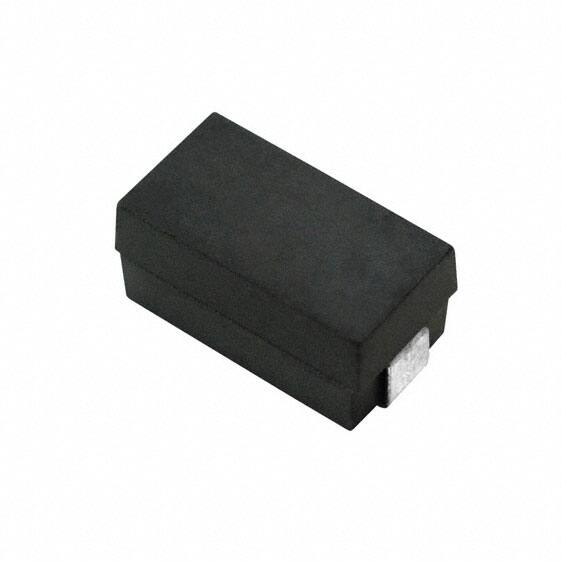

    固定电感器 Nonstandard 1.5µH ±10% 2.72A 40mΩ
P3519R-152K 数据手册
Weight/Mass 0.490 Grams Maximum SERIES P3519 FERRITE CORE 0.01 5.35 0.10 ±10% 0.01 5.11 0.12 ±10% 0.01 4.83 0.15 ±10% 0.01 4.62 0.18 ±10% 0.02 4.39 0.22 ±10% 0.02 3.17 0.27 ±10% 0.02 3.97 0.33 ±10% 0.02 3.81 0.39 ±10% 0.02 3.63 0.47 ±10% 0.02 3.48 0.56 ±10% 0.03 3.31 0.68 ±10% 0.03 3.16 0.82 ±5% 0.03 3.01 1.0 ±5% 0.04 2.88 1.2 ±5% 0.04 2.72 1.5 ±5% 0.04 2.60 1.8 ±5% 0.05 2.47 2.2 ±5% 0.09 1.85 2.7 ±5% 0.10 1.76 3.3 ±5% 0.10 1.69 3.9 ±5% 0.11 1.61 4.7 ±5% 0.12 1.54 5.6 ±5% 0.14 1.47 6.8 ±5% 0.24 1.11 8.2 ±5% 0.26 1.06 10 ±5% 0.29 1.01 12 ±5% 0.32 0.96 15 ±5% 0.35 0.91 18 ±5% 0.39 0.87 22 ±5% 0.43 0.83 27 ±5% 0.75 0.63 33 ±5% 0.81 0.60 39 ±5% 0.89 0.58 47 ±5% 0.98 0.55 56 ±5% 1.07 0.52 68 ±5% 1.96 0.39 82 ±5% 2.17 0.37 100 ±5% 2.38 0.35 120 ±5% 2.66 0.33 150 ±5% 4.48 0.26 180 ±5% 4.95 0.24 220 ±5% 5.48 0.23 270 ±5% 6.06 0.22 330 ±5% 10.3 0.17 390 ±5% 11.3 0.16 470 ±5% 12.3 0.16 560 ±5% 13.6 0.15 680 ±5% 24.2 0.11 820 ±5% 26.7 0.11 1000 ±5% 29.3 0.10 1200 ±5% 32.8 0.10 1500 ±5% 35.9 0.09 1800 ±5% 39.7 0.09 2200 ±5% s or ct du In Terminal Material and Final Finish Series P3519: (Tin-Lead) Sn63Pb37 over (Copper) Cu Series P3519R: (Tin-Silver-Copper) Sn96.5Ag3.0Cu0.5 over (Copper) Cu er w Po Marking Delevan; dash number followed by a P; and date code/lot symbol (YYWWL). Note: An R before the date code/lot symbol indicates an RoHS Compliant choke Example: P3519-104J DELEVAN 104 P 1823A L TA EN (A) EM C CR D IN ENT RR CU NG TI ) RA A T M( EN MU RR XI CU MA CE AN ) ST S SI HM RE M (O DC MU XI MA Incremental Current The current at which the inductance will be decreased by a maximum of 10% from its initial DC value E NC RA LE TO Maximum Power Dissipation at 90°C 0.414 W Inductance Measured at 1VAC with no DC Current -101K -121K -151K -181K -221K -271K -331K -391K -471K -561K -681K -821J -102J -122J -152J -182J -222J -272J -332J -392J -472J -562J -682J -822J -103J -123J -153J -183J -223J -273J -333J -393J -473J -563J -683J -823J -104J -124J -154J -184J -224J -274J -334J -394J -474J -564J -684J -824J -105J -125J -155J -185J -225J z Kh 10 Operating Temperature Range –55°C to +130°C Current Rating at 85° Ambient 45°C Rise @ H) (µ Physical Parameters Inches Millimeters A 0.350 to 0.370 8.89 to 9.40 B 0.180 to 0.200 4.57 to 5.08 C 0.165 to 0.185 4.19 to 4.70 D 0.050 Min. 1.27 Min. E 0.050 to 0.070 1.27 to 1.78 F 0.200 (Ref. Only) 5.08 (Ref. Only) Dimensions “A” and “C” are over terminals R* Actual Size E MB NU Surface Mount Power Inductors CE AN CT DU IN P3519R P3519 SH DA SERIES 13.66 12.47 11.15 10.18 9.21 8.31 7.52 6.92 6.30 5.77 5.24 4.77 4.32 3.94 3.53 3.22 2.91 2.63 2.38 2.19 1.99 1.83 1.66 1.50 1.37 1.25 1.12 1.02 0.92 0.83 0.75 0.69 0.63 0.58 0.52 0.48 0.43 0.39 0.35 0.32 0.29 0.26 0.24 0.22 0.20 0.18 0.17 0.15 0.14 0.12 0.11 0.10 0.09 Packaging Tape & reel (24mm): 13" reel, 1500 pieces max. Tolerances: J = ±5% K = ±10% (±5% Tolerance is Standard for Values Above 0.68uH) *Complete part # must include series # PLUS the dash # All product specifications and data contained herein are subject to change without notice to improve reliability, function, performance, design or otherwise. Made In the U.S.A. 270 Quaker Rd., East Aurora NY 14052 • Phone 716-652-3600 • Fax 716-652-4814 • E-mail: apisales@delevan.com • www.delevan.com 8/2018 er w Po P3519R P3519 s or ct du In SERIES Surface Mount Power Inductors Inductance vs. Frequency 270 Quaker Rd., East Aurora NY 14052 • Phone 716-652-3600 • Fax 716-652-4814 • E-mail: apisales@delevan.com • www.delevan.com 3/2018 er w Po P3519R P3519 s or ct du In SERIES Surface Mount Power Inductors Inductance vs. Frequency The above waveforms have been composed from data taken from a Wayne Kerr 3260B Precision Magnetics Analyzer and Hewlett Packard 4191A RF Impedance Analyzer. 270 Quaker Rd., East Aurora NY 14052 • Phone 716-652-3600 • Fax 716-652-4814 • E-mail: apisales@delevan.com • www.delevan.com 3/2018
