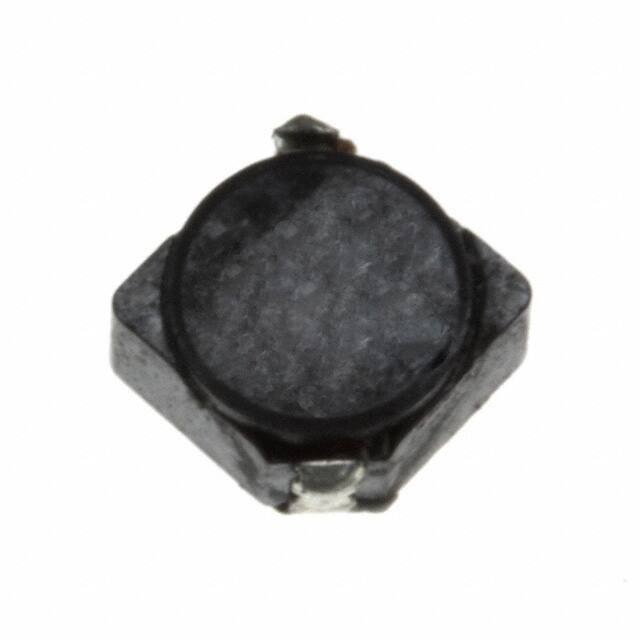

    固定电感器 Nonstandard 10µH ±20% 580mA 83mΩ 37MHz
SPD42R-103M 数据手册
er w Po 1.2 2.2 3.3 4.7 6.8 10 12 15 18 22 27 33 39 47 56 68 82 100 SERIES SPD42R 100 0.019 100 0.023 100 0.032 100 0.045 100 0.060 100 0.083 1.0 0.100 1.0 0.115 1.0 0.150 1.0 0.160 1.0 0.190 1.0 0.215 1.0 0.290 1.0 0.320 1.0 0.365 1.0 0.480 1.0 0.520 1.0 0.700 1.80 1.35 1.10 0.90 0.73 0.58 0.53 0.46 0.42 0.38 0.35 0.32 0.30 0.28 0.25 0.22 0.20 0.12 s or ct du In ) Hz (M AL IC YP FT SR NG TI ) RA s T mp EN (A RR UM CU XIM CE MA AN ) ST S SI HM RE M (O DC MU XI ) MA Hz (k Y NC UE EQ FR 0% ±2 H) (µ -122M -222M -332M -472M -682M -103M -123M -153M -183M -223M -273M -333M -393M -473M -563M -683M -823M -104M ST TE R* Actual Size E MB NU Shielded Surface Mount Inductors CE AN CT DU IN SPD42R SH DA SERIES 120 77 65 55 45 37 34 30 28 25 21 18 17 16 15 14 12 11 *Complete part # must include series # PLUS the dash # Mechanical Configuration Magnetically shielded surface mount power inductor ferrite core & shield. Physical Parameters Inches A 0.185 ± 0.012 B 0.185 ± 0.012 C 0.115 Max. D 0.015 Ref. E 0.100 Ref. F 0.065 Ref. G 0.270 Ref. H 0.075 Ref. I 0.210 Ref. J 0.059 Ref. Millimeters 4.7 ± 0.3 4.7 ± 0.3 2.92 Max. 0.38 Ref. 2.54 Ref. 1.65 Ref. 6.86 Ref. 1.90 Ref. 5.30 Ref. 1.50 Ref. Operating Temperature Range –55°C to +125°C Current Rating at 25°C Ambient 40°C maximum temperature rise and 10% maximum decrease in inductance Application Frequency Range 18 Inductance values from 1.2 μH to 100 μH Core Material Ferrite Weight (Grams Max.) 0.85 Packaging Tape & reel (12mm): 7" reel, 500 pieces max. Note: No vias and traces in restricted area. 270 Quaker Rd., East Aurora NY 14052 • Phone 716-652-3600 • Fax 716-652-4814 • E-mail: apisales@delevan.com • www.delevan.com 8/2021
