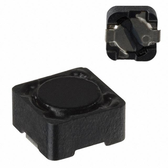

    68 µH 屏蔽 鼓芯,绕线式 电感器 1.05 A 520 毫欧最大 非标准
SPD73R-683M 数据手册
Example: SPD73R-122M (1.2 μH) 1R2 Example: SPD74R-105M (1,000 μH) 102 Packaging Tape & reel (16mm): 13" reel, 1000 pieces max.; 7" reel not available s or ct du In Marking For values lower than 10 μH the R indicates a decimal point and the remaining digits indicate the inductance in μH. For values 10 μH and above, the first two digits indicate the inductance in μH and the third digit indicates the number of trailing zeros where a zero indicates that there are no trailing zeros. SERIES SPD73R FERRITE CORE & SLEEVE 1.2 100 0.020 2.4 100 0.032 3.5 100 0.035 4.7 100 0.050 6.8 100 0.065 10 100 0.067 12 1.0 0.080 15 1.0 0.091 18 1.0 0.14 22 1.0 0.19 27 1.0 0.21 33 1.0 0.24 39 1.0 0.32 47 1.0 0.36 56 1.0 0.47 68 1.0 0.52 82 1.0 0.69 100 1.0 0.79 120 1.0 0.84 150 1.0 0.89 180 1.0 1.45 220 1.0 1.65 270 1.0 2.31 330 1.0 2.62 390 1.0 2.94 470 1.0 4.18 560 1.0 4.67 680 1.0 5.73 820 1.0 6.54 1000 1.0 9.44 SERIES SPD74R FERRITE CORE & SLEEVE 1.2 100 0.025 2.4 100 0.03 3.5 100 0.034 4.7 100 0.038 6.8 100 0.042 10 100 0.049 12 1.0 0.058 15 1.0 0.081 18 1.0 0.091 22 1.0 0.11 27 1.0 0.15 33 1.0 0.17 39 1.0 0.23 47 1.0 0.26 56 1.0 0.35 68 1.0 0.38 82 1.0 0.43 100 1.0 0.61 120 1.0 0.66 150 1.0 0.88 180 1.0 0.98 220 1.0 1.17 270 1.0 1.64 330 1.0 1.86 390 1.0 2.85 470 1.0 3.01 560 1.0 3.62 680 1.0 4.63 820 1.0 5.2 1000 1.0 6.0 er w Po Current Rating at 25°C Ambient The maximum DC current that will cause a 40°C maximum temperature rise and where the inductance will not decrease by more than 10% from its zero DC value NG TI ) RA C T D EN (A RR UM CU XIM MA CE AN ) ST S SI HM RE M (O DC MU XI MA Application Frequency Range Values 1.2µH to 10µH to 1.0 MHz Min. Values above 10µH to 300 kHz Min. ) Hz (k Operating temperature range –55°C to +125°C Y NC UE EQ FR Mechanical Configuration Units designed for surface mounting; ferrite core and ferrite sleeve -122M -242M -352M -472M -682M -103M -123M -153M -183M -223M -273M -333M -393M -473M -563M -683M -823M -104M -124M -154M -184M -224M -274M -334M -394M -474M -564M -684M -824M -105M ST TE Millimeters 7.3 ± 0.5 7.3 ± 0.5 4.7 Max. (Series SPD74) 3.9 Max.(Series SPD73) 5.0 ± 0.5 2.2 ± 0.5 1.0 ± 0.5 0.38 Ref. only -122M -242M -352M -472M -682M -103M -123M -153M -183M -223M -273M -333M -393M -473M -563M -683M -823M -104M -124M -154M -184M -224M -274M -334M -394M -474M -564M -684M -824M -105M 0% ±2 H) (µ Physical Parameters Inches A 0.287 ± .020 B 0.287 ± .020 C 0.185 Max. C 0.153 Max. D 0.200 ± 0.020 E 0.088 ± 0.020 F 0.042 ± 0.020 G 0.015 Ref. only R* Actual Size E MB NU Shielded Surface Mount Inductors CE AN CT DU IN SPD73R SPD74R SH DA SERIES 3.40 2.69 2.60 2.15 1.90 1.90 1.70 1.59 1.28 1.10 1.05 0.981 0.850 0.801 0.701 0.667 0.579 0.541 0.524 0.510 0.399 0.374 0.316 0.297 0.280 0.235 0.222 0.201 0.188 0.156 4.40 4.00 3.70 3.50 3.40 2.50 2.40 2.30 2.15 2.00 1.70 1.50 1.35 1.30 1.10 1.05 1.00 0.86 0.84 0.70 0.68 0.60 0.53 0.50 0.40 0.39 0.36 0.32 0.30 0.28 *Complete part # must include series # PLUS the dash # Note: No vias and traces in restricted area. 270 Quaker Rd., East Aurora NY 14052 • Phone 716-652-3600 • Fax 716-652-4814 • E-mail: apisales@delevan.com • www.delevan.com 8/2021

1. 物料型号:文档列出了SPD73R和SPD74R系列的屏蔽表面贴装电感器,包括不同的电感值和额定电流。
2. 器件简介:这些电感器采用铁氧体芯和铁氧体套筒设计,适用于表面贴装,工作温度范围为-55°C至+125°C,适用于1.0 MHz至300 kHz的频率范围。
3. 引脚分配:文档提供了电感器的顶视图和侧视图,但未明确列出引脚分配
4. 参数特性:列出了不同型号电感器的直流电阻、电流额定值、电感值和测试频率。
5. 功能详解:文档描述了电感器的电流额定值,即在25°C环境温度下,不会导致电感值下降超过10%的最大直流电流,同时电感器的温度上升不超过40°C。
6. 应用信息:电感器适用于高频应用,具有较小的电流额定值和电感值。
7. 封装信息:提供了电感器的物理参数,包括尺寸和机械配置信息,以及包装信息,如胶带和卷轴包装。
