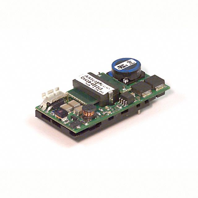

CXA10 Series DC/DC CONVERTERS • • • • • • • • • 10W DC/DC Converters Single and dual output 1 4:1 input voltage range Approved to EN60950, UL1950, CSA C22.2 No. 950 Operating ambient temperature of -40°C to +70°C in still air High demonstrated reliability with conservative component deratings Complies with ETS 300 019-1-3/2-3 Complies with ETS 300 132-2 input voltage and current requirements Fully compliant with ETS 300 386-1 Pin compatible with NFC10 and BXA10 series Basic insulation system (input to output) The CXA10 series comprising of five different models delivers single and dual output voltages covering 3.3V, 5V, 12V, ±5V, ±12 and ±15V. The series has a wide 4:1 input voltage range of 18 to 75VDC. The CXA10 has been designed as a competitive open-frame alternative for the communications market. The product is supplied in the industry standard footprint of 2.0 x 1.0 x 0.394 inches. Other product features include overvoltage protection, short circuit protection and remote on/off. All components are placed in a fully automated environment. Planar magnetics are used in the design to improve the reliability and reduce the profile of the DC/DC converter. The series has full international safety approval to EN60950 and UL1950 reducing system compliance costs, and it has a basic insulation system from input to output making it suitable for a wide variety of applications. 2 YEAR WARRANTY All specifications are typical at nominal input, full load at 25°C unless otherwise stated SPECIFICATIONS OUTPUT SPECIFICATIONS Voltage accuracy Line regulation (LL to HL) Load regulation (not incl. cross reg.) Min. load Ripple and noise 20MHz bandwidth Temperature coefficient Overvoltage protection Short circuit protection Short
CXA10-48S3V3
1. 物料型号: - 型号包括CXA10-48S3V3、CXA10-48S05、CXA10-48S12、CXA10-48D05、CXA10-48D12和CXA10-48D15。
2. 器件简介: - CXA10系列是10W DC/DC转换器,提供单输出和双输出电压,覆盖3.3V、5V、12V、±5V、±12V和±15V。该系列具有18至75VDC的宽输入电压范围,设计为通信市场的开放框架替代品。
3. 引脚分配: - 单输出:1号引脚为正输入,2号引脚为负输入,3号引脚为正输出,5号引脚为负输出。 - 双输出:1号引脚为正输入,2号引脚为负输入,3号引脚为正输出,4号引脚为公共地,5号引脚为负输出,6号引脚为远程开/关。
4. 参数特性: - 输出电压准确度:±1.0%。 - 线路调整率(单/双正输出/双负输出):±0.1%/±0.2%。 - 负载调整率:±0.15%。 - 最小负载:所有输出10%。 - 纹波和噪声(20MHz带宽):3.3V和5.0V为30mV峰峰值,其他为60mV峰峰值,所有型号为12mV均方根值。 - 温度系数:±0.01%/°C。 - 过压保护:钳位型。 - 短路保护:短路<20m时为hiccup模式,持续自动恢复。
5. 功能详解: - 该系列产品具有过压保护、短路保护和远程开/关功能。所有组件均在全自动化环境中放置,使用平面磁学设计以提高可靠性并降低DC/DC转换器的外形。
6. 应用信息: - 适用于多种应用,具有基本绝缘系统(输入到输出),符合EN60950和UL1950等国际安全认证,减少系统合规成本。
7. 封装信息: - 产品尺寸为2.0 x 1.0 x 0.394英寸,重量为12g(0.42 oz)。
