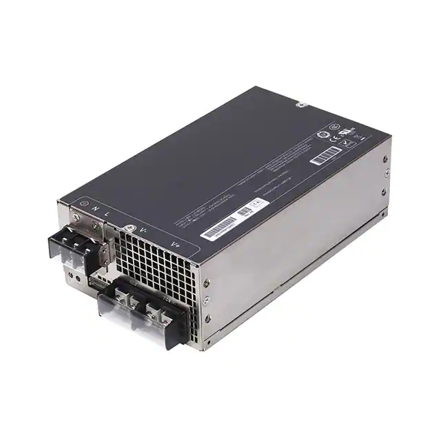

ARTESYN LCM600 600 Watt Bulk Front End Advanced Energy's Artesyn LCM600 series of 2U high distributed power front-end AC-DC power supplies provides a very cost effective bulk power solution. The series comprises five models, offering outputs of 12 V, 15 V, 24 V, 36 V or 48 V, together with an optional 5 V standby output. Each model accepts a universal input of 85 to 264 VAC and has a typical full load efficiency of 89%. Carrying industrial and medical safety approvals, these power supplies can deliver up to 600 watts and offer versatile bulk power for a wide variety of industrial, medical, military and process automation applications. SPECIAL FEATURES COMPLIANCE  600 W output power  EMI Class B  Low cost  EN61000 Immunity  2.4” x 4.5” x 7.5”  7.41 W/cu-in  UL/CSA UL/CSA62368-1  -40°C to 70°C with derating  TUV EN62368-1  Optional 5 V @ 2 A housekeeping  CB Report IEC60950-1,  Conformal coat option  ± 20% adjustment range  Margin programming  OR-ing FET  Terminal block input option 600 W # of Outputs Single Outputs 12 to 60 VDC Optional 5 VDC standby IEC60601-1  High efficiency: 89% typical  DSP controlled front end Total Power SAFETY  Industrial/Medical safety  Variable speed “Smart Fans” DATA SHEET  CCC GB4943, GB9254 and GB17625  UL/CSA ES60601-1/CSA C22.2 No. 60601-1  TUV EN60601-1  CE and UKCA Mark ** LCM600 tested according to the medical standard IEC60601-1-2 4th Edition. ©2022 Advanced Energy Industries, Inc. LCM600 ELECTRICAL SPECIFICATIONS Input Input ra­nge 85 to 264 VAC (Operating) 115/230 VAC (Nominal) Input through standard IEC connector/ TERMINAL BLOCK Frequency 47 to 440 Hz, Nominal 50/60 Hz Input fusing Internal 10 A fuses, both lines fused Inrush current ≤ 25 A peak, either hot or cold start Power factor 0.99 typical, meets EN61000-3-2 Harmonics Meets IEC1000-3-2 requirements Input current 8 A RMS max input current, at 100 VAC Hold up time 20 ms minimum for main O/P, at full rated load Efficiency > 89% at full load Leakage current < 0.3 mA at 240 VAC ON/OFF power switch N/A Power line transient MOV directly after the fuse Isolation Isolation: PRI-Chassis 2500 VDC Basic PRI-SEC 4000 VAC Reinforced 2xMOPP SEC-Chassis 500 VDC LCM600Q Efficiency Without the 5 Vsb 92.00 90.00 88.00 Efficiency % 86.00 100 Vac 230 Vac 84.00 82.00 80.00 78.00 76.00 25 50 75 Loading % 2 advancedenergy.com 100 LCM600 ELECTRICAL SPECIFICATIONS (CONTINUED) Output Output rating See ordering information table 85 to 264 VAC Set point ± 0.5% 85 to 264 VAC Total regulation range Main output ± 2% 5 VSB ± 1% Combined line/load/transient when measured at output terminal Rated load 600 W maximum Derate linear to 50% from 50°C to 70°C Minimum load Main output @ 0.0 A 5 VSB @ 0.0 A No loss of regulation Output noise (PARD) 1% max p-p 50 mV max p-p Main output 5 VSB output Measured with a 0.1 μF Ceramic and 10 μF Tantalum Capacitor on any output, 20 MHz Output voltage overshoot < 300 µSec No overshoot/undershoot outside the regulation band during on or off cycle Transient response 50% load step @ 1 A/µs Step load valid between 10% to 100% of output rating Recovery time to within 1% of set point at onset of transient Max units in parallel Short circuit protection Up to 10 Protected, no damage to occur Remote sense Bounce mode Compensation up to 500 mV Output isolation Standard per safety requirements Forced load sharing To within 10% of all shared outputs Analog sharing control Overload protection (OCP) 105% to 125% 120% to 170% Main output 5 VSB output Overvoltage protection (OVP) 125% to 145% 110% to 125% 12 V output 5 VSB output Overtemp protection 10 to 15°C above safe operating area Both PFC and output converter monitored Fan Fault Protection For -N option only. Will shutdown output and DC_OK ENVIRONMENTAL SPECIFICATIONS Operating temperature -40°C to +70°C, linear derating to 50% from 50°C to 70°C Storage temperature -40°C to +85°C Humidity 10 to 90%, non-condensing. Operating. Conformal coat option available Fan noise < 45 dBA, 80% load at 30°C “-N” Low Noise Option < 35 dBA, 80% Load at 30°C Altitude Operating - 16,404.2 feet Storage - 30,000 feet Shock MIL-STD-810F 516.5, Procedure I, VI. Storage Vibration MIL-STD-810F 514.5, Cat. 4, 10. Storage advancedenergy.com 3 LCM600 ORDERING INFORMATION Output Nominal Output Voltage Set Point Set Point Tolerance LCM600L 12 V 12 V LCM600N 15 V 15 V LCM600Q 24 V LCM600U LCM600W Model Number* *Note: Adjustment Range Min Current Max Output Ripple P/P (0-50˚C) Max Continuous Power Combined Line/Load Regulation ±0.5% 9.6 to 14.4 V 0A 52 A 120 mV 600 W 2% ±0.5% 12.0 to 19.5 V 0A 44 A 150 mV 600 W 2% 24 V ±0.5% 19.2 to 28.8 V 0A 27 A 240 mV 600 W 2% 36 V 36 V ±0.5% 28.8 to 43.2 V 0A 16.7 A 360 mV 600 W 2% 48 V 48 V ±0.5% 38.4 to 57.6 V 0A 14 A 480 mV 600 W 2% Add “-T” for terminal block instead of IEC input Add “-N” for low noise model on 12 V or 24 V models Add “-4” for 5 V Standby output Add “-A” will be automatically added to all orders to denote new Aesthetics style chassis unless otherwise specified Example: a 24 V with terminal block, low noise and standby with new Aesthetics would be LCM600Q-T-N-4-A PIN ASSIGNMENT Signals Name Description Pin Number(s) +Vout Power rail SK4 GND Power GND SK5 Signals Name Description SK2 Pin Number A2 EEPROM Address 1 -VPROG Return connection of external supply for Margin Programming 2 A1 EEPROM Address 3 -Vsense Remote Sense Return 4 ISHARE Load share voltage 5 A0 EEPROM Address 6 SDA1 Serial Data Signal (I2C) 7 +VPROG Positive connection of external supply for Margin Programming 8 SCL1 Serial Clock Signal (I2C) 9 +Vsense Remote Sense Positive 10 5VSB 5V standby 11 GND 5V standby Return 12 5VSB 5V standby 13 G_DCOK_C Global DCOK Collector 14 GPIOA6 EEPROM Write Protect 15 G_DCOK_E Global DCOK Emitter (GND) 16 GND Return Ground for output signal and I2C communication 17 G_ACOK_C Global ACOK Collector 18 INH_EN Turn Off Main Output 19 G_ACOK_E Global ACOK Emitter (GND) 20 Note: Mating connector for SK2 is: LANDWIN: PN 2050S2000 Housing and PN 2053T021V Contact CIVILUX: PN CI0120SD000 Housing and PN CI01TD21PE0 Contact JST: PN PHDR-20VS housing and PN: SPHD-001T-P0.5 Signal Output Signal Connectors (SK2) SK2 Mating Connector: JST Part Number PHDR-20VS Contact Pins: JST Part Number SPHD-001T-P0.5 4 advancedenergy.com LCM600 PIN ASSIGNMENT (CONTINUED) LED Indicators Two (2) provided are clearly visible up to a 45 degree offset from vertical with office environment ambient lighting. The status is reflected in the indicator color. The DC_OK LED LED is bicolor. It shall light green if the DC output is within specification, and amber if the output falls out of specification. The AC_OK LED LED is green if the AC is within specification and off when out of specification. Note: With 5 V standby, Amber also indicates that PSU is in standby mode/output off. Control Signals AC_OK Open collector 0.5 V maximum at 10 mA. Both emitter and collector access provided. DC_OK Open collector 0.5 V maximum at 10 mA. Both emitter and collector access provided. DC_OK will de-assert when output is loss due to OCP, OVP, OTP, or Fan Fault (for -N option). PS_INHIBIT/ENABLE Signal 0.0 to 0.5 V contact closure, output OFF ORDERING INFORMATION LCMXXXXY - Case Size A - B - C - ### Input Termination Acoustic Noise Option Codes Hardware Code Blank = IEC connector Blank = Standard Blank = No Options Factory Assigned for Modiefied standards T = Terminal Block N = Low Noise Fan 1 = Conformal Coat 1-Phase input where XXXX = 600 = 2.4” x 4.5” x 7.5”, 600 W Voltage Code Y = 4 = 5 V Standby Code 5 = Opt 1 + 4 L 12 N 15 Q 24 U 36 W 48 advancedenergy.com 5 LCM600 MECHANICAL DRAWINGS (18.5) (212.2 ref) 190.5 0.5 SEE DETAIL C (TRIMPOT LOCATION) 9.5 GROUND 114.3 0.5 9.5 16.8 SEE DETAIL A NEUTRAL LIVE DETAIL A SCALE 1.500 SCREW-MC PHILIP PAN WITH WASHER M4x8 SK2 SIGNAL CONNECTOR - 20WAY 50 (8X) MOUNTING LOCATIONS BOTH SIDES M4X0.7P THREAD SEE NOTE 7 41 (2X)6 0.5 (2X)22 0.5 SK4 & SK5 LED (AC OK) LED (DC/OK FAIL) (2X)47 0.5 62 1 INPUT TERMINAL BLOCK SEE NOTE 8 BRAND LOGO SEE DETAIL B (2X)10.6 (2X)182.5 0.5 50 (2X)177.5 0.5 11.15 0.5 17.65 0.5 (2X) 94.45 0.5 (2X)10 0.5 VOLTAGE ADJUSTMENT: CLOCKWISE - INCREASE VOLTAGE COUNTER CLOCKWISE - DECREASE VOLTAGE DETAIL C (TRIMPOT LOCATION) (4X) MOUNTING LOCATIONS M4X0.7P THREAD SEE NOTE 7 DETAIL B AC INLET VERSION New Mechanical Reference Drawing: Weight: 2.84 lbs (1.29 kg) MOUNTING LOCATIONS SCREW PENETRATION DEPTH IS 4.6 mm MAX. RECOMMENDED SCREW TORQUE: M3.5 x 0.6P = 6 to 8 kgf-cm M4.0 x 0.7P = 8 to 10 kgf-cm NOTE: OPTIONAL BARRIER STRIP OUTPUT TERMINAL AVAILABLE OPTIONAL MOLEX TYPE CONNECTOR OUTPUT AVAILABLE 6 advancedenergy.com Note 7 RECOMMENDED SCREW TORQUE: M3.5x0.6P = 6 to 8 kgf-cm M4.0x0.7P = 8 to 10 kfg-cm Note 8 INPUT: TERMINAL BLOCK TYPE. M3.5 SCREW TORQUE VALUE OF 12 kgf-cm USING WIRE GAUGE 22-19 (9.5 mm centers) LCM600 MECHANICAL DRAWINGS – TERMINAL BLOCK INPUT 190,5 0,5 SEE DETAIL A 9,5 GROUND 9,5 SEE DETAIL B (TRIMPOT LOCATION) NUETRAL 12,8 LIVE 32,8 114,3 0,5 16,8 18,5 REF DETAIL A SCALE 8:5 SCREW-MC PHILIP PAN WITH EXT-T WASHER M3.5 x P0.6 x 6 PROVISION FOR FUTURE LABEL REQUIREMENTS (8X) MOUNTING LOCATIONS BOTH SIDES M4X0.7P THREAD SEE NOTE 7 40,2 15,75 POS - SK4 NEG - SK5 SK2 SIGNAL CONNECTOR - 20WAY (2X)22 0,5 61 0,5 LED (DC/OK FAIL) LED (AC OK) PRODUCT LABEL (2X)47 0,5 INPUT TERMINAL BLOCK SEE NOTE 8 (2X)6 0,5 (2X)10,6 (2X)182,5 0,5 50 (2X)177,5 0,5 11,15 0,5 17,65 0,5 (2X)94,45 0,5 (2X)10 0,5 VOLTAGE ADJUSTMENT: CLOCKWISE - INCREASE VOLTAGE COUNTER CLOCKWISE - DECREASE VOLTAGE (4X) MOUNTING LOCATIONS M4X0.7P THREAD SEE NOTE 7 DETAIL B (TRIMPOT LOCATION) AIRFLOW DIRECTION Old Mechanical Reference Drawing: Weight: 2.84 lbs (1.29 kg) Note 7 - RECOMMENDED SCREW TORQUE: M3.5x0.6P = 6 to 8 kgf-cm M4.0x0.7P = 8 to 10 kfg-cm advancedenergy.com 7 LCM600 NOISE (dBA LOW NOISE VS. NON-LOW NOISE LCM600 MODEL 60.0 58.0 56.0 54.0 52.0 50.0 48.0 46.0 44.0 42.0 40.0 38.0 36.0 34.0 32.0 30.0 25 Deg Ambient NON-Low noise version Low noise version 0 2.5 5 7.5 10 12.5 15 17.5 20 22.5 25 27.5 30 32.5 35 37.5 40 42.5 45 47.5 50 47.5 50 LOAD (A) 60.0 50 Deg Ambient 58.0 56.0 54.0 52.0 NOISE (dBA 50.0 48.0 46.0 44.0 42.0 40.0 NON-Low noise version 38.0 Low noise version 36.0 34.0 32.0 30.0 0 2.5 5 7.5 10 12.5 15 17.5 20 22.5 25 LOAD (A) 27.5 30 32.5 35 37.5 40 42.5 45 NON-LOW NOISE VERSION 25˚C ambient 50˚C ambient LOAD (A) Fan (V) RPM Noise (dbA) Fan (V) RPM Noise (dbA) 0 6.254 3558.0 40.9 6.228 3460.9 39.9 2.5 6.257 3559.8 41.0 6.228 3460.9 39.9 5 6.262 3562.0 41.0 6.230 3494.3 40.1 7.5 6.263 3562.0 41.0 6.242 3526.6 40.1 10 6.242 3528.9 40.5 6.242 3526.6 40.1 12.5 6.251 3530.9 40.6 6.237 3515.6 40.4 15 6.251 3538.3 40.7 6.229 3504.9 40.2 17.5 6.226 3538.2 40.7 6.205 3482.8 39.4 20 6.223 3541.0 40.7 6.217 3490.1 40.0 22.5 6.242 3545.1 40.8 6.227 3493.8 40.1 25 6.253 3553.9 40.9 6.234 3504.3 40.2 27.5 6.254 3564.1 41.0 6.212 3501.7 40.2 30 6.253 3552.2 40.9 6.642 3787.4 44.1 32.5 6.264 3559.7 41.0 7.893 4652.3 48.0 35 6.262 3559.6 41.0 9.153 5463.4 50.0 37.5 6.262 3560.8 41.0 11.035 6600.2 52.0 40 6.262 3559.8 41.0 11.605 6993.9 53.2 42.5 7.637 4521.2 47.8 11.608 6997.2 53.2 45 8.919 5362.2 49.3 11.608 6997.2 53.2 47.5 10.068 6139.5 51.0 11.608 6997.2 53.2 50 11.362 6893.4 52.8 11.608 6997.2 53.2 8 advancedenergy.com LCM600 LOW NOISE VERSION 25 ˚C ambient 50 ˚C ambient PWM LOAD (A) RPM Noise (dbA) LOAD (A) RPM Noise (dbA) 0% 0 3028 35.2 0 3180 36.0 5% 2.5 3028 35.2 2.5 3300 36.7 10% 5 3028 35.2 5 3300 36.7 15% 7.5 3060 35.4 7.5 3360 37.0 20% 10 3028 35.2 10 3360 37.0 25% 12.5 3028 35.2 12.5 3360 37.0 30% 15 3060 35.4 15 3360 37.0 35% 17.5 3060 35.4 17.5 3388 37.2 40% 20 3028 35.2 20 3388 37.2 45% 22.5 3028 35.2 22.5 3540 38.0 39.2 50% 25 3060 35.4 25 3840 55% 27.5 3028 35.2 27.5 4104 40.2 60% 30 3028 35.2 30 4408 41.4 65% 32.5 3060 35.4 32.5 4736 42.7 70% 35 3060 35.4 35 5184 44.5 75% 37.5 3060 35.4 37.5 5728 46.4 80% 40 3060 35.4 40 6688 49.5 85% 42.5 3420 37.4 42.5 7560 51.8 90% 45 3868 39.3 45 7584 51.9 95% 47.5 4376 41.3 47.5 7584 51.9 100% 50 5040 43.9 50 7584 51.9 advancedenergy.com 9 LCM600 ACCESSORIES PIN 20 PIN 19 PIN 2 PIN 3 PIN 1 300 ± 5 mm Order kit part number 73-788-001 for control connector interface with .3m wires attached PIN 20 PIN 19 PIN 2 PIN 3 PIN 1 Order kit part number 73-788-002 for control connector interface with unloaded housing and 20 pins MISCELLANEOUS SPECIFICATIONS Burn-In 100% Burn-in at 45°C, at 80 to 90 % load. Duration of burn-in determined by Quality Assurance Procedures. MTBF The power supply has a minimum MTBF of 300K hours using the Bell core 332, issue 6 specification @ 25°C and 40°C, ambient, at full load. With the power supply installed in a system in a 25°C ambient environment and operating at full load, capacitor life shall be 10 years, minimum for ALL electrolytic capacitors contained within this power supply. The power supply shall demonstrate a MTBF level of > 500,000 hours. 10 advancedenergy.com Quality Assurance Full QAV testing shall be conducted in accordance with Artesyn Embedded Power Standards with reports available upon request. Warranty Artesyn Embedded Power shall warrant the power supply to be free of defects in materials and workmanship for a minimum period of three years from the date of shipment, when operated within specifications. The warranty shall be fully transferable to the end owner of the equipment powered by the supply. ABOUT ADVANCED ENERGY Advanced Energy (AE) has devoted more than three decades to perfecting power for its global customers. AE designs and manufactures highly engineered, precision power conversion, measurement and control solutions for mission-critical applications and processes. Our products enable customer innovation in complex applications for a wide range of industries including semiconductor equipment, industrial, manufacturing, telecommunications, data center computing, and medical. With deep applications know-how and responsive service and support across the globe, we build collaborative partnerships to meet rapid technological developments, propel growth for our customers, and innovate the future of power. For international contact information, visit advancedenergy.com. powersales@aei.com (Sales Support) productsupport.ep@aei.com (Technical Support) +1 888 412 7832 Specifications are subject to change without notice. Not responsible for errors or omissions. ©2022 Advanced Energy Industries, Inc. All rights reserved. Advanced Energy®, AE® and Artesyn™ are U.S. trademarks of Advanced Energy Industries, Inc. ENG-LCM600-235-01 7.29
