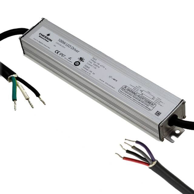

POWER LDS100 Series LED Lighting Power Supply - Class 2 Data Sheet Total Power: 100 Watts # of Outputs: Single Special Features ƒƒ Constant current & constant voltage operation ƒƒ Dimming options ƒƒ Free-air rated - no forced air necessary for cooling Compliance ƒƒ Class 2 outputs ƒƒ IP64 to IP67 water protection ƒƒ CISPR 15 / FCC Part 15 EMI performance ƒƒ Class C harmonics ƒƒ 0.9 power factor Safety ƒƒ EN ƒƒ UL ƒƒ CSA ƒƒ CE 61347-2-13 1310 / 8750 C22.2 No. 107.1 Mark (LVD) Warranty Standard 5-year warranty Electrical Specifications Input Input ra­nge nom 100 - 240 Vac (U models); 120-277 Vac (H models) Input range max 90-264 Vac (U models); 90-305 Vac (H models); Derating may apply Input frequency 47 - 63 Hz Inrush current < 50 A max., cold start @ 25 °C Leakage current 750 µA, at 264 Vac 50/60 Hz Input power (no-load) < 1.5 W, at no load Input power (max) < 118 W, at full load Input fusing Internally fused EMI/RFI CISPR 15 FCC Part 15 Efficiency (typical) 90% - 230 Vac 89% - 115 Vac Output Constant current Programmable current levels. Refer to model table for details Constant voltage No load to Full load operation. Refer to model table for details Output power 100 W maximum. Class 2 rated outputs Ripple voltage < 2% Control and Protection Current limit Programmable. Refer to model table for details Protection Short circuit Overvoltage Overtemperature LDS100 Series Data Sheet Environmental Specifications Criteria Specification Reference Power factor > 0.9 Energy Star Harmonics Class C IEC 61000-3-2 THD - input current < 20% ANSI C82.11 Surge immunity Level 3 6 kV ring wave IEC 61000-4-5 ANSI C62.41 IEC 61000-4-2, -3, -4, -5, -6, -8, -11 EMC compliance Temperature (case) -40 °C to 90 °C Operating Ingress protection IP67 Refer to model table for details Mechanical Drawing 42±0.25 235.5 1 215.0 1 MODEL LABEL (SEE TABLE 1) 350 10 INPUT: Black (L) Green/Yellow (GR) White (N) DIMMING FEATURES (SEE TABLE 1) 350 10 UL1015 18AWG x2C UL1015 #18AWG WIRE4C (SEE TABLE 1) 30 (2X)227.5 1 225.5 1 5 (4 PL) (30) (2X)18 0.5 0 -0,5 UL1015 18AWG x3C (2 5 ) PL Mechanical Miscellaneous Criteria Specification Reference Input wiring 300 mm 3-wire Output wiring 300 mm 4-wire Weight 625 grams OUTPUT: Red (+) Black (-) DIMMING Pur (DIM+) Gry (DIM-) LDS100 Series Data Sheet Ordering Information Model Number Rated Output Voltage Rated Output Current LDS100-24-U00 24 Vdc 4.1 Adc LDS100-24-U04 24 Vdc 4.1 Adc LDS100-24-H00 24 Vdc 4.1 Adc Dimming Interface IP Rating IP67 Programmable1 IP67 IP67 LDS100-24-H03 24 Vdc 4.1 Adc 1 - 10 V IP67 LDS100-24-H04 24 Vdc 4.1 Adc Programmable1 IP67 LDS100-31-H03 31 Vdc 3.16 Adc 1 - 10 V IP67 LDS100-31-H04 31 Vdc 3.16 Adc Programmable1 IP67 LDS100-48-H03 48 Vdc 2.0 Adc 1 - 10 V IP67 Notes: 1. The Dimming Interface on these highly-flexible models can be programmed via a Graphical User-Interface. The options include 0-10 V, 1-10 V and Bi-Level dimming. Maximum and minimum current levels and threshold levels are also programmable. Current Adjust and Dimming Description 0 - 10 V Between Purple & Grey Wires (for model -H03 only) Output Current 100% 10% 1V 1 – 10 V Signal 10 V WORLDWIDE OFFICES Americas Europe (UK) Asia (HK) 2900 South Diablo Way Suite B100 Tempe, AZ 85282, USA +1 888 412 7832 Ground Floor Offices, Barberry House 4 Harbour Buildings, Waterfront West Brierley Hill, West Midlands DY5 1LN, UK +44 (0) 1384 842 211 14/F, Lu Plaza 2 Wing Yip Street Kwun Tong, Kowloon Hong Kong +852 2176 3333 Artesyn Embedded Technologies, Artesyn Embedded Power, Artesyn, and all Artesyn related logos are trademarks and service marks of Artesyn Embedded Technologies, Inc. All other names and logos referred to are trade names, trademarks, or registered trademarks of their respective owners. Specifications are subject to change without notice. © 2019 Artesyn Embedded Technologies, Inc. All rights reserved. For full legal terms and conditions, please visit www.artesyn.com/legal. www.artesyn.com For more information: www.artesyn.com For support: productsupport.ep@artesyn.com LDS100 DS 18Dec2019
