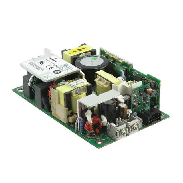

    LPS200-M系列医疗级AC-DC电源模块,提供5V、12V、15V、24V或48V输出电压。具有12V辅助风扇输出,支持自然对流冷却和强制风冷。
LPS205-M 数据手册
ARTESYN LPS200-M SERIES 250 Watts Advanced Energy’s Artesyn LPS200-M series medicallyapproved AC-DC power supplies are available with a nominal main output of 5 V, 12 V, 15 V, 24 V or 48V. Auxiliary 12 V fan output is also provided. LPS200-M power supplies provide 125 Watts of output power with free air convection cooling or up to 250 Watts with 30 CFM of forced air. All models have a power factor of 0.99 typical and a 3 x 5 x 1.32 inch form factor. AT A GLANCE Total Power 125 to 250 Watts Input Voltage 90 to 264 VAC # of Outputs Single SPECIAL FEATURES SAFETY  Medical and ITE safeties  TUV 62368, 60601-1  Active power factor correction  UL 62368, 60601-1  3” x 5” footprint  cULus 62368, 60601-1  Less than 1U high  CB Certificate & report  EN61000-3-2 compliant  CE Mark (LVD)  Remote sense  UKCA Mark  Power fail  Adjustable main output  Built-in Class B EMI filter  Overvoltage protection  Overload protection  Thermal overload protection  Isolated 12 V Fan output  LPX200 enclosure kit available  RoHS compliant ©2022 Advanced Energy Industries, Inc. LPS200-M ELECTRICAL SPECIFICATIONS Input Input ra­nge 90 to 264 VAC; 120 to 300 VDC Frequency 47 to 63 Hz Inrush current 50 A max., cold start @ 25°C Efficiency 86% typical at full load EMI/RFI FCC Class B conducted; CISPR22 Class B conducted; EN55022 Class B conducted; VDE0878PT3 Class B conducted Power factor 0.99 typical Safety ground Leakage current 275 µA @ 50/60 Hz, 264 Vac input Output Maximum power 125 W for convection (100 W for LPS202-M); 250 W (200 W for LPS202-M) with 30CFM forced air Adjustment range ± 10% minimum on the main outputs Fan output 12 V @ 0.5 A convection, @ 1 A forced air isolated, ± 10% Hold-up time 16 ms @ 250 W load, 120 Vac input Overload protection Short circuit protection on all outputs. Case overload protected @ 110% to 160% above rating Overvoltage protection 15% to 50% above nominal output Logical Control Power failure Open collector logic signal goes high 100 to 500 msec after main output; it goes low at least 6 msec before loss of regulation Remote sense Compensates for 0.5 V lead drop min. Will operate without remote sense connected. Reverse connection protected. ENVIRONMENTAL SPECIFICATIONS Operating temperature 0°C to 50°C ambient derate each output as 2.5% per degree from 50° to 70°C. -20°C start up Storage temperature -40°C to +85°C Electromagnetic susceptibility Designed to meet EN61000-4; -2, -3, -4, -5, -6, -8, -11 Level 3 Humidity Operating; non-condensing 10% to 95% RH Vibration IEC68-2-6 to the levels of IEC721-3-2 MTBF calculated 1 million hours at full load and 25°C ambient conditions. 230 Vac input, Bellcore 2 advancedenergy.com LPS200-M ORDERING INFORMATION Model Number Output Voltage Minimum Load Maximum Load with Convection Cooling Maximum Load with 30CFM Forced Air LPS202-M 5V 0A 20 A LPS203-M 12 V 0A 10.3 A LPS204-M 15 V 0A 8.3 A LPS205-M 24 V 0A 5.2 A LPS208-M 48 V 0A 2.6 A 5.2 A Ripple P/P(PARD)3 Peak Load1 Regulation2 40 A 44 A ± 2% 50 mV 20.8 A 22 A ± 2% 120 mV 16.6 A 18 A ± 2% 150 mV 10.4 A 11.5 A ± 2% 240 mV 5.8 A ± 2% 480 mV 1 Peak current lasting
