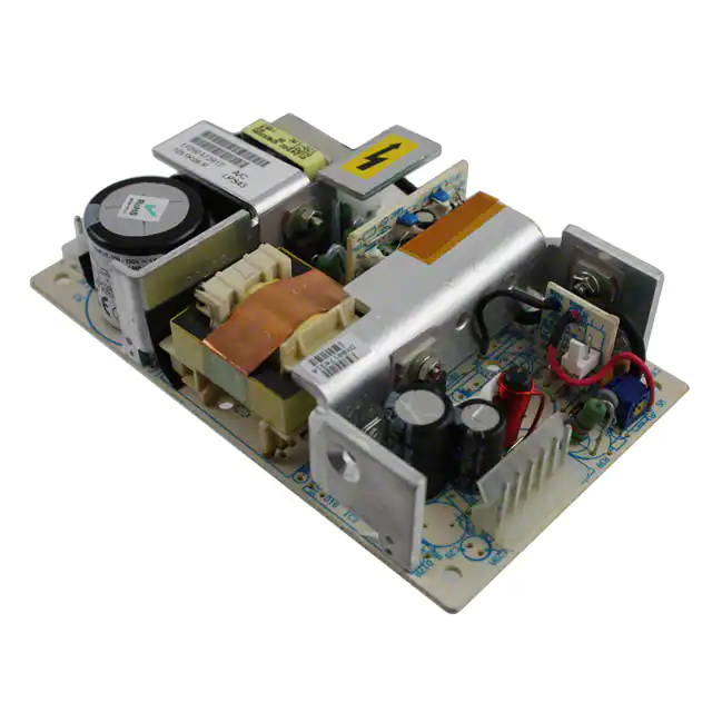

ARTESYN LPS40 SERIES 40 W Advanced Energy’s Artesyn LPS40 series of open-frame comprises four single output models, offering voltages of 5 V, 12 V, 15 V or 24 V. Each model accepts a universal input of 85 to 264 VAC or 120 to 300 VDC. All four feature medical safety approvals, with a very low safety ground leakage current of less than 75 mA. These compact switch-mode power supplies feature output overvoltage and short-circuit protection, as well as remote sense. They provide 40 W of output power with free air convection cooling and 55 watts with 30 CFM of forced air. Less than 1U high, LPS40 power supplies are designed for medical, test and measurement, single-board computers, telecommunications and networking applications. SPECIAL FEATURES SAFETY  Universal input  CUL 62368-1  3" x 5" footprint  Less than 1U high  Remote sense  Built-in EMI filter  Low output ripple  Adjustable output  Overvoltage protection  Overload protection  110 KHz switching frequency AT A GLANCE Total Power: 25 to 40 W Input Voltage: 85 to 264 VAC 120 to 300 VDC # of Outputs: Single E132002  CSA CSA 22.2-234 Level 3 LR53982C  NEMKO EN 62368-1/EMKO-TUE  CB P94100375 (74-sec) 203 Certificate and report 1119, 1125, 1126, 1127  CE Mark  UKCA Mark  LPX40 enclosure kit available  RoHS compliant ©2022 Advanced Energy Industries, Inc. LPS40 ELECTRICAL SPECIFICATIONS Input Input range 85 to 264 VAC or 120 to 300 VDC Frequency 47 to 440 Hz Inrush current < 18 A peak @ 115 VAC, < 36 A peak @ 230 VAC, cold start @ 25 °C Input current 1 A max. (RMS) @ 115 VAC Efficiency 70% typical at full load EMI filter FCC Class B conducted, CISPR 22 Class B conducted EN55022 Class B conducted, VDE 0878 PT3 class B conducted Safety ground leakage current < 0.5 mA @ 50/60 Hz, 264 VAC input Output Maximum power 40 W for convection, 55 W with 30 CFM forced air Adjustment range -5, +10% minimum Hold-up time 20 ms @ 40 W load, 115 VAC nominal line Overload protection Short circuit protection on all outputs Case overload protected @ 110% to 145% of peak rating Overvoltage protection 5 V output: 5.7 to 6.7 V. Other outputs 110% to 125% of nominal output Remote sense Compensates for 0.5 V lead drop minimum Will operate without remote sense connected Reverse connection protected ENVIRONMENTAL SPECIFICATIONS Operating temperature 0° to 50 °C ambient. Derate each output 2.5% per degree from 50 °C to 70 °C, -20 °C start up Storage temperature -40 °C to +85 °C Temperature coefficient ± 0.4% per °C Electromagnetic susceptibility Designed to meet IEC 801, -2, -3, -4, -5, -6, Level 3 Humidity Operating, non-condensing 5% to 95% RH Vibration Three orthogonal axes, sweep at 1 oct/min, 5 min. dwell at four major resonances 0.75 G peak 5 Hz to 500 Hz, operational MTBF demonstrated > 550,000 hours at full load and 25 °C ambient conditions 2 advancedenergy.com LPS40 ORDERING INFORMATION Model Number Output Voltage Minimum Load Maximum Load with Convection Cooling Maximum Load with 30 CFM Forced Air Peak Load1 Regulation2 Ripple P/P(PARD)3 LPS41 3.3 V 0A 8A 11 A 12 A ± 2% 50 mV LPS42 5V 0A 8A 11 A 12 A ± 2% 50 mV LPS43 12 V 0A 3.3 A 4.5 A 5A ± 2% 120 mV LPS44 15 V 0A 2.6 A 3.6 A 4A ± 2% 150 mV LPS45 24 V 0A 1.7 A 2.3 A 2.5 A ± 2% 240 mV LPS48 48 V 0A 0.9 A 1.2 A 1.3 A ± 2% 480 mV 1. Peak current lasting < 30 seconds with a maximum 10% duty cycle. 2. At 25 °C including initial tolerance, line voltage, load currents and output voltages adjusted to factory settings. 3. Peak-to-peak with 20 MHz bandwidth and 10 μF in parallel with a 0.1 μF capacitor at rated line voltage and load ranges. 4. T his product is a Component Power Supply and is only for inclusion by professional installers within other equipment and must not be operated as a standalone product. EMC compliance to appropriate standards must be verified at the system level. This product is for sale to OEMs and System Integrators, including through Distribution Channels. It is not intended for sale to End Users. Power Derating Curve 55W 30 CFM Forced Air Cooling 40W Output Power (Watts) 30W 20W Natural Convection Cooling 27.5W 20W 10W 0W 0°C 10°C 20°C 30°C 40°C 50°C 60°C 70°C TA – Ambient Temperature – °C advancedenergy.com 3 LPS40 MECHANICAL DRAWING 1. Specifications subject to change without notice. 2. A ll dimensions in inches (mm), tolerance is ±0.02" (±0.5 mm). 3. M ounting holes M1 and M2 should be grounded for EMI purposes. 4. Mounting hole M1 is safety ground connection. 5. S  pecifications are for convection rating at factory settings at 115 VAC input, 25 °C unless otherwise stated. 6. Warranty: 2 years. 7. Weight: 0.5 lbs/0.23kg. 4 advancedenergy.com LPS40 PIN ASSIGNMENTS Connector LPS41 LPS42 LPS43 LPS44 LPS45 LPS48 SK1-1 Line Line Line Line Line Line SK1-3 Neutral Neutral Neutral Neutral Neutral Neutral SK2-1 +3.3V +5V +12V +15V +24V +48V SK2-2 +3.3V +5V +12V +15V +24V +48V SK2-3 +3.3V +5V +12V +15V +24V +48V SK2-4 Common Common Common Common Common Common SK2-5 Common Common Common Common Common Common SK2-6 Common Common Common Common Common Common SK201-1 +Sense +Sense +Sense +Sense +Sense +Sense SK201-2 -Sense -Sense -Sense -Sense -Sense -Sense MATING CONNECTORS AC Input Molex 09-50-8031 (USA) 09-93-0300 (UK) PINS: 08-52-0113 DC Outputs Molex 09-50-8061 (USA) 09-93-0600 (UK) PINS: 08-52-0113 Remote Sense Molex 22-01-2025 PINS: 08-52-0123 Artesyn Embedded Power Connector Kit #70-841-006, includes all of the above advancedenergy.com 5 ABOUT ADVANCED ENERGY Advanced Energy (AE) has devoted more than three decades to perfecting power for its global customers. AE designs and manufactures highly engineered, precision power conversion, measurement and control solutions for mission-critical applications and processes. Our products enable customer innovation in complex applications for a wide range of industries including semiconductor equipment, industrial, manufacturing, telecommunications, data center computing, and medical. With deep applications know-how and responsive service and support across the globe, we build collaborative partnerships to meet rapid technological developments, propel growth for our customers, and innovate the future of power. For international contact information, visit advancedenergy.com. powersales@aei.com (Sales Support) productsupport.ep@aei.com (Technical Support) +1 888 412 7832 Specifications are subject to change without notice. Not responsible for errors or omissions. ©2022 Advanced Energy Industries, Inc. All rights reserved. Advanced Energy®, AE® and Artesyn™ are U.S. trademarks of Advanced Energy Industries, Inc. ENG-LPS40-235-01 4.20
