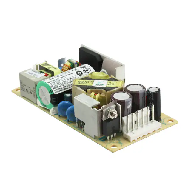

NPS43-M 数据手册
ARTESYN NPS40-M SERIES 60 W Advanced Energy's Artesyn NPS40-M series of open-frame AC-DC power supplies comprises five single output models, offering voltages of 5 V, 12 V, 15 V, 24 V or 48 V. All five models feature ITE and medical safety approvals and are equipped with dual AC fuses. The power supplies have a typical full load efficiency of 87% and a no-load power consumption of less than 300 mW. NPS40-M series power supplies are primarily designed for use in information technology equipment (ITE) and light industrial systems, as well as for equipment intended for non-patient contact and non-patient critical use in low power medical, dental and laboratory applications. SPECIAL FEATURES  0 ˚C to +80 ˚C operation  Medical and ITE safety approvals  Complies with EN61000-3-2  Universal input  Less than 1U high  2" x 4" footprint  Remote sense  Overload and short circuit protection  Adjustable output voltage  High efficiency  High MTBF  Built in EMI filter (CISPR 22 Class B)  International Efficiency Level V, Energy Star 2.0 & CeC compliant (except NPS42-M)  Less than 300 mW no-load power consumption AT A GLANCE Total Power: 40 to 60 W Input Voltage: 90 to 264 VAC 127 to 300 VDC # of Outputs: Single  Input power < 74 W  Class I approved  Class II approved (with Class A EMI)  LPX100 enclosure kit available  Dual AC fuses  RoHS compliant SAFETY  UL+CUL UL 62368-1, UL 60601-1 IEC 62368-1  CB Certificate and report  CE Mark  CQC Mark  UKCA Mark ©2022 Advanced Energy Industries, Inc. NPS40-M ELECTRICAL SPECIFICATIONS Input Input ra­nge 90 to 264 VDC or 127 to 300 VAC Frequency 47 to 63 Hz Inrush current < 50 A peak @ 230 VAC, cold start @ 25° C Input power < 74 W Efficiency 87% average (as per Energy Star 2.0 standard) (NPS42-M, 80%) EMI/RFI FCC Class B conducted, CISPR 22 Class B conducted, EN55022 Class B conducted VDE0878PT3 Class B conducted Safety ground leakage current 275 µA @ 50/60 Hz, 264 VAC input Output Maximum power 45 W for convection (NPS42-M, 40 W). 60 W with 200LFM forced air (NPS42-M, 55 W) Adjustment range ±20% minimum (-10%, +20% for NPS42-M) Hold-up time 13/75 ms 115/230 VAC input line Overload protection Short circuit protection on all outputs. Case overload protected @ 110% to 160% of normal rating Overvoltage protection 30% to 50% above nominal output Remote sense Compensated for 0.5 V lead drop max. Will operate without remote sense connected. Reverse connection protected. ENVIRONMENTAL SPECIFICATIONS Operating temperature 0 °C to 50 °C ambient derate each output at 2.5% per degree from 50 °C to 80 °C. -20 °C start up Storage temperature -45 °C to +85 °C Electromagnetic susceptibility Designed to meet EN61000-4; -2, -3, -4, -5, -6, -8, -11 Level 3 Humidity Operating, non-condensing 10% to 90% RH Vibration IEC68-2-6 to the levels of IEC721-3-2 MTBF demonstrated > 550,000 hours at full load and 25 °C ambient conditions 2 advancedenergy.com NPS40-M MECHANICAL DRAWING BARCODE M1 3.73" (94.6) 4.00" (101.6) VR1 OUTPUT VOLTAGE ADJUST POT 0.86" (21.8 max) GND TAB (CN1) PIN 1 1.72" (43.8) 2.00" (50.8) PIN 1 PIN 3 PIN 6 INPUT CONNECTOR (SK1) MODEL LABEL ROHS LABEL M2 6 PINS OUTPUT CONNECTOR (SK2) 1.00" (25.4) 0.16” (4.0) MOUNTING HOLE (4 PLACES) 0.197” (5.0) MINIMUM STANDOFF HEIGHT advancedenergy.com 3 NPS40-M ORDERING INFORMATION Output Voltage Minimum Load Maximum Load with Convection Cooling Maximum Load with 200LFM Forced Air NPS42-M 5V NPS43-M 12 V 0A 8A 0A 3.75 A NPS44-M 15 V 0A 3A NPS45-M 24 V 0A 1.9 A NPS48-M 48 V 0A 0.94 A Model Number Ripple P/P (PARD)3 Peak Load1 Regulation2 11 A 13 A ± 2% 50 mV 5A 5.5 A ± 2% 120 mV 4A 4.4 A ± 2% 150 mV 2.5 A 2.75 A ± 2% 240 mV 1.25 A 1.38 A ± 2% 480 mV 1. Peak current lasting < 15 seconds with a maximum 10% duty cycle. 2­. At 25 °C including initial tolerance, line voltage, load currents and output voltages adjusted to factory settings. 3­. Peak-to-peak with 20 MHz bandwidth and 10 µF (tantalum capacitor) in parallel with a 0.1 µF capacitor at rated line voltage and load ranges. 4. T his product is a Component Power Supply and is only for inclusion by professional installers within other equipment and must not be operated as a standalone product. EMC compliance to appropriate standards must be verified at the system level. This product is for sale to OEMs and System Integrators, including through Distribution Channels. It is not intended for sale to End Users. PIN ASSIGNMENTS Connector NPS42-M NPS43-M NPS44-M NPS45-M NPS48-M SK1-1 Line Line Line Line Line SK1-3 Neutral Neutral Neutral Neutral Neutral CN1 Ground Ground Ground Ground Ground SK2-1 +5 V +12 V +15 V +24 V +48 V SK2-2 +5 V +12 V +15 V +24 V +48 V SK2-3 Common Common Common Common Common SK2-4 Common Common Common Common Common SK2-5 -Sense -Sense -Sense -Sense -Sense SK2-6 +Sense +Sense +Sense +Sense +Sense MATING­ CONNECTORS AC Input Molex 09-50-8031 (USA) 09-91-0300 (UK) PINS: 08-52-0113 DC Outputs Molex 09-50-8061 (USA) 09-93-0600 (UK) PINS: 08-52-0113 Artesyn Embedded Power Connector Kit #70-841-006, includes all of the above Notes: 1. Specifications subject to change without notice. 2. All dimensions in inches (mm), tolerance is ±0.02"­­(±0.5 mm). 3. Mounting holes M1 and M2 should be grounded for EMI purposes. 4. Mounting hole M1 is safety ground connection. 5. S pecifications are for convection rating at factory settings at 115 VAC input, 25 °C unless otherwise stated. 6. For DC input an external DC safety rated fuse must be used. 7. Warranty: 2 years. 8. Weight: 0.26lbs/0.118kg. 4 advancedenergy.com ABOUT ADVANCED ENERGY Advanced Energy (AE) has devoted more than three decades to perfecting power for its global customers. AE designs and manufactures highly engineered, precision power conversion, measurement and control solutions for mission-critical applications and processes. Our products enable customer innovation in complex applications for a wide range of industries including semiconductor equipment, industrial, manufacturing, telecommunications, data center computing, and medical. With deep applications know-how and responsive service and support across the globe, we build collaborative partnerships to meet rapid technological developments, propel growth for our customers, and innovate the future of power. For international contact information, visit advancedenergy.com. powersales@aei.com (Sales Support) productsupport.ep@aei.com (Technical Support) +1 888 412 7832 Specifications are subject to change without notice. Not responsible for errors or omissions. ©2022 Advanced Energy Industries, Inc. All rights reserved. Advanced Energy®, AE® and Artesyn™ are U.S. trademarks of Advanced Energy Industries, Inc. ENG-NPS40-M-235-01 4.20
