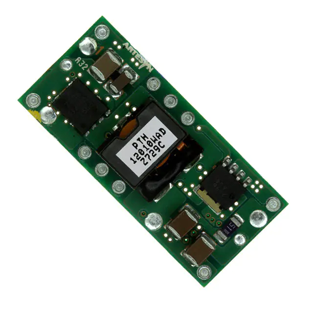

PTH12010WAD 数据手册
Embedded Power for Business-Critical Continuity Rev. 2.16.09_115 PTH12010 Series  of 6 PTH12010 12 Vin Single Output Total Power: # of Outputs: 66W Single Specifications Input Special Features Input voltage range: (See Note 3) 10.8 - 13.2 Vdc • 12 A output current • 12 V input voltage • Wide-output voltage adjust • 1.2 Vdc to 5.5 Vdc for suffix ‘W’ and 0.8 Vdc to 1.8 Vdc for suffix ‘L’ • Auto-track™ sequencing* • Margin up/down controls • Efficiencies up to 94% • Output ON/OFF inhibit • Output voltage sense • Point-of-Load-Alliance (POLA) compatible • Available RoHS compliant • 2 Year Warranty Input current: No load 10 mA typ. Remote ON/OFF: (See Note 1) Positive logic Safety • UL/cUL CAN/CSA-C22.2 No. 60950-1-03/UL 60950-1, File No. E174104 • TÜV Product Service (EN60950) Certificate No. B 04 06 38572 044 • CB Report and Certificate to IEC60950, Certificate No. US/8292/UL Start-up time: 1 V/ms Undervoltage lockout: 9.0 - 9.5 V typ. Track input voltage: Pin 8 (See Note 6) ± 0.3 Vin Suffix ‘-W’ Suffix ‘-L’ 1.2 - 5.5 Vdc 0.8 - 1.8 Vdc Output Voltage adjustability: (See Note 4) Setpoint accuracy: ± 2.0% Vo Line regulation: ± 10 mV typ. Load regulation: ± 12 mV typ. Total regulation: ± 3.0% Vo Minimum load: 0A Ripple and noise: 20 MHz bandwidth 25 mV pk-pk Temperature co-efficient: -40 °C to +85 °C ± 0.5% Vo Transient response: (See Note 5) 70 µs recovery time Margin adjustment: ± 5.0% Vo Overshoot/undershoot 100 mV All specifications are typical at nominal input, full load at 25 °C unless otherwise stated Cin = 560 µF, Cout = 0 µF *Auto-track™ is a trade mark of Texas Instruments Embedded Power for Business-Critical Continuity Rev. 2.16.09_115 PTH12010 Series  of 6 EMC Characteristics Electrostatic discharge: EN61000-4-2, IEC801-2 Conducted immunity: EN61000-4-6 Radiated immunity: EN61000-4-3 General Specifications Efficiency: See tables on page 3 Insulation voltage: Non-Isolated Switching frequency: Suffix ‘-W’ Suffix ‘-L’ 300 kHz to 400 kHz 200 kHz to 300 kHz Approvals and standards: EN60950, UL/cUL60950 Material flammability: UL94V-0 Dimensions: (L x W x H) Weight: MTBF 34.80 x 15.75 x 9.00 mm 1.370 x 0.620 x 0.354 in 5g (0.18 oz) Telcordia SR-332 7,092,000 hours Environmental Specifications Thermal performance: Operating ambient, temperature Non-operating -40° C to +85 °C -40° C to +125 °C MSL (‘Z’ suffix only) JEDEC J-STD-020C Level 3 Protection Short circuit: Auto reset 20 A typ. Embedded Power for Business-Critical Continuity Rev. 2.16.09_115 PTH12010 Series  of 6 Ordering Information Output Power (max) Input Voltage Output Voltage 66 W 10.8 - 13.2 Vdc 66 W 10.8 - 13.2 Vdc Output Currents Min Max Efficiency (max) 0.8 - 1.8 Vdc 0A 12 A 89% ±10 mV ±12 mV PTH12010L 1.2 - 5.5 Vdc 0A 12 A 94% ±10 mV ±12 mV PTH12010W Part Number System with Options Regulation Line Load M������������� odel Numbers (8, 9) PTH12010WAST Product Family Point of Load Alliance Compatible Packaging Options No Suffix = Trays T = Tape and Reel (7) Input Voltage 12 = 12 V Mounting Option (8) D = Horizontal Through-Hole (RoHS 6/6) H = Horizontal Through-Hole (RoHS 5/6) S = Surface-Mount Solder Ball (RoHS 5/6) Z = Surface-Mount Solder Ball (RoHS 6/6) Output Current 01 = 12 A Pin Option A = Through-Hole Std. Pin Length (0.140”) A = Surface-Mount Tin/Lead Solder Ball Mechanical Package Always 0 Output Voltage Code W = Wide, L = Low Voltage Output Voltage Adjustment of the PTH12010 Series The ultra-wide output voltage trim range offers major advantages to users who select the PTH12010. It is no longer necessary to purchase a variety of modules in order to cover different output voltages. The output voltage can be trimmed in a range of 1.2 V to 5.5 V for suffix ‘W’ and 0.8 Vdc to 1.8 Vdc for suffix ‘L’. When the PTH12010 converter leaves the factory the output has been adjusted to the default voltage of 1.2 V for the PTH12010W and 0.8 V for PTH12010L. Efficiency Table - PTH12010W (Io = 8 a) Output Voltage Efficiency Vo = 5.0 V 94% Vo = 3.3 V 93% Vo = 2.5 V 91% 1 2 Vo = 2.0 V 90% 3 Vo = 1.8 V 89% 4 Vo = 1.5 V 88% Vo = 1.2 V 86% Efficiency Table - PTH12010L (Io = 8 a) Output Voltage Efficiency Vo = 1.8 V 89% Vo = 1.5 V 88% Vo = 1.2 V 86% Vo = 1.0 V 84% Vo = 0.8 V 82% Notes 5 6 7 8 9 Remote ON/OFF. Positive Logic ON: Pin 3 open; or V > Vin - 0.5 V OFF: Pin 3 GND; or V
