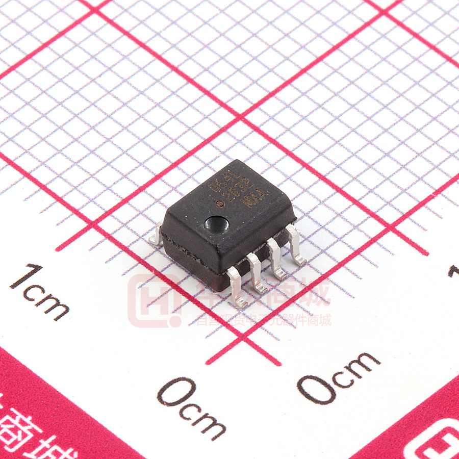

ACPL-064L-500E
ACPL-064L-500E
    AVAGO(博通)
    SOIC8_150MIL
    单向光耦 Viso=3750Vrms VF(typ)=1.3V IF=8mA SOIC8_150MIL
ACPL-064L-500E 数据手册
Data Sheet ACPL-064L, ACPL-M61L, ACPL-W61L, ACPL-K64L Low-Power 10-MBd Digital CMOS Optocouplers Description Features The Broadcom® low-power ACPL-x6xL digital optocouplers combine an AlGaAs light emitting diode (LED) and an integrated high gain photodetector. The optocoupler consumes low power, at maximum 1.3 mA IDD current per channel across temperature. With a forward LED current as low as 1.6 mA, most microprocessors can directly drive the LED.  An internal Faraday shield provides a guaranteed commonmode transient immunity specification of 20 kV/µs. Maximum AC and DC circuit isolation is achieved while maintaining TTL/CMOS compatibility.        The optocouplers' CMOS outputs are slew-rate controlled and designed to allow the rise and fall time to be controlled over a wide load-capacitance range. The ACPL-x6xL series operates from both 3.3V and 5V supply voltages with guaranteed AC and DC performance from –40°C to +105°C. These low-power optocouplers are suitable for high-speed logic interface applications.  Low IDD current: 1.3 mA/channel maximum Low input current: 1.6 mA Built-in slew-rate controlled outputs 20 kV/µs minimum Common-Mode Rejection (CMR) at VCM = 1000V High speed: 10 MBd minimum Guaranteed AC and DC performance over wide temperature: –40°C to +105°C Package selection: SO-5, SO-8, stretched SO-6, and stretched SO-8 Safety approval – UL 1577 recognized: 3750 Vrms for 1 minute for ACPL-064L/M61L and 5000 Vrms for 1 minute for ACPL-W61L/K64L – CSA approval – IEC/EN/DIN EN 60747-5-5 approval for Reinforced Insulation RoHS-compliant Applications    Communication interfaces: RS485, CANBus, and I2C Microprocessor system interfaces Digital isolation for A/D and D/A converters CAUTION! It is advised that normal static precautions be taken in handling and assembly of this component to prevent damage and/or degradation which may be induced by ESD. The components featured in this data sheet are not to be used in military or aerospace applications or environments. Broadcom AV02-2150EN January 8, 2020 ACPL-064L, ACPL-M61L, ACPL-W61L, ACPL-K64L Data Sheet Low-Power 10-MBd Digital CMOS Optocouplers Functional Diagrams ACPL-064L/K64L ACPL-M61L Anode Cathode 6 VDD 5 Vo Anode1 1 8 VDD Cathode1 2 7 Vo1 Cathode2 3 6 Vo2 Anode2 4 5 GND 1 3 4 GND SHIELD ACPL-W61L Anode 1 6 VDD NC* 2 5 Vo Cathode 3 4 GND NOTE: SHIELD A 0.1-μF bypass capacitor must be connected as close as possible between pins VDD and GND. Truth Table LED Output ON L OFF H Broadcom AV02-2150EN 2 ACPL-064L, ACPL-M61L, ACPL-W61L, ACPL-K64L Data Sheet Low-Power 10-MBd Digital CMOS Optocouplers Ordering Information The ACPL-064L and ACPL-M61L are UL recognized with an isolation voltage of 3750 Vrms for 1 minute per UL1577. The ACPL-W61L and ACPL-K64L are UL recognized with an isolation voltage of 5000 Vrms for 1 minute per UL1577. All devices are RoHS-compliant. Part Number ACPL-M61L Option RoHS-Compliant Package Surface Mount -000E SO-5 X X -500E X X X X -000E SO-8 X X X X Stretched S06 -500E -560E -000E -060E Stretched S08 X 1500 per reel 100 per tube X -000E 100 per tube 1500 per reel X -500E -060E ACPL-K64L X -060E -560E ACPL-W61L Quantity 100 per tube -060E -560E ACPL-064L UL1577 5000 Vrms / IEC/EN/DIN EN Tape and Reel 1 Minute Rating 60747-5-5 X X 1500 per reel X X X X X X X X X X X X X -500E X X X -560E X X X 1500 per reel 100 per tube 100 per tube 1000 per reel X X X 100 per tube 1000 per reel 80 per tube X 80 per tube 1000 per reel X 1000 per reel To form an ordering part number, choose a part number from the part number column and combine it with the desired option from the RoHS option column. Example: Part number ACPL-M61L-560E describes an optocoupler with a surface mount SO-5 package; delivered in Tape and Reel with 1500 parts-per-reel; with IEC/EN/DIN EN 60747-5-5 Safety Approval; and full RoHS compliance. Option data sheets are available. Contact your Broadcom sales representative or authorized distributor for information. Broadcom AV02-2150EN 3 ACPL-064L, ACPL-M61L, ACPL-W61L, ACPL-K64L Data Sheet Low-Power 10-MBd Digital CMOS Optocouplers Package Outline Drawings ACPL-064L SO-8 Package Land Pattern Recommendation 1.91 (0.075) 0.64 (0.025) 3.937 ±0.127 (0.155 ±0.005) 8 Device Part Number Lead-Free 7 6 5 NNNN V YYWW EEE • PIN 1 1 2 3 For Option x6xE Lot ID 4 0.406 ±0.076 (0.016 ±0.003) 3.95 (0.156) Date Code 5.994 ±0.203 (0.236 ±0.008) 1.270 BSC (0.050) 1.27 (0.05) *5.080 ± 0.127 (0.200 ± 0.005) 3.175 ± 0.127 (0.125 ± 0.005) 7.49 (0.295) 0.432 45° X (0.017) 7° 0 ~ 7° 1.524 (0.060) * Total package length (inclusive of mold flash) 5.207 ±0.254 (0.205 ±0.010) Dimensions in Millimeters (Inches). Note: Floating lead protrusion is 0.15 mm (6 mils) max. Lead coplanarity = 0.10 mm (0.004 inches) max. Option number 500 not marked. 0.228 ±0.025 (0.009 ±0.001) 0.203 ±0.102 (0.008 ±0.004) 0.305 Min. (0.012) ACPL-M61L SO-5 Package Land Pattern Recommendation 0.33 (0.013) Device Part Number 1.27 (0.05) 0.64 (0.025) For Option x6xE 4.4 ±0.1 (0.173 ±0.004) Lead Free NNNN V • YYWW EEE 7.0 ±0.2 (0.276 ±0.008) Date Code 4.39 (0.17) 8.26 (0.325) Lot ID Pin 1 Dot 1.80 (0.071) 0.4 ±0.05 (0.016 ±0.002) 2.54 (0.10) 3.6 ±0.1* (0.142 ±0.004) 2.5 ±0.1 (0.098 ±0.004) 1.27 BSC (0.050) 0.102 ±0.102 (0.004 ±0.004) 0.20 ±0.025 (0.008 ±0.001) Dimensions in millimeters (inches). Note: Foating Lead Protrusion is 0.15 mm (6 mils) max. * Maximum Mold flash on each side is 0.15 mm (0.006). Broadcom 7° Max. 0.71 Min. (0.028) Max. Lead Coplanarity = 0.102 (0.004) AV02-2150EN 4 ACPL-064L, ACPL-M61L, ACPL-W61L, ACPL-K64L Data Sheet Low-Power 10-MBd Digital CMOS Optocouplers ACPL-W61L Stretched SO-6 Package *4.580 ±0.254 (0.180 ±0.010) Land Pattern Recommendation 1.27 (0.050) BSG 12.65 (0.498) 6 5 4 Part Number 0.76 (0.030) For Option x6xE RoHS-Compliance Indicator NNNN V Date Code YYWW EEE Lot ID 1.91 (0.075) 1 2 3 +0.127 0 +0.005 0.268 –0.000 6.807 0.381 ±0.127 (0.015 ±0.005) ( 7° 7° 0.45 (0.018) ) 1.590 ±0.127 (0.063 ±0.005) 45° 3.180 ±0.127 (0.125 ±0.005 0.20 ±0.10 (0.008 ±0.004) *Total package width (inclusive of mold flash) 4.834 ±0.254 mm Dimensions in millimeters (inches). Lead coplanarity = 0.1 mm (0.004 inches). 0.750 ±0.250 (0.0295±0.010) 11.50 ±0.250 (0.453 ±0.010) ACPL-K64L Stretched SO-8 Package * 5.850 ±0.254 (0.230 ±0.010) 8 7 6 Land Pattern Recommendation 5 For Option x6xE Part Number Date Code RoHS-Compliance Indicator NNNN V Lot ID YYWW EEE 6.807 ±0.127 (0.268 ±0.005) 1.905 (0.1) 12.650 (0.5) 1 2 3 4 0.450 (0.018) 7° 7° 1.590 ±0.127 (0.063 ±0.005) 45° 3.180 ±0.127 (0.125 ±0.005) 1.270 (0.050) BSG 0.381 ±0.13 (0.015 ±0.005) * Total package width (inclusive of mold flash) 6.100 ±0.254 mm Dimensions in millimeters (inches). Lead coplanarity = 0.1 mm (0.004 inches). Broadcom 0.254 ±0.100 (0.010 ±0.004) 0.750 ±0.250 (0.0295±0.010) 11.5 ±0.250 (0.453 ±0.010) AV02-2150EN 5 ACPL-064L, ACPL-M61L, ACPL-W61L, ACPL-K64L Data Sheet Low-Power 10-MBd Digital CMOS Optocouplers Reflow Soldering Profile The recommended reflow soldering conditions are per JEDEC Standard J-STD-020 (latest revision). Non-halide flux should be used. Regulatory Information The ACPL-064L, ACPL-M61L, ACPL-W61L, and ACPL-K64L are approved by the following organizations:    IEC/EN/DIN EN 60747-5-5 (Option 060 only) UL — Approval under UL 1577 component recognition program up to VISO = 3750 Vrms for the ACPL-M61L/064L and VISO = 5000 Vrms for the ACPL-W61L/K64L File E55361. CSA — Approval under CSA Component Acceptance Notice #5, File CA 88324. Insulation and Safety Related Specifications Parameter Symbol ACPL-064L ACPL-M61L ACPL-W61L ACPL-K64L Unit Conditions Minimum External Air Gap (External Clearance) L(101) 4.9 5 8 mm Measured from input terminals to output terminals, shortest distance through air. Minimum External Tracking (External Creepage) L(102) 4.8 5 8 mm Measured from input terminals to output terminals, shortest distance path along body. 0.08 0.08 0.08 mm Through insulation distance conductor to conductor, usually the straight line distance thickness between the emitter and detector. 175 175 175 V IIIa IIIa IIIa Minimum Internal Plastic Gap (Internal Clearance) Tracking Resistance (Comparative Tracking Index) Isolation Group Broadcom CTI VDE 0303-11/DIN EN 60112 (2010-05) Material Group (DIN VDE 0110, 1/89, Table 1) AV02-2150EN 6 ACPL-064L, ACPL-M61L, ACPL-W61L, ACPL-K64L Data Sheet Low-Power 10-MBd Digital CMOS Optocouplers IEC/EN/DIN EN 60747-5-5 Insulation Characteristicsa (Option 060) Characteristic ACPL-064L/ ACPL-M61L ACPL-W61L/ ACPL-K64L I – IV I – IV I – III I – IV I – IV I – IV I – III 55/105/21 55/105/21 2 2 VIORM 567 1140 Vpeak Input to Output Test Voltage, Method ba VIORM x 1.875 = VPR, 100% Production Test with tm = 1s, Partial Discharge < 5 pC VPR 1063 2137 Vpeak Input to Output Test Voltage, Method aa VIORM x 1.6 = VPR, Type and Sample Test, tm = 10s, Partial Discharge < 5 pC VPR 907 1824 Vpeak VIOTM 6000 8000 Vpeak Input Currentb TS IS, INPUT Output Powerb PS, OUTPUT 150 150 600 175 230 600 °C mA mW RS >109 >109 Ω Description Symbol Unit Installation classification per DIN VDE 0110/39, Table 1 For Rated Mains Voltage ≤ 150 Vrms For Rated Mains Voltage ≤ 300 Vrms For Rated Mains Voltage ≤ 600 Vrms For Rated Mains Voltage ≤ 1000 Vrms Climatic Classification Pollution Degree (DIN VDE 0110/39) Maximum Working Insulation Voltage Highest Allowable Overvoltage (Transient Overvoltage tini = 60s) Safety-Limiting Values – maximum values allowed in the event of a failure Case Temperature Insulation Resistance at TS, VIO = 500V a. Refer to the optocoupler section of the Isolation and Control Components Designer’s Catalog, under Product Safety Regulations section, (IEC/ EN/DIN EN 60747-5-5) for a detailed description of Method a and Method b partial discharge test profiles. b. Refer to the following figures for dependence of PS and IS on ambient temperature: POWER OUTPUT – PS, INPUT CURRENT – I S PS (mW) IS (mA) 800 600 400 200 0 0 NOTE: Broadcom 25 50 75 100 125 150 175 TS – CASE TEMPERATURE (°C) Surface Mount SSO-6/SSO-8 Product POWER OUTPUT – PS , INPUT CURRENT – I S Surface Mount SO-8 Product 1000 700 PS (mW) IS (mA) 600 500 400 300 200 100 0 0 25 50 75 100 125 150 175 200 TS – CASE TEMPERATURE (°C) These optocouplers are suitable for safe electrical isolation only within the safety limit data. Maintenance of the safety data shall be ensured by means of protective circuits. AV02-2150EN 7 ACPL-064L, ACPL-M61L, ACPL-W61L, ACPL-K64L Data Sheet Low-Power 10-MBd Digital CMOS Optocouplers Absolute Maximum Ratings Parameter Symbol Min. Max. Unit Storage Temperature TS –55 +125 °C Operating Temperature TA –40 +105 °C Reverse Input Voltage VR — 5 V Supply Voltage VDD — 6.5 V IF — 8 mA IF(TRAN) — 1 A 80 mA Output Current IO — 10 mA Output Voltage VO –0.5 VDD + 0.5 V Input Power Dissipation PI — 14 mW Output Power Dissipation PO — 20 mW Lead Solder Temperature TLS — Average Forward Input Current Peak Forward Input Current (IF at 1-μs pulse width, |ILN|, LED current IF is momentarily: is momentarily: Positive (> 0) Away from the LED anode through CLA Away from the LED cathode through CLC Increased Decreased Negative (< 0) Toward the LED anode through CLA Toward the LED cathode through CLC Decreased Increased Broadcom AV02-2150EN 18 ACPL-064L, ACPL-M61L, ACPL-W61L, ACPL-K64L Data Sheet Typically, the output slew rate (rise and fall time) varies with the output load, as more time is required to charge up the higher load. The propagation delay and the PWD both increase with the load capacitance. This will be an issue especially in parallel communication because different communication lines will have different load capacitances. However, optocoupler ACPL-x6xL has a built-in slew-rate controlled feature to ensure that the output slew rate remains stable across wide load capacitance. Figure 13 shows the rise time and fall time for ACPL-x6xL at 3.3V and 5V. Figure 13: Rise and Fall Time of ACPL-x6xL across WideLoad Capacitance Rise Time (VDD = 5.0V) 30 25 Rise Time (nS) Slew-Rate Controlled Outputs Feature Low-Power 10-MBd Digital CMOS Optocouplers 20 15 10 5 0 –40 10 pF 33 pF –20 15 pF 47 pF 0 22 pF 100 pF 20 40 60 Temperature (°C) 80 100 80 100 80 100 80 100 Fall Time (VDD = 5.0V) 25 Fall Time (nS) 20 15 10 5 0 –40 10 pF 33 pF –20 15 pF 47 pF 0 22 pF 100 pF 20 40 60 Temperature (°C) Rise Time (VDD = 3.3V) 25 Rise Time (nS) 20 15 10 5 0 –40 10 pF 33 pF –20 15 pF 47 pF 0 22 pF 100 pF 20 40 60 Temperature (°C) Fall Time (VDD = 3.3V) 25 Rise Time (nS) 20 15 10 5 0 –40 Broadcom 10 pF 33 pF –20 15 pF 47 pF 0 22 pF 100 pF 20 40 60 Temperature (°C) AV02-2150EN 19 ACPL-064L, ACPL-M61L, ACPL-W61L, ACPL-K64L Data Sheet Low-Power 10-MBd Digital CMOS Optocouplers Speed Improvement Figure 15: Improvement of tp and PWD with an Added 100-pF Peaking Capacitor in Parallel of Input Limiting Resistor a. VDD = 5V, Cpeak = 47 pF, R1 = 845Ω VDD2 = 5V, IF = 2 mA 60 TPHL 50 tP or PWD (ns) A peaking capacitor can be placed across the input currentlimit resistor (Figure 14) to achieve enhanced speed performance. The value of the peaking capacitor is dependent on the rise and fall time of the input signal, supply voltages, and LED input driving current (IF). Figure 15 shows significant improvement of propagation delay and pulse width distortion with an added peak capacitor at a driving current of 2 mA and 3.3V/5V power supply. Figure 14: Connection of Peaking Capacitor (Cpeak) in Parallel with the Input Limiting Resistor (R1) to Improve Speed Performance TPLH 40 TPHL 30 TPLH No Peaking With Peaking PWD 20 10 0 –40 Cpeak –20 0 20 40 Temp (°C) 60 80 100 VDD2 + R1 V0 Vin b. VDD = 3.3V, Cpeak = 47 pF, R1 = 430Ω 0.1 μF î VDD2 = 3.3V, IF = 2 mA 60 R2 TPHL 50 SHIELD GND2 tP or PWD (ns) GND1 40 30 TPLH No Peaking With Peaking TPHL 20 10 0 –40 Broadcom TPLH PWD –20 0 20 40 Temp (°C) 60 80 100 AV02-2150EN 20 Broadcom, the pulse logo, Connecting everything, Avago Technologies, Avago, and the A logo are among the trademarks of Broadcom and/or its affiliates in the United States, certain other countries, and/or the EU. Copyright © 2016–2020 Broadcom. All Rights Reserved. The term “Broadcom” refers to Broadcom Inc. and/or its subsidiaries. For more information, please visit www.broadcom.com. Broadcom reserves the right to make changes without further notice to any products or data herein to improve reliability, function, or design. Information furnished by Broadcom is believed to be accurate and reliable. However, Broadcom does not assume any liability arising out of the application or use of this information, nor the application or use of any product or circuit described herein, neither does it convey any license under its patent rights nor the rights of others.
