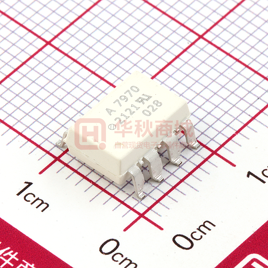

ACPL-7970-500E 数据手册
ACPL-7970 Optically Isolated Sigma-Delta Modulator Data Sheet Description Features The ACPL-7970 is a 1-bit, second-order sigma-delta (∑-∆) modulator converts an analog input signal into a highspeed data stream with galvanic isolation based on optical coupling technology. The ACPL-7970 operates from a 5 V power supply with dynamic range of 78 dB with an appropriate digital filter. The differential inputs of ±200 mV (full scale ±320 mV) are ideal for direct connection to shunt resistors or other low-level signal sources in applications such as motor phase current measurement. • • • • • • • • The analog input is continuously sampled by a means of sigma-delta over-sampling using an on-board clock. The signal information is contained in the modulator data, as a density of ones with data rate of 10 MHz, and the data are encoded and transmitted across the isolation boundary where they are recovered and decoded into high-speed data stream of digital ones and zeros. The original signal information can be reconstructed with a digital filter. The serial interface for data and clock has a wide supply range of 3 V to 5.5 V. Combined with superior optical coupling technology, the modulator delivers high noise margins and excellent immunity against isolation-mode transients. With 0.5 mm minimum distance through insulation (DTI), the ACPL‑7970 provides reliable reinforced insulation and high working insulation voltage, which is suitable for fail-safe designs. This outstanding isolation performance is superior to alternatives including devices based on capacitive- or magnetic-coupling with DTI in micro-meter range. Offered in a DIP-8 package, the isolated ADC delivers the reliability, small size, superior isolation and over-temperature performance motor drive designers need to accurately measure current at much lower price compared to traditional current transducers. • • • • 10 MHz internal clock 1-bit, second-order sigma-delta modulator 16 bits resolution no missing codes (12 bits ENOB) 78 dB SNR 6 mV/°C maximum offset drift ±1% maximum gain error Internal reference voltage ±200 mV linear range with single 5 V supply (±320 mV full scale) 3 V to 5.5 V wide supply range for digital interface -40° C to +105° C operating temperature range 25 kV/ms common-mode transient immunity Safety and regulatory approvals: – IEC/EN/DIN EN 60747-5-5: 891 Vpeak working insulation voltage – UL 1577: 5000 Vrms/1min isolation voltage – CSA: Component Acceptance Notice #5 Applications • • • • • • Motor phase and rail current sensing Power inverter current and voltage sensing Industrial process control Data acquisition systems General purpose current and voltage sensing Traditional current transducer replacements Functional Block Diagram VDD2 VDD1 VIN+ VIN– The external clock version modulator ACPL-796J (SO-16 package) is also available. Σ-∆ MODULATOR/ ENCODER LED DRIVER DECODER BUF SHIELD GND1 MCLK MDAT CLK VREF CAUTION: It is advised that normal static precautions be taken in handling and assembly of this component to prevent damage and/or degradation which may be induced by ESD. GND2 Pin Configuration and Descriptions VDD1 1 VIN+ 2 VIN– 3 ACPL-7970 GND1 4 8 VDD2 7 MCLK 6 MDAT 5 GND2 Figure 1. Pin configuration. Table 1. Pin descriptions. Pin No. Symbol Description 1 VDD1 Supply voltage for signal input side (analog side), relative to GND1 2 VIN+ Positive analog input, recommended input range ±200 mV 3 VIN– Negative analog input, recommended input range ±200 mV (normally connected to GND1) 4 GND1 Supply ground for signal input side 5 GND2 Supply ground for data/clock output side (digital side) 6 MDAT Modulator data output 7 MCLK Modulator clock output 8 VDD2 Supply voltage for data output side, relative to GND2 Table 2. Ordering Information ACPL-7970 is UL recognized with 5000 Vrms/1 minute rating per UL 1577. Part number Option (RoHS Compliant) ACPL-7970 -000E -300E -500E Package 300 mil DIP-8 Surface Mount Gull Wing X X X X Tape & Reel X IEC/EN/DIN EN 60747-5-5 Quantity X 50 per tube X 50 per tube X 1000 per reel To order, choose a part number from the part number column and combine with the desired option from the option column to form an order entry. Example: ACPL-7970-500E to order product of Surface Mount package in Tape and Reel packaging with IEC/EN/DIN EN 60747-5-5 Safety Approval and RoHS compliance. Option datasheets are available. Contact your Avago sales representative or authorized distributor for information. 2 Package Outline Drawings Standard DIP Package 9.80 ± 0.25 (0.386 ± 0.010) 8 7 6 5 Dimensions in millimeters and (inches). DATE CODE A 7970 YYWW 1 1.19 (0.047) MAX. 3.56 ± 0.13 (0.140 ± 0.005) 2 3 Note: Floating lead protrusion is 0.5 mm (20 mils) max. 7.62 ± 0.25 (0.300 ± 0.010) 4 1.78 (0.070) MAX. 6.35 ± 0.25 (0.250 ± 0.010) 4.70 (0.185) MAX. 0.51 (0.020) MIN. 2.92 (0.115) MIN. 1.080 ± 0.320 (0.043 ± 0.013) 0.65 (0.025) MAX. 5˚ TYP. 0.20 (0.008) 0.33 (0.013) 2.54 ± 0.25 (0.100 ± 0.010) Note: Initial or continued variation in the color of the white mold compound is normal and does not affect device performance or reliability. Figure 2. 3 Gull Wing Surface Mount Option 300 LAND PATTERN RECOMMENDATION 9.80 ± 0.25 (0.386 ± 0.010) 8 7 6 1.016 (0.040) 5 6.350 ± 0.25 (0.025 ± 0.010) A 7970 YYWW 1 2 3 10.9 (0.430) 4 1.27 (0.050) 1.780 (0.070) MAX. 1.19 (0.047) MAX. 9.65 ± 0.25 (0.380 ± 0.010) 7.62 ± 0.25 (0.300 ± 0.010) 3.56 ± 0.13 (0.140 ± 0.005) 1.080 ± 0.320 (0.043 ± 0.013) 2.54 (0.100) BSC Dimensions in millimeters (inches). Tolerances (unless otherwise specified): xx.xx = 0.01 xx.xxx = 0.005 Note: Foating lead protrusion is 0.5 mm (20 mils) max. 0.635 ± 0.130 (0.025 ± 0.005) 0.635 ± 0.25 (0.025 ± 0.010) 2.0 (0.080) 0.20 (0.008) 0.33 (0.013) 12° NOM. Lead coplanarity Maximum: 0.102 (0.004) Figure 3. Recommended Pb-Free IR Profile Recommended reflow condition as per JEDEC Standard, J-STD-020 (latest revision). Non-Halide Flux should be used. Regulatory Information The ACPL-7970 is approved by the following organizations: IEC/EN/DIN EN 60747-5-5 CSA Approved with Maximum Working Insulation Voltage VIORM = 891 Vpeak. Approval under CSA Component Acceptance Notice #5, File CA 88324. UL Approval under UL 1577, component recognition program up to VISO = 5000 Vrms/1min. File E55361. 4 Table 3. IEC/EN/DIN EN 60747-5-5 Insulation Characteristics [1] Description Symbol Value Installation classification per DIN VDE 0110/1.89, Table 1 for rated mains voltage ≤ 150 Vrms for rated mains voltage ≤ 300 Vrms for rated mains voltage ≤ 450 V rms for rated mains voltage ≤ 600 Vrms I-IV I-IV I-IV I-IV Climatic Classification 55/105/21 Pollution Degree (DIN VDE 0110/1.89) 2 Units Maximum Working Insulation Voltage VIORM 891 Vpeak Input to Output Test Voltage, Method b VIORM x 1.875 = VPR, 100% Production Test with tm = 1 sec, Partial Discharge < 5 pC VPR 1671 Vpeak Input to Output Test Voltage, Method a VIORM x 1.6 = VPR, Type and Sample Test, tm = 10 sec, Partial Discharge < 5 pC VPR 1426 Vpeak Highest Allowable Overvoltage (Transient Overvoltage, tini = 60 sec) VIOTM 8000 Vpeak Safety-limiting values (Maximum values allowed in the event of a failure) Case Temperature Input Current [2] Output Power [2] TS IS,INPUT PS,OUTPUT 175 400 600 °C mA mW Insulation Resistance at TS, VIO = 500 V RS ≥ 109 Ω Notes: 1. Insulation characteristics are guaranteed only within the safety maximum ratings, which must be ensured by protective circuits within the application. 2. Safety-limiting parameters are dependent on ambient temperature. The Input Current, IS,INPUT, derates linearly above 25° C free-air temperature at a rate of 2.67 mA/°C; the Output Power, PS,OUTPUT, derates linearly above 25° C free-air temperature at a rate of 4 mW/°C. Table 4. Insulation and Safety Related Specifications Parameter Symbol Value Units Conditions Minimum External Air Gap (External Clearance) L(101) 7.4 mm Measured from input terminals to output terminals, shortest distance through air Minimum External Tracking (External Creepage) L(102) 8.0 mm Measured from input terminals to output terminals, shortest distance path along body 0.5 mm Through insulation distance, conductor to conductor, usually the direct distance between the photoemitter and photodetector inside the optocoupler cavity >175 V DIN IEC 112/VDE 0303 Part 1 Minimum Internal Plastic Gap (Internal Clearance) Tracking Resistance (Comparative Tracking Index) Isolation Group 5 CTI IIIa Material Group (DIN VDE 0110, 1/89, Table 1) Table 5. Absolute Maximum Ratings Parameter Symbol Min. Max. Units Storage Temperature TS -55 +125 °C Ambient Operating Temperature TA -40 +105 °C Supply Voltage VDD1, VDD2 -0.5 6.0 V Steady-State Input Voltage [1, 3] VIN+, VIN– -2 VDD1 + 0.5 V Two-Second Transient Input Voltage [2] VIN+, VIN– -6 VDD1 + 0.5 V Digital Output Voltages MCLK, MDAT -0.5 VDD2 + 0.5 V Lead Solder Temperature 260° C for 10 sec., 1.6 mm below seating plane Notes: 1. DC voltage of up to -2 V on the inputs does not cause latch-up or damage to the device; tested at typical operating conditions. 2. Transient voltage of 2 seconds up to -6 V on the inputs does not cause latch-up or damage to the device; tested at typical operating conditions. 3. Absolute maximum DC current on the inputs = 100 mA, no latch-up or device damage occurs. Table 6. Recommended Operating Conditions Parameter Symbol Min. Max. Units Ambient Operating Temperature TA -40 +105 °C VDD1 Supply Voltage VDD1 4.5 5.5 V VDD2 Supply Voltage VDD2 3 5.5 V Input Voltage Range [1] VIN+, VIN– -200 +200 mV Notes: 1. Full scale input range ±320 mV. 6 Table 7. Electrical Specifications Unless otherwise noted, TA = -40° C to +105° C, VDD1 = 4.5 V to 5.5 V, VDD2 = 3 V to 5.5 V, VIN+ = -200 mV to +200 mV, and VIN– = 0 V (single-ended connection); tested with Sinc3 filter, 256 decimation ratio. Parameter Symbol Min. Typ.[1] Max. Units Test Conditions/Notes Bits Decimation filter output set to 16 bits Fig. STATIC CHARACTERISTICS Resolution Integral Nonlinearity 16 INL -15 3 15 LSB TA = -40° C to +85° C; see Definitions section -25 3 25 LSB TA = 85° C to 105° C 0.9 LSB No missing codes, guaranteed by design; see Definitions section 0.4 2 mV TA = -40° C to +105° C; see Definitions section 2 6 mV/°C VDD1 = 5 V Differential Nonlinearity DNL -0.9 Offset Error VOS -2 Offset Drift vs. Temperature TCVOS Offset Drift vs. VDD1 Internal Reference Voltage VREF Reference Voltage Tolerance GE VREF Drift vs. Temperature 220 mV/V 320 mV -1 1 % TA = 25° C, VIN+ = -320 to +320 mV; see Definitions section -2 2 % TA = -40° C to +105° C, VIN+ = -320 to +320 mV TCGE VREF Drift vs. VDD1 60 ppm/°C -1.3 mV/V Note 4 5 6 ANALOG INPUTS Full-Scale Differential Voltage Input Range FSR 320 mV VIN = VIN+ – VIN–; Note 2 Average Input Bias Current IINA -0.3 mA VDD1 = 5V, VDD2 = 5V, VIN+ = 0 V; Note 3 Average Input Resistance RIN 24 kΩ Across VIN+ or VIN– to GND1; Note 3 Input Capacitance CINA 8 pF Across VIN+ or VIN– to GND1 DYNAMIC CHARACTERISTICS 7 VIN+ = 400 mVpp, 1 kHz sine wave Signal-to-Noise Ratio SNR 68 78 dB TA = -40° C to +105° C; see Definitions section 8 Signal-to-(Noise + Distortion) Ratio SNDR 65 75 dB TA = -40° C to +105° C; see Definitions section 9 Effective Number of Bits ENOB 12 Bits see Definitions section Isolation Transient Immunity CMR 25 kV/ms VCM = 1 kV; See Definitions section Common-Mode Rejection Ratio CMRR 74 dB DIGITAL OUTPUTS Output High Voltage VOH Output Low Voltage VOL V IOUT = -200 mA 0.6 V IOUT = +1.6 mA VDD2 – VDD2 – 0.2 0.1 POWER SUPPLY VDD1 Supply Current IDD1 9 14 mA VIN+ = –320 mV to +320 mV 10 VDD2 Supply Current IDD2 5.2 8 mA VDD2 = 5 V supply 11 4.6 7 mA VDD2 = 3.3 V supply 12 Notes: 1. All Typical values are at TA = 25° C, VDD1 = 5 V, VDD2 = 5 V. 2. Beyond the full-scale input range the data output is either all zeroes or all ones. 3. Because of the switched-capacitor nature of the isolated modulator, time averaged values are shown. 4. VREF Drift vs. VDD1 can be expressed as –0.4%/V with reference to VREF. 7 Table 8. Timing Specifications Unless otherwise noted, TA = -40° C to +105° C, VDD1 = 4.5 V to 5.5 V, VDD2 = 3 V to 5.5 V. Parameter Symbol Min. Typ. Max. Units Test Conditions/Notes Fig. Modulator Clock Output Frequency fMCLK 9 10 11 MHz Clock duty cycle 40% to 60% 13 Data Access Time After MCLK Rising Edge tA 40 ns CL = 15 pF 4 Data Hold Time After MCLK Rising Edge tH ns CL = 15 pF 4 Unit Test Condition Note Vrms RH < 50%, t = 1 min; TA = 25° C 1, 2 Ω VI-O = 500 VDC 3 Ω TA = 100° C 3 pF f = 1 MHz 3 10 MCLK tA tH MDAT Figure 4. Data timing. Table 9. Package Characteristics Parameter Symbol Min. Input-Output Momentary Withstand Voltage VISO 5000 Input-Output Resistance RI-O 1012 Typ. 1013 1011 Input-Output Capacitance CI-O 1.4 Max. Notes: 1. In accordance with UL 1577, each optocoupler is proof tested by applying an insulation test voltage ≥ 6000 Vrms for 1 second (leakage detection current limit, II-O ≤ 5 µA). This test is performed before the 100% production test for partial discharge (method b) shown in IEC/EN/DIN EN 607475-5 Insulation Characteristic Table. 2. The Input-Output Momentary Withstand Voltage is a dielectric voltage rating that should not be interpreted as an input-output continuous voltage rating. For the continuous voltage rating, refer to the IEC/EN/DIN EN 60747-5-5 insulation characteristics table and your equipment level safety specification. 3. This is a two-terminal measurement: pins 1–4 are shorted together and pins 5–8 are shorted together. 8 Typical Performance Plots Unless otherwise noted, TA = 25° C, VDD1 = 5 V, VDD2 = 5 V, VIN+ = –200 mV to +200 mV, and VIN– = 0 V, with Sinc3 filter, 256 decimation ratio. 2.0 335 1.5 330 325 0.5 VREF (mV) VOS (mV) 1.0 0.0 -0.5 320 315 -1.0 310 -1.5 -2.0 -55 -35 -15 5 25 45 65 Temperature (°C) 85 105 305 125 Figure 5. Offset change vs. temperature. 20 SNR (dB) IIN+ (µA) 10 0 -10 -20 0 80 VIN+ (mV) 160 240 320 400 5 25 45 65 Temperature (°C) 85 105 125 86 84 82 80 78 76 74 72 70 68 66 -55 -35 -15 5 25 45 65 Temperature (°C) 85 105 125 12.0 11.0 10.0 9.0 8.0 7.0 25° C -40° C 105° C 6.0 -55 -35 -15 5 Figure 9. SNDR vs. temperature. 9 -15 Figure 8. SNR vs. temperature. IDD1 (mA) SNDR (dB) Figure 7. Input current vs. input voltage. 86 84 82 80 78 76 74 72 70 68 66 -35 Figure 6. VREF change vs. temperature 30 -30 -400 -320 -240 -160 -80 -55 25 45 65 Temperature (°C) 85 105 125 5.0 -400 -300 -200 -100 0 100 VIN (mV) 200 Figure 10. IDD1 vs. VIN DC input at various temperatures. 300 400 8.0 8.0 VDD2 = 5 V 7.0 25° C -40° C 105° C 7.0 IDD2 (mA) IDD2 (mA) 5.0 4.0 3.0 3.0 -300 -200 -100 0 100 VIN (mV) 200 300 400 Figure 11. IDD2 (VDD2 = 5 V) vs. VIN DC input at various temperatures. Clock Frequency (MHz) 5.0 4.0 2.0 -400 -55 -35 -15 5 25 45 65 Temperature (°C) 85 105 2.0 -400 -300 -200 -100 0 100 VIN (mV) 200 300 Figure 12. IDD2 (VDD2 = 3.3V) vs. VIN DC input at various temperatures. 4.5V 5V 5.5V Figure 13. Clock frequency vs. temperature for various VDD1. 10 25°C -40°C 105°C 6.0 6.0 10.5 10.4 10.3 10.2 10.1 10.0 9.9 9.8 9.7 9.6 9.5 VDD2 = 3.3 V 125 400 Definitions Effective Number of Bits (ENOB) Integral Nonlinearity (INL) The ENOB determines the effective resolution of an ADC, expressed in bits, defined by ENOB = (SNDR − 1.76)/6.02 INL is the maximum deviation of a transfer curve from a straight line passing through the endpoints of the ADC transfer function, with offset and gain errors adjusted out. Differential Nonlinearity (DNL) DNL is the deviation of an actual code width from the ideal value of 1 LSB between any two adjacent codes in the ADC transfer curve. DNL is a critical specification in closed-loop applications. A DNL error of less than ±1 LSB guarantees no missing codes and a monotonic transfer function. Offset Error Offset error is the deviation of the actual input voltage corresponding to the mid-scale code (32,768 for a 16-bit system with an unsigned decimation filter) from 0 V. Offset error can be corrected by software or hardware. Gain Error (Full-Scale Error) Gain error includes positive full-scale gain error and negative full-scale gain error. Positive full-scale gain error is the deviation of the actual input voltage corresponding to positive full-scale code (65,535 for a 16-bit system) from the ideal differential input voltage (VIN+ – VIN– = +320 mV), with offset error adjusted out. Negative fullscale gain error is the deviation of the actual input voltage corresponding to negative full-scale code (0 for a 16-bit system) from the ideal differential input voltage (VIN+ – VIN– = -320 mV), with offset error adjusted out. Gain error includes reference error. Gain error can be corrected by software or hardware. Signal-to-Noise Ratio (SNR) The SNR is the measured ratio of AC signal power to noise power below half of the sampling frequency. The noise power excludes harmonic signals and DC. Signal-to-(Noise + Distortion) Ratio (SNDR) The SNDR is the measured ratio of AC signal power to noise plus distortion power at the output of the ADC. The signal power is the rms amplitude of the fundamental input signal. Noise plus distortion power is the rms sum of all non-fundamental signals up to half the sampling frequency (excluding DC). 11 Isolation Transient Immunity (CMR) The isolation transient immunity (also known as CommonMode Rejection or CMR) specifies the minimum rate-ofrise/fall of a common-mode signal applied across the isolation boundary beyond which the modulator clock or data is corrupted. Product Overview Description The ACPL-7970 isolated sigma-delta (∑-∆) modulator converts an analog input signal into a high-speed (10 MHz typical) single-bit data stream by means of a sigmadelta over-sampling modulator. The time average of the modulator data is directly proportional to the input signal voltage. The modulator uses internal clock of 10 MHz. The modulator data are encoded and transmitted across the isolation boundary where they are recovered and decoded into high-speed data stream of digital ones and zeros. The original signal information is represented by the density of ones in the data output. The other main function of the modulator (optocoupler) is to provide galvanic isolation between the analog signal input and the digital data output. It provides high noise margins and excellent immunity against isolation-mode transients that allows direct measurement of low-level signals in highly noisy environments, for example measurement of motor phase currents in power inverters. With 0.5 mm minimum DTI, the ACPL-7970 provides reliable double protection and high working insulation voltage, which is suitable for fail-safe designs. This outstanding isolation performance is superior to alternatives including devices based on capacitive- or magneticcoupling with DTI in micro-meter range. Offered in an DIP-8 package, the isolated ADC delivers the reliability, small size, superior isolation and over-temperature performance motor drive designers need to accurately measure current at much lower price compared to traditional current transducers. Analog Input Latch-up Consideration The differential analog inputs of the ACPL-7970 are implemented with a fully-differential, switched-capacitor circuit. The ACPL-7970 accepts signal of ±200 mV (full scale ±320 mV), which is ideal for direct connection to shunt based current sensing or other low-level signal sources applications such as motor phase current measurement. An internal voltage reference determines the full-scale analog input range of the modulator (±320 mV); an input range of ±200 mV is recommended to achieve optimal performance. Users are able to use higher input range, for example ±250 mV, as long as within full-scale range, for purpose of over-current or overload detection. Figure 14 shows the simplified equivalent circuit of the analog input. Latch-up risk of CMOS devices needs careful consideration, especially in applications with direct connection to signal source that is subject to frequent transient noise. The analog input structure of the ACPL-7970 is designed to be resilient to transients and surges, which are often encountered in highly noisy application environments such as motor drive and other power inverter systems. Other situations could cause transient voltages to the inputs include short circuit and overload conditions. The ACPL-7970 is tested with DC voltage of up to -2 V and 2-second transient voltage of up to -6 V to the analog inputs with no latch-up or damage to the device. In the typical application circuit (Figure 19), the ACPL-7970 is connected in a single-ended input mode. Given the fully differential input structure, a differential input connection method (balanced input mode as shown in Figure 15) is recommended to achieve better performance. The input currents created by the switching actions on both of the pins are balanced on the filter resistors and cancelled out each other. Any noise induced on one pin will be coupled to the other pin by the capacitor C and creates only common mode noise which is rejected by the device. Typical values for Ra (= Rb) and C are 22 Ω and 10 nF respectively. Input signal information is contained in the modulator output data stream, represented by the density of ones and zeros. The density of ones is proportional to the input signal voltage, as shown in Figure 16. A differential input signal of 0 V ideally produces a data stream of ones and zeros in equal densities. A differential input of -200 mV corresponds to 18.75% density of ones, and a differential input of +200 mV is represented by 81.25% density of ones in the data stream. A differential input of +320 mV or higher results in ideally all ones in the data stream, while input of -320 mV or lower will result in all zeros ideally. Table 5 shows this relationship. Modulator Data Output 200 Ω (TYP) VIN+ fSWITCH = MCLK 5V 3 pF (TYP) 1.5 pF VDD1 Ra ANALOG GROUND fSWITCH = MCLK COMMON MODE VOLTAGE 1.5 pF VIN– +Analog Input VIN+ 3 pF (TYP) –Analog Input VIN– 200 Ω (TYP) Figure 14. Analog input equivalent circuit. MODULATOR OUTPUT ACPL-7970 C Rb GND1 Figure 15. Simplified differential input connection diagram. +FS (ANALOG INPUT) 0 V (ANALOG INPUT) –FS (ANALOG INPUT) ANALOG INPUT TIME Figure 16. Modulator output vs. analog input. 12 Table 10. Input voltage with ideal corresponding density of 1s at modulator data output, and ADC code. Analog Input Voltage Input Density of 1s ADC Code (16-bit unsigned decimation) Full-Scale Range 640 mV +Full-Scale +320 mV 100% 65,535 +Recommended Input Range +200 mV 81.25% 53,248 Zero 0 mV 50% 32,768 –Recommended Input Range -200 mV 18.75% 12,288 –Full-Scale -320 mV 0% 0 Notes: 1. With bipolar offset binary coding scheme, the digital code begins with digital 0 at –FS input and increases proportionally to the analog input until the full-scale code is reached at the +FS input. The zero crossing occurs at the mid-scale input. 2. Ideal density of 1s at modulator data output can be calculated with VIN/640 mV + 50%; similarly, the ADC code can be calculated with (VIN/640 mV) × 65,536 + 32,768, assuming a 16-bit unsigned decimation filter. Digital Filter A digital filter converts the single-bit data stream from the modulator into a multi-bit output word similar to the digital output of a conventional A/D converter. With this conversion, the data rate of the word output is also reduced (decimation). A Sinc3 filter is recommended to ISOLATION BARRIER ISOLATED 5V INPUT CURRENT RSHUNT 1 µF work together with the ACPL-7970. With 256 decimation ratio and 16-bit word settings, the output data rate is 39 kHz (= 10 MHz/256). This filter can be implemented in an ASIC, an FPGA or a DSP. Some of the ADC codes with corresponding input voltages are shown in Table 5. NONISOLATED 5 V/3.3 V VDD1 VDD2 VIN+ MCLK 0.1 µF VIN– MDAT GND1 GND2 VDD 0.1 µF 1 µF CLOCK SCLK SDAT DATA CS GND SINC3 FILTER GND1 ACPL-7970 GND2 Note: In applications, 1 mF/0.1 mF bypass capacitors are recommended to connect between pins VDD1 and GND1, and between pins VDD2 and GND2 of the ACPL-7970. Figure 17. Typical application circuit with a Sinc3 filter. 13 3-WIRE SERIAL INTERFACE Digital Interface IC The HCPL-0872 Digital Interface IC (SO-16 package) is a digital filter that converts the single-bit data stream from the modulator into 15-bit output words and provides a serial output interface that is compatible with SPI, QSPI, and Microwire protocols, allowing direct connection to a microcontroller. Instead of a digital filter implemented in software, the HCPL-0872 can be used together with the ACPL-7970 to form an isolated programmable two-chip A/D converter. Available in an SO-16 surface-mount package, the Digital Interface IC has features include five different conversion modes (combinations of speed and resolution), three different pre-trigger modes (allows conversion time < 1 ms), offset calibration, fast over-range (over-current, or short circuits) detection, and adjustable threshold detection. ISOLATION BARRIER ISOLATED 5V INPUT CURRENT RSHUNT 1 µF Programmable features are configured via the Serial Configuration port. A second multiplexed input is available to allow measurements with a second isolated modulator without additional hardware. Refer to the HCPL-0872 data sheet for details. Notes: SPI and QSPI are trademarks of Motorola Corp. Microwire is a trademark of National Semiconductor Inc. Application Information Digital Current Sensing Circuit Figure 19 shows a typical application circuit for motor control phase current sensing. By choosing the appropriate shunt resistance, a wide range of current can be monitored, from less than 1 A to more than 100 A. NONISOLATED 5V VDD1 VDD2 VIN+ MCLK VDD 0.1 µF VIN– MDAT GND1 GND2 0.1 µF SCLK MCLK1 1 µF SDAT CS MDAT1 3-WIRE SERIAL INTERFACE GND HCPL-0872 GND1 GND2 ACPL-7970 Figure 18. Typical application circuit with the HCPL-0872. FLOATING POSITIVE SUPPLY HV+ GATE DRIVE CIRCUIT R2a MOTOR D1 5.1 V C1a 1 µF C1b 0.1 µF 22 Ω C2 + – R2b 22 Ω RSENSE 10 nF VDD2 VDD1 MCLK VIN+ VIN– MDAT GND1 GND2 ACPL-7970 HV – Figure 19. Typical application circuit for motor phase current sensing. 14 NONISOLATED 5 V/3.3 V ISOLATION BARRIER R1 C3a 0.1 µF GND2 C3b 1 µF Power Supplies and Bypassing PC Board Layout As shown in Figure 19, a floating power supply (which in many applications could be the same supply that is used to drive the high-side power transistor) is regulated to 5 V using a simple zener diode (D1); the value of resistor R1 should be chosen to ensure sufficient current can be supplied from the existing floating supply. The voltage from the current sensing resistor or shunt (RSENSE) is applied to the input of the ACPL-7970 through an RC antialiasing filter (R2 and C2). And finally, a clock is connected to the ACPL-7970 and data are connected to the digital filter. Although the application circuit is relatively simple, a few recommendations should be followed to ensure optimal performance. The design of the printed circuit board (PCB) should follow good layout practices, such as keeping bypass capacitors close to the supply pins, keeping output signals away from input signals, the use of ground and power planes, etc. In addition, the layout of the PCB can also affect the isolation transient immunity (CMR) of the isolated modulator, due primarily to stray capacitive coupling between the input and the output circuits. To obtain optimal CMR performance, the layout of the PC board should minimize any stray coupling by maintaining the maximum possible distance between the input and output sides of the circuit and ensuring that any ground or power plane on the PC board does not pass directly below or extend much wider than the body of the isolated modulator. The power supply for the isolated modulator is most often obtained from the same supply used to power the power transistor gate drive circuit. If a dedicated supply is required, in many cases it is possible to add an additional winding on an existing transformer. Otherwise, some sort of simple isolated supply can be used, such as a line powered transformer or a high-frequency DC-DC converter. An inexpensive 78L05 three terminal regulator can also be used to reduce the floating supply voltage to 5 V. To help attenuate high-frequency power supply noise or ripple, a resistor or inductor can be used in series with the input of the regulator to form a low-pass filter with the regulator’s input bypass capacitor. As shown in Figure 19, bypass capacitors (C1a, C1b, C3a and C3b) should be located as close as possible to the input and output power-supply pins of the isolated modulator. The bypass capacitors are required because of the high-speed digital nature of the signals inside the isolated modulator. A bypass capacitor (C2) is also recommended at the input due to the switched-capacitor nature of the input circuit. The input bypass capacitor also forms part of the anti-aliasing filter, which is recommended to prevent high frequency noise from aliasing down to lower frequencies and interfering with the input signal. MOTOR OUTPUT POWER - HORSEPOWER 40 440 V 380 V 220 V 120 V 35 30 25 15 10 5 0 5 10 15 20 25 MOTOR PHASE CURRENT - A (rms) 30 35 Figure 20. Motor Output Horsepower vs. Motor Phase Current and Supply. 15 The current-sensing shunt resistor should have low resistance (to minimize power dissipation), low inductance (to minimize di/dt induced voltage spikes which could adversely affect operation), and reasonable tolerance (to maintain overall circuit accuracy). Choosing a particular value for the shunt is usually a compromise between minimizing power dissipation and maximizing accuracy. Smaller shunt resistances decrease power dissipation, while larger shunt resistances can improve circuit accuracy by utilizing the full input range of the isolated modulator. The first step in selecting a shunt is determining how much current the shunt will be sensing. The graph in Figure 20 shows the RMS current in each phase of a threephase induction motor as a function of average motor output power (in horsepower, hp) and motor drive supply voltage. The maximum value of the shunt is determined by the current being measured and the maximum recommended input voltage of the isolated modulator. The maximum shunt resistance can be calculated by taking the maximum recommended input voltage and dividing by the peak current that the shunt should see during normal operation. For example, if a motor will have a maximum RMS current of 10 A and can experience up to 50% overloads during normal operation, then the peak current is 21.1 A (= 10 x 1.414 x 1.5). Assuming a maximum input voltage of 200 mV, the maximum value of shunt resistance in this case would be about 10 mΩ. The maximum average power dissipation in the shunt can also be easily calculated by multiplying the shunt resistance times the square of the maximum RMS current, which is about 1 W in the previous example. 20 0 Shunt Resistors If the power dissipation in the shunt is too high, the resistance of the shunt can be decreased below the maximum value to decrease power dissipation. The minimum value of the shunt is limited by precision and accuracy requirements of the design. As the shunt value is reduced, the output voltage across the shunt is also reduced, which means that the offset and noise, which are fixed, become a larger percentage of the signal amplitude. The selected value of the shunt will fall somewhere between the minimum and maximum values, depending on the particular requirements of a specific design. When sensing currents large enough to cause significant heating of the shunt, the temperature coefficient (tempco) of the shunt can introduce nonlinearity due to the signal dependent temperature rise of the shunt. The effect increases as the shunt-to-ambient thermal resistance increases. This effect can be minimized either by reducing the thermal resistance of the shunt or by using a shunt with a lower tempco. Lowering the thermal resistance can be accomplished by repositioning the shunt on the PC board, by using larger PC board traces to carry away more heat, or by using a heat sink. For a two-terminal shunt, as the value of shunt resistance decreases, the resistance of the leads becomes a significant percentage of the total shunt resistance. This has two primary effects on shunt accuracy. First, the effective resistance of the shunt can become dependent on factors such as how long the leads are, how they are bent, how far they are inserted into the board, and how far solder wicks up the lead during assembly (these issues will be discussed in more detail shortly). Second, the leads are typically made from a material such as copper, which has a much higher tempco than the material from which the resistive element itself is made, resulting in a higher tempco for the shunt overall. Both of these effects are eliminated when a four-terminal shunt is used. A four-terminal shunt has two additional terminals that are Kelvin-connected directly across the resistive element itself; these two terminals are used to monitor the voltage across the resistive element while the other two terminals are used to carry the load current. Because of the Kelvin connection, any voltage drops across the leads carrying the load current should have no impact on the measured voltage. Several four-terminal shunts from Isotek (Isabellenhütte) suitable for sensing currents in motor drives up to 71 Arms (71 hp or 53 kW) are shown in Table 11; the maximum current and motor power range for each of the PBV series shunts are indicated. For shunt resistances from 50 mΩ down to 10 mΩ, the maximum current is limited by the input voltage range of the isolated modulator. For the 5 mΩ and 2 mΩ shunts, a heat sink may be required due to the increased power dissipation at higher currents. When laying out a PC board for the shunts, a couple of points should be kept in mind. The Kelvin connections to the shunt should be brought together under the body of the shunt and then run very close to each other to the input of the isolated modulator; this minimizes the loop area of the connection and reduces the possibility of stray magnetic fields from interfering with the measured signal. If the shunt is not located on the same PC board as the isolated modulator circuit, a tightly twisted pair of wires can accomplish the same thing. Also, multiple layers of the PC board can be used to increase current carrying capacity. Numerous plated-through vias should surround each non-Kelvin terminal of the shunt to help distribute the current between the layers of the PC board. The PC board should use 2 or 4 oz. copper for the layers, resulting in a current carrying capacity in excess of 20 A. Making the current carrying traces on the PC board fairly large can also improve the shunt’s power dissipation capability by acting as a heat sink. Liberal use of vias where the load current enters and exits the PC board is also recommended. Table 11. Isotek (Isabellenhütte) four-terminal shunt summary. Shunt Resistance Tol. Maximum RMS Current Motor Power Range 120 Vac – 440 Vac mΩ % A hp kW PBV-R050-0.5 50 0.5 3 0.8-3 0.6-2 PBV-R020-0.5 20 0.5 7 2-7 1.4-5 PBV-R010-0.5 10 0.5 14 4-14 3-10 PBV-R005-0.5 5 0.5 25 (28) 7-25 (8-28) 5-19 (6-21) PBV-R002-0.5 2 0.5 39 (71) 11-39 (19-71) 8-29 (14-53) Shunt Resistor Part Number Note: Values in brackets are a heatsink for the shunt. 16 Shunt Connections The recommended method for connecting the isolated modulator to the shunt resistor is shown in Figure 19. VIN+ of the ACPL-7970 is connected to the positive terminal of the shunt resistor, while VIN– is shorted to GND1, with the power-supply return path functioning as the sense line to the negative terminal of the current shunt. This allows a single pair of wires or PC board traces to connect the isolated modulator circuit to the shunt resistor. By referencing the input circuit to the negative side of the sense resistor, any load current induced noise transients on the shunt are seen as a common-mode signal and will not interfere with the current-sense signal. This is important because the large load currents flowing through the motor drive, along with the parasitic inductances inherent in the wiring of the circuit, can generate both noise spikes and offsets that are relatively large compared to the small voltages that are being measured across the current shunt. If the same power supply is used both for the gate drive circuit and for the current sensing circuit, it is very important that the connection from GND1 of the isolated modulator to the sense resistor be the only return path for supply current to the gate drive power supply in order to eliminate potential ground loop problems. The only direct connection between the isolated modulator circuit and the gate drive circuit should be the positive power supply line. HV+ D1 5.1 V – MCLK VIN+ VIN– R2b 22 Ω RSENSE VDD2 VDD1 C1b 0.1 µF C2b 20 nF C2a 20 nF MDAT GND1 GND2 ACPL-7970 HV – Figure 21. Schematic for three conductor shunt connection. 17 NONISOLATED 5 V/3.3 V ISOLATION BARRIER R1 C1a 1 µF R2a 22 Ω + The resistor R2 in series with the input lead forms a low pass anti-aliasing filter with the input bypass capacitor C2. The resistor performs another important function as well; it dampens any ringing which might be present in the circuit formed by the shunt, the input bypass capacitor, and the inductance of wires or traces connecting the two. Undamped ringing of the input circuit near the input sampling frequency can alias into the baseband producing what might appear to be noise at the output of the device. FLOATING POSITIVE SUPPLY GATE DRIVE CIRCUIT MOTOR In some applications, however, supply currents flowing through the power-supply return path may cause offset or noise problems. In this case, better performance may be obtained by connecting VIN+ and VIN– directly across the shunt resistor with two conductors, and connecting GND1 to the shunt resistor with a third conductor for the power-supply return path, as shown in Figure 21. When connected this way, both input pins should be bypassed. To minimize electromagnetic interference of the sense signal, all of the conductors (whether two or three are used) connecting the isolated modulator to the sense resistor should be either twisted pair wire or closely spaced traces on a PC board. C3b 1 µF C3a 0.1 µF GND2 Voltage Sensing The ACPL-7970 can also be used to isolate signals with amplitudes larger than its recommended input range with the use of a resistive voltage divider at its input. The only restrictions are that the impedance of the divider be relatively small (less than 1 kΩ) so that the input resistance (24 kΩ) and input bias current (0.3 mA) do not affect the accuracy of the measurement. An input bypass capacitor is still required, although the damping resistor is not For product information and a complete list of distributors, please go to our web site: (the resistance of the voltage divider provides the same function). The low-pass filter formed by the divider resistance and the input bypass capacitor may limit the achievable bandwidth. To obtain higher bandwidth, the input bypass capacitor (C2) can be reduced, but it should not be reduced much below 1000 pF to maintain adequate input bypassing of the isolated modulator. www.avagotech.com Avago, Avago Technologies, and the A logo are trademarks of Avago Technologies in the United States and other countries. Data subject to change. Copyright © 2005-2012 Avago Technologies. All rights reserved. AV02-2856EN - November 29, 2012
