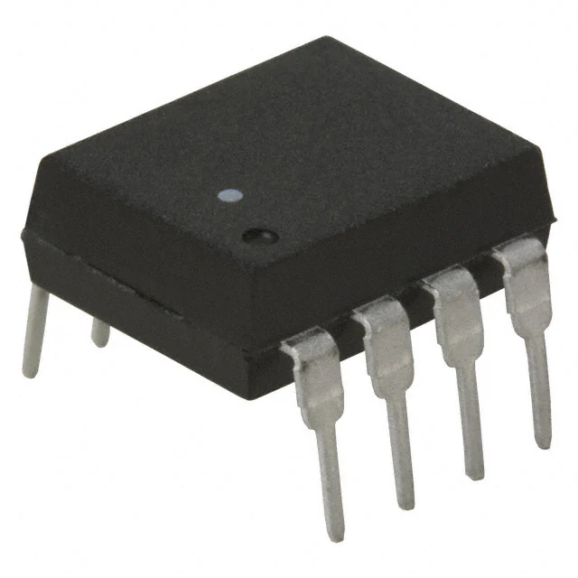

Data Sheet HCPL-2201, HCPL-2202, HCPL-2211, HCPL-2212, HCPL-2231, HCPL-2232, HCPL-0201, HCPL-0211, HCNW2201, HCNW2211 Very High CMR, Wide VCC Logic Gate Optocouplers Description The Broadcom® HCPL-22XX, HCPL-02XX, and HCNW22XX are optically coupled logic gates. The HCPL22XX and HCPL-02XX contain a GaAsP LED while the HCNW22XX contains an AlGaAs LED. The detectors have totem pole output stages and optical receiver input stages with built-in Schmitt triggers to provide logic-compatible waveforms, eliminating the need for additional waveshaping. A superior internal shield on the HCPL-2211/12, HCPL-0211, HCPL-2232, and HCNW2211 guarantees common mode transient immunity of 10 kV/µs at a common mode voltage of 1000V. Features           CAUTION! Take normal static precautions in handling and assembly of this component to prevent damage, or degradation, or both that may be induced by ESD. The components featured in this data sheet are not to be used in military or aerospace applications or environments. The components are not AEC-Q100 qualified and are not recommended for automotive applications.  Applications        Broadcom 10 kV/µs minimum Common Mode Rejection (CMR) at VCM = 1000V (HCPL-2211/2212/0211/2232, HCNW2211) Wide operating VCC range: 4.5V to 20V 300 ns propagation delay guaranteed over the full temperature range 5 Mbd typical signal rate Low input current (1.6 mA to 1.8 mA) Hysteresis Totem pole output (no pull-up resistor required) Available in 8-pin DIP, SOIC-8, wide body packages Guaranteed performance from –40°C to +85°C Safety approval – UL recognized –3750 Vrms for 1 minute (5000 Vrms for 1 minute for HCNW22XX) per UL1577 – CSA approved – IEC/EN/DIN EN 60747-5-5 approved with VIORM = 630 Vpeak (HCPL-2211/2212 Option 060 only) and VIORM = 1414 Vpeak (HCNW22XX only) MIL-PRF-38534 hermetic version available (HCPL-52XX/62XX) Isolation of high-speed logic systems Computer-peripheral interfaces Microprocessor system interfaces Ground loop elimination Pulse transformer replacement High-speed line receiver Power control systems AV02-0674EN January 14, 2021 HCPL-2201, HCPL-2202, HCPL-2211, HCPL-2212, HCPL-2231, HCPL-2232, HCPL-0201, HCPL-0211, HCNW2201, HCNW2211 Data Sheet Very High CMR, Wide VCC Logic Gate Optocouplers Functional Diagram HCPL-2201/11 HCPL-0201/11 HCNW2201/11 HCPL-2202/12 NC 1 8 VCC NC 1 8 VCC ANODE 2 7 VO ANODE 2 7 NC CATHODE 3 6 NC CATHODE 3 6 VO NC 4 SHIELD 5 GND NC 4 5 GND SHIELD HCPL-2231/32 ANODE 1 1 8 VCC CATHODE 1 2 7 VO1 CATHODE 2 3 6 VO2 ANODE 2 4 NOTE: SHIELD TRUTH TABLE (POSITIVE LOGIC) LED ON OFF VO HIGH LOW 5 GND A 0.1-µF bypass capacitor must be connected between pins 5 and 8. The electrical and switching characteristics of the HCPL-22XX, HCPL-02XX and HCNW22XX are guaranteed from –40°C to +85°C and a VCC from 4.5V to 20V. Low IF and wide VCC range allow compatibility with TTL, LSTTL, and CMOS logic and result in lower power consumption compared to other high-speed couplers. Logic signals are transmitted with a typical propagation delay of 150 ns. Broadcom AV02-0674EN 2 HCPL-2201, HCPL-2202, HCPL-2211, HCPL-2212, HCPL-2231, HCPL-2232, HCPL-0201, HCPL-0211, HCNW2201, HCNW2211 Data Sheet Very High CMR, Wide VCC Logic Gate Optocouplers Selection Guide Minimum CMR Input 8-Pin DIP (300 Mil) dV/dt (V/μs) VCM (V) On Current (mA) Single Channel Package 1,000 50 1.6 HCPL-2200a,b HCPL-2201 HCPL-2202 2,500 400 1.6 c c 1.6 1.8 5,000 300 50 Widebody (400 Mil) Hermetic Single Channel Single Channel Single and Dual Package Package Channel Packages HCPL-0201 HCNW2201 HCPL-0211 HCNW2211 HCPL-2231 a,b HCPL-2219 HCPL-2211 HCPL-2212 1.8 1,000 Dual Channel Package Small Outline SO-8 HCPL-2232 2.0 HCPL-52XXb HCPL-62XXb a. HCPL-2200/2219 devices include output enable/disable function. b. Technical data for the HCPL-2200/2219, HCPL-52XX, and HCPL-62XX are on separate Broadcom publications. c. Minimum CMR of 10 kV/μs with VCM = 1000V can be achieved with input current, IF, of 5 mA. Schematic ICC 8 ICC 8 VCC IO1 1 IF1 + VF1 – 2 7 VO1 SHIELD IO 2 IF + VF – 3 VCC VO SHIELD 5 HCPL-2201/02/11/12 HCPL-0201/11 HCNW2201/11 GND IO2 3 – VF2 + 4 IF2 6 SHIELD 5 VO2 GND HCPL-2231/32 Broadcom AV02-0674EN 3 HCPL-2201, HCPL-2202, HCPL-2211, HCPL-2212, HCPL-2231, HCPL-2232, HCPL-0201, HCPL-0211, HCNW2201, HCNW2211 Data Sheet Very High CMR, Wide VCC Logic Gate Optocouplers Ordering Information HCPL-2201, HCPL-2202, HCPL-2211, HCPL-2212, HCPL-2231, HCPL-2232, HCPL-0201, HCPL-0211 are UL Recognized with 3750 Vrms for 1 minute per UL1577. HCNW2201 and HCNW2211 are UL Recognized with 5000 Vrms for 1 minute per UL1577. All devices listed above are approved under CSA Component Acceptance Notice #5, File CA 88324. Option Part Number RoHS Compliant Non RoHS Compliant HCPL-2201 HCPL-2202 HCPL-2211 HCPL-2212 -000E No option -300E #300 -500E #500 -060E #060 HCPL-2231 HCPL-2232 HCPL-0201 HCPL-0211 HCNW2201 HCNW2211 Package Surface Mount Gull Wing 300 mil DIP-8 X X X X #360 X X #560 X X -000E No option -300E #300 300 mil DIP-8 X X X X SO-8 X #500 -000E No option -500E #500 X -060E #060 X #560 -300E #300 -500E #500 X 1000 per reel X 50 per tube X 1000 per reel 50 per tube X 1000 per reel 100 per tube X X 400 mil Widebody DIP-8 X 50 per tube 50 per tube -500E No option Quantity 50 per tube X -560E -000E IEC/EN/DIN EN 60747-5-5 50 per tube -360E -560E Tape & Reel UL 5000 Vrms/ 1 Minute Rating 1500 per reel X X X X X X X X 100 per tube X 1500 per reel X 42 per tube X X 42 per tube X X 750 per reel To order, choose a part number from the part number column and combine with the desired option from the option column to form an order entry. Example 1: HCPL-2202-560E to order product of 300 mil DIP Gull Wing Surface Mount package in Tape and Reel packaging with IEC/EN/DIN EN 60747-5-5 Safety Approval in RoHS compliant. Example 2: HCPL-2202 to order product of 300 mil DIP package in tube packaging and non-RoHS compliant. Option data sheets are available. Contact your Broadcom sales representative or authorized distributor for information. NOTE: Broadcom The notation #XXX is used for existing products, while (new) products launched since 15th July 2001 and RoHS compliant option will use -XXXE. AV02-0674EN 4 HCPL-2201, HCPL-2202, HCPL-2211, HCPL-2212, HCPL-2231, HCPL-2232, HCPL-0201, HCPL-0211, HCNW2201, HCNW2211 Data Sheet Very High CMR, Wide VCC Logic Gate Optocouplers Package Outline Drawings 8-Pin DIP Package (HCPL-2201/02/11/12/31/32) 7.62 ± 0.25 (0.300 ± 0.010) 9.65 ± 0.25 (0.380 ± 0.010) 8 TYPE NUMBER AVAGO 7 6 5 A XXXXZ YYWW RU EEE P DATE CODE LOT ID 1 2 3 6.35 ± 0.25 (0.250 ± 0.010) OPTION CODE* UL RECOGNITION SPECIAL PROGRAM CODE 4 1.78 (0.070) MAX. 1.19 (0.047) MAX. 5° TYP. 3.56 ± 0.13 (0.140 ± 0.005) 4.70 (0.185) MAX. + 0.076 0.254 - 0.051 + 0.003) (0.010 - 0.002) 0.51 (0.020) MIN. 2.92 (0.115) MIN. DIMENSIONS IN MILLIMETERS AND (INCHES). * MARKING CODE LETTER FOR OPTION NUMBERS "V" = OPTION 060 OPTION NUMBERS 300 AND 500 NOT MARKED. 0.65 (0.025) MAX. 1.080 ± 0.320 (0.043 ± 0.013) 2.54 ± 0.25 (0.100 ± 0.010) NOTE: FLOATING LEAD PROTRUSION IS 0.25 mm (10 mils) MAX. 8-Pin DIP Package with Gull Wing Surface Mount Option 300 (HCPL-2201/02/11/12/31/32) LAND PATTERN RECOMMENDATION 1.016 (0.040) 9.65 ± 0.25 (0.380 ± 0.010) 8 7 6 5 10.9 (0.430) 6.350 ± 0.25 (0.250 ± 0.010) 1 2 3 4 1.27 (0.050) 9.65 ± 0.25 (0.380 ± 0.010) 1.780 (0.070) MAX. 1.19 (0.047) MAX. 7.62 ± 0.25 (0.300 ± 0.010) 3.56 ± 0.13 (0.140 ± 0.005) 1.080 ± 0.320 (0.043 ± 0.013) 2.54 (0.100) BSC 2.0 (0.080) 0.635 ± 0.130 (0.025 ± 0.005) 0.635 ± 0.25 (0.025 ± 0.010) + 0.076 0.254 - 0.051 + 0.003) (0.010 - 0.002) 12° NOM. DIMENSIONS IN MILLIMETERS (INCHES). LEAD COPLANARITY = 0.10 mm (0.004 INCHES). NOTE: FLOATING LEAD PROTRUSION IS 0.25 mm (10 mils) MAX. Broadcom AV02-0674EN 5 HCPL-2201, HCPL-2202, HCPL-2211, HCPL-2212, HCPL-2231, HCPL-2232, HCPL-0201, HCPL-0211, HCNW2201, HCNW2211 Data Sheet Very High CMR, Wide VCC Logic Gate Optocouplers Small-Outline SO-8 Package (HCPL-0201/11) LAND PATTERN RECOMMENDATION 8 7 6 5 5.994 ± 0.203 (0.236 ± 0.008) XXX YYWW EEE 3.937 ± 0.127 (0.155 ± 0.005) 1 PIN ONE 2 3 TYPE NUMBER (LAST 3 DIGITS) DATE CODE LOT ID 4 0.406 ± 0.076 (0.016 ± 0.003) 7.49 (0.295) 1.9 (0.075) 1.270 BSC (0.050) 0.64 (0.025) 7o * 5.080 ± 0.127 (0.200 ± 0.005) 3.175 ± 0.127 (0.125 ± 0.005) 0.432 45° X (0.017) 0 ~ 7° 1.524 (0.060) 0.228 ± 0.025 (0.009 ± 0.001) 0.203 ± 0.102 (0.008 ± 0.004) * TOTAL PACKAGE LENGTH (INCLUSIVE OF MOLD FLASH) 5.207 ± 0.254 (0.205 ± 0.010) 0.305 MIN. (0.012) DIMENSIONS IN MILLIMETERS (INCHES). LEAD COPLANARITY = 0.10 mm (0.004 INCHES) MAX. NOTE: FLOATING LEAD PROTRUSION IS 0.15 mm (6 mils) MAX. 8-Pin Widebody DIP Package (HCNW2201/11) 11.00 MAX. (0.433) 11.23 ± 0.15 (0.442 ± 0.006) 8 7 6 TYPE NUMBER A HCNWXXXX YYWW EEE 1 2 3 9.00 ± 0.15 (0.354 ± 0.006) 5 DATE CODE LOT ID 4 10.16 (0.400) TYP. 1.55 (0.061) MAX. 7° TYP. 5.10 MAX. (0.201) 3.10 (0.122) 3.90 (0.154) 2.54 (0.100) TYP. 1.80 ± 0.15 (0.071 ± 0.006) Broadcom 0.40 (0.016) 0.56 (0.022) + 0.076 0.254 - 0.0051 + 0.003) (0.010 - 0.002) 0.51 (0.021) MIN. DIMENSIONS IN MILLIMETERS (INCHES). NOTE: FLOATING LEAD PROTRUSION IS 0.25 mm (10 mils) MAX. AV02-0674EN 6 HCPL-2201, HCPL-2202, HCPL-2211, HCPL-2212, HCPL-2231, HCPL-2232, HCPL-0201, HCPL-0211, HCNW2201, HCNW2211 Data Sheet Very High CMR, Wide VCC Logic Gate Optocouplers 8-Pin Widebody DIP Package with Gull Wing Surface Mount Option 300 (HCNW2201/11) 11.23 ± 0.15 (0.442 ± 0.006) 8 7 6 LAND PATTERN RECOMMENDATION 5 9.00 ± 0.15 (0.354 ± 0.006) 1 2 3 13.56 (0.534) 4 2.29 (0.09) 1.3 (0.051) 12.30 ± 0.30 (0.484 ± 0.012) 1.55 (0.061) MAX. 11.00 MAX. (0.433) 4.00 MAX. (0.158) 1.80 ± 0.15 (0.071 ± 0.006) 2.54 (0.100) BSC 0.75 ± 0.25 (0.030 ± 0.010) DIMENSIONS IN MILLIMETERS (INCHES). LEAD COPLANARITY = 0.10 mm (0.004 INCHES). NOTE: FLOATING LEAD PROTRUSION IS 0.25 mm (10 mils) MAX. Broadcom 1.00 ± 0.15 (0.039 ± 0.006) + 0.076 0.254 - 0.0051 + 0.003) (0.010 - 0.002) 7° NOM. AV02-0674EN 7 HCPL-2201, HCPL-2202, HCPL-2211, HCPL-2212, HCPL-2231, HCPL-2232, HCPL-0201, HCPL-0211, HCNW2201, HCNW2211 Data Sheet Very High CMR, Wide VCC Logic Gate Optocouplers Solder Reflow Profile Recommended reflow condition as per JEDEC Standard, J-STD-020 (latest revision). Non-Halide Flux should be used. Regulatory Information The HCPL-22XX/02XX and HCNW22XX have been approved by the following organizations: UL Recognized under UL 1577, Component Recognition Program, File E55361. CSA Approved under CSA Component Acceptance Notice #5, File CA 88324. IEC/EN/DIN EN 60747-5-5 (Option 060 and HCNW only.) Insulation and Safety Related Specifications Symbol 8-Pin DIP (300 Mil) Value SO-8 Value Widebody (400 Mil) Value Unit Conditions Minimum External Air Gap (External Clearance) L(101) 7.1 4.9 9.6 mm Measured from input terminals to output terminals, shortest distance through air. Minimum External Tracking (External Creepage) L(102) 7.4 4.8 10.0 mm Measured from input terminals to output terminals, shortest distance path along body. Minimum Internal Plastic Gap (Internal Clearance) 0.08 0.08 1.0 mm Through insulation distance, conductor to conductor, usually the direct distance between the photoemitter and photodetector inside the optocoupler cavity. Minimum Internal Tracking (Internal Creepage) NA NA 4.0 mm Measured from input terminals to output terminals, along internal cavity. 200 200 200 V IIIa IIIa IIIa Parameter Tracking Resistance (Comparative Tracking Index) Isolation Group NOTE: Broadcom CTI DIN IEC 112/VDE 0303 Part 1. Material Group (DIN VDE 0110, 1/89, Table 1). Option 300 - surface mount classification is Class A in accordance with CECC 00802. AV02-0674EN 8 HCPL-2201, HCPL-2202, HCPL-2211, HCPL-2212, HCPL-2231, HCPL-2232, HCPL-0201, HCPL-0211, HCNW2201, HCNW2211 Data Sheet Very High CMR, Wide VCC Logic Gate Optocouplers IEC/EN/DIN EN 60747-5-5 Insulation Characteristics (Option 060) Characteristic Description Symbol Installation Classification per DIN VDE 0110, Table 1 For Rated Mains Voltage  150 Vrms For Rated Mains Voltage  300 Vrms For Rated Mains Voltage  600 Vrms Climatic Classification Pollution Degree (DIN VDE 0110/39) HCPL-2201/02/11/12/31/32 HCPL-0201/11 I – IV I – IV I – IV I – IV I – IV I – III 0/70/21 0/70/21 Unit 2 2 VIORM 630 567 Vpeak Input to Output Test Voltage, Method ba VIORM × 1.875 = VPR, 100% Production Test with tm = 1s, Partial Discharge < 5 pC VPR 1181 1063 Vpeak Input to Output Test Voltage, Method aa VIORM × 1.6 = VPR, Type and Sample Test, tm = 10s, Partial Discharge < 5 pC VPR 1008 907 Vpeak VIOTM 8000 6000 Vpeak TS IS, INPUT PS, OUTPUT 175 230 600 150 230 600 °C mA mW RS 109 109 Ω Maximum Working Insulation Voltage Highest Allowable Overvoltage (Transient Overvoltage tini = 60s) Safety-Limiting Values (Maximum values allowed in the event of a failure, also see Figure 12.) Case Temperature Input Current Output Power Insulation Resistance at TS, VIO = 500V a. Refer to the front of the optocoupler section of the current catalog, under Product Safety Regulations section IEC/EN/DIN EN 60747-5-5, for a detailed description. NOTE: Broadcom These optocouplers are suitable for safe electrical isolation only within the safety limit data. Maintenance of the safety limit data is ensured by means of protective circuits. AV02-0674EN 9 HCPL-2201, HCPL-2202, HCPL-2211, HCPL-2212, HCPL-2231, HCPL-2232, HCPL-0201, HCPL-0211, HCNW2201, HCNW2211 Data Sheet Very High CMR, Wide VCC Logic Gate Optocouplers IEC/EN/DIN EN 60747-5-5 Insulation Characteristics (HCNW22xx Option 060 ONLY) Description Symbol Installation Classification per DIN VDE 0110, Table 1 For Rated Mains Voltage  150 Vrms Characteristic Unit I – IV I – IV I – IV I – III For Rated Mains Voltage  300 Vrms For Rated Mains Voltage  600 Vrms For Rated Mains Voltage  1000 Vrms Climatic Classification –40/85/21 Pollution Degree (DIN VDE 0110/39) 2 VIORM 1414 Vpeak Input to Output Test Voltage, Method ba VIORM x 1.875 = VPR, 100% Production Test with tm = 1 sec, Partial Discharge < 5 pC VPR 2651 Vpeak Input to Output Test Voltage, Method aa VIORM x 1.6 = VPR, Type and Sample Test, tm =1 0 sec, Partial Discharge < 5 pC VPR 2262 Vpeak VIOTM 8000 Vpeak TS IS, INPUT PS, OUTPUT 150 400 700 °C mA mW RS 109 Ω Maximum Working Insulation Voltage Highest Allowable Overvoltagea (Transient Overvoltage tini = 60 sec) Safety-Limiting Values (Maximum values allowed in the event of a failure, also see Figure 12.) Case Temperature Input Current Output Power Insulation Resistance at TS, VIO = 500V a. Refer to the front of the optocoupler section of the current catalog, under Product Safety Regulations section IEC/EN/DIN EN 60747-5-5, for a detailed description. NOTE: Broadcom These optocouplers are suitable for safe electrical isolation only within the safety limit data. Maintenance of the safety limit data is ensured by means of protective circuits. AV02-0674EN 10 HCPL-2201, HCPL-2202, HCPL-2211, HCPL-2212, HCPL-2231, HCPL-2232, HCPL-0201, HCPL-0211, HCNW2201, HCNW2211 Data Sheet Very High CMR, Wide VCC Logic Gate Optocouplers Absolute Maximum Ratings Parameter Symbol Min. Max. Unit Note Storage Temperature TS –55 125 °C Operating Temperature TA –40 85 °C Average Forward Input Current IF(AVG) — 10 mA a Peak Transient Input Current (≤1 µs Pulse Width, 300 pps) IF(TRAN) A a — 1.0 — 40 mA — 5 V a — 3 IO — 25 mA a Supply Voltage VCC 0 20 V Output Voltage VO –0.5 20 V a Total Package Power Dissipation PT — 210 mW b (≤200 µs Pulse Width, 2.0V. CML is the maximum slew rate of the common mode voltage that can be sustained with the output voltage in the logic low state, VO < 0.8V. d. IF = 1.8 mA for HCPL-2232. 2. Broadcom For HCPL-223X, 1.8 mA ≤ IF(ON) ≤ 5 mA. AV02-0674EN 13 HCPL-2201, HCPL-2202, HCPL-2211, HCPL-2212, HCPL-2231, HCPL-2232, HCPL-0201, HCPL-0211, HCNW2201, HCNW2211 Data Sheet Very High CMR, Wide VCC Logic Gate Optocouplers Package Characteristics Parameter Input-Output Momentary Withstand Voltagea Sym. Min. Typ. Max. Unit Test Conditions VISO 3750 — — Vrms RH < 50%, t = 1 min. b, c 5000 — — TA = 25°C b, d — 1012 — 1012 1013 — TA = 25°C 1011 — — TA = 100°C — 0.6 — 0.5 0.6 HCNW22XX Input-Output Resistance RI-O HCNW22XX Input-Output Capacitance CI-O HCNW22XX Ω pF Fig. Note VI-O = 500 Vdc b f = 1 MHz b TA = 25°C, VI-O = 0 Vdc Input-Input Insulation Leakage Current II-I — 0.005 — μA Relative Humidity = 45%, t = 5s, VI-I = 500V e Resistance (Input-Input) RI-I — 1011 — Ω VI-I = 500V e Capacitance (Input-Input) CI-I — 0.25 — pF f = 1 MHz e a. The Input-Output Momentary Withstand Voltage is a dielectric voltage rating that should not be interpreted as an input-output continuous voltage rating. For the continuous voltage rating, refer to the IEC/EN/DIN EN 60747-5-5 Insulation Characteristics Table (if applicable), your equipment level safety specification, or the Broadcom Application Note Optocoupler Input-Output Endurance Voltage, publication number 5963-2203. b. Device considered a two-terminal device: pins 1, 2, 3, and 4 shorted together and pins 5, 6, 7, and 8 shorted together. c. In accordance with UL 1577, each optocoupler is proof tested by applying an insulation test voltage ≥4500 Vrms for one second (leakage detection current limit, II-O ≤ 5 μA). This test is performed before the 100% production test for partial discharge (Method b) shown in the IEC/EN/DIN EN 60747-5-5 Insulation Characteristics Table, if applicable. d. In accordance with UL 1577, each optocoupler is proof tested by applying an insulation test voltage ≥6000 Vrms for one second (leakage detection current limit, II-O ≤ 5 μA). This test is performed before the 100% production test for partial discharge (Method b) shown in the IEC/EN/DIN EN 60747-5-5 Insulation Characteristics Table. e. For HCPL-2231/32 only. Measured between pins 1 and 2, shorted together, and pins 3 and 4, shorted together. Broadcom AV02-0674EN 14 HCPL-2201, HCPL-2202, HCPL-2211, HCPL-2212, HCPL-2231, HCPL-2232, HCPL-0201, HCPL-0211, HCNW2201, HCNW2211 Data Sheet Very High CMR, Wide VCC Logic Gate Optocouplers 1.0 VCC = 4.5 V VF = 0 V IO = 6.4 mA 0.9 0.8 0.7 0.6 0.5 0.4 0.3 0.2 0.1 0 -60 -40 -20 0 20 40 60 Figure 2: Typical Logic High Output Current vs. Temperature IOH – HIGH LEVEL OUTPUT CURRENT – mA VOL – LOW LEVEL OUTPUT VOLTAGE – V Figure 1: Typical Logic Low Output Voltage Vs. Temperature 80 100 0 VCC = 4.5 V IF = 5 mA -1 -2 VO = 2.7 V -3 -4 -5 VO = 2.4 V -6 -7 -8 -60 -40 -20 TA – TEMPERATURE – °C 0 20 40 60 80 100 TA – TEMPERATURE – °C Figure 3: Typical Output Voltage vs. Forward Input Current VO – OUTPUT VOLTAGE – V 5 VCC = 4.5 V TA = 25 °C 4 3 IO = -2.6 mA 2 1 IO = 6.4 mA 0 0 0.5 1.0 1.5 IF – INPUT CURRENT – mA Figure 4: Typical Input Diode Forward Characteristic HCPL-22XX HCPL-02XX TA = 25 °C 100 10 IF + VF – 1.0 0.1 0.01 0.001 1.1 1.2 1.3 1.4 1.5 VF – FORWARD VOLTAGE – V Broadcom HCNW22XX 1000 IF – FORWARD CURRENT – mA IF – FORWARD CURRENT – mA 1000 TA = 25 °C 100 10 IF + VF – 1.0 0.1 0.01 0.001 1.1 1.2 1.3 1.4 1.5 1.6 VF – FORWARD VOLTAGE – V AV02-0674EN 15 HCPL-2201, HCPL-2202, HCPL-2211, HCPL-2212, HCPL-2231, HCPL-2232, HCPL-0201, HCPL-0211, HCNW2201, HCNW2211 Data Sheet Very High CMR, Wide VCC Logic Gate Optocouplers Figure 5: Circuit for tPLH, tPHL, tr, tf PULSE GEN. tr = tf = 5 ns f = 100 kHz 10 % DUTY CYCLE VO = 5 V ZO = 50 OUTPUT VO MONITORING NODE HCPL-2201/11 HCPL-02XX HCNW22XX 1 VCC 8 2 7 3 6 * INPUT MONITORING NODE R1 PULSE GEN. tr = tf = 5 ns f = 100 kHz 10 % DUTY CYCLE VO = 5 V ZO = 50 VCC 619 Ω D1 D2 C2 = 15 pF GND 5 4 C1 = 120 pF 5V VCC HCPL-223X INPUT MONITORING NODE 1 VCC 8 2 7 3 6 * D3 5 kΩ D4 R1 OUTPUT VO MONITORING NODE D1 619 Ω D2 C2 = 15 pF GND 5 4 C1 = 120 pF 5V 5 kΩ D3 D4 THE PROBE AND JIG CAPACITANCES ARE INCLUDED IN C1 AND C2. THE PROBE AND JIG CAPACITANCES ARE INCLUDED IN C1 AND C2. 2.15 kΩ 1.10 kΩ 681 Ω R1 5 mA IF (ON) 1.6 mA 3 mA 1.96 kΩ 1.10 kΩ 681 Ω R1 5 mA IF (ON) 1.8 mA 3 mA ALL DIODES ARE 1N916 OR 1N3064. IF (ON) 50 % IF (ON) 0 mA INPUT IF tPLH tPHL ALL DIODES ARE 1N916 OR 1N3064. VOH 1.3 V VOL OUTPUT VO * 0.1 μF BYPASS — SEE NOTE. NOTE: A 0.1 µF bypass capacitor must be connected between pins 5 and 8. Figure 6: Typical Propagation Delays vs. Temperature HCPL-22XX HCPL-02XX 250 VCC = 5.0 V, 20 V C1 (120 pF) PEAKING CAPACITOR IS USED. SEE FIGURE 5. 200 *IF = 1.8 mA FOR HCPL-223X DEVICES. IF (mA) 5 3 1.6* 150 1.6* -5 tPHL 100 tPLH 50 -60 -40 -20 0 20 40 60 TA – TEMPERATURE – °C Broadcom 80 100 tP – PROPAGATION DELAY – ns tP – PROPAGATION DELAY – ns 250 HCNW22XX VCC = 5.0 V, 20 V C1 (120 pF) PEAKING CAPACITOR IS USED. SEE FIGURE 5. IF (mA) 5 200 3 150 1.6 tPHL 1.6, 5 100 tPLH 50 -60 -40 -20 0 20 40 60 80 100 TA – TEMPERATURE – °C AV02-0674EN 16 HCPL-2201, HCPL-2202, HCPL-2211, HCPL-2212, HCPL-2231, HCPL-2232, HCPL-0201, HCPL-0211, HCNW2201, HCNW2211 Data Sheet PO – MAXIMUM OUTPUT POWER PER CHANNEL (mW) 80 TA = 75 °C 60 TA = 80°C 40 TA = 85 °C 20 0 0 5 15 10 20 VCC – SUPPLY VOLTAGE – V Figure 8: Typical Logic High Output Voltage vs. Supply Voltage VOH – HIGH LEVEL OUTPUT VOLTAGE – V Figure 7: Maximum Output Power per Channel vs. Supply Voltage Very High CMR, Wide VCC Logic Gate Optocouplers 20 TYPICAL VOH vs. VCC AT IO = -2.6 mA TA = 25 °C 15 10 5 0 0 5 10 15 20 VCC – SUPPLY VOLTAGE – V Figure 9: Typical Rise, Fall Time vs. Temperature 100 tr, tf – RISE, FALL TIME – ns VCC = 5 V 80 60 40 tr 20 tf 0 -60 -40 -20 0 20 40 60 80 100 TA – TEMPERATURE – °C Broadcom AV02-0674EN 17 HCPL-2201, HCPL-2202, HCPL-2211, HCPL-2212, HCPL-2231, HCPL-2232, HCPL-0201, HCPL-0211, HCNW2201, HCNW2211 Data Sheet Very High CMR, Wide VCC Logic Gate Optocouplers Figure 10: Test Circuit for Common Mode Transient Immunity and Typical Waveforms HCPL-2201/11 HCPL-02XX HCNW22XX A B VCC 2 OUTPUT VO MONITORING NODE 3 6 4 5 + 0.1 μF BYPASS 1 8 2 7 3 6 4 5 B 7 RIN VCC HCPL-2231/32 A 8 1 R1 VFF – OUTPUT VO MONITORING NODE 0.1 μF BYPASS + VFF – PULSE GENERATOR + VCM – PULSE GENERATOR + VCM – VCM (PEAK) |VCM| 0V VOH OUTPUT VO SWITCH AT A: IF = 1.6 mA** VO (MIN.)* SWITCH AT B: VF = 0 V VO (MAX.)* VOL * SEE NOTE. ** IF = 1.8 mA FOR HCPL-2231/32 DEVICES. NOTE: CMH is the maximum slew rate of the common mode voltage that can be sustained with the output voltage in the logic high state, VO > 2.0V. CML is the maximum slew rate of the common mode voltage that can be sustained with the output voltage in the logic low state, VO < 0.8V. Use of a 0.1-µF bypass capacitor connected between pins 5 and 8 is recommended. Broadcom AV02-0674EN 18 HCPL-2201, HCPL-2202, HCPL-2211, HCPL-2212, HCPL-2231, HCPL-2232, HCPL-0201, HCPL-0211, HCNW2201, HCNW2211 Data Sheet Very High CMR, Wide VCC Logic Gate Optocouplers Figure 11: Typical Input Threshold Current vs. Temperature HCPL-22XX HCPL-02XX VCC = 5.0 V VCC = 20 V 0.9 0.8 IF (ON) 0.7 IF (OFF) 0.6 IF (ON) IF (OFF) 0.5 -60 -40 -20 0 20 40 HCNW22XX 1.0 INPUT CURRENT THRESHOLD – mA INPUT CURRENT THRESHOLD – mA 1.0 60 80 100 VCC = 5.0 V VCC = 20 V 0.9 0.8 0.7 IF (ON) IF (OFF) 0.6 IF (ON) IF (OFF) 0.5 -60 -40 -20 TA – TEMPERATURE – °C 0 20 40 60 80 100 TA – TEMPERATURE – °C HCPL-2211/2212 OPTION 060 800 PS (mW) 700 IS (mA) 600 500 400 300 200 100 0 0 25 75 100 125 150 175 200 50 OUTPUT POWER PS, INPUT CURRENT IS OUTPUT POWER – PS, INPUT CURRENT – IS Figure 12: Thermal Derating Curve, Dependence of Safety Limiting Value with Case Temperature per IEC/EN/DIN EN 60747-5-5 HCNW22XX 1000 PS (mW) 900 IS (mA) 800 700 600 500 400 300 200 100 0 0 25 50 75 100 125 150 175 TS – CASE TEMPERATURE – °C TS – CASE TEMPERATURE – °C Figure 13: Recommended LSTTL to LSTTL Circuit where 500 ns Propagation Delay Is Sufficient HCPL-2201/11 HCPL-02XX HCNW22XX VCC1 (+5 V) VCC2 (+5 V) 1 8 2 7 3 6 4 5 1.1 kΩ DATA INPUT DATA OUTPUT * TTL OR LSTTL 1 UP TO 16 LSTTL LOADS OR 4 TTL LOADS * 0.1 μF BYPASS 2 Broadcom AV02-0674EN 19 HCPL-2201, HCPL-2202, HCPL-2211, HCPL-2212, HCPL-2231, HCPL-2232, HCPL-0201, HCPL-0211, HCNW2201, HCNW2211 Data Sheet Very High CMR, Wide VCC Logic Gate Optocouplers Figure 14: Recommended LSTTL to LSTTL Circuit for Applications Requiring a Maximum Allowable Propagation Delay of 300 ns HCPL-2201/11 HCPL-02XX HCNW22XX VCC2 (+5 V) 80 Ω VCC1 (+5 V) 1.1 kΩ 1 8 2 7 3 6 4 5 120 pF DATA INPUT DATA OUTPUT * TTL OR LSTTL 1 UP TO 16 LSTTL LOADS OR 4 TTL LOADS * 0.1 μF BYPASS 2 Figure 15: LSTTL to CMOS Interface Circuit VCC2 (4.5 TO 20 V) HCPL-2201/11 HCPL-02XX HCNW22XX 80 Ω* VCC1 (+5 V) VCC 1 1.1 kΩ 2 GND 4 VCC2 5V 10 V 15 V 20 V DATA OUTPUT 6 TTL OR LSTTL 1 CMOS 7 3 DATA INPUT TOTEM POLE OUTPUT GATE RL 8 120 pF* RL 1.1 kΩ 2.37 kΩ 3.83 kΩ 5.11 kΩ 5 2 * 120 pF PEAKING CAPACITOR MAY BE OMITTED AND 80 Ω RESISTOR MAY BE SHORTED WHERE 500 ns PROPAGATION DELAY IS SUFFICIENT. **0.1 μF BYPASS Broadcom AV02-0674EN 20 HCPL-2201, HCPL-2202, HCPL-2211, HCPL-2212, HCPL-2231, HCPL-2232, HCPL-0201, HCPL-0211, HCNW2201, HCNW2211 Data Sheet Figure 16: Alternative LED Drive Circuit Figure 17: Series LED Drive with Open Collector Gate (4.7 k Resistor Shunts IOH from the LED) HCPL-2201/11 HCPL-02XX HCNW22XX VCC1 (+5 V) 1.1 kΩ 1 DATA INPUT TTL or LSTTL HCPL-2201/11 HCPL-02XX HCNW22XX VCC 8 2 7 3 6 VCC (+5 V) GND D1 (1N4150) REQUIRED FOR ACTIVE PULL-UP DRIVER. 80 Ω* 1 VCC 8 120 pF* 1.1 kΩ 2 D1 4 Broadcom Very High CMR, Wide VCC Logic Gate Optocouplers 7 4.7 kΩ 3 DATA INPUT TTL OR LSTTL 5 4 OPEN COLLECTOR GATE 6 GND 5 * 120 pF PEAKING CAPACITOR MAY BE OMITTED AND 80 Ω RESISTOR MAY BE SHORTED WHERE 500 ns PROPAGATION DELAY IS SUFFICIENT. AV02-0674EN 21 Broadcom, the pulse logo, Connecting everything, Avago Technologies, Avago, and the A logo are among the trademarks of Broadcom and/or its affiliates in the United States, certain other countries, and/or the EU. Copyright © 2016–2021 Broadcom. All Rights Reserved. The term “Broadcom” refers to Broadcom Inc. and/or its subsidiaries. For more information, please visit www.broadcom.com. Broadcom reserves the right to make changes without further notice to any products or data herein to improve reliability, function, or design. Information furnished by Broadcom is believed to be accurate and reliable. However, Broadcom does not assume any liability arising out of the application or use of this information, nor the application or use of any product or circuit described herein, neither does it convey any license under its patent rights nor the rights of others.
HCNW2201-000E
物料型号: - HCPL-2201, HCPL-2202, HCPL-2211, HCPL-2212, HCPL-2231, HCPL-2232, HCPL-0201, HCPL-0211, HCNW2201, HCNW2211
器件简介: - 这些是Broadcom®生产的光耦逻辑门,具有非常高的共模抑制比(CMR)和宽工作电源电压范围(VCC)。
引脚分配: - 引脚分配在文档中有详细的功能图和说明,例如HCPL-2201/11、HCPL-0201/11、HCPL-2231/32等。
参数特性: - 包括最小10 kV/µs的共模抑制(CMR)、宽VCC工作范围(4.5V至20V)、300 ns传播延迟保证、5 Mbd典型信号率、低输入电流(1.6 mA至1.8 mA)、滞后特性、上拉输出(无需上拉电阻)等。
功能详解: - 光耦逻辑门通过内部屏蔽保证了在1000V共模电压下的10 kV/µs的共模瞬态抗扰度。器件还具有UL安全认证和CSA批准。
应用信息: - 适用于高速逻辑系统的隔离、计算机外围接口、微处理器系统接口、消除接地回路、脉冲变压器替代、高速线接收器、电源控制系统等。
封装信息: - 提供8引脚DIP、SOIC-8、宽体封装,保证了从-40°C至+85°C的性能。
