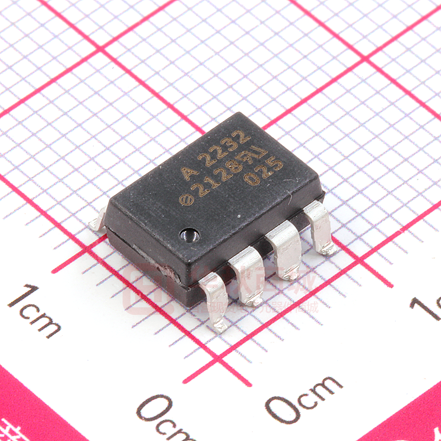

HCPL-2232-500E
HCPL-2232-500E
    AVAGO(博通)
    OC_9.65X6.35MM_SM
    光电耦合器 Viso=3750Vrms VF(typ)=1.5V IF=10mA
HCPL-2232-500E 数据手册
HCPL-2201, HCPL-2202, HCPL-2211,HCPL-2212, HCPL-2231, HCPL-2232, HCPL-0201, HCPL-0211, HCNW2201, HCNW2211 Very High CMR, Wide VCC Logic Gate Optocouplers Data Sheet Lead (Pb) Free RoHS 6 fully compliant RoHS 6 fully compliant options available; -xxxE denotes a lead-free product Description Features The HCPL-22XX, HCPL-02XX, and HCNW22XX are optically-coupled logic gates. The HCPL‑22XX, and HCPL-02XX contain a GaAsP LED while the HCNW22XX contains an AlGaAs LED. The detectors have totem pole output stages and optical receiver input stages with built-in Schmitt triggers to provide logic-compatible waveforms, eliminat­ ing the need for additional waveshaping. • 10 kV/µs minimum Common Mode Rejection (CMR) at VCM = 1000 V (HCPL-2211/2212/0211/2232, HCNW2211) • Wide operating VCC range: 4.5 to 20 Volts • 300 ns propagation delay guaranteed over the full temperature range • 5 Mbd typical signal rate • Low input current (1.6 mA to 1.8 mA) • Hysteresis • Totem pole output (no pullup resistor required) • Available in 8-Pin DIP, SOIC-8, widebody packages • Guaranteed performance from -40°C to 85°C • Safety approval A superior internal shield on the HCPL-2211/12, HCPL0211, HCPL-2232 and HCNW2211 guarantees common mode transient immunity of 10 kV/µs at a common mode voltage of 1000 volts. Functional Diagram HCPL-2201/11 HCPL-0201/11 HCNW2201/11 8 VCC NC 1 8 VCC – UL recognized -3750 V rms for 1 minute (5000 V rms for 1 minute for HCNW22XX) per UL1577 – CSAapproved HCPL-2202/12 NC 1 ANODE 2 7 VO ANODE 2 7 NC CATHODE 3 6 NC CATHODE 3 6 VO NC 4 SHIELD 5 GND NC 4 SHIELD 5 GND HCPL-2231/32 ANODE 1 1 8 VCC CATHODE 1 2 7 VO1 CATHODE 2 3 6 VO2 ANODE 2 4 SHIELD TRUTH TABLE (POSITIVE LOGIC) LED VO ON HIGH OFF LOW 5 GND A 0.1 µF bypass capacitor must be connected between pins 5 and 8. – IEC/EN/DIN EN 60747-5-2 approved with VIORM = 630 V peak (HCPL-2211/2212 Option 060 only) and VIORM = 1414 V peak (HCNW22XX only) • MIL-PRF-38534 hermetic version available (HCPL-52XX/62XX) Applications • Isolation of high speed logic systems • Computer-peripheral interfaces • Microprocessor system interfaces • Ground loop elimination • Pulse transformer replacement • High speed line receiver • Power control systems CAUTION: It is advised that normal static precautions be taken in handling and assembly Functional Diagram ofHCPL-2201 this component to prevent damage and/or degradation which may be induced by ESD. The electrical and switching characteristics of the HCPL22XX, HCPL-02XX and HCNW22XX are guaranteed from -40°C to +85°C and a VCC from 4.5 volts to 20 volts. Low IF and wide VCC range allow compati­bil­ity with TTL, LSTTL, and CMOS logic and result in lower power consump­tion compared to other high speed couplers. Logic signals are transmitted with a typical propagation delay of 150 ns. Selection Guide Small- Widebody   Minimum CMR Input      8-Pin DIP (300 Mil) Outline SO-8 (400 Mil) On- Single Dual Single Single dV/dt Current Channel Channel Channel Channel (V/µs) VCM (V) (mA) Package Package Package Package 1,000 50 1.6 HCPL-2200[1,2] HCPL-0201 HCNW2201 HCPL-2201 HCPL-2202 1.8 HCPL-2231 2,500 400 1.6 HCPL-2219[1,2] 5,000[3] 300[3] 1.6 HCPL-2211 HCPL-0211 HCNW2211 HCPL-2212 1.8 HCPL-2232 1,000 50 2.0 Notes: 1. HCPL-2200/2219 devices include output enable/disable function. 2. Technical data for the HCPL-2200/2219, HCPL-52XX and HCPL-62XX are on separate Avago publications. 3. Minimum CMR of 10 kV/µs with VCM = 1000 V can be achieved with input current, IF, of 5 mA. Schematic ICC 8 ICC 8 SHIELD GND IO2 3 – VF2 + 4 IF2 6 SHIELD 5 HCPL-2231/32 HCPL-2201 Schematic 2 VO1 VO 5 HCPL-2201/02/11/12 HCPL-0201/11 HCNW2201/11 7 SHIELD IO 2 IF + VF – 3 VCC IO1 1 IF1 + VF1 – 2 VCC VO2 GND Hermetic Single and Dual Channel Packages HCPL-52XX[2] HCPL-62XX[2] Ordering Information HCPL-2201, HCPL-2202, HCPL-2211, HCPL-2212, HCPL-2231, HCPL-2232, HCPL-0201, HCPL-0211 are UL Recognized with 3750 Vrms for 1 minute per UL1577. HCNW2201 and HCNW2211 are UL Recognized with 5000 Vrms for 1 minute per UL1577. All devices listed above are approved under CSA Component Acceptance Notice #5, File CA 88324. Option Part number HCPL-2201 HCPL-2202 HCPL-2211 HCPL-2212 HCPL-2231 HCPL-2232 HCPL-0201 HCPL-0211 HCNW2201 HCNW2211 RoHS Compliant Non RoHS Compliant -000E No option -300E -300 X X -500E -500 X X -060E -060 -360E -360 X X -560E -560 X X -000E No option -300E -300 X X -500E -500 X X -000E No option X -500E -500 -060E -060 -560E -560 -000E No option -300E -300 -500E -500 Package Surface Mount Gull Wing Tape & Reel UL 5000 Vrms/ 1 Minute rating IEC/EN/DIN EN 60747-5-2 Quantity 50 per tube 300mil DIP-8 50 per tube X 1000 per reel X X 50 per tube X 50 per tube X 1000 per reel 50 per tube SO-8 1000 per reel 100 per tube X X 1500 per reel X X 400mil Widebody DIP-8 50 per tube X X 100 per tube X 1500 per reel X X 42 per tube X X 42 per tube X X 750 per reel X X X X X X To order, choose a part number from the part number column and combine with the desired option from the option column to form an order entry. Example 1: HCPL-2202-560E to order product of 300mil DIP Gull Wing Surface Mount package in Tape and Reel packaging with IEC/EN/DIN EN 60747-5-2 Safety Approval in RoHS compliant. Example 2: HCPL-2202 to order product of 300mil DIP package in tube packaging and non RoHS compliant. Option datasheets are available. Contact your Avago sales representative or authorized distributor for information. Remarks: The notation ‘#XXX’ is used for existing products, while (new) products launched since 15th July 2001 and RoHS compliant option will use ‘-XXXE‘. 3 Package Outline Drawings 8-Pin DIP Package (HCPL-2201/02/11/12/31/32) 7.62 ± 0.25 (0.300 ± 0.010) 9.65 ± 0.25 (0.380 ± 0.010) 8 TYPE NUMBER 7 6 5 6.35 ± 0.25 (0.250 ± 0.010) OPTION CODE* DATE CODE A XXXXZ YYWW RU 1 2 3 4 UL RECOGNITION 1.78 (0.070) MAX. 1.19 (0.047) MAX. + 0.076 0.254 - 0.051 + 0.003) (0.010 - 0.002) 5° TYP. 3.56 ± 0.13 (0.140 ± 0.005) 4.70 (0.185) MAX. 0.51 (0.020) MIN. 2.92 (0.115) MIN. DIMENSIONS IN MILLIMETERS AND (INCHES). 0.65 (0.025) MAX. 1.080 ± 0.320 (0.043 ± 0.013) * MARKING CODE LETTER FOR OPTION NUMBERS "V" = OPTION 060 OPTION NUMBERS 300 AND 500 NOT MARKED. 2.54 ± 0.25 (0.100 ± 0.010) NOTE: FLOATING LEAD PROTRUSION IS 0.25 mm (10 mils) MAX. 8-Pin DIP Package with Gull Wing Surface Mount Option 300 (HCPL-2201/02/11/12/31/32) LAND PATTERN RECOMMENDATION 9.65 ± 0.25 (0.380 ± 0.010) 8 7 6 1.016 (0.040) 5 6.350 ± 0.25 (0.250 ± 0.010) 1 2 3 10.9 (0.430) 4 1.27 (0.050) 1.19 (0.047) MAX. 1.780 (0.070) MAX. 9.65 ± 0.25 (0.380 ± 0.010) 7.62 ± 0.25 (0.300 ± 0.010) 3.56 ± 0.13 (0.140 ± 0.005) 1.080 ± 0.320 (0.043 ± 0.013) 0.635 ± 0.25 (0.025 ± 0.010) 0.635 ± 0.130 2.54 (0.025 ± 0.005) (0.100) BSC DIMENSIONS IN MILLIMETERS (INCHES). LEAD COPLANARITY = 0.10 mm (0.004 INCHES). NOTE: FLOATING LEAD PROTRUSION IS 0.25 mm (10 mils) MAX. 4 2.0 (0.080) + 0.076 0.254 - 0.051 + 0.003) (0.010 - 0.002) 12° NOM. Small-Outline SO-8 Package (HCPL-0201/11) LAND PATTERN RECOMMENDATION 8 7 6 5 5.994 ± 0.203 (0.236 ± 0.008) XXX YWW 3.937 ± 0.127 (0.155 ± 0.005) 7.49 (0.295) TYPE NUMBER (LAST 3 DIGITS) DATE CODE 1 PIN ONE 2 3 4 1.9 (0.075) 0.406 ± 0.076 (0.016 ± 0.003) 1.270 BSC (0.050) 0.64 (0.025) * 5.080 ± 0.127 (0.200 ± 0.005) 7o 3.175 ± 0.127 (0.125 ± 0.005) 1.524 (0.060) 0.432 (0.017) 45o X 0 ~ 7o * TOTAL PACKAGE LENGTH (INCLUSIVE OF MOLD FLASH) 5.207 ± 0.254 (0.205 ± 0.010) 0.228 ± 0.025 (0.009 ± 0.001) 0.203 ± 0.102 (0.008 ± 0.004) 0.305 MIN. (0.012) DIMENSIONS IN MILLIMETERS (INCHES). LEAD COPLANARITY = 0.10 mm (0.004 INCHES) MAX. NOTE: FLOATING LEAD PROTRUSION IS 0.15 mm (6 mils) MAX. 8-Pin Widebody DIP Package (HCNW2201/11) 11.00 MAX. (0.433) 11.23 ± 0.15 (0.442 ± 0.006) 8 7 6 5 TYPE NUMBER A HCNWXXXX 9.00 ± 0.15 (0.354 ± 0.006) DATE CODE YYWW 1 2 3 4 10.16 (0.400) TYP. 1.55 (0.061) MAX. 7o TYP. 5.10 MAX. (0.201) 3.10 (0.122) 3.90 (0.154) + 0.076 0.254 - 0.0051 + 0.003) (0.010 - 0.002) 0.51 (0.021) MIN. 2.54 (0.100) TYP. 1.80 ± 0.15 (0.071 ± 0.006) 0.40 (0.016) 0.56 (0.022) DIMENSIONS IN MILLIMETERS (INCHES). NOTE: FLOATING LEAD PROTRUSION IS 0.25 mm (10 mils) MAX. 5 8-Pin Widebody DIP Package with Gull Wing Surface Mount Option 300 (HCNW2201/11) 11.23 ± 0.15 (0.442 ± 0.006) 8 7 6 LAND PATTERN RECOMMENDATION 5 9.00 ± 0.15 (0.354 ± 0.006) 1 2 3 13.56 (0.534) 4 2.29 (0.09) 1.3 (0.051) 12.30 ± 0.30 (0.484 ± 0.012) 1.55 (0.061) MAX. 11.00 MAX. (0.433) 4.00 MAX. (0.158) 1.80 ± 0.15 (0.071 ± 0.006) 0.75 ± 0.25 (0.030 ± 0.010) 2.54 (0.100) BSC 1.00 ± 0.15 (0.039 ± 0.006) + 0.076 0.254 - 0.0051 + 0.003) (0.010 - 0.002) DIMENSIONS IN MILLIMETERS (INCHES). 7o NOM. LEAD COPLANARITY = 0.10 mm (0.004 INCHES). NOTE: FLOATING LEAD PROTRUSION IS 0.25 mm (10 mils) MAX. Solder Reflow Temperature Profile 300 PREHEATING RATE 3 °C + 1 °C/–0.5 °C/SEC. REFLOW HEATING RATE 2.5 °C ± 0.5 °C/SEC. 200 PEAK TEMP. 245 °C PEAK TEMP. 240 °C TEMPERATURE (°C) 2.5 C ± 0.5 °C/SEC. 30 SEC. 160 °C 150 °C 140 °C PEAK TEMP. 230 °C SOLDERING TIME 200 °C 30 SEC. 3 °C + 1 °C/–0.5 °C 100 PREHEATING TIME 150 °C, 90 + 30 SEC. 50 SEC. TIGHT TYPICAL LOOSE ROOM TEMPERATURE 0 0 50 100 150 TIME (SECONDS) NOTE: NON-HALIDE FLUX SHOULD BE USED. 6 200 250 Recommended Pb-Free IR Profile tp Tp TEMPERATURE TL Tsmax * 260 +0/-5 °C TIME WITHIN 5 °C of ACTUAL PEAK TEMPERATURE 15 SEC. 217 °C 150 - 200 °C RAMP-UP 3 °C/SEC. MAX. NOTES: THE TIME FROM 25 °C to PEAK TEMPERATURE = 8 MINUTES MAX. Tsmax = 200 °C, Tsmin = 150 °C RAMP-DOWN 6 °C/SEC. MAX. Tsmin ts PREHEAT 60 to 180 SEC. 25 tL NOTE: NON-HALIDE FLUX SHOULD BE USED. 60 to 150 SEC. * RECOMMENDED PEAK TEMPERATURE FOR WIDEBODY 400mils PACKAGE IS 245 °C t 25 °C to PEAK TIME Regulatory Information The HCPL-22XX/02XX and HCNW22XX have been approved by the following organizations: UL Recognized under UL 1577, Component Recognition Program, File E55361. CSA Approved under CSA Component Acceptance Notice #5, File CA 88324. Insulation and Safety Related Specifications 8-pin DIP Package 8-Pin DIP (300 Mil) SO-8 Parameter Symbol Value Value IEC/EN/DIN EN 60747-5-2 Approved under: IEC 60747-5-2:1997 + A1:2002 EN 60747-5-2:2001 + A1:2002 DIN EN 60747-5-2 (VDE 0884 Teil 2):2003-01 (Option 060 and HCNW only) Widebody (400 Mil) Value Units Conditions Minimum External L(101) 7.1 4.9 9.6 mm Air Gap (External Clearance) Measured from input terminals to output terminals, shortest distance through air. Minimum External L(102) 7.4 4.8 10.0 mm Tracking (External Creepage) Measured from input terminals to output terminals, shortest distance path along body. Minimum Internal 0.08 0.08 1.0 mm Plastic Gap (Internal Clearance) Through insulation distance, conductor to conductor, usually the direct distance between the photoemitter and photodetector inside the optocoupler cavity. Minimum Internal NA NA 4.0 mm Tracking (Internal Creepage) Measured from input terminals to output terminals, along internal cavity. Tracking Resistance (Comparative Tracking Index) DIN IEC 112/VDE 0303 Part 1 CTI 200 200 200 Volts Isolation Group IIIa IIIa IIIa Option 300 - surface mount classification is Class A in accordance with CECC 00802. 7 Material Group (DIN VDE 0110, 1/89, Table 1) IEC/EN/DIN EN 60747-5-2 Insulation Related Characteristics (HCPL-2211/2212 Option 060 ONLY) Description Symbol Characteristic Units Installation classification per DIN VDE 0110/1.89, Table 1   for rated mains voltage ≤300 V rms I-IV   for rated mains voltage ≤450 V rms I-III Climatic Classification 55/85/21 Pollution Degree (DIN VDE 0110/1.89) 2 Maximum Working Insulation Voltage VIORM 630 V peak Input to Output Test Voltage, Method b*   VIORM x 1.875 = VPR, 100% Production Test with tm = 1 sec,   Partial Discharge < 5 pC VPR 1181 V peak Input to Output Test Voltage, Method a*   VIORM x 1.5 = VPR, Type and sample test,   tm = 60 sec, Partial Discharge < 5 pC VPR 945 V peak VIOTM 6000 V peak TS IS,OUTPUT PS,OUTPUT 175 230 600 °C mA mW RS ≥109 Ω Highest Allowable Overvoltage* (Transient Overvoltage, tini = 10 sec) Safety Limiting Values   (Maximum values allowed in the event of a failure,   also see Figure 12, Thermal Derating curve.)    Case Temperature    Input Current    Output Power Insulation Resistance at TS, VIO = 500 V *Refer to the front of the optocoupler section of the current catalog, under Product Safety Regulations section IEC/EN/DIN EN 60747-5-2, for a detailed description. Note: Isolation characteristics are guaranteed only within the safety maximum ratings which must be ensured by protective circuits in application. 8 IEC/EN/DIN EN 60747-5-2 Insulation Related Characteristics (HCNW22XX ONLY) Description Symbol Characteristic Units Installation classification per DIN VDE 0110/1.89, Table 1   for rated mains voltage ≤600 V rms I-IV   for rated mains voltage ≤1000 V rms I-III Climatic Classification 55/100/21 Pollution Degree (DIN VDE 0110/1.89) 2 Maximum Working Insulation Voltage VIORM 1414 V peak Input to Output Test Voltage, Method b*   VIORM x 1.875 = VPR, 100% Production Test with tm = 1 sec,   Partial Discharge < 5 pC VPR 2652 V peak Input to Output Test Voltage, Method a*   VIORM x 1.5 = VPR, Type and sample test,   tm = 60 sec, Partial Discharge < 5 pC VPR 2121 V peak VIOTM 8000 V peak TS IS,INPUT PS,OUTPUT 150 400 700 °C mA mW RS ≥109 Ω Highest Allowable Overvoltage* (Transient Overvoltage, tini = 10 sec) Safety Limiting Values   (Maximum values allowed in the event of a failure,   also see Figure 12, Thermal Derating curve.)    Case Temperature    Current (Input Current IF, PS = 0)    Output Power Insulation Resistance at TS, VIO = 500 V *Refer to the front of the optocoupler section of the current catalog, under Product Safety Regulations section IEC/EN/DIN EN 60747-5-2, for a detailed description. Note: Isolation characteristics are guaranteed only within the safety maximum ratings which must be ensured by protective circuits in application. 9 Absolute Maximum Ratings Parameter Symbol Min. Max. Units Storage Temperature TS -55 125 °C Operating Temperature TA -40 85 °C Note Average Forward Input Current IF(AVG) 10 mA 1 Peak Transient Input Current   (≤ 1 µs Pulse Width, 300 pps) IF(TRAN) 1.0 A 1 HCNW22XX 40 mA VR 5 V 1 HCNW22XX 3 1   (≤ 200 µs Pulse Width,    < 1% Duty Cycle) Reverse Input Voltage Average Output Current IO 25 mA Supply Voltage VCC 0 20 V Output Voltage VO -0.5 20 V 1 Total Package Power Dissipation PT 210 mW 2 HCPL-223X 294 Output Power Dissipation PO See Figure 7 1 Lead Solder Temperature (Through Hole Parts Only)            260°C for 10 sec.,    1.6 mm below seating plane HCNW22XX     Solder Reflow Temperature Profile       (Surface Mount Parts Only) 260°C for 10 sec., up to seating plane   See Package Outline Drawings section Recommended Operating Conditions Parameter Symbol Min. Max. Units Power Supply Voltage VCC 4.5 20 V Forward Input Current (ON) IF(ON) 1.6* 5 mA HCPL-223X 1.8† Forward Input Voltage (OFF) VF(OFF) - 0.8 V Operating Temperature TA -40 85 °C Junction Temperature TJ -40 125 °C Fan Out N 4 TTL Loads *The initial switching threshold is 1.6 mA or less. It is recommended that 2.2 mA be used to permit at least a 20% LED degradation guardband. †The initial switching threshold is 1.8 mA or less. It is recommended that 2.5 mA be used to permit at least a 20% LED degradation guardband. 10 Electrical Specifications -40°C ≤ TA ≤ 85°C, 4.5 V ≤ VCC ≤ 20 V, 1.6 mA ≤ IF(ON)* ≤ 5 mA, 0 V ≤ VF(OFF) ≤ 0.8 V, unless otherwise specified. All Typicals at TA = 25°C. See Note 7. Parameter Logic Low Output Voltage Sym. Typ. VOL Logic High Output Voltage VOH (V < V ) OUT CC Output Leakage Current Min. 2.4 Max. 0.5 ** Units    100 1, 3 1 V IOH = -2.6 mA 2, 3, 1 µA IOH = -0.4 mA VO = 5.5 V IF = 5 mA 500 VO = 20 V Logic Low Supply ICCL Current 3.7 6.0 VCC = 5.5 V VF = 0 V 4.3 7.0 VCC = 20 V IO = Open HCPL-223X 7.4 12.0 VCC = 5.5 V 8.6 14.0 VCC = 20 V Logic High Supply ICCH Current 2.4 4.0 VCC = 5.5 V IF = 5 mA 2.7 5.0 VCC = 20 V IO = Open HCPL-223X 4.8 8.0 VCC = 5.5 V 5.4 10.0 VCC = 20 V 15 mA mA mA 20 VF = 0 V VO = VCC = 20 V VO = GND VCC = 5.5 V IF = 5 mA -10 -20 VCC = 20 V Input Forward Voltage 1.7 V TA = 25°C 1.85 1.82 TA = 25°C HCNW22XX 1.5 1.5 Input Reverse Breakdown BVR Voltage HCNW22XX 5 ∆VF -1.7 ∆TA -1.4 Input Capacitance CIN 60 *For HCPL-223X, 1.8 mA ≤ IF(ON) ≤ 5 mA. **Typical VOH = VCC - 2.1 V. 11 V 3 HCNW22XX 70 IF = 5 mA 1 1, 3 1, 3 4 1 IR = 10 µA 1 1.95 Input Diode Temperature Coefficient HCNW22XX mA VO = VCC = 5.5 V Logic High Short Circuit IOSH Output Current VF Fig IOL = 6.4 mA (4 TTL Loads) Logic Low Short Circuit IOSL Output Current Note V 2.7 IOHH Test Conditions Fig. IR = 100 µA mV/°C IF = 5 mA pF f = 1 MHz, VF = 0 V 1, 4 Switching Specifications (AC) -40°C ≤ TA ≤ 85°C, 4.5 V ≤ VCC ≤ 20 V, 1.6 mA ≤ IF(ON)* ≤ 5 mA, 0 V ≤ VF(OFF) ≤ 0.8 V. All Typicals at TA = 25°C, VCC = 5 V, IF(ON) = 3 mA unless otherwise specified. Parameter Sym. Min. Typ. Max. Units     Test Conditions 5, 6 1, 6 5, 6 1, 6 150 Propagation Delay Time tPLH to Logic High Output Level 110 Output Rise Time (10-90%) tr 30 ns 5, 9 1 Output Fall Time (90-10%) tf 7 ns 5, 9 1 Sym.    Device Logic High |CMH| Common Mode Transient Immunity Without Peaking Capacitor Note Propagation Delay Time tPHL to Logic Low Output Level Parameter ns Fig. 160 HCNW22XX 150 With Peaking Capacitor 300 ns Without Peaking Capacitor 180 HCNW22XX 90 With Peaking Capacitor Min. 300 Units    Test Conditions Fig. HCPL-2201/02 1,000 V/µs HCPL-0201 HCPL-2231 HCNW2201 |VCM| = 50 V IF = 1.6 mA† HCPL-2211/12 5,000 V/µs HCPL-0211 |VCM| = 300 V IF = 1.6 mA‡ HCPL-2232 10,000 V/µs HCNW2211 |VCM| = 1 kV IF = 5.0 mA HCPL-2201/02 1,000 V/µs |VCM| = 50 V HCPL-0201 HCPL-2231 HCNW2201 Logic Low |CML| Common Mode Transient Immunity *For HCPL-223X, 1.8 mA ≤ IF(ON) ≤ 5 mA. †IF = 1.8 mA for HCPL-2231. ‡IF = 1.8 mA for HCPL-2232. 12 HCPL-2211/12 HCPL-0211 HCPL-2232 HCNW2211 10,000 V/µs |VCM| = 1 kV Note VCC = 5 V TA = 25°C 10 1, 7 VF = 0 V VCC = 5 V TA = 25°C 10 1, 7 Package Characteristics Parameter Sym. Input-Output Momentary VISO Withstand HCNW22XX Voltage* Input-Output Resistance Typ. Max. 3750 Units     Test Conditions 1012 1012 1013 HCNW22XX 0.6 0.5 TA = 25°C Ω 1011 CI-O Fig. V rms RH < 50%, t = 1 min. 5000 RI-O HCNW22XX Input-Output Capacitance Min. 5, 10 5, 11 VI-O = 500 Vdc 5 f = 1 MHz, 5 TA = 25°C TA = 100°C pF 0.6 Note TA = 25°C, VI-O = 0 Vdc Input-Input Insulation II-I 0.005 µA Relative Humidity = 45%, Leakage Current t = 5 s, VI-I = 500 V 12 Resistance (Input-Input) RI-I 1011 Ω VI-I = 500 V 12 Capacitance (Input-Input) CI-I 0.25 pF f = 1 MHz 12 *The Input-Output Momentary Withstand Voltage is a dielectric voltage rating that should not be interpreted as an input-output continuous voltage rating. For the continuous voltage rating refer to the IEC/EN/DIN EN 60747-5-2 Insulation Characteristics Table (if applicable), your equipment level safety specification or Avago Application Note 1074 entitled “Optocoupler Input-Output Endurance Voltage,” publication number 5963-2203 Notes:   1. Each channel.   2. Derate total package power dissipation, PT, linearly above 70°C free-air temperature at a rate of 4.5 mW/°C.   3. Duration of output short circuit time should not exceed 10 ms.   4. For single devices, input capacitance is measured between pin 2 and pin 3.   5. Device considered a two-terminal device: pins 1, 2, 3, and 4 shorted together and pins 5, 6, 7, and 8 shorted together.   6. The tPLH propagation delay is measured from the 50% point on the leading edge of the input pulse to the 1.3 V point on the leading edge of the output pulse. The tPHL propagation delay is measured from the 50% point on the trailing edge of the input pulse to the 1.3 V point on the trailing edge of the output pulse.   7. CMH is the maximum slew rate of the common mode voltage that can be sustained with the output voltage in the logic high state, VO > 2.0 V. CML is the maximum slew rate of the common mode voltage that can be sustained with the output voltage in the logic low state, VO < 0.8 V.   8. For HCPL-2202/12, VO is on pin 6.   9. Use of a 0.1 µF bypass capacitor connected between pins 5 and 8 is recommended. 10. In accordance with UL 1577, each optocoupler is proof tested by applying an insulation test voltage ≥4500 V rms for one second (leakage detection current limit, II-O ≤5 µA). This test is performed before the 100% production test for partial discharge (Method b) shown in the IEC/ EN/DIN EN 60747-5-2 Insulation Characteristics Table, if applicable. 11. In accordance with UL 1577, each optocoupler is proof tested by applying an insulation test voltage ≥6000 V rms for one second (leakage detection current limit, II-O ≤5 µA). This test is performed before the 100% production test for partial discharge (Method b) shown in the IEC/ EN/DIN EN 60747-5-2 Insulation Characteristics Table. 12. For HCPL-2231/32 only. Measured between pins 1 and 2, shorted together, and pins 3 and 4, shorted together. 13 IOH – HIGH LEVEL OUTPUT CURRENT – mA VCC = 4.5 V VF = 0 V IO = 6.4 mA 0.8 0.7 0.6 0.5 0.4 0.3 0.2 0.1 0 -60 -40 -20 0 20 40 80 100 60 0 5 VCC = 4.5 V IF = 5 mA -1 -2 VO = 2.7 V -3 -4 -5 VO = 2.4 V -6 -7 -8 -60 -40 -20 TA – TEMPERATURE – °C IF – FORWARD CURRENT – mA IF – FORWARD CURRENT – mA 1.0 0.1 0.01 1.2 1.3 3 IO = -2.6 mA 2 1 0 80 100 60 4 IO = 6.4 mA 0 0.5 1.4 Figure 3. Typical output voltage vs. forward input current. HCPL-2201 fig 3 TA = 25 °C 100 IF + VF – 10 1.0 0.1 0.01 0.001 1.1 1.5 1.5 1.0 IF – INPUT CURRENT – mA HCNW22XX 1000 TA = 25 °C 0.001 1.1 40 VCC = 4.5 V TA = 25 °C HCPL-2201 fig 2 IF + VF – 10 20 Figure 2. Typical logic high output current vs. temperature. HCPL-2201 fig 1 HCPL-22XX HCPL-02XX 100 0 TA – TEMPERATURE – °C Figure 1. Typical logic low output voltage vs. temperature. 1000 VO – OUTPUT VOLTAGE – V VOL – LOW LEVEL OUTPUT VOLTAGE – V 1.0 0.9 VF – FORWARD VOLTAGE – V 1.2 1.3 1.4 1.6 1.5 VF – FORWARD VOLTAGE – V Figure 4. Typical input diode forward characteristic. HCPL-2201 fig 4a PULSE GEN. tr = tf = 5 ns f = 100 kHz 10 % DUTY CYCLE VO = 5 V ZO = 50 INPUT MONITORING NODE R1 HCPL-2201 fig 4b VCC OUTPUT VO MONITORING NODE HCPL-2201/11 HCPL-02XX HCNW22XX 1 VCC 8 2 7 619 Ω D1 D2 C2 = 15 pF 6 3 4 C1 = 120 pF * 5V GND 5 PULSE GEN. tr = tf = 5 ns f = 100 kHz 10 % DUTY CYCLE VO = 5 V ZO = 50 INPUT MONITORING NODE D3 5 kΩ D4 R1 VCC OUTPUT VO MONITORING NODE HCPL-223X 1 VCC 8 2 7 3 6 4 C1 = 120 pF * D1 GND 5 1.96 kΩ� 1.10 kΩ� 681 Ω� R1 5 mA IF (ON) 1.8 mA 3 mA IF (ON) 50 % IF (ON) 0 mA INPUT IF tPLH HCPL-2201 fig 5a Figure 5. Circuit for tPLH, tPHL, tr, tf. tPHL OUTPUT VO * 0.1 µF BYPASS — SEE NOTE 9. 14 HCPL-2201 fig 5c 5 kΩ D3 D4 THE PROBE AND JIG CAPACITANCES ARE INCLUDED IN C1 AND C2. ALL DIODES ARE 1N916 OR 1N3064. 619 Ω D2 C2 = 15 pF THE PROBE AND JIG CAPACITANCES ARE INCLUDED IN C1 AND C2. 2.15 kΩ� 1.10 kΩ� 681 Ω� R1 5 mA IF (ON) 1.6 mA 3 mA 5V ALL DIODES ARE 1N916 OR 1N3064. VOH 1.3 V VOL HCPL-2201 fig 5b 250 VCC = 5.0 V, 20 V C1 (120 pF) PEAKING CAPACITOR IS USED. SEE FIGURE 5. 200 *IF = 1.8 mA FOR HCPL-223X DEVICES. tP – PROPAGATION DELAY – ns tP – PROPAGATION DELAY – ns 250 IF (mA) 5 3 1.6* 150 1.6* -5 tPHL 100 tPLH 50 -60 -40 -20 0 20 40 60 HCNW22XX IF (mA) 5 200 3 150 1.6 tPHL 1.6, 5 100 tPLH 50 -60 -40 -20 80 100 80 VCC = 5.0 V, 20 V C1 (120 pF) PEAKING CAPACITOR IS USED. SEE FIGURE 5. 0 20 40 60 VOH – HIGH LEVEL OUTPUT VOLTAGE – V 10 5 10 5 15 20 HCPL-2201 fig 7 0 5 10 20 15 80 60 40 tr 20 tf 0 -60 -40 -20 HCPL-2201/11 HCPL-02XX HCNW22XX B 40 60 80 100 HCPL-2201 fig 9 VCC R1 8 2 7 3 6 4 5 OUTPUT VO MONITORING NODE 0.1 µF BYPASS B VFF + – VCM – HCPL-2201 fig 10a 1 8 2 7 3 6 4 5 PULSE GENERATOR VCM (PEAK) |VCM| VCM (PEAK) |VCM| 0V 0 V SWITCH AT A: IF = 1.6 mA** SWITCH AT A: IF = 1.6 mA** VOH VOH VO (MIN.)* V (MIN.)* OUTPUT VO SWITCH AT B: VOF = 0 V OUTPUT VO SWITCH AT B: VF = 0 V VO (MAX.)* VO (MAX.)* VOL VOL * SEE NOTE 7, 9. * SEE NOTE 7, 9. ** IF = 1.8 mA FOR HCPL-2231/32 DEVICES. ** IF = 1.8 mA FOR HCPL-2231/32 DEVICES. Figure 10. Test circuit for common mode transient immunity and typical waveforms. 15 HCPL-2201 fig 10c HCPL-2201 fig 10c VCC HCPL-2231/32 A 1 PULSE GENERATOR + 20 Figure 9. Typical rise, fall time vs. temperature. HCPL-2201 fig 8 A 0 TA – TEMPERATURE – °C Figure 8. Typical logic high output voltage vs. supply voltage. – 0 VCC = 5 V tr, tf – RISE, FALL TIME – ns 15 + TA = 85 °C 20 100 TYPICAL VOH vs. VCC AT IO = -2.6 mA TA = 25 °C VCC – SUPPLY VOLTAGE – V VFF 40 Figure 7. Maximum output power per channel vs. supply voltage. HCPL-2201 fig 6b 20 RIN TA = 80°C VCC – SUPPLY VOLTAGE – V Figure 6. Typical propagation delays vs. temperature. HCPL-2201 fig 6a TA = 75 °C 60 0 80 100 TA – TEMPERATURE – °C TA – TEMPERATURE – °C 0 PO – MAXIMUM OUTPUT POWER PER CHANNEL (mW) HCPL-22XX HCPL-02XX + VCM – HCPL-2201 fig 10b OUTPUT VO MONITORING NODE 0.1 µF BYPASS HCPL-22XX HCPL-02XX VCC = 5.0 V VCC = 20 V 0.9 0.8 IF (ON) 0.7 IF (OFF) 0.6 IF (ON) IF (OFF) 0.5 -60 -40 -20 0 20 40 HCNW22XX 1.0 INPUT CURRENT THRESHOLD – mA INPUT CURRENT THRESHOLD – mA 1.0 60 80 100 VCC = 5.0 V VCC = 20 V 0.9 0.8 0.7 IF (ON) IF (OFF) 0.6 IF (ON) IF (OFF) 0.5 -60 -40 -20 0 20 40 60 80 100 TA – TEMPERATURE – °C TA – TEMPERATURE – °C Figure 11. Typical input threshold current vs. temperature. HCPL-2201 fig 11b HCPL-2211/2212 OPTION 060 800 PS (mW) 700 IS (mA) 600 500 400 300 200 100 0 0 25 50 75 100 125 150 175 200 OUTPUT POWER PS, INPUT CURRENT IS OUTPUT POWER – PS, INPUT CURRENT – IS HCPL-2201 fig 11a HCNW22XX 1000 PS (mW) 900 IS (mA) 800 700 600 500 400 300 200 100 0 0 25 50 75 100 125 150 175 TS – CASE TEMPERATURE – °C TS – CASE TEMPERATURE – °C Figure 12. Thermal derating curve, dependence of safety limiting value with case temperature per IEC/EN/DIN EN 60747-5-2. HCPL-2201 fig 12b HCPL-2201 fig 12a HCPL-2201/11 HCPL-02XX HCNW22XX VCC1 (+5 V) VCC2 (+5 V) 1 8 2 7 3 6 4 5 1.1 kΩ DATA INPUT TTL OR LSTTL 1 DATA OUTPUT * UP TO 16 LSTTL LOADS OR 4 TTL LOADS * 0.1 µF BYPASS 2 Figure 13a. Recommended LSTTL to LSTTL circuit where 500 ns propagation delay is sufficient. HCPL-2201 fig 13a 16 HCPL-2201/11 HCPL-02XX HCNW22XX 80 Ω VCC1 (+5 V) 120 pF 1.1 kΩ DATA INPUT TTL OR LSTTL VCC2 (+5 V) 1 8 2 7 3 6 4 5 1 DATA OUTPUT * UP TO 16 LSTTL LOADS OR 4 TTL LOADS * 0.1 µF BYPASS 2 Figure 13b. Recommended LSTTL to LSTTL circuit for applications requiring a maximum allowable propagation delay of 300 ns. HCPL-2201 fig 13b VCC2 (4.5 TO 20 V) HCPL-2201/11 HCPL-02XX HCNW22XX 80 Ω* VCC1 (+5 V) 1.1 kΩ DATA INPUT 120 pF* TTL OR LSTTL 1 VCC 8 2 7 3 6 GND 4 TOTEM POLE OUTPUT GATE DATA OUTPUT CMOS ** HCPL-2201/11 HCPL-02XX HCNW22XX VCC1 (+5 V) 1.1 kΩ 5 DATA INPUT 2 RL 1.1 kΩ 2.37 kΩ 3.83 kΩ 5.11 kΩ VCC2 5V 10 V 15 V 20 V 1 RL * 120 pF PEAKING CAPACITOR MAY BE OMITTED AND 80 Ω RESISTOR MAY BE SHORTED WHERE 500 ns PROPAGATION DELAY IS SUFFICIENT. **0.1 µF BYPASS Figure 14. LSTTL to CMOS interface circuit. TTL or LSTTL D1 1 VCC 8 2 7 3 4 D1 (1N4150) REQUIRED FOR ACTIVE PULL-UP DRIVER. Figure 15. Alternative LED drive circuit. HCPL-2201 fig 14 HCPL-2201/11 HCPL-02XX HCNW22XX VCC (+5 V) 80 Ω* 120 pF* 1.1 kΩ 4.7 kΩ DATA INPUT TTL OR LSTTL 1 8 2 7 3 6 4 OPEN COLLECTOR GATE VCC GND 5 * 120 pF PEAKING CAPACITOR MAY BE OMITTED AND 80 Ω RESISTOR MAY BE SHORTED WHERE 500 ns PROPAGATION DELAY IS SUFFICIENT. Figure 16. Series LED drive with open collector gate (4.7 k resistor shunts IOH from the LED). 17 6 GND HCPL-2201 fig 15 5 For product information and a complete list of distributors, please go to our website: www.avagotech.com Avago, Avago Technologies, and the A logo are trademarks of Avago Technologies in the United States and other countries. Data subject to change. Copyright © 2005-2010 Avago Technologies. All rights reserved. Obsoletes AV01-0556EN AV02-0674EN - January 28, 2010
