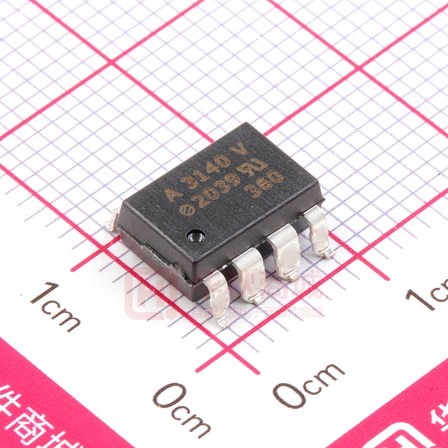

    光电耦合器 Viso=3750Vrms VF(typ)=1.5V IF=25mA
HCPL-3140-560E 数据手册
Data Sheet HCPL-3140, HCPL-0314 0.4-Amp Output Current IGBT Gate Drive Optocoupler Description Features The HCPL-3140/HCPL-0314 family of devices consists of a GaAsP LED optically coupled to an integrated circuit with a power output stage. These optocouplers are ideally suited for driving power IGBTs and MOSFETs used in motor control inverter applications. The high operating voltage range of the output stage provides the drive voltages required by gate controlled devices. The voltage and current supplied by this optocoupler make it ideally suited for directly driving small or medium power IGBTs. For IGBTs with higher ratings, the HCPL-3150 (0.5A) or HCPL-3120 (2.0A) optocouplers can be used.         Figure 1: Functional Diagram 0.4A minimum peak output current High-speed response: 0.7-μs maximum propagation delay over temperature range Ultra-high CMR: minimum 25 kV/μs at VCM = 1 kV Bootstrappable supply current: maximum 3 mA Wide operating temperature range: –40°C to 100°C Wide VCC operating range: 10V to 30V over temperature range Available in DIP-8 and SO-8 packages Safety approvals: UL approval, 3750 Vrms for 1 minute. CSA approval. IEC/EN/DIN EN 60747-5-2 approval VIORM = 630 Vpeak (HCPL-3140) Applications N/C 1 8 VCC ANODE 2 7 N.C. CATHODE 3 6 VO N/C 4 5 VEE   SHIELD HCPL-3140/HCPL-0314 Table 1: Truth Table LED    Isolated IGBT/Power MOSFET gate drive AC and brushless DC motor drives Inverters for home appliances Industrial inverters Switch Mode Power Supplies (SMPS) CAUTION! It is advised that normal static precautions be taken in handling and assembly of this component to prevent damage and/or degradation that may be induced by ESD. VO OFF LOW ON HIGH A 0.1-µF bypass capacitor must be connected between pins VCC and VEE. Broadcom AV02-0162EN May 28, 2021 HCPL-3140, HCPL-0314 Data Sheet 0.4-Amp Output Current IGBT Gate Drive Optocoupler Ordering Information HCPL-3140 and HCPL-0314 are UL recognized with 3750 Vrms for 1 minute per UL1577. Option Part Number HCPL-3140 HCPL-0314 RoHS Compliant Non RoHS Compliant -000E No option -300E #300 -500E #500 -060E #060 -360E #360 X X -560E #560 X X Package Surface Mount Gull Wing X X X X Tape & Reel IEC/EN/DIN EN 60747-5-2 Quantity 50 per tube 300 mil DIP-8 X 1000 per reel X -000E No option X -500E #500 X -060E #060 -560E #560 SO-8 50 per tube X X 50 per tube X 1000 per reel 100 per tube X X X 50 per tube X 1500 per reel X 100 per tube X 1500 per reel To order, choose a part number from the Part Number column and combine with the desired option from the Option column to form an order entry. Example 1: HCPL-3140-560E to order product of 300 mil DIP Gull Wing Surface Mount package in Tape and Reel packaging with IEC/EN/DIN EN 60747-5-2 Safety Approval in RoHS compliant. Example 2: HCPL-3140 to order product of 300 mil DIP package in tube packaging and non RoHS compliant. Option data sheets are available. Contact your Broadcom® sales representative or authorized distributor for information. Remarks: The notation '#XXX' is used for existing products, while (new) products launched since 15th July 2001 and RoHS compliant option will use '-XXXE'. Broadcom AV02-0162EN 2 HCPL-3140, HCPL-0314 Data Sheet 0.4-Amp Output Current IGBT Gate Drive Optocoupler Package Outline Drawings Figure 2: HCPL-3140 Standard DIP Package 7.62 ± 0.25 (0.300 ± 0.010) 9.65 ± 0.25 (0.380 ± 0.010) 8 TYPE NUMBER 7 6 5 6.35 ± 0.25 (0.250 ± 0.010) OPTION CODE* DATE CODE A XXXXZ YYWW RU 1 2 3 UL RECOGNITION 4 1.78 (0.070) MAX. 1.19 (0.047) MAX. + 0.076 0.254 - 0.051 + 0.003) (0.010 - 0.002) 5° TYP. 3.56 ± 0.13 (0.140 ± 0.005) 4.70 (0.185) MAX. 0.51 (0.020) MIN. 2.92 (0.115) MIN. DIMENSIONS IN MILLIMETERS AND (INCHES). * MARKING CODE LETTER FOR OPTION NUMBERS "V" = OPTION 060 OPTION NUMBERS 300 AND 500 NOT MARKED. 0.65 (0.025) MAX. 1.080 ± 0.320 (0.043 ± 0.013) 2.54 ± 0.25 (0.100 ± 0.010) NOTE: FLOATING LEAD PROTRUSION IS 0.25 mm (10 mils) MAX. Figure 3: HCPL-3140 Gull Wing Surface Mount Option 300 Outline Drawing LAND PATTERN RECOMMENDATION 9.65 ± 0.25 (0.380 ± 0.010) 8 7 6 1.016 (0.040) 5 6.350 ± 0.25 (0.250 ± 0.010) 1 2 3 10.9 (0.430) 4 1.27 (0.050) 1.19 (0.047) MAX. 1.780 (0.070) MAX. 9.65 ± 0.25 (0.380 ± 0.010) 7.62 ± 0.25 (0.300 ± 0.010) 3.56 ± 0.13 (0.140 ± 0.005) 1.080 ± 0.320 (0.043 ± 0.013) 2.0 (0.080) 0.635 ± 0.25 (0.025 ± 0.010) 0.635 ± 0.130 2.54 (0.025 ± 0.005) (0.100) BSC DIMENSIONS IN MILLIMETERS (INCHES). LEAD COPLANARITY = 0.10 mm (0.004 INCHES). + 0.076 0.254 - 0.051 + 0.003) (0.010 - 0.002) 12° NOM. NOTE: FLOATING LEAD PROTRUSION IS 0.25 mm (10 mils) MAX. Broadcom AV02-0162EN 3 HCPL-3140, HCPL-0314 Data Sheet 0.4-Amp Output Current IGBT Gate Drive Optocoupler Figure 4: HCPL-0314 Small Outline SO-8 Package LAND PATTERN RECOMMENDATION 8 7 6 5 XXX YWW 3.937 ± 0.127 (0.155 ± 0.005) 5.994 ± 0.203 (0.236 ± 0.008) 7.49 (0.295) TYPE NUMBER (LAST 3 DIGITS) DATE CODE PIN ONE 1 2 3 4 0.406 ± 0.076 (0.016 ± 0.003) 1.9 (0.075) 1.270 BSC (0.050) 0.64 (0.025) * 5.080 ± 0.127 (0.200 ± 0.005) 7° 3.175 ± 0.127 (0.125 ± 0.005) 45° X 0.432 (0.017) 0 ~ 7° 1.524 (0.060) 0.228 ± 0.025 (0.009 ± 0.001) 0.203 ± 0.102 (0.008 ± 0.004) * TOTAL PACKAGE LENGTH (INCLUSIVE OF MOLD FLASH) 5.207 ± 0.254 (0.205 ± 0.010) 0.305 MIN. (0.012) DIMENSIONS IN MILLIMETERS (INCHES). LEAD COPLANARITY = 0.10 mm (0.004 INCHES) MAX. NOTE: FLOATING LEAD PROTRUSION IS 0.15 mm (6 mils) MAX. Figure 5: Solder Reflow Temperature Profile 300 TEMPERATURE (°C) PREHEATING RATE 3°C + 1°C/–0.5°C/SEC. REFLOW HEATING RATE 2.5°C ± 0.5°C/SEC. 200 PEAK TEMP. 245°C PEAK TEMP. 240°C 2.5°C ± 0.5°C/SEC. 30 SEC. 160°C 150°C 140°C PEAK TEMP. 230°C SOLDERING TIME 200°C 30 SEC. 3°C + 1°C/–0.5°C 100 PREHEATING TIME 150°C, 90 + 30 SEC. 50 SEC. TIGHT TYPICAL LOOSE ROOM TEMPERATURE 0 0 50 100 150 200 250 TIME (SECONDS) NOTE: Broadcom Non-halide flux should be used. AV02-0162EN 4 HCPL-3140, HCPL-0314 Data Sheet 0.4-Amp Output Current IGBT Gate Drive Optocoupler Figure 6: Recommended Pb-Free IR Profile tp Tp TEMPERATURE TL Tsmax 260 +0/-5 °C TIME WITHIN 5 °C of ACTUAL PEAK TEMPERATURE 20-40 SEC. 217 °C RAMP-UP 3 °C/SEC. MAX. 150 - 200 °C RAMP-DOWN 6 °C/SEC. MAX. Tsmin ts PREHEAT 60 to 180 SEC. 25 tL 60 to 150 SEC. t 25 °C to PEAK TIME NOTES: THE TIME FROM 25 °C to PEAK TEMPERATURE = 8 MINUTES MAX. Tsmax = 200 °C, Tsmin = 150 °C NOTE: Non-halide flux should be used. Regulatory Information The HCPL-3140/HCPL-0314 have been approved by the following organizations: IEC/EN/DIN EN 60747-5-2 Approved under: IEC 60747-5-2:1997 + A1:2002 EN 60747-5-2:2001 + A1:2002 DIN EN 60747-5-2 (VDE 0884 Teil 2):2003-01 (Option 060 only) UL Approval under UL 1577, component recognition program up to VISO = 3750 Vrms. File E55361. CSA Approval under CSA Component Acceptance Notice #5, File CA 88324. Broadcom AV02-0162EN 5 HCPL-3140, HCPL-0314 Data Sheet 0.4-Amp Output Current IGBT Gate Drive Optocoupler IEC/EN/DIN EN 60747-5-2 Insulation Characteristics (HCPL-3140 Option 060) Description Symbol Installation classification per DIN VDE 0110/1.89, Table 1 For rated mains voltage ≤ 150 Vrms For rated mains voltage ≤ 300 Vrms For rated mains voltage ≤ 600 Vrms — Climatic Classification — Pollution Degree (DIN VDE 0110/1.89) Characteristic I - IV I - III I - II 55/100/21 Unit — — — 2 — VIORM 630 Vpeak Input to Output Test Voltage, Method ba VIORM x 1.875 = VPR, 100% Production Test with tm = 1 sec, Partial Discharge < 5 pC VPR 1181 Vpeak Input to Output Test Voltage, Method aa VIORM x 1.5 = VPR, Type and Sample Test, tm = 60 sec, Partial Discharge < 5 pC VPR 945 Vpeak VIOTM 6000 Vpeak TS IS,INPUT PS,OUTPUT 175 230 600 °C mA mW RS >109 Ω Maximum Working Insulation Voltage Highest Allowable Overvoltage (Transient Overvoltage tini = 10 sec) Safety-limiting values - maximum values allowed in the event of a failure. Case Temperature Input Currentb Output Powerb Insulation Resistance at TS, VIO = 500V a. Refer to the optocoupler section of the Isolation and Control Components Designer’s Catalog, under the Product Safety Regulations section IEC/EN/DIN EN 60747-5-2, for a detailed description of the Method a and Method b partial discharge test profiles. OUTPUT POWER – PS, INPUT CURRENT – IS b. See the following figure for dependence of PS and IS on ambient temperature. 800 PS (mW) IS (mA) 700 600 500 400 300 200 100 0 0 25 50 75 100 125 150 175 200 TS – CASE TEMPERATURE – °C Broadcom AV02-0162EN 6 HCPL-3140, HCPL-0314 Data Sheet 0.4-Amp Output Current IGBT Gate Drive Optocoupler Insulation and Safety Related Specifications Parameter Minimum External Air Gap (Clearance) Minimum External Tracking (Creepage) Minimum Internal Plastic Gap (Internal Clearance) Tracking Resistance (Comparative Tracking Index) Isolation Group Symbol HCPL-3140 HCPL-0314 Units L(101) 7.1 4.9 mm Measured from input terminals to output terminals, shortest distance through air. L(102) 7.4 4.8 mm Measured from input terminals to output terminals, shortest distance path along body. Through insulation distance conductor to conductor, usually the straight line distance thickness between the emitter and the detector. — 0.08 0.08 mm CTI >175 >175 V — IIIa IIIa — Conditions DIN IEC 112/VDE 0303 Part 1 Material Group (DIN VDE 0110, 1/89, Table 1) Absolute Maximum Ratings Parameter Symbol Min. Max. Units Storage Temperature TS –55 125 °C Operating Temperature TA –40 100 °C Average Input Current IF(AVG) — 25 mA Peak Transient Input Current ( 5V Threshold Input Voltage High to Low VFHL 0.8 — — V — VF 1.2 1.5 1.8 V IF = 10 mA ΔVF/ΔTA — –1.6 — mV/°C — Input Reverse Breakdown Voltage BVR 5 — — V IR = 10 µA Input Capacitance CIN — 60 — pF f = 1 MHz, VF = 0V Input Forward Voltage Temperature Coefficient of Input Forward Voltage A A e 15, 21 22 a. Maximum pulse width = 50 µs, maximum duty cycle = 0.5%. b. Maximum pulse width = 10 µs, maximum duty cycle = 0.2%. This value is intended to allow for component tolerances for designs with IO peak minimum = 0.4A. See the Applications Information section for additional details on limiting IOL peak. c. In this test, VOH is measured with a DC load current. When driving capacitive load, VOH will approach VCC as IOH approaches zero amps. d. Maximum pulse width = 1 ms, maximum duty cycle = 20%. e. The power supply current increases when the operating frequency and Qg of the driven IGBT increase. Broadcom AV02-0162EN 8 HCPL-3140, HCPL-0314 Data Sheet 0.4-Amp Output Current IGBT Gate Drive Optocoupler Switching Specifications (AC) Over recommended operating conditions unless otherwise specified. Parameter Symbol Min. Typ. Max. Units Propagation Delay Time to High Output Level tPLH 0.1 0.2 0.7 µs Propagation Delay Time to Low Output Level tPHL 0.1 0.3 0.7 µs Propagation Delay Difference Between Any Two Parts or Channels PDD –0.5 — 0.5 µs Rise Time tR — 50 — ns Fall Time tF — 50 — ns Output High Level Common Mode Transient Immunity |CMH| 25 35 Output Low Level Common Mode Transient Immunity |CML| 25 35 — — kV/µs Test Conditions Figure Note Rg = 47Ω, Cg = 3 nF, f = 10 kHz, Duty Cycle = 50%, IF = 8 mA, 16, 17, 18, 19, a 20, 23 b VCC = 30V TA = 25°C, VCM = 1 kV kV/µs 24 c 24 d a. The power supply current increases when the operating frequency and Qg of the driven IGBT increase. b. PDD is the difference between tPHL and tPLH between any two parts or channels under the same test conditions. c. Common mode transient immunity in the high state is the maximum tolerable |dVCM/dt| of the common mode pulse VCM to assure that the output will remain in the high state (i.e. VO > 6.0V). d. Common mode transient immunity in a low state is the maximum tolerable |dVCM/dt| of the common mode pulse VCM to assure that the output will remain in a low state (i.e. VO < 1.0V). Package Characteristics Parameter Symbol Min. Typ. Max. Units Test Conditions Figure Note Input-Output Momentary Withstand Voltage VISO 3750 — — Vrms TA = 25°C, RH < 50% for 1 min. a, b Input-Output Resistance RI-O — 1012 — Ω VI-O = 500V b Input-Output Capacitance CI-O — 0.6 — pF Freq = 1 MHz a. In accordance with UL 1577, each optocoupler is proof-tested by applying an insulation test voltage ≥ 4500 Vrms for 1 second (leakage detection current limit II-O ≤ 5μA). This test is performed before 100% production test for partial discharge (method B) shown in the IEC/EN/DIN EN 60747-5-2 Insulation Characteristics (HCPL-3140 Option 060) table, if applicable. b. Device considered a two-terminal device: Pins on input side shorted together, and pins on output side shorted together. Broadcom AV02-0162EN 9 HCPL-3140, HCPL-0314 Data Sheet 0.4-Amp Output Current IGBT Gate Drive Optocoupler Figure 8: IOH vs. Temperature 0 0.40 IOH – OUTPUT HIGH CURRENT – A (VOH-VCC) – HIGH OUTPUT VOLTAGE DROP – V Figure 7: VOH vs. Temperature -0.5 -1.0 -1.5 -2.0 -2.5 -50 -25 0 25 50 75 100 0.38 0.36 0.34 0.32 0.30 -50 125 -25 0 TA – TEMPERATURE – °C 25 50 75 100 125 TA – TEMPERATURE – °C Figure 9: VOH vs. IOH Figure 10: VOL vs. Temperature VOL – OUTPUT LOW VOLTAGE – V 0.44 0.43 0.42 0.41 0.40 0.39 -50 -25 0 25 50 75 100 125 TA – TEMPERATURE – °C Figure 11: IOL vs. Temperature Figure 12: VOL vs. IOL 25 VOL – OUTPUT LOW VOLTAGE – V IOL – OUTPUT LOW CURRENT – A 0.470 0.465 0.460 0.455 0.450 0.445 0.440 -50 15 10 5 0 -25 0 25 50 75 TA – TEMPERATURE – °C Broadcom 20 100 125 0 100 200 300 400 500 600 700 IOL – OUTPUT LOW CURRENT – mA AV02-0162EN 10 HCPL-3140, HCPL-0314 Data Sheet 0.4-Amp Output Current IGBT Gate Drive Optocoupler Figure 14: ICC vs. VCC 1.4 1.2 1.2 1.0 ICC – SUPPLY CURRENT – mA ICC – SUPPLY CURRENT – mA Figure 13: ICC vs. Temperature 1.0 0.8 0.6 0.4 ICCL ICCH 0.2 0 -50 -25 0 25 50 75 100 0.8 0.6 0.4 ICCL 0.2 ICCH 0 10 125 15 TA – TEMPERATURE – °C 25 30 Figure 16: Propagation Delay vs. VCC 3.5 400 TP – PROPAGATION DELAY – ns IFLH – LOW TO HIGH CURRENT THRESHOLD – mA Figure 15: IFLH vs. Temperature 3.0 2.5 2.0 1.5 -50 300 200 100 TPLH TPHL -25 0 25 50 75 100 0 10 125 15 TA – TEMPERATURE – °C 20 25 30 VCC – SUPPLY VOLTAGE – V Figure 17: Propagation Delay vs. IF Figure 18: Propagation Delay vs. Temperature 500 TP – PROPAGATION DELAY – ns 400 TP – PROPAGATION DELAY – ns 20 VCC – SUPPLY VOLTAGE – V 300 200 100 400 300 200 100 TPLH TPHL 0 6 9 12 15 IF – FORWARD LED CURRENT – mA Broadcom 18 0 -50 -25 0 25 50 75 100 125 TA – TEMPERATURE – °C AV02-0162EN 11 HCPL-3140, HCPL-0314 Data Sheet 0.4-Amp Output Current IGBT Gate Drive Optocoupler Figure 19: Propagation Delay vs. Rg Figure 20: Propagation Delay vs. Cg 400 TP – PROPAGATION DELAY – ns TP – PROPAGATION DELAY – ns 400 350 TPLH 300 TPHL 250 300 200 100 TPLH TPHL 200 50 0 100 150 0 200 0 Rg – SERIES LOAD RESISTANCE – Ω Figure 21: Transfer Characteristics 40 60 80 100 Figure 22: Input Current vs. Forward Voltage 25 35 IF – FORWARD CURRENT – mA 30 VO – OUTPUT VOLTAGE – V 20 Cg – LOAD CAPACITANCE – nF 25 20 15 10 5 20 15 10 5 0 -5 0 1 2 3 4 5 IF – FORWARD LED CURRENT – mA Broadcom 6 0 1.2 1.4 1.6 1.8 VF – FORWARD VOLTAGE – V AV02-0162EN 12 HCPL-3140, HCPL-0314 Data Sheet 0.4-Amp Output Current IGBT Gate Drive Optocoupler Figure 23: Propagation Delay Test Circuit and Waveforms 1 8 0.1 μF IF = 7 to 16 mA 2 + 10 KHz – + – 7 500Ω IF VCC = 15 to 30V tr tf VO 50% DUTY CYCLE 3 6 90% 47Ω 50% VOUT 3 nF 4 10% 5 tPLH tPHL Figure 24: CMR Test Circuit and Waveforms V CM 1 5V δt 0.1 μF A B δV 8 IF 2 VO 3 6 4 5 V CM Δt 0V 7 + – = Δt + – V CC = 30V VO V OH SWITCH AT A: I F = 10 mA VO V OL + – SWITCH AT B: I F = 0 mA V CM = 1500V Broadcom AV02-0162EN 13 HCPL-3140, HCPL-0314 Data Sheet 0.4-Amp Output Current IGBT Gate Drive Optocoupler Applications Information Eliminating Negative IGBT Gate Drive To keep the IGBT firmly off, the HCPL-3140/HCPL-0314 has a very low maximum VOL specification of 1.0V. Minimizing Rg and the lead inductance from the HCPL-3140/HCPL-0314 to the IGBT gate and emitter (possibly by mounting the HCPL-3140/HCPL-0314 on a small PC board directly above the IGBT) can eliminate the need for negative IGBT gate drive in many applications as shown in Figure 25. Care should be taken with such a PC board design to avoid routing the IGBT collector or emitter traces close to the HCPL-3140/HCPL-0314 input as this can result in unwanted coupling of transient signals into the input of HCPL-3140/HCPL-0314 and degrade performance. (If the IGBT drain must be routed near the HCPL-3140/HCPL-0314 input, then the LED should be reverse-biased when in the off state to prevent the transient signals coupled from the IGBT drain from turning on the HCPL-3140/HCPL-0314.) Figure 25: Recommended LED Drive and Application Circuit for HCPL-3140/HCPL-0314 HCPL-3140/HCPL-0314 +5V 1 270Ω CONTROL INPUT 74XXX OPEN COLLECTOR Broadcom 8 0.1 μF 2 7 3 6 4 5 + – VCC = 15V + HVDC Rg Q1 3-PHASE AC Q2 - HVDC AV02-0162EN 14 HCPL-3140, HCPL-0314 Data Sheet Step 1: Calculate Rg minimum from the IOL peak specification. The IGBT and Rg in Figure 25 can be analyzed as a simple RC circuit with a voltage supplied by the HCPL-3140/HCPL-0314. y Rg ≥ VCC – VOL IOLPEAK = 24V – 5V 0.6A = 32Ω The VOL value of 5V in the previous equation is the VOL at the peak current of 0.6A. (See Figure 12.) Step 2: Check the HCPL-3140/HCPL-0314 power dissipation and increase Rg if necessary. The HCPL-3140/ HCPL-0314 total power dissipation (PT) is equal to the sum of the emitter power (PE) and the output power (PO). PT = PE + PO PE = IF  VF  Duty Cycle PO = PO(BIAS) + PO(SWITCHING) = ICC  VCC + ESW (Rg,Qg)  f = (ICCBIAS + KICC  Qg  f)  VCC + ESW (Rg,Qg)  f Where KICC  Qg  f is the increase in ICC due to switching and KICC is a constant of 0.001 mA/(nC*kHz). For the circuit in Figure 25 with IF (worst case) = 10 mA, Rg = 32Ω, Max Duty Cycle = 80%, Qg = 100 nC, f = 20 kHz, and TAMAX = 85°C: PE = 10 mA  1.8V  0.8 = 14 mW PO = (3 mA + (0.001 mA/(nC  kHz))  20 kHz  100 nC) 24V + 0.4 µJ  20 kHz = 128 mW < 250 mW (PO(MAX) @ 85°C) The value of 3 mA for ICC in the previous equation is the max. ICC over the entire operating temperature range. Since PO for this case is less than PO(MAX), Rg = 32Ω is alright for the power dissipation. Broadcom Figure 26: Energy Dissipated in the HCPL-0314 and for Each IGBT Switching Cycle Esw – ENERGY PER SWITCHING CYCLE – μJ Selecting the Gate Resistor (Rg) 0.4-Amp Output Current IGBT Gate Drive Optocoupler 4.0 Qg = 50 nC Qg = 100 nC Qg = 200 nC Qg = 400 nC 3.5 3.0 2.5 2.0 1.5 1.0 0.5 0 0 20 40 60 80 100 Rg – GATE RESISTANCE – Ω LED Drive Circuit Considerations for UltraHigh CMR Performance Without a detector shield, the dominant cause of optocoupler CMR failure is capacitive coupling from the input side of the optocoupler, through the package, to the detector IC as shown in Figure 27. The HCPL-3140/ HCPL-0314 improves CMR performance by using a detector IC with an optically transparent Faraday shield, which diverts the capacitively coupled current away from the sensitive IC circuitry. However, this shield does not eliminate the capacitive coupling between the LED and optocoupler pins 5-8 as shown in Figure 28. This capacitive coupling causes perturbations in the LED current during common mode transients and becomes the major source of CMR failures for a shielded optocoupler. The main design objective of a high CMR LED drive circuit becomes keeping the LED in the proper state (on or off) during common mode transients. For example, the recommended application circuit (Figure 25) can achieve 25-kV/µs CMR while minimizing component complexity. Techniques to keep the LED in the proper state are discussed in the next two sections. AV02-0162EN 15 HCPL-3140, HCPL-0314 Data Sheet 0.4-Amp Output Current IGBT Gate Drive Optocoupler Figure 27: Optocoupler Input to Output Capacitance Model for Unshielded Optocouplers 1 Figure 28: Optocoupler Input to Output Capacitance Model for Shielded Optocouplers 8 1 7 2 CLEDO1 CLEDP 2 8 CLEDP 7 CLEDO2 3 CLEDN 4 6 3 5 4 Figure 29: Equivalent Circuit for Figure 23 During Common Mode Transient 6 CLEDN 5 SHIELD Figure 30: Not Recommended Open Collector Drive Circuit 1 +5V 1 8 0.1 μF CLEDP 2 + VSAT – 7 8 +5V + – CLEDP 2 VCC = 18V 7 ILEDP 3 ••• 6 CLEDN Rg 3 Q1 CLEDN 6 ILEDN 4 SHIELD 5 ••• 4 SHIELD 5 * THE ARROWS INDICATE THE DIRECTION OF CURRENT FLOW DURING –dVCM/dt. + – VCM Figure 31: Recommended LED Drive Circuit for Ultra-High CMR IPM Dead Time and Propagation Delay Specifications 1 8 +5V CLEDP 2 3 4 Broadcom 7 CLEDN SHIELD 6 5 AV02-0162EN 16 HCPL-3140, HCPL-0314 Data Sheet CMR with the LED On (CMRH) A high CMR LED drive circuit must keep the LED on during common mode transients. This is achieved by over-driving the LED current beyond the input threshold so that it is not pulled below the threshold during a transient. A minimum LED current of 8 mA provides adequate margin over the maximum IFLH of 5 mA to achieve 25-kV/µs CMR. CMR with the LED Off (CMRL) A high CMR LED drive circuit must keep the LED off (VF ≤ VF(OFF)) during common mode transients. For example, during a –dVCM/dt transient in Figure 29, the current flowing through CLEDP also flows through the RSAT and VSAT of the logic gate. As long as the low state voltage developed across the logic gate is less than VF(OFF), the LED will remain off and no common mode failure will occur. The open collector drive circuit, shown in Figure 30, cannot keep the LED off during a +dVCM/dt transient, since all the current flowing through CLEDN must be supplied by the LED, and it is not recommended for applications requiring ultrahigh CMR1 performance. The alternative drive circuit, which like the recommended application circuit (Figure 25), does achieve ultra-high CMR performance by shunting the LED in the off state. 0.4-Amp Output Current IGBT Gate Drive Optocoupler IPM Dead Time and Propagation Delay Specifications The HCPL-3140/HCPL-0314 includes a Propagation Delay Difference (PDD) specification intended to help designers minimize “dead time” in their power inverter designs. Dead time is the time that high-side and low-side power transistors are off. Any overlap in Q1 and Q2 conduction will result in large currents flowing through the power devices from the high-voltage to the low-voltage motor rails. To minimize dead time in a given design, the turn on of LED2 should be delayed (relative to the turn off of LED1) so that under worst-case conditions, transistor Q1 has just turned off when transistor Q2 turns on, as shown in Figure 32. The amount of delay necessary to achieve this condition is equal to the maximum value of the propagation delay difference specification, PDD max, which is specified to be 500 ns over the operating temperature range of –40°C to 100°C. Delaying the LED signal by the maximum propagation delay difference ensures that the minimum dead time is zero, but it does not tell a designer what the maximum dead time will be. The maximum dead time is equivalent to the difference between the maximum and minimum propagation delay difference specification as shown in Figure 33. The maximum dead time for the HCPL-3140/HCPL-0314 is 1 µs (= 0.5 µs – (–0.5 µs)) over the operating temperature range of –40°C to 100°C. Note that the propagation delays used to calculate PDD and dead time are taken at equal temperatures and test conditions since the optocouplers under consideration are typically mounted in close proximity to each other and are switching identical IGBTs. Broadcom AV02-0162EN 17 HCPL-3140, HCPL-0314 Data Sheet 0.4-Amp Output Current IGBT Gate Drive Optocoupler Figure 32: Minimum LED Skew for Zero Dead Time ILED1 VOUT1 Q1 ON Q1 OFF Q2 ON VOUT2 ILED2 Q2 OFF tPHL MAX tPLH MIN PDD* MAX = (tPHL– tPLH)MAX = tPHL MAX – tPLH MIN *PDD = PROPAGATION DELAY DIFFERENCE NOTE: FOR PDD CALCULATIONS, THE PROPAGATION DELAYS ARE TAKEN AT THE SAME TEMPERATURE AND TEST CONDITIONS. Figure 33: Waveforms for Dead Time ILED1 VOUT1 Q1 ON Q1 OFF Q2 ON VOUT2 Q2 OFF ILED2 tPHL MIN tPHL MAX tPLH MIN tPLH MAX (tPHL – tPLH) MAX PDD* MAX MAXIMUM DEAD TIME (DUE TO OPTOCOUPLER) = (tPHL MAX – tPHL MIN) + (tPLH MAX – tPLH MIN) = (tPHL MAX – tPLH MIN) – (tPHL MIN – tPLH MAX) = PDD* MAX – PDD* MIN *PDD = PROPAGATION DELAY DIFFERENCE NOTE: FOR DEAD TIME AND PDD CALCULATIONS, ALL PROPAGATION DELAYS ARE TAKEN AT THE SAME TEMPERATURE AND TEST CONDITIONS. Broadcom AV02-0162EN 18 Broadcom, the pulse logo, Connecting everything, Avago Technologies, Avago, and the A logo are among the trademarks of Broadcom and/or its affiliates in the United States, certain other countries, and/or the EU. Copyright © 2007–2021 Broadcom. All Rights Reserved. The term “Broadcom” refers to Broadcom Inc. and/or its subsidiaries. For more information, please visit www.broadcom.com. Broadcom reserves the right to make changes without further notice to any products or data herein to improve reliability, function, or design. Information furnished by Broadcom is believed to be accurate and reliable. However, Broadcom does not assume any liability arising out of the application or use of this information, nor the application or use of any product or circuit described herein, neither does it convey any license under its patent rights nor the rights of others.
