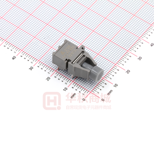

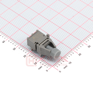

HFBR-1506AM/HFBR-2506AM Fiber Optic SMA Transmitters and Receivers for 16 MBd SERCOS Applications Data Sheet Description SERCOS, an acronym for S E rial R ealtime CO mmunications S ystems, is a standard digital interface for communication in industrial CNC applications. SERCOS is a European (EN 61491) and international standard (IEC 61491). The optical interface allows data rates of 2,4,8 and 16 MBd and data transfer between numerical controls and drives via fiber-optic rings, with voltage isolation and noise immunity. The HFBR-1506AM and HFBR-2506AM products have a guaranteed performance up to 16 MBd. Features • • • • • • Meets Industrial SERCOS 16MBd standard SMA ports 650 nm wavelength Metal coated, plastic packaging Specified for use with 1 mm POF and 200 µm HCS DC - 16 MBd data rate Applications • Industrial Control Data Links • Factory Automation Data Links • Voltage Isolation Applications °, ±, ≥,≤,≠,∅, ∞,µ,π,ο,θ,λ, ρ,σ,γ,φ,η, δ,χ,β,α,Ω,, Σ,,,∏,, ∝,∂,τ,υ,ϖ, ω,ξ,ψ,ζ,∅, ≈,,, • • Bullet Bold Obsoletes: 5988-8402EN 5988-9121EN Package Information The transmitters and receivers are housed in a lowcost, dual-in-line package that is made of high strength, heat resistant, chemically resistant and UL 94V-O (UL file # E121562) flame retardant plastic. Both the transmitter and receiver are coated with a layer of conductive alloy for better air discharge (ESD) performance. The package is designed for auto insertion and wave soldering so it is ideal for high volume production applications. Handling and Design Information When soldering, it is advisable to leave the protective cap on the unit to keep the optics clean. Good system performance requires clean port optics and cable ferrules to avoid obstructing the optical path. Clean compressed air often is sufficient to remove particles of dirt; methanol on a cotton swab also works well. Recommended Chemicals for Cleaning/Degreasing Alcohols: methyl, isopropyl, isobutyl. Aliphatics: hexane, heptane. Other: soap solution, naphtha. Do not use partially halogenated hydrocarbons such as 1,1,1 trichloroethane, ketones such as MEK, acetone, chloroform, ethyl acetate, methylene dichloride, phenol, methylene chloride or N-methylpyrolldone. Also, Agilent does not recommend the use of cleaners that use halogenated hydrocarbons because of their potential environmental harm. CAUTION: The small junction size inherent in the design of these components increases the components’ susceptibility to damage from electrostatic discharge (ESD). It is advised that normal static precautions be taken in handling and assembly of these components to prevent damage and/or degradation which may be induced by ESD. Table 1. Link Performance Specification 0 °C to +70 °C unless otherwise noted. Parameter Link distance with HFBR-1506AM/2506AM Symbol I Min 0.1 0.1 Max 45 200 Unit m m Condition POF HCS Reference Note 1, 2, 4, 6 Note 1, 3, 5, 6 Notes: 1. 60 mA nominal drive current. 2. POF HFBR-Exxyyy 0.23 dB/m worst case attenuation. 3. HCS 10 dB/km worst case attenuation. 4. Including a 3 dB optical safety margin accounting for link service lifetime. 5. Including a 2 dB optical safety margin accounting for link service lifetime. 6. Signaling rate dc to 16 MBd. 2 HFBR-1506AM Transmitter 4 5 6 7 1 8 The HFBR-1506AM transmitter incoporates a 650nm LED in a metal-coated, plastic housing. The high light output power enables the use of both plastic optical fiber (POF) and Hard Clad Silica (HCS). This transmitter can operate up to 16MBd using a simple driver circuit. The HFBR-1506AM is compatible with SMA connectors. PIN 1 4 5 6 7 8 FUNCTION CONNECTED TO PIN 4 CONNECTED TO PIN 1 GND GND CATHODE ANODE BOTTOM VIEW, HFBR-1506AM SEE NOTE 10 Figure 1. Absolute Maximum Ratings Parameter Storage and Operating Temperature Peak Forward Input Current Average Forward Input Current Reverse Input Voltage Lead Soldering Cycle Temp Time Symbol TS, O Min -40 Max +85 90 60 3 Unit °C mA mA V Notes IF, PK IF, AVG VR 1 TSOL TSOL 260 10 °C s 2 Notes: 1. For I F_PK > 60 mA, the duty factor must maintain I F_AVG
HFBR-2506AM
### 物料型号 - 型号:HFBR-1506AM(发射器)和HFBR-2506AM(接收器)
### 器件简介 - 简介:SERCOS是一种用于工业CNC应用通信的标准数字接口。HFBR-1506AM和HFBR-2506AM产品保证在16 MBd的数据传输性能。
### 引脚分配 - HFBR-1506AM: - 1:连接到引脚4 - 4:连接到引脚1 - 5:地(GND) - 6:地(GND) - 7:阴极(CATHODE) - 8:阳极(ANODE) - HFBR-2506AM: - 1:连接到引脚4 - 4:连接到引脚1 - 5:无连接(NO CONNECT) - 6:电源(VCC) - 7:地(GND) - 8:输出(VO)
### 参数特性 - HFBR-1506AM: - 存储和工作温度:-40°C至+85°C - 最大正向输入电流:90mA - 平均正向输入电流:60mA - 反向输入电压:3V - HFBR-2506AM: - 存储和工作温度:-40°C至+85°C - 供电电压:0.5V至5.5V - 平均输出电流:16mA - 输出功率耗散:80mW
### 功能详解 - HFBR-1506AM:集成650nm LED,适用于塑料光纤(POF)和硬包层硅(HCS),可使用简单的驱动电路在16MBd下工作。 - HFBR-2506AM:包含硅PIN光电二极管和数字化IC,产生逻辑兼容输出,具有独特的电路以纠正长时间空闲后第一个比特的脉冲宽度失真。
### 应用信息 - 应用:工业控制数据链路、工厂自动化数据链路、电压隔离应用。
### 封装信息 - 封装:发射器和接收器都封装在低成本的双列直插式封装中,由高强度、耐热、耐化学腐蚀和UL 94V-0(UL文件#E121562)阻燃塑料制成。两者都涂有一层导电合金,以提高空气放电(ESD)性能。
