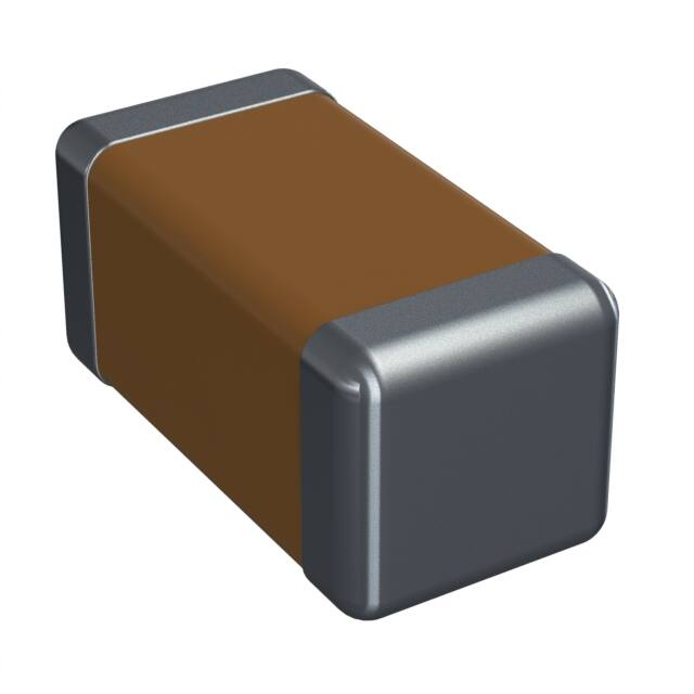

High Voltage MLC Chips For 600V to 5000V Applications High value, low leakage and small size are difficult parameters to obtain in capacitors for high voltage systems. KYOCERA AVX special high voltage MLC chip capacitors meet these performance characteristics and are designed for applications such as snubbers in high frequency power converters, resonators in SMPS, and high voltage coupling/dc blocking. These high voltage chip designs exhibit low ESRs at high frequencies. Larger physical sizes than normally encountered chips are used to make high voltage MLC chip products. Special precautions must be taken in applying these chips in surface mount assemblies. The temperature gradient during heating or cooling cycles should not exceed 4ºC per second. The preheat temperature must be within 50ºC of the peak temperature reached by the ceramic bodies through the soldering process. Chip sizes 1210 and larger should be reflow soldered only. Capacitors may require protective surface coating to prevent external arcing. For 1825, 2225 and 3640 sizes, KYOCERA AVX offers leaded version in either thru-hole or SMT configurations (for details see section on high voltage leaded MLC chips) NEW 630V RANGE HOW TO ORDER 1808 Style 0805 1206 1210 1808 1812 1825 2220 2225 3640 *** T A A 271 M A Voltage Temperature Coefficient Capacitance Code Capacitance Tolerance A = Standard C = 600V/630V A = 1000V S = 1500V G = 2000V W = 2500V H = 3000V J = 4000V K = 5000V A = NPO (C0G) C = X7R (2 significant digits + no. of zeros) Examples: 10 pF = 100 100 pF = 101 1,000 pF = 102 22,000 pF = 223 220,000 pF = 224 1 μF = 105 C0G: J = ±5% K = ±10% M = ±20% X7R: K = ±10% M = ±20% Z = +80%, -20% Test Level Termination* T = Plated Ni and Sn (RoHS Compliant) 2 A Packaging Special Code 2 = 7” Reel** 4 = 13” Reel A = Standard Notes: 1. Capacitors with X7R dielectrics are not intended for applications across AC supply mains or AC line filtering with polarity reversal. Contact plant for recommendations. Contact factory for availability of Termination and Tolerance options for Specific Part Numbers. 2. *Terminations with 5% minimum lead (Pb) is available, see pages 100 and 101 for LD style. Leaded terminations are available, see pages 102-106. **The 3640 Style is not available on 7” Reels. *** KYOCERA AVX offers nonstandard chip sizes. Contact factory for details. DIMENSIONS: millimeters (inches) SIZE 0805 2.10 ± 0.20 (0.083 ± 0.008) 1.25 ± 0.20 (W) Width (0.049 ±0.008) min. 0.50 ± 0.20 (t) terminal max. (0.020 ± 0.008) (L) Length 1206 1210* 1808* 1812* 1825* 2220* 2225* 3640* 3.30 ± 0.30 (0.130 ± 0.012) 1.60 ± 0.20 (0.063 ± 0.008) 0.60 ± 0.20 (0.024 ± 0.008) 3.30 ± 0.40 (0.130 ± 0.016) 2.50 ± 0.30 (0.098 ± 0.012) 0.75 ± 0.35 (0.030 ± 0.014) 4.60 ± 0.50 (0.181 ± 0.020) 2.00 ± 0.20 (0.079 ± 0.008) 0.75 ± 0.35 (0.030 ± 0.014) 4.60 ± 0.50 (0.181 ± 0.020) 3.20 ± 0.30 (0.126 ± 0.012) 0.75 ± 0.35 (0.030 ± 0.014) 4.60 ± 0.50 (0.181 ± 0.020) 6.30 ± 0.40 (0.248 ± 0.016) 0.75 ± 0.35 (0.030 ± 0.014) 5.70 ± 0.50 (0.224 ± 0.020) 5.00 ± 0.40 (0.197 ± 0.016) 0.85 ± 0.35 (0.033 ± 0.014) 5.70 ± 0.50 (0.224 ± 0.020) 6.30 ± 0.40 (0.248 ± 0.016) 0.85 ± 0.35 (0.033 ± 0.014) 9.14 ± 0.25 (0.360 ± 0.010) 10.2 ± 0.25 (0.400 ± 0.010) 0.76 (0.030) 1.52 (0.060) *Reflow Soldering Only The Important Information/Disclaimer is incorporated in the catalog where these specifications came from or available online at www.kyocera-avx.com/disclaimer/ by reference and should be reviewed in full before placing any order. 072022 – surface mount ceramic capacitor products – 97 High Voltage MLC Chips For 600V to 5000V Applications NP0 (C0G) DIELECTRIC – PERFORMANCE CHARACTERISTICS Capacitance Range Capacitance Tolerances Dissipation Factor Operating Temperature Range Temperature Characteristic Voltage Ratings Insulation Resistance (+25°C, at 500 VDC) Insulation Resistance (+125°C, at 500 VDC) Dielectric Strength 10 pF to 0.100 μF (25°C, 1.0 ±0.2 Vrms at 1kHz, for ≤ 1000 pF use 1 MHz) ±5%, ±10%, ±20% 0.1% max. (+25°C, 1.0 ±0.2 Vrms, 1kHz, for ≤ 1000 pF use 1 MHz) -55°C to +125°C 0 ±30 ppm/°C (0 VDC) 600, 630, 1000, 1500, 2000, 2500, 3000, 4000 & 5000 VDC (+125°C) 100K MΩ min. or 1000 MΩ - μF min., whichever is less 10K MΩ min. or 100 MΩ - μF min., whichever is less Minimum 120% rated voltage for 5 seconds at 50 mA max. current NPO (C0G) CAPACITANCE RANGE – PREFERRED SIZES ARE SHADED Case Size Soldering (L) Length W) Width (t) Terminal mm (in.) mm (in.) mm (in.) Voltage (V) Cap (pF) .5 1.0 1.2 1.5 1.8 2.2 2.7 3.3 3.9 4.7 5.6 6.8 8.2 10 12 15 18 22 27 33 39 47 56 68 82 100 120 150 180 220 270 330 390 470 560 680 750 820 1000 1200 1500 1800 2200 2700 3300 3900 4700 5600 6800 8200 Cap (µF) 0.010 0.012 0.015 0.018 0.022 0.027 0.033 0.047 0.056 0.068 0.100 Voltage (V) Case Size Letter Max. Thickness 98 0R5 1R0 1R2 1R5 1R8 2R2 2R7 3R3 3R9 4R7 5R6 6R8 8R2 100 120 150 180 220 270 330 390 470 560 680 820 101 121 151 181 221 271 331 391 471 561 681 751 821 102 122 152 182 222 272 332 392 472 562 682 822 103 123 153 183 223 273 333 473 563 683 104 A 0.81 (0.032) 0805 1206 1210 1808 1812 Reflow/Wave Reflow/Wave Reflow Only Reflow Only Reflow Only 2.10 ± 0.20 3.30 + 0.30 3.30 + 0.40 4.60 + 0.50 4.60 + 0.50 (0.085 ± 0.008) (0.130 + 0.012) (0.130 + 0.016) (0.181 + 0.020) (0.177 + 0.012) 1.25 ± 0.2 0 1.60 +0.30/-0.10 2.50 + 0.30 2.00 + 0.20 3.20 + 0.30 (0.049 ± 0.008) (0.063 +0.012/-0.004) (0.098 + 0.012) (0.079 + 0.008) (0.126 + 0.008) 0.50 + 0.20 0.60 + 0.20 0.75 + 0.35 0.75 + 0.35 0.75 + 0.35 (0.020 + 0.008) (0.0 4 + 0.008) (.030 + 0.014) (.030 + 0.014) (.030 + 0.014) 600 630 1000 600 630 1000 1500 2000 600 630 1000 1500 2000 3000 600 630 1000 1500 2000 2500 3000 4000 600 630 1000 1500 2000 2500 3000 4000 A C A C A C A A C X X X X X A A C X X X X X A A C X X X X X C C C C C A A C X X X X X C C C C C C C A A C X X X X X C C C C C C C A A C X X X X X C C C C C C C A A C X X X X X C C C C C C C A A C X X X X X C C C C C C C A A C X X X X X C C C C C C C A A C X X X X X C C C C C C C A A C C F C C C C C C C C C C C C C C C E C C C C C C C C C A A C C F C C C C C C C C C C C C C C C E C C C C C C C C C A A C C F C C C C C C C C C C C C C C C E C C C C C C C C C A A C C F C C C C C C C C C C C C C C C E C C C C C C C C C A A C C F C C C C C C C E C C C C C C C E C C C C C C C C C A A C C F C C C C C C C E C C C C F C C E C C C C C C C C C A A C C F C C C C C C C F C C C C F C C E C C C C C C C C C A A C C F C C C C C C C F C C C C F C C E C C C C C C C C C A A C C F C C C C C C C F C C C C F C C E C C C C C C C C C A A C C F C C C C C C C C C C C F C C F C C C C C C C C C A A C C F C C C C C C C C C C C F C C F C C C C C C C C C X X X C F C C C C C C C C C C C F C C F C C C C C C C C C X X X C F C C C C C F F C C C C F C C F C C C C C C C C C C C C C F C C C C C F F C C C C F C C G C C C E E C C C C C C C E F C C C F F F F C C C C F C C G C C C E E C C C E C C C E F C C C F F F F C C C C F F F C C E E E C C E E C C C E F C C C F F F F C C C C F F F C C E E E C C E E C C C E G C F C F F F F C C C C F F F C C E E E C C E E C C C E C F F F F F F C C C F F F F C C E E E C C E E C C C E C F F F F F F C C C F F F F C C E E E C C E E C C E C F F F F F F C C F F F F F C C E E E C C E E C C C C E C C E E E C F F F F F C C F F F F F C C C C E C C E E E C F F F F C C F F F G G C C E E E C C E E E C F F F F C C F F F G G C C E E E C C E E E C F F E F C C F F F G G C E E E C C E F F C F F E F C C F F F G G C E E E C C E F F C F F E F C C F E E C E E C C F G G E F F F C C F F F C E E C C G G G E F F F C C F G F C E E C C G E F F C C E G G E E C C G E F F C C E G G E E C C G E F F C C F G E E C C G E F C C F E E C C E F C C G E E E F C C G E E F F C C F F F E C F F F F F F F F F G G G G G G F G G 600 630 1000 600 630 1000 1500 2000 600 630 1000 1500 2000 3000 600 630 1000 1500 2000 2500 3000 4000 600 630 1000 1500 2000 2500 3000 4000 0805 1206 1210 1808 1812 C 1.45 (0.057) E 1.80 (0.071) F 2.20 (0.087) G 2.80 (0.110) X 0.94 (0.037) 7 3.30 (0.130) NOTE: Contact factory for non-specified capacitance values The Important Information/Disclaimer is incorporated in the catalog where these specifications came from or available online at www.kyocera-avx.com/disclaimer/ by reference and should be reviewed in full before placing any order. 072222 – surface mount ceramic capacitor products – High Voltage MLC Chips For 600V to 5000V Applications NP0 (C0G) CAPACITANCE RANGE – PREFERRED SIZES ARE SHADED Case Size Soldering (L) Length W) Width (t) Terminal 1825 Reflow Only 2225 Reflow Only 3640 Reflow Only mm 4.60 ± 0.50 5.70 ± 0.50 5.70 ± 0.50 9.14 ± 0.25 (in.) (0.181 ± 0.020) (0.224 ± 0.020) (0.224 ± 0.020) (0.360 ± 0.010) mm 6.30 ± 0.40 5.00 ± 0.40 6.30 ± 0.40 10.2 ± 0.25 (in.) (0.248 ± 0.016) (0.197 ± 0.016) (0.248 ± 0.016) (0.400 ± 0.010) mm 0.75 ± 0.35 0.85 ± 0.35 0.85 ± 0.35 0.76 (0.030) max Voltage (V) Cap (pF) 2220 Reflow Only (0.030 ± 0.014) 600 (0.033 ± 0.014) 630 1000 1500 2000 2500 3000 4000 600 (0.033 ± 0.014) 630 1000 1500 2000 2500 3000 4000 5000 600 1.52 (0.060) 630 1000 1500 2000 2500 3000 4000 5000 600 630 1000 1500 2000 2500 3000 4000 5000 1.5 1R5 1.8 1R8 2.2 2R2 2.7 2R7 3.3 3R3 3.9 3R9 4.7 4R7 5.6 5R6 6.8 6R8 8.2 8R2 10 100 E E G E F E F F E E E E E E E E E E E E E E E E F F 12 120 E E G E F E F F E E E E E E E E E E E E E E E E F F 15 150 E E G E F E F F E E E E E E E E E E E E E E E E F F 18 180 E E G E F E F F E E E E E E E E E E E E E E E E F F 22 220 E E G E F E F F E E E E E E E E E E E E E E E E F F 27 270 E E G E F E F F E E E E E E E E E E E E E E E E F F 33 330 E E G E F E F F E E E E E E E E E E E E E E E E F F 39 390 E E G E F E F F E E E E E E E E E E E E E E E E F F 47 470 E E G E F E F F E E E E E E E E E E E E E E E E F G 56 560 E E G E F E F F E E E E E E E E E E E E E E E E F G G 68 680 E E G E F E F F E E E E E E E E E E E E E E E E F G G G 82 820 E E G E F E F F E E E E E E E E E E E E E E E E F G 100 101 E E G E F E F F E E E E E E E E E E E E E E E E G G G G G G G G 120 121 E E G E F E F F E E E E E E E E E E E E E E E E G G G G G G G G G 150 151 E E G E F E F F E E E E E E E E E E E E E E E E G G G G G G G G 180 181 E E G E F E F F E E E E E E E F F E E E E E E E G G G G G G G G 220 221 E E G E F E F F E E E E E E E F F E E E E E E E G G G G G G G G 270 271 E E G E F E F F E E E E E E E E E E E E E E G G G G G G G G 330 331 E E G E F E F F E E E E E E E E E E E E E E G G G G G G G 390 391 E E G E F E F E E E E E E E E E E E E E E G G G G G G G 470 471 E E G E F E F E E E E E E E E E E E E E E G G G G G G G 560 561 E E G E F E F E E E E E E E E E E E E E E G G G G G G 680 681 E E G E F F G E E E E E F F E E E E E E E G G G G G G 750 751 E E G E F F G E E E E E F F E E E E E E E G G G G G G G 820 821 E E G E F F G E E E E E F F E E E E E F E G G G G G 1000 102 E E G E F F G E E E E E F F E E E E E E E G G G G G G G G 1200 122 E E G E F G G E E E E E G G E E E E E F F G G G G G G G G 1500 152 E E G F G G G E E E F F G G E E E E E F F G G G G G G G 1800 182 E E G F G G G E E E F F G G E E E E E G G G G G G G G G 2200 222 E E G G G G E E E G G E E E E E G G G G G G G 2700 272 E E G G G G E E E G G E E E F F G G G G G G G 3300 332 E E G G G E E E G G E E E F F G G G G G G 3900 392 E E G G G E E E G G E E E G G G G G G G G 4700 472 E E G G G E E E G G F F F G G G G G G G 5600 562 F F G G G F F F G G F F F G G G G G G G 6800 682 F F G G F F F F F F G G G G G G G 8200 822 F F G G G G G G G G G G G G Cap (μF) 0.010 103 F F G 7 7 7 G G G G G G G 0.012 123 F F G G G G G G 0.015 153 F F G G G G G 0.018 183 F F G G G G G 0.022 223 F F G G G G G 0.027 273 F F 0.033 333 F F G G G G 0.039 393 G G 0.047 473 G G G G G G 0.056 563 G G G G 0.068 683 G G G G 0.100 104 Voltage (V) Case Size Letter Max. Thickness 600 630 1000 1500 2000 2500 3000 4000 600 630 1000 1500 2000 2500 3000 4000 5000 600 1825 A 0.81 (0.032) C 1.45 (0.057) E 1.80 (0.071) 2220 F 2.20 (0.087) G 2.80 (0.110) X 0.94 (0.037) 7 3.30 (0.130) 630 1000 1500 2000 2500 3000 4000 5000 600 G 630 1000 1500 2000 2500 3000 4000 5000 2225 3640 NOTE: Contact factory for non-specified capacitance values The Important Information/Disclaimer is incorporated in the catalog where these specifications came from or available online at www.kyocera-avx.com/disclaimer/ by reference and should be reviewed in full before placing any order. 072022 – surface mount ceramic capacitor products – 99 High Voltage MLC Chips For 600V to 5000V Applications X7R Dielectric Performance Characteristics Capacitance Range Capacitance Tolerances Dissipation Factor Operating Temperature Range Temperature Characteristic Voltage Ratings Insulation Resistance (+25°C, at 500 VDC) Insulation Resistance (+125°C, at 500 VDC) Dielectric Strength 10 pF to 0.82 µF (25°C, 1.0 ±0.2 Vrms at 1kHz) ±10%; ±20%; +80%, -20% 2.5% max. (+25°C, 1.0 ±0.2 Vrms, 1kHz) -55°C to +125°C ±15% (0 VDC) 600, 630, 1000, 1500, 2000, 2500, 3000, 4000 & 5000 VDC (+125°C) 100K MΩ min. or 1000 MΩ - µF min., whichever is less 10K MΩ min. or 100 MΩ - µF min., whichever is less Minimum 120% rated voltage for 5 seconds at 50 mA max. current X7R CAPACITANCE RANGE – PREFERRED SIZES ARE SHADED Case Size Soldering 0805 Reflow/Wave mm 2.10 ± 0.20 (in.) (0.085 ± 0.008) mm 1.25 ± 0.20 (in.) (0.049 ± 0.008) mm 0.50 ± 0.20 (t) Terminal max (0.020 ± 0.008) Voltage (V) 600 630 1000 Cap (pF) 100 101 X X C (L) Length W) Width 3.30 ± 0.30 (0.130 ± 0.012) 1.60 +0.30/-0.10 (0.063 +0.012/-0.004) 0.60 ± 0.20 (0.024 ± 0.008) 600 630 1000 1500 2000 C C E E E 1210 Reflow Only 600 E 3.30 ± 0.40 (0.130 ± 0.016) 2.50 ± 0.30 (0.098 ± 0.012) 0.75 ± 0.35 (0.030 ± 0.014) 630 1000 1500 2000 600 E E E E 1808 Reflow Only 630 4.60 ± 0.50 (0.181 ± 0.020) 2.00 ± 0.20 (0.079 ± 0.008) 0.75 ± 0.35 (0.030 ± 0.014) 1000 1500 2000 2500 3000 4000 1812 Reflow Only 4.60 ± 0.50 (0.177 ± 0.012) 3.20 ± 0.30 (0.126 ± 0.008) 0.75 ± 0.35 (0.030 ± 0.014) 1000 1500 2000 2500 3000 4000 600 630 E E E E E E E E E E F E E E E E E F E E E E E E E E F F E E E E E E E E E F F E E E E E F F E E E F F E E E E E F F E E E E F F E E E E E F F E E E E E F F E E E E E F F E E E E E E F F F F F F F F F E E E E E E F F F F F F F G G E E E E E E E F F F F F F F G G F E E E E F F F F F F F F G G E F E E E E F F F F F F F G G E E F E E E E F F F F F F F G G E E E F E E E F F F F F F G G E E E E F E E E F F F F F F G G C E E E E F E E E F F F F G G G C C E E E E E E E F F F F G G C C E E E E E E E F F F G G C C C E E E E E E E F F F G G C C E E E G C C E E C C 120 121 X X C C C E E E E E E E E 150 151 X X C C C E E E E E E E E 180 181 X X C C C E E E E E E E E 220 221 X X C C C E E E E E E E E 270 271 X X C C C E E E E E E E E 330 331 X X C C C E E E E E E E E E E E E E E F 390 391 X X C C C E E E E E E E E E E E E E E 470 471 X X C C C E E E E E E E E E E E E E 560 561 X X C C C E E E E E E E E E E E E 680 681 X X C C C E E E E E E E E E E E 750 751 X X C C C E E E E E E E E E E 820 821 X X C C C E E E E E E E E E 1000 102 X X X C C E E E E E E E E 1200 122 X X X C C E E E E E E E 1500 152 X X X C C E E E E E E E 1800 182 X X C C C E E E E E E 2200 222 X X X C C E E E E E E 2700 272 C C C C E E E E 3300 332 C C C C E E 3900 392 C C C C E 4700 472 C C C C 5600 562 C C C 6800 682 C C 8200 822 C C Cap (μF) 0.010 103 C 0.015 153 0.018 183 0.022 223 E E 0.027 273 E E 0.033 333 E E E E F F F F G 0.039 393 E E F F F F G G E E E F F F F F F E E E F F F F F G E E F F F F E E F F F F G F F G 0.047 473 E E F F F F 0.056 563 F F F F F F 0.068 683 F F F F F F 0.082 823 F F F F F F 0.100 104 F F 0.150 154 G G 0.220 224 G G 0.270 274 0.330 334 0.390 394 0.470 474 0.560 564 0.680 684 0.820 824 600 630 1.000 105 Voltage (V) 600 Case Size Letter Max. Thickness 100 1206 Reflow/Wave 630 1000 600 630 0805 A 0.81 (0.032) C 1.45 (0.057) 1000 1500 2000 600 1206 E 1.80 (0.071) F 2.20 (0.087) 630 1000 1500 2000 600 1210 G 2.80 (0.110) X 0.94 (0.037) 630 1000 1500 2000 2500 3000 4000 1000 1500 2000 2500 3000 4000 1808 7 3.30 (0.130) 1812 NOTE: Contact factory for non-specified capacitance values The Important Information/Disclaimer is incorporated in the catalog where these specifications came from or available online at www.kyocera-avx.com/disclaimer/ by reference and should be reviewed in full before placing any order. 072122 – surface mount ceramic capacitor products – High Voltage MLC Chips For 600V to 5000V Applications X7R CAPACITANCE RANGE PREFERRED SIZES ARE SHADED Case Size 1825 2220 2225 3640 Soldering Reflow Only Reflow Only Reflow Only Reflow Only (L) Length mm 4.60 ± 0.50 5.70 ± 0.50 5.70 ± 0.50 9.14 ± 0.25 (in.) (0.181 ± 0.020) (0.224 ± 0.020) (0.224 ± 0.020) (0.360 ± 0.010) mm W) Width 6.30 ± 0.40 (in.) mm (t) Terminal max Voltage (V) 600 Cap (pF) 100 101 120 121 150 151 180 181 220 221 270 271 330 331 390 391 470 471 560 561 680 681 750 751 820 821 5.00 ± 0.40 (0.248 ± 0.016) 0.75 ± 0.35 (0.030 ± 0.014) 630 1000 1500 2000 2500 3000 4000 600 6.30 ± 0.40 (0.197 ± 0.016) 0.85 ± 0.35 (0.033 ± 0.014) 630 1000 1500 2000 2500 3000 4000 5000 600 10.2 ± 0.25 (0.248 ± 0.016) 0.85 ± 0.35 (0.033 ± 0.014) 630 1000 1500 2000 2500 3000 4000 5000 600 630 (0.400 ± 0.010) 0.76 (0.030) 1.52 (0.060) 1000 1500 2000 2500 3000 4000 5000 1000 102 F F F F F F F F F F F F F G F F F F F F F G G G G G G G G G 1200 122 F F F F F F F F F F F F F G F F F F F F F G G G G G G G G G 1500 152 F F F F F F F F F F F F F G F F F F F F F G G G G G G G G G 1800 182 F F F F F F F F F F F F F G F F F F F F F G G G G G G G G G 2200 222 F F F F F F F F F F F F F G F F F F F F F G G G G G G G G G 2700 272 F F F F F F F F F F F F F G F F F F F F F G G G G G G G G G G 3300 332 F F F F F F F F F F F F F G F F F F F F F G G G G G G G G 3900 392 F F F F F F F F F F F F F G F F F F F F F G G G G G G G G G 4700 472 F F F F F F F F F F F F F G F F F F F F F G G G G G G G 5600 562 F F F F F F F F F F F F F G F F F F F F F G G G G G G G G 6800 682 F F F G G G G F F F F F G G F F F F F G G G G G G G G G G 8200 822 F F F G G G G F F F G G G G F F F F F G G G G G G G G G Cap (μF) 0.010 103 F F F G G G G F F F G G G G F F F F F G G G G G G G G G 0.015 153 F F F G G G F F F G G G F F F G G G G G G G G G G G 0.018 183 F F F G G F F F G G G F F F G G G G G G G G G G 0.022 223 F F F G G F F F G G F F F G G G G G G G G G 0.027 273 F F F G F F F G G F F F G G G G G G G 0.033 333 F F F G F F F G F F F G G G G G G 0.039 393 F F F G F F F G F F F G G G G G 0.047 473 F F F P F F F G F F F G G G G G 0.056 563 F F F G F F F G F F F G G G G G 0.068 683 F F G F F G F F F G G G G G 0.082 823 F F G F F G F F G G G 0.100 104 F F G F F G F F G G G 0.150 154 F F F F G F F G G G 0.220 224 F F F F G F F G G 0.270 274 F F F F F F G G G 0.330 334 F F F F F F G 0.390 394 F F F F F F G G 0.470 474 F F F F F F G G 0.560 564 G G G G F F G G 0.680 684 G G G G 0.820 824 G G 1.000 105 Voltage (V) Case Size Letter Max. Thickness 600 630 1000 1500 2000 2500 3000 4000 600 630 1000 1500 2000 2500 3000 4000 5000 600 1825 A 0.81 (0.032) C 1.45 (0.057) 2220 E 1.80 (0.071) F 2.20 (0.087) G 2.80 (0.110) X 0.94 (0.037) 630 1000 1500 2000 2500 3000 4000 5000 600 630 1000 1500 2000 2500 3000 4000 5000 2225 7 3.30 (0.130) 3640 NOTE: Contact factory for non-specified capacitance values The Important Information/Disclaimer is incorporated in the catalog where these specifications came from or available online at www.kyocera-avx.com/disclaimer/ by reference and should be reviewed in full before placing any order. 072122 – surface mount ceramic capacitor products – 101

物料型号:Kyocera AVX的高电压多层陶瓷(MLC)芯片电容器,适用于600V至5000V的应用。
器件简介:这些高电压MLC芯片电容器具有高值、低漏电和小型化的特点,专为高频电源转换器中的扼流圈、SMPS中的谐振器以及高压耦合/直流阻断设计。这些高电压芯片设计在高频下展现出低ESR特性。
引脚分配:文档中未明确提供引脚分配信息,但提到了对于1210尺寸及以上的芯片,应仅使用回流焊接,并且可能需要保护性表面涂层以防止外部电弧。
参数特性: - 电容范围:从10pF到0.82μF(对于X7R介质)和10pF到0.1μF(对于NPO/C0G介质)。 - 电容公差:±5%,±10%,±20%,以及+80%-20%(对于X7R介质)。 - 耗散因子:最大0.1%(对于NPO/C0G介质)和最大2.5%(对于X7R介质)。 - 工作温度范围:-55°C至+125°C。 - 温度特性:NPO/C0G介质的ppm/°C(0VDC)为0至+30,X7R介质的±15%(0VDC)。 - 电压等级:600V、630V、1000V、1500V、2000V、2500V、3000V、4000V和5000V。
功能详解:这些电容器适用于高频率应用,具有低ESR和高电压等级,适合用作扼流圈、谐振器和高压耦合/直流阻断。
应用信息:适用于高频电源转换器、SMPS、高压耦合和直流阻断等应用。
封装信息:提供了多种尺寸的封装,包括0805、1206、1210、1808、1812、1825、2220、2225和3640等,并且对于1825、2225和3640尺寸,Kyocera AVX还提供了通孔或SMT配置的有铅版本。
