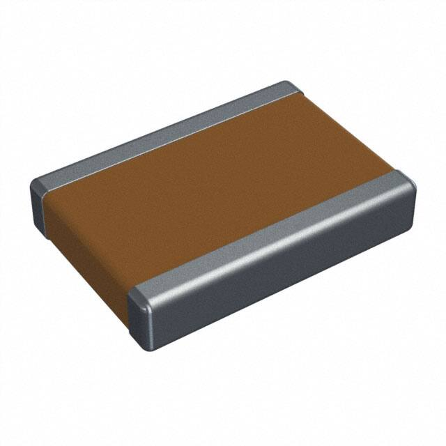

    贴片电容(MLCC) 1825 3.3nF ±1% 50V C0G(NP0)
18255A332FAT2A 数据手册
C0G (NP0) Dielectric General Specifications C0G (NP0) is the most popular formulation of the “temperature-compensating,” EIA Class I ceramic materials. Modern C0G (NP0) formulations contain neodymium, samarium and other rare earth oxides. C0G (NP0) ceramics offer one of the most stable capacitor dielectrics available. Capacitance change with temperature is 0 ±30ppm/°C which is less than ±0.3% C from -55°C to +125°C. Capacitance drift or hysteresis for C0G (NP0) ceramics is negligible at less than ±0.05% versus up to ±2% for films. Typical capacitance change with life is less than ±0.1% for C0G (NP0), one-fifth that shown by most other dielectrics. C0G (NP0) formulations show no aging characteristics. PART NUMBER (see page 4 for complete part number explanation) 0805 5 A 101 J A T 2 A Size (L” x W”) Voltage 6.3V = 6 10V = Z 16V = Y 25V = 3 50V = 5 100V = 1 200V = 2 250V = V 500V = 7 Dielectric C0G (NP0) = A Capacitance Code (In pF) 2 Sig. Digits + Number of Zeros Capacitance Tolerance B = ±.10 pF (
