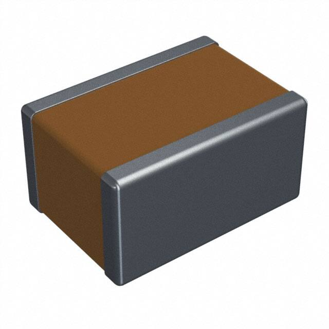

High Voltage MLC Chips FLEXITERM® - 600V to 5000V Applications High value, low leakage and small size are difficult parameters to obtain in capacitors for high voltage systems. AVX special high voltage MLC chips capacitors meet these performance characteristics and are designed for applications such as snubbers in high frequency power converters, resonators in SMPS, and high voltage coupling/DC blocking. These high voltage chip designs exhibit low ESRs at high frequencies. To make high voltage chips, larger physical sizes than are normally encountered are necessary. These larger sizes require that special precautions be taken in applying these chips in surface mount assemblies. In response to this, and to follow from the success of the FLEXITERM® range of low voltage parts, AVX is delighted to offer a FLEXITERM® high voltage range of capacitors, FLEXITERM®. The FLEXITERM® layer is designed to enhance the mechanical flexure and temperature cycling performance of a standard ceramic capacitor, giving customers a solution where board flexure or temperature cycle damage are concerns. HOW TO ORDER 1808 A C 272 K A Z 2 AVX Style 0805 1206 1210 1808 1812 1825 2220 2225 *** Voltage 600V/630V = C 1000V = A 1500V = S 2000V = G 2500V = W 3000V = H 4000V = J 5000V = K Temperature Coefficient C0G = A X7R = C Capacitance Code (2 significant digits + no. of zeros) Examples: 10 pF = 100 100 pF = 101 1,000 pF = 102 22,000 pF = 223 220,000 pF = 224 1 μF =105 Capacitance Tolerance C0G: J = ±5% K = ±10% M = ±20% X7R: K = ±10% M = ±20% Z = +80%, -20% Test Level Termination* Z = FLEXITERM® 100% Tin (RoHS Compliant) A Packaging 2 = 7" Reel 4 = 13" Reel Special Code A = Standard Notes: Capacitors with X7R dielectrics are not intended for applications across AC supply mains or AC line filtering with polarity reversal. Contact plant for recommendations. Contact factory for availability of Termination and Tolerance options for Specific Part Numbers. *** AVX offers nonstandard chip sizes. Contact factory for details. DIMENSIONS SIZE millimeters (inches) 0805 1206 1210* 1808* 1812* 1825* 2220* 2225* (L) Length 2.10 ± 0.20 (0.083 ± 0.008) 3.30 ± 0.30 (0.130 ± 0.012) 3.30 ± 0.40 (0.130 ± 0.016) 4.60 ± 0.50 (0.181 ± 0.020) 4.60 ± 0.50 (0.181 ± 0.020) 4.60 ± 0.50 (0.181 ± 0.020) 5.70 ± 0.50 (0.224 ± 0.020) 5.70 ± 0.50 (0.224 ± 0.020) (W) Width 1.25 ± 0.20 (0.049 ±0.008) 1.60 +0.30 -0.10 (0.063 +0.012 -0.004 ) 1.80 (0.071) 2.50 ± 0.30 (0.098 ± 0.012) 2.00 ± 0.20 (0.079 ± 0.008) 3.20 ± 0.30 (0.126 ± 0.012) 6.30 ± 0.40 (0.248 ± 0.016) 5.00 ± 0.40 (0.197 ± 0.016) 6.30 ± 0.40 (0.248 ± 0.016) 2.80 (0.110) 2.20 (0.087) 2.80 (0.110) 3.40 (0.134) 3.40 (0.134) 3.40 (0.134) 0.60 ± 0.20 (0.024 ± 0.008) 0.75 ± 0.35 (0.030 ± 0.014) 0.75 ± 0.35 (0.030 ± 0.014) 0.75 ± 0.35 (0.030 ± 0.014) 0.75 ± 0.35 (0.030 ± 0.014) 0.85 ± 0.35 (0.033 ± 0.014) 0.85 ± 0.35 (0.033 ± 0.014) (T) Thickness Max. (t) terminal 1.35 (0.053) min. 0.50 ± 0.20 max. (0.020 ± 0.008) *Reflow Soldering Only Performance of SMPS capacitors can be simulated by downloading SpiCalci software program - http://www.avx.com/SpiApps/default.asp#spicalci Custom values, ratings and configurations are also available. The Important Information/Disclaimer is incorporated in the catalog where these specifications came from or available online at www.avx.com/disclaimer/ by reference and should be reviewed in full before placing any order. 011916 101 High Voltage MLC Chips FLEXITERM® - 600V to 5000V Applications NP0 (C0G) Dielectric Performance Characteristics Capacitance Range Capacitance Tolerances Dissipation Factor Operating Temperature Range Temperature Characteristic Voltage Ratings Insulation Resistance (+25°C, at 500 VDC) Insulation Resistance (+125°C, at 500 VDC) Dielectric Strength 10 pF to 0.100 μF (+25°C, 1.0 ±0.2 Vrms, 1kHz) ±5%, ±10%, ±20% 0.1% max. (+25°C, 1.0 ±0.2 Vrms, 1kHz) -55°C to +125°C 0 ±30 ppm/°C (0 VDC) 600, 630, 1000, 1500, 2000, 2500, 3000, 4000 & 5000 VDC (+125°C) 100K MΩ min. or 1000 MΩ - μF min., whichever is less 10K MΩ min. or 100 MΩ - μF min., whichever is less Minimum 120% rated voltage for 5 seconds at 50 mA max. current NP0 (C0G) CAPACITANCE RANGE PREFERRED SIZES ARE SHADED Case Size Soldering 0805 Reflow/Wave mm 2.10 ± 0.20 (in.) (0.083 ± 0.008) mm 1.25 ± 0.20 (in.) (0.049 ± 0.008) mm 1.35 (T) Thickness (in.) (0.053) mm 0.50 ± 0.20 (t) Terminal max (0.020 ± 0.008) Voltage (V) 600 630 1000 Cap (pF) 1.5 1R5 A A 1.8 1R8 A A 2.2 2R2 A A 2.7 2R7 A A 3.3 3R3 A A 3.9 3R9 A A 4.7 4R7 A A 5.6 5R6 A A 6.8 6R8 A A 8.2 8R2 A A 10 100 A A A 12 120 A A A 15 150 A A A 18 180 A A A 22 220 A A A 27 270 A A A 33 330 A A A 39 390 A A A 47 470 A A A 56 560 A A A 68 680 A A A 82 820 X X X 100 101 X X X 120 121 C C C 150 151 C C C 180 181 C C C 220 221 C C 270 271 C C 330 331 C C 390 391 C C 470 471 C C 560 561 C C 680 681 C C 750 751 C C 820 821 C C 1000 102 1200 122 1500 152 1800 182 2200 222 2700 272 3300 332 3900 392 4700 472 5600 562 6800 682 8200 822 Cap (μF) 0.010 103 (L) Length W) Width 3.30 ± 0.30 (0.130 ± 0.012) 1.60 ± 0.30/-0.10 (0.063 ± 0.012/-0.004) 1.80 (0.071) 0.60 ± 0.20 (0.024 ± 0.008) 600 630 1000 1500 2000 X X X X X X X X X X X X X X X X X X X X X X X X X X X X X X X X X X X X X X X X X X X X X X X X X X X X X X X X X X X X X X X X X X X X X X X X X X X X X X X X X X X D D X X X D D X X M D D X X M C C X X M C C X X C C C X X C C C X X C E E X X C E E X X E E E X X E E E C C E E E C C E E E E C C E E C C E E E C C E C C E E E E E E E E E E E E E E E E E E E E E E 1210 Reflow Only 600 C C C C C C C C C C C C C C C C C C C C C C C C C C C C C E E E E E E 3.30 ± 0.40 (0.130 ± 0.016) 2.50 ± 0.30 (0.098 ± 0.012) 2.80 (0.110) 0.75 ± 0.35 (0.030 ± 0.014) 630 1000 1500 2000 C C C C C C C C C C C C C C C C C C C C C C C C C C C C C E E E E E E D D D D D D D D D D D D C C C E E E E E E E E E E E E G G D D D D D D D D D C C C C C E E E E E E E E F G G D D D D D D D D D C C C C C E E E E E E E E F G G 1808 Reflow Only 600 C C C C C C C C C C C C C C C C C C C C C C C C C C E E E E E E E E E F 630 C C C C C C C C C C C C C C C C C C C C C C C C C C E E E E E E E E E F 4.60 ± 0.50 (0.181 ± 0.020) 2.00 ± 0.20 (0.079 ± 0.008) 2.20 (0.087) 0.75 ± 0.35 (0.030 ± 0.014) 1000 1500 2000 2500 C C C C C C C C C C C C C C C C C C C C C C C C C F F F F F F F F F F F C C C C C C C C C C C C C C C C C C C C C F F F F F F F F F F E E E C C C C C C C C C C C C C C C C C C C C C F F F F F F F F F F E E E C C C C C C C C C C C C C C C C C C C F F F F F F F F F 1812 Reflow Only 3000 4000 C C C C C C C C C C C C C C C C C C C F F F F F F F F F C C C C C C C C C 600 630 C C C C C C C C C C C C C C C C C C C C C C C C C C C C C C C C C C C C E E C C C C C C C C C C C C C C C C C C C C C C C C C C C C C C C C C C C C E E 0.012 123 F F 0.015 153 G G 0.018 183 G G 0.022 223 0.033 333 0.047 473 0.056 563 0.068 683 600 630 0.100 104 Voltage (V) 600 Case Size 102 1206 Reflow/Wave 630 0805 1000 600 630 1000 1500 2000 1206 600 630 1000 1500 2000 1210 600 630 1000 1500 2000 2500 3000 4000 1808 4.60 ± 0.50 (0.181 ± 0.020) 3.20 ± 0.30 (0.126 ± 0.012) 2.80 (0.110) 0.75 ± 0.35 (0.030 ± 0.014) 1000 1500 2000 2500 3000 4000 C C C C C C C C C C C C C C C C C C C C F F F F F F F F F E E F F G C C C C C C C C C C C C C C C C C C F F F F F F F F E F F G G C C C C C C C C C C C C C C C F F F F F F F G G G G C C C C C C C C C C C C C C C F F F F F F F G G G G E E E E E E E E E F F F F G G 1000 1500 2000 2500 3000 4000 The Important Information/Disclaimer is incorporated in the catalog where these specifications came from or available online at www.avx.com/disclaimer/ by reference and should be reviewed in full before placing any order. 011916 C C C C C C C C C C C C C C C C C C F F F F F F F F E F F G G 1812 High Voltage MLC Chips FLEXITERM® - 600V to 5000V Applications NP0 (C0G) CAPACITANCE RANGE PREFERRED SIZES ARE SHADED Case Size Soldering (L) Length W) Width (T) Thickness (t) Terminal Voltage (V) 1.5 1.8 2.2 2.7 3.3 3.9 4.7 5.6 6.8 8.2 10 12 15 18 22 27 33 39 47 56 68 82 100 120 150 180 220 270 330 390 470 560 680 750 820 1000 1200 1500 1800 2200 2700 3300 3900 4700 5600 6800 8200 Cap (μF) 0.010 0.012 0.015 0.018 0.022 0.033 0.047 0.056 0.068 0.100 Voltage (V) Case Size mm (in.) mm (in.) mm (in.) mm max Cap (pF) 1R5 1R8 2R2 2R7 3R3 3R9 4R7 5R6 6R8 8R2 100 120 150 180 220 270 330 390 470 560 680 820 101 121 151 181 221 271 331 391 471 561 681 751 821 102 122 152 182 222 272 332 392 472 562 682 822 103 123 153 183 223 333 473 563 683 104 1825 2220 2225 Reflow Only Reflow Only Reflow Only 4.60 ± 0.50 5.70 ± 0.50 5.72 ± 0.25 (0.181 ± 0.020) (0.224 ± 0.020) (0.225 ± 0.010) 6.30 ± 0.40 5.00 ± 0.40 6.35 ± 0.25 (0.248 ± 0.016) (0.197 ± 0.016) (0.250 ± 0.010) 3.40 3.40 3.40 (0.134) (0.134) (0.134) 0.75 ± 0.35 0.85 ± 0.35 0.85 ± 0.35 (0.030 ± 0.014) (0.033 ± 0.014) 600 630 1000 1500 2000 2500 3000 4000 600 630 1000 1500 2000 2500 3000 4000 5000 600 630 1000 1500 2000 2500 3000 4000 5000 E E E E E E E E E E E E E E E E E E E E E E E E E E E E E E E E E E F F G E E E E E E E E E E E E E E E E E E E E E E E E E E E E E E E E E E F F G E E E E E E E E E E E E E E E E E E E E E E E E E E E E E E E E E E F F G E E E E E E E E E E E E E E E E E E E E E E E E E E E F F G G G G G G E E E E E E E F F E E E E E E E F F E E E E E E E F F E E E E E E E F F E E E E E E E F F E E E E E E E F F E E E E E E E F F E E E E E E E F F E E E E E E E F G E E E E E E E F G E E E E E E E F G E E E E E E E F G E E E E E E E G G E E E E E E E G G E E E E E E E G G E E E E E E E G G E E E E E E E G G E E E E E E E G G E E E E E E E G E E E E E E E G E E E E E E E G E E E E E E E G E E E E E E E E E E E E E E E E E E E F E E E E E E E E E E E E E F F E E E E E F F E E E E E G G E E E E E E E E F F E E E F F E E E G G F F F G G F F F G G F F F G G G G G G G G G G G G G G G G G G G G G G G G G G G G G G G G G G 600 630 1000 1500 2000 2500 3000 4000 600 630 1000 1500 2000 2500 3000 4000 5000 600 630 1000 1500 2000 2500 3000 4000 5000 1825 2220 2225 F 2.210 E E E E E E E E E E E E E E E E E E E E E E E E E E E F F G G G G G G G 2.794 E E E E E E E E E E E E E E E E E E E E E E F F F F G G G Letter Max. A 0.813 C 1.448 E 1.803 X 0.940 Thickness (0.032) (0.057) (0.071) (0.087) (0.110) (0.037) E E E E E E E E E E E E E E E E E E E E E E F F F F G G G E E E E E E E E F F F F F F F F F F F E E E E E E E E E E E E E E E E E E E E E E E E E E E E E E E E E E F F G E E E E E E E E E E E E E E E E E E E E E E E E E E E E E E E E E E F F G E E E E E E E E E E E E E E E E E E E E E E E E E E E E E E E E E E F F G E E E E E E E E E E E E E E E E E E E E E E E E E E E F F G G G G G E E E E E E E E E E E E E E E E E E E E E E E E E E E F F G G G G G E E E E E E E E E E E E E E E E E E E E E E F F F F G G G E E E E E E E E E E E E E E E E E E E E E E F F F F G G G E E E E E E E E E E E E E E E F F E E E E E E E E E E E E E E E F F NOTE: Contact factory for non-specified capacitance The Important Information/Disclaimer is incorporated in the catalog where these specifications came from or available online at www.avx.com/disclaimer/ by reference and should be reviewed in full before placing any order. 043019 103 High Voltage MLC Chips FLEXITERM® - 600V to 5000V Applications X7R Dielectric Performance Characteristics Capacitance Range Capacitance Tolerances Dissipation Factor Operating Temperature Range Temperature Characteristic Voltage Ratings Insulation Resistance (+25°C, at 500 VDC) Insulation Resistance (+125°C, at 500 VDC) Dielectric Strength 10 pF to 0.82 μF (25°C, 1.0 ±0.2 Vrms at 1kHz) ±10%; ±20%; +80%, -20% 2.5% max. (+25°C, 1.0 ±0.2 Vrms, 1kHz) -55°C to +125°C ±15% (0 VDC) 600, 630, 1000, 1500, 2000, 2500, 3000, 4000 & 5000 VDC (+125°C) 100K MΩ min. or 1000 MΩ - μF min., whichever is less 10K MΩ min. or 100 MΩ - μF min., whichever is less Minimum 120% rated voltage for 5 seconds at 50 mA max. current X7R CAPACITANCE RANGE PREFERRED SIZES ARE SHADED Case Size 0805 Soldering Reflow/Wave mm 2.10 0.20 (L) Length (in.) (0.083 ± 0.008) mm 1.25 0.20 W) Width (in.) (0.049 ± 0.008) mm 1.35 (T) Thickness (in.) (0.053) mm 0.50 ± 0.20 (t) Terminal max (0.020 ± 0.008) Voltage (V) 600 630 1000 Cap (pF) 100 101 X X C 1210 3.30 ± 0.30 (0.130 ± 0.012) 1.60 +0.30/-0.10 (0.063 +0.012/-0.004) 1.80 (0.071) 0.60 ± 0.20 (0.024 ± 0.008) 600 630 1000 1500 2000 C C E E E 1808 Reflow Only 600 E 3.30 0.40 (0.130 0.016) 2.50 0.30 (0.098 0.012) 2.80 (0.110) 0.75 0.35 (0.030 ± 0.014) 630 1000 1500 2000 E E E E 1812 Reflow Only 600 630 4.60 ± 0.50 (0.181 ± 0.020) 2.00 0.20 (0.079 ± 0.008) 2.20 (0.087) 0.75 ± 0.35 (0.030 ± 0.014) 1000 1500 2000 2500 3000 4000 Reflow Only 600 630 4.60 ± 0.50 (0.181 ± 0.020) 3.20 ± 0.30 (0.126 ± 0.012) 2.80 (0.110) 0.75 ± 0.35 (0.030 ± 0.014) 1000 1500 2000 2500 3000 4000 120 121 X X C C C E E E E E E E E 150 151 X X C C C E E E E E E E E 180 181 X X C C C E E E E E E E E 220 221 X X C C C E E E E E E E E 270 271 X X C C C E E E E E E E E E E E E E 330 331 X X C C C E E E E E E E E E E E E E E F E E E E E 390 391 X X C C C E E E E E E E E E E E E E E F E E E E E 470 471 X X C C C E E E E E E E E E E E E E E F E E E E E E E 560 561 X X C C C E E E E E E E E E E E E E F F E E E E E E E 680 681 X X C C C E E E E E E E E E E E E E F F E E E E E F F 750 751 X X C C C E E E E E E E E E E E E E F F E E E E E F F 820 821 X X C C C E E E E E E E E E E E E E F F E E E E E F F 1000 102 X X C C C E E E E E E E E E E E E E F F E E E E E F F 1200 122 X X C C C E E E E E E E E E E E E E F F F F F F F F F 1500 152 X X C C C E E E E E E E E E E E E E F F F F F F F G G 1800 182 X X C C E E E E E E E E E E E E E F F F F F F F G G 2200 222 X X C C E E E E E E F E E E E F F F F F F F F G G 2700 272 X X C C E E E E E F E E E E F F F F F F F G G 3300 332 X X C C E E E E F E E E E F F F F F F F G G 3900 392 X X C C E E E E G E E E F F F F F F G G 4700 472 X X C C E E E E G E E E F F F F F F G G 5600 562 X X C C E E E E G E E E F F F F G G 6800 682 X X C C E E E E E E E F F F F G G 8200 822 X X C C E E E E E E E F F E G G Cap (μF) 0.010 103 C C C C E E E E E E E F F F G G 0.015 153 C C E E E E E E F F F F F F G F 0.018 183 C C E E E E E F F 0.022 223 C C E E E E E F F F F G F F G 0.027 273 E E E E F F F F G 0.033 333 E E E E F F F F G 0.039 393 E E F F F F G 0.047 473 E E F F F F G 0.056 563 F F F F F F 0.068 683 F F F F F F 0.082 823 F F F F 0.100 104 F F F F 0.150 154 G G 0.220 224 G G 0.270 274 0.330 334 0.390 394 0.470 474 0.560 564 0.680 684 0.820 824 600 630 1.000 105 Voltage (V) 600 Case Size 104 1206 Reflow/Wave 630 0805 1000 600 630 1000 1500 2000 1206 600 630 1000 1500 2000 1210 600 630 1000 1500 2000 2500 3000 4000 1808 1000 1500 2000 2500 3000 4000 The Important Information/Disclaimer is incorporated in the catalog where these specifications came from or available online at www.avx.com/disclaimer/ by reference and should be reviewed in full before placing any order. 091620 1812 High Voltage MLC Chips FLEXITERM® - 600V to 5000V Applications X7R CAPACITANCE RANGE PREFERRED SIZES ARE SHADED Case Size Soldering mm (L) Length (in.) mm W) Width (in.) (T) mm Thickness (in.) mm (t) Terminal max Voltage (V) 600 Cap (pF) 100 101 120 121 150 151 180 181 220 221 270 271 330 331 390 391 470 471 560 561 680 681 750 751 820 821 1825 2220 Reflow Only 4.60 0.50 (0.181 0.020) 6.30 0.40 (0.248 ± 0.016) 3.40 (0.134) 0.75 0.35 2225 Reflow Only 5.70 0.50 (0.224 0.020) 5.00 0.40 (0.197 0.016) 3.40 (0.134) 0.85 0.35 (0.030 ± 0.014) (0.033 ± 0.014) 630 1000 1500 2000 2500 3000 4000 600 3640 Reflow Only 5.72 ± 0.25 (0.225 ± 0.010) 6.35 ± 0.25 (0.250 ± 0.010) 2.54 (0.100) 0.85 ± 0.35 (0.033 ± 0.014) 630 1000 1500 2000 2500 3000 4000 5000 600 630 1000 1500 2000 2500 3000 4000 5000 600 630 Reflow Only 9.14 ± 0.25 (0.360 ± 0.010) 5.72 ± 0.25 (0.225 ± 0.010) 2.54 (0.100) 0.76 (0.030) 1.52 (0.062) 1000 1500 2000 2500 3000 4000 5000 1000 102 F F F F F F F F F F F F F G F F F F F F F G G G G G G G G G 1200 122 F F F F F F F F F F F F F G F F F F F F F G G G G G G G G G 1500 152 F F F F F F F F F F F F F G F F F F F F F G G G G G G G G G 1800 182 F F F F F F F F F F F F F G F F F F F F F G G G G G G G G G 2200 222 F F F F F F F F F F F F F G F F F F F F F G G G G G G G G G 2700 272 F F F F F F F F F F F F F G F F F F F F F G G G G G G G G G G 3300 332 F F F F F F F F F F F F F G F F F F F F F G G G G G G G G 3900 392 F F F F F F F F F F F F F G F F F F F F F G G G G G G G G 4700 472 F F F F F F F F F F F F F G F F F F F F F G G G G G G G G 5600 562 F F F F F F F F F F F F F G F F F F F F F G G G G G G G G G 6800 682 F F F G G G G F F F F F G G F F F F F G G G G G G G G G 8200 822 F F F G G G G F F F G G G G F F F F F G G G G G G G G G G G Cap (μF) 0.010 103 F F F G G G 0.015 153 F F F G G G F F F G G G F F F F F G G G G G G G G G F F F G G G F F F G G G G G G G G G G 0.018 183 F F F G G G F F F G G G F F F G G G G G G G G G 0.022 223 F F F G G G F F F G G F F F G G G G G G G G G 0.027 273 F F F 0.033 333 F F F G F F F G G F F F G G G G G G G G F F F G F F F G G G G G G 0.039 393 F F 0.047 473 F F F G F F F G F F F G G G G G F P F F F G F F F G G G G 0.056 563 F G F F G F F F G F F F G G G G 0.068 683 G F F G F F G F F F G G G G 0.082 G 823 F F G F F G F F G G G 0.100 104 F F G F F G F F G G G 0.150 154 F F F F G F F G G G 0.220 224 F F F F G F F G G 0.270 274 F F F F F F G G 0.330 334 F F F F F F G G 0.390 394 F F F F F F G G 0.470 474 F F F F F F G G 0.560 564 G G G G F F G G 0.680 684 G G G G 0.820 824 G G G G 1.000 105 600 630 Voltage (V) Case Size 600 G 630 1000 1500 2000 2500 3000 4000 600 1825 G G 630 1000 1500 2000 2500 3000 4000 5000 600 2220 Letter A C E F G P X Max. Thickness 0.813 (0.032) 1.448 (0.057) 1.8034 (0.071) 2.2098 (0.087) 2.794 (0.110) 3.048 (0.120) 0.940 (0.037) G 630 1000 1500 2000 2500 3000 4000 5000 2225 1000 1500 2000 2500 3000 4000 5000 3640 NOTE: Contact factory for non-specified capacitance values The Important Information/Disclaimer is incorporated in the catalog where these specifications came from or available online at www.avx.com/disclaimer/ by reference and should be reviewed in full before placing any order. 051520 105
1825CA103JAZ2A
物料型号:FLEXITERM® 高电压MLC芯片,由AVAX公司生产,属于京瓷集团。
器件简介:这些高电压多层陶瓷(MLC)芯片电容器具有高值、低漏电和小型化的特点,适用于高频电源转换器中的缓冲器、开关电源(SMPS)中的谐振器,以及高压耦合/直流阻断等应用。这些高电压芯片设计在高频下展现出低等效串联电阻(ESR)。
引脚分配:文档中未明确提供引脚分配信息,但提到了这些电容器设计用于表面贴装组装,并需要特别注意以适应其较大的物理尺寸。
参数特性: - 电容范围:从10pF到0.100F - 电容公差:±5%, ±10%, ±20% - 耗散因数:最大0.1%(在+25°C, 1.0 ± 0.2 Vrms, 1kHz条件下) - 工作温度范围:-55°C至+125°C - 温度特性:0至+30 ppm/°C(0VDC) - 电压等级:600V至5000V - 绝缘电阻:在+25°C, 500VDC下最小100K MQ或1000MQ-uF,取较小值;在+125°C, 500VDC下最小10K MQ或100 MQ-uF,取较小值 - 介质强度:至少为额定电压的120%,持续5秒,最大电流50mA
功能详解:FLEXITERM®层设计用于提高标准陶瓷电容器的机械柔性和温度循环性能,为客户提供在板弯曲或温度循环损坏方面的解决方案。
应用信息:适用于高频电源转换器的缓冲器、开关电源的谐振器,以及高压耦合/直流阻断。
封装信息:提供了多种尺寸的封装,包括0805、1206、1210、1808、1812、1825、2220和2225等,每种尺寸都有详细的尺寸和公差信息。
