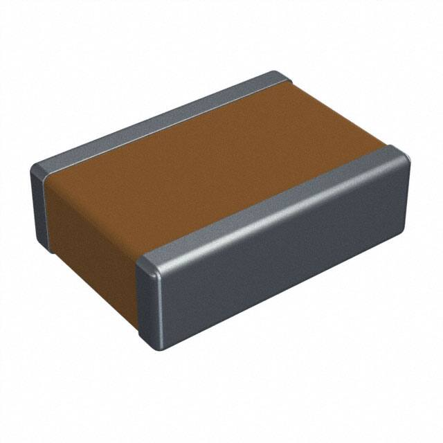

    贴片电容(MLCC) 1825 1µF ±10% 250V X7R
1825PC105KAZ2A 数据手册
Tip & Ring Multilayer Ceramic Chip Capacitors AVX “Tip & Ring” or “ring detector” Multilayer Ceramic Chip Capacitors are designed as a standard telecom filter to block -48 Volts DC telephone line voltage and pass subscriber’s AC signal pulse (16 to 25Hz, 70 to 90Vrms). The typical ringing signal is seen on figure on page 132. The ringer capacitors replace large leaded film capacitors and are ideal for telecom/modem applications. Using AVX “Tip & Ring” capacitors not only saves valuable real estate on the board and reduces the weight of overall product, but also features standard surface mounting capabilities, so critical to new and compact designs. The AVX “Tip & Ring” capacitors are offered in standard EIA sizes and standard values. They offer excellent high frequency performance, low ESR and improved temperature performance over film capacitors. HOW TO ORDER A 1812 P C 104 K AVX Style 0805 1206 1210 1808 1812 1825 2220 2225 Voltage 250 VDC Telco Rating Temperature Coefficient X7R Capacitance Code (2 significant digits + no. of zeros) Examples: 1,000 pF = 102 22,000 pF = 223 220,000 pF = 224 1 µF = 105 Capacitance Tolerance K = ±10% M = ±20% T 1 A Termination Test Packaging T = Plated Level 1 or 2 = 7" Reel Ni and Sn A = Standard 3 or 4 = 13" Reel (RoHS Compliant) 9 = Bulk Z = FLEXITERM® 100% Tin (RoHS Compliant) Special Code A = Standard Contact factory for availability of Termination and Tolerance options for Specific Part Numbers. W L T t DIMENSIONS Style 0805 millimeters (inches) 1206 1210* 1808* 1812* 1825* 2220* 2225* (L) Length 2.01 ± 0.20 3.20 ± 0.20 3.2 ± 0.20 4.57 ± 0.25 4.50 ± 0.30 4.50 ± 0.30 5.60 ± 0.30 5.60 ± 0.25 (0.079 ± 0.008) (0.126 ± 0.008) (0.126 ± 0.008) (0.180 ± 0.010) (0.177 ± 0.012) (0.177 ± 0.012) (0.220 ± 0.012) (0.220 ± 0.010) (W)Width 1.25 ± 0.20 1.60 ± 0.20 2.50 ± 0.20 2.03 ± 0.25 3.2 ± 0.20 6.34 ± 0.30 5.10 ± 0.40 6.35 ± 0.25 (0.049 ± 0.008) (0.063 ± 0.008) (0.098 ± 0.008) (0.080 ± 0.010) (0.126 ± 0.008) (0.252 ± 0.012) (0.200 ± 0.016) (0.250 ± 0.010) (T) Thickness (t) terminal 1.30 max. (0.051 max.) 1.50 max. (0.059 max.) 1.78 max. (0.070 max.) 1.78 max. (0.070 max.) 2.00 max. (0.080 max.) 2.00max. (0.080 max.) 2.00 max. (0.080 max.) 2.00 max. (0.080 max.) 0.50 ± 0.25 0.50 ± 0.25 0.50 ± 0.25 0.63 ± 0.38 0.63 ± 0.38 0.63 ± 0.38 0.63 ± 0.38 0.63 ± 0.38 (0.020 ± 0.010) (0.020 ± 0.010) (0.020 ± 0.010) (0.025 ± 0.015) (0.025 ± 0.015) (0.025 ± 0.015) (0.025 ± 0.015) (0.025 ± 0.015) *Reflow Soldering Only 062216 131 Tip & Ring Multilayer Ceramic Chip Capacitors CAPACITANCE RANGE (µF) Size 0805 1206 1210 1808 1812 1825 2220 2225 min. max. 0.0010 0.027 0.0010 0.082 0.0010 0.22 0.010 0.27 0.10 0.47 0.33 1.0 0.47 1.0 0.47 1.2 “TIP & RING” GRAPH 250V Tip & Ring 0 -48V -250V 200ms/div -400ms 1.6s PERFORMANCE CHARACTERISTICS Capacitance Range 1000 pF to 1.2 µF Capacitance Tolerances ±10%, ±20% Dissipation Factor 2.5% max. (25°C, 1.0 ±0.2 Vrms at 1kHz) Operating Temperature Range Temperature Characteristic (25°C, 1.0 ±0.2 Vrms at 1kHz) -55°C to +125°C X7R ±15% (0 VDC) Voltage Rating 250 VDC Telco rating Insulation Resistance 1000 megohm-microfarad min. Dielectric Strength Minimum 200% rated voltage for 5 seconds at 50 mA max. current 132 062216
1825PC105KAZ2A
- 物料型号:文档中列出了多种型号,包括0805、1206、1210、1808、1812、1825、2220和2225。 - 器件简介:这些电容器设计为标准电信滤波器,用于阻挡-48V直流电话线路电压,并通过用户的交流信号脉冲(16至25Hz,70至90Vrms)。 - 引脚分配:文档中没有明确提到引脚分配,但通常这类电容器是无引脚的表面贴装元件。 - 参数特性:包括电容范围(1000pF至1.2F)、电容公差(±10%,+20%)、耗散因子(最大2.5%)、工作温度范围(-55°C至+125°C)、温度特性(X7R+15%(0VDC))、电压等级(250VDC电信等级)、绝缘电阻(最小1000兆欧-微法拉)和介质强度(至少是额定电压的200%,持续5秒,最大电流50毫安)。 - 功能详解:电容器用于电信/调制解调器应用,可以节省电路板上的宝贵空间,减少产品整体重量,并具有标准表面贴装能力。 - 应用信息:适用于电信和调制解调器应用。 - 封装信息:提供了EIA标准尺寸和标准值,封装选项包括7英寸和13英寸的卷轴,以及特殊代码,如标准、电压、电信等级、RoHS合规性等。
