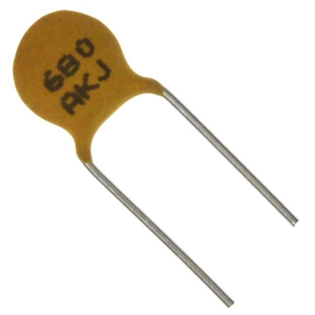

    0.047 µF -20%,+80% 25V 陶瓷电容器 Y5U(E) 径向,圆片式
5YF473ZADAA 数据手册
Disc Ceramic Capacitors General Specifications - Class III Semi Conducting DIELECTRIC - CLASS III A thin dielectric layer is grown on a disc of conductive ceramic. Very large capacitances can be obtained due to reduced thickness of this barrier layer and its inherently high dielectric constant. Due to its small dimensions, they are a less expensive replacement of multilayer ceramic or polyester capacitors. An equivalent circuit is shown below: Meets IEC 324 (1970). HOW TO ORDER 5Z H 104 Z A C A A Product Code Voltage Capacitance Tolerance Lead Forming Capacitor Diameter Finishing Packaging PERFORMANCE CHARACTERISTICS CLASS III Measured at 1.0 kHz / 0.1 Vrms / 25ºC Dissipation Factor (%) CR ≤ 22 nF → Y5V, Y5U ≤ 7.5% CR > 22 nF → Y5V, Y5P ≤ 5.0% Tolerance Y5P → ±20% / -20 +50% Y5U → ±20% / -20 +50% Y5V → -20% +50% / -20 +80% Insulation Resistance (IR) Dielectric Strength NOTE: Charging current limited to 50 mA Y5P ≥12 MΩ Y5U 4.7 nF...100 nF → ≥ 10 MΩ 200 nF → ≥ 1 MΩ Y5V ≥ 100 MΩ Between leads Vt = 1.25 VR Body insulation VR = 25V Vt = 100V (DC) VR = 50V Vt = 150V (DC) Operating Temperature Range (ºC) -30... +85ºC Climate Category 30 / 85 / 21 15 Disc Ceramic Capacitors General Specifications - Class III Semi Conducting TEMPERATURE COEFFICIENT – TYPICAL CURVES PHENOLIC COATED – CAPACITANCE VS. DISC DIAMETER Class III Temp. Coefficient Digits 1,2,3 of P.N. Rated Voltage (VR) CR (pF) 4,700 10,000 22,000 33,000 47,000 50,000 68,000 100,000 200,000 ∆ C/C (max.) ±12% Range -30... +85ºC ∆ C/C (max.) +30 -65% Y5P Range -30... +85ºC Y5U ∆ C/C (max.) +30 -65% Range -30... +85ºC Y5V 5WF 5WH 5YF 5YH 5ZH 25 VDC 50 VDC 25 VDC 50 VDC 50 VDC 5.0 (0.197) 6.0 (0.236) 7.0 (0.276) 8.0 (0.315) 5.0 (0.197) 6.0 (0.236) 8.0 (0.315) 5.0 (0.197) 9.0 (0.354) 9.0 (0.354) 11.0 (0.433) 6.0 (0.236) 7.0 (0.276) 11.0 (0.433) 8.0 (0.315) Note: Damp Heat Steady State: 90... 95% R.H. 40ºC / 21 days. No voltage to be applied. 16 millimeters (inches) 5.0 (0.197) 6.0 (0.236) 7.0 (0.276) 5.0 (0.197) 8.0 (0.315) 9.0 (0.354) 6.0 (0.236) 10.0 (0.394)
