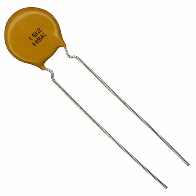

    贴片电容(MLCC) 径向 2.2nF ±20% 400V
61V222MWGCL 数据手册
Disc Ceramic Capacitors Safety Ceramic Capacitors DEFINITIONS (IEC 384-14 1993) ANTENNA: the capacitors are used to decouple the antenna leads of video and audio equipment, whose failure may lead to danger of electrical shock. TPC Safety Capacitors: 61V (GZO): meets subclasses X1, Y1 Test voltage 4000 VAC 62O (GKO): meets subclasses X1, Y2 Test voltage 2500 VAC 65N (GAY): meets subclasses X2, Y3 Test voltage 1800 VAC X FUNCTION: applications where the capacitor failure does not lead to danger of electrical shock. There are three subclasses related to the peak voltage of the impulses superimposed to the mains voltage: Subclass X1: impulses up to 4000V Subclass X2: impulses up to 2500V Subclass X3: impulses up to 1200V Y FUNCTION: applications where the capacitor failure may lead to danger of electrical shock. There are four subclasses related to the peak voltage of the impulses applied before the life test: Subclass Y1: impulses up to 8000V Subclass Y2: impulses up to 5000V Subclass Y3: rated 250Vac without impulses Subclass Y4: impulses up to 2500V HOW TO ORDER 61 V 101 K B D C A Product Code Voltage Capacitance Tolerance Lead Forming Capacitor Diameter Finishing Packaging PERFORMANCE CHARACTERISTICS Measured at 61V 62O 65N 1.0 kHz / 0.3 Vrms / 25ºC 1.0 kHz / 0.3 Vrms / 25ºC 1.0 kHz / 0.3 Vrms / 25ºC ±20% / -20 +50% ±20% / -20 +50% ±20% / -20 +50% 1.5% 1.5% 1.5% Capacitance Tolerance D.F max. @ 25ºC Insulation Resistance (IR) ≥ 10 GΩ ≥ 10 GΩ ≥ 10 GΩ Test Voltage Between Leads* 4.000 VAC 2.500 VAC 1.800 VAC Test Voltage Leads to Body 4.000 VAC 2.500 VAC 1.800 VAC -40 +125 -40 +125 -40 +125 Operating Temperature Range (ºC) * Main reference voltage CERTIFICATION BODY APPROVALS Standard UL UL 1414 CAS CAN/CSA - C22.2 No. 1-94 VDE DIN BDE 0560 Part 2 DIN EN 132400: 1995 IEC 384-14: 1993 IMQ EN 132400: 1994 IEC 384-14: 1993 Certificate Number 61V Rated Voltage Climatic Category Certificate Number 62O Rated Voltage Climatic Category Certificate Number 65N Rated Voltage Climatic Category E 147842 (N) 250 VAC E 147842 (N) 250 VAC E 147842 (N) 250 VAC – LR 100430-2 250 VAC LR 100430-1 250 VAC – – – – – 76830 76804 400 VAC 25/85/21 – – – 94612 94610 94634 X1: 400 VAC Y1: 250 VAC 40/85/21/C 101384 X1: 400 VAC Y1: 250 VAC 40/85/21/C – – – V4551 X1: 400 VAC Y1: 250 VAC 40/125/21/C V4635 X1: 400 VAC Y2: 250 VAC 40/125/21C – – – 17 Disc Ceramic Capacitors Safety Ceramic Capacitors Epoxy Coated CAPACITANCE VS. DISC DIAMETER Digits 1, 2, 3 of P.N. CR(pF) 33 39 47 56 68 82 100 120 150 180 220 270 330 390 470 560 680 820 1000 1200 1500 1800 2200 2700 3300 3900 4700 8200 10000 20000 61V 62O 6.0 (0.236) 6.0 (0.236) 7.0 (0.276) 6.0 (0.236) 8.0 (0.315) 7.0 (0.276) 8.0 (0.315) 7.0 (0.276) 8.0 (0.315) 10.0 (0.394) 11.0 (0.433) 12.0 (0.472) 10.0 (0.394) 12.0 (0.472) 14.0 (0.551) 16.0 (0.630) 19.0 (0.748) 14.0 (0.551) 16.0 (0.630) TEMPERATURE COEFFICIENT – TYPICAL CURVES 18 65N 9.0 (0.354) 10.0 (0.394) 12.0 (0.472) 16.0 (0.630) Disc Ceramic Capacitors Safety Ceramic Capacitors Epoxy Coated APPROVED LOGOS CSA IMQ UL VDE TYPICAL APPLICATION FOR SAFETY CERAMIC DISCS AND SWITCH MODE Line by-pass for noise suppression Across the line capacitors for noise suppression Cx Cx Cx=TPC 61V or 62O series Cy Cy Cy Cy=TPC 61V or 62O series Protection and suppression of a motor (X and Y function) Typical X and Y function application Cy Cx Cy Chassis Cy M Y Function Cx Y Function Capacitor Cy 61V or 62O series R S X Function 19
61V222MWGCL
物料型号: - 61V系列:GZO材质,额定电压61V,适用于X1和Y1应用,测试电压4000V AC。 - 620系列:GKO材质,额定电压62V,适用于X1和Y2应用,测试电压2500V AC。 - 65N系列:GAY材质,额定电压65V,适用于X2和Y3应用,测试电压1800V AC。
器件简介: - 这些电容器用于视频和音频设备的天线去耦,以及在电源线路上用于噪声抑制。
引脚分配封装信息: - 文档中未明确提供引脚分配信息,但提供了封装尺寸和电容器直径。
参数特性: - 电容公差:+20%/-20%至+50%。 - 介质损耗因数(D.F)最大值:1.5%。 - 绝缘电阻(IR):≥10GΩ。 - 工作温度范围:-40°C至+125°C。
功能详解: - X功能:电容器故障不会导致电击危险。 - Y功能:电容器故障可能导致电击危险。
应用信息: - 典型应用包括电源线噪声抑制、电机保护和抑制。
认证信息: - 包括UL、CAS、VDE和IMQ等认证。
封装信息: - 提供了不同封装尺寸的电容器及其对应的电容值。
温度系数曲线: - 提供了不同材质电容器的温度系数典型曲线。
