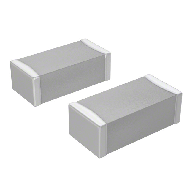

CB SERIES: PEN DIELECTRIC – LEAD FREE VERSION General Description GENERAL DESCRIPTION Film chip capacitor using a naked and stacked construction with metallized PEN (polyethylene naphtalate). ADVANTAGES • Use of high temperature dielectric films make these capacitors suitable for IR or vapor phase reflow processes. This chip is built without specific encapsulation. • The intrinsic elasticity of the dielectric film allows an excellent compatibility of the capacitor with all types of material for printed circuit boards. • The self-healing property of film technology results to a safety open failure mode and better overall reliability. • Excellent thermal shock resistance. APPLICATIONS • Low dissipation factor ESR & ESL. General purpose function in low voltage applications where miniaturization and SMD is required. Typical applications would be: • No piezoelectric effect. • Available in tape and reel suitable for automatic placement. • Non-polar construction. • Automotive (Airbag, Fuel injection calculator...) • Telecom (Public switching systems, modems, telephone set, cordless, mobile) Outer Layer • Industrial (SMPS, Power convertor module...) Termination Plating : 100% matte Sn Ni Barrier Under Termination Silver Epoxy Resin Brass Active Layers : PEN dielectric PERFORMANCE CHARACTERISTICS Climatic Category Capacitance Range Tolerance on CR Nominal Voltages Test Voltage Soldering methods Tangent of Loss Angle at 1kHz (DF) Insulation resistance minimum : IR Temperature range A.C. applications 55/125/56 1nF to 4.7μF ±5%, ±10% 25Vdc to 630Vdc 1.4Vr 2 sec. at 25°C IR or vapor phase reflow (not suitable for wave soldering) < 100 x 10-4 for C ≤ 0.33μF IR > 1000 MΩ at 20°C for 1 min. charge at 10Vdc for VR < 100Vdc and 100Vdc for VR ≥ 100Vdc for C > 0.33μF IR C > 400 sec. at 20°C for 1 min. charge at 10Vdc for VR < 100Vdc and 100Vdc for VR ≥ 100Vdc -55°C to 125°C with voltage derating of 1.25%/°C between 105°C and 125°C For high frequency A.C. application please check with AVX The Important Information/Disclaimer is incorporated in the catalog where these specifications came from or available online at www.avx.com/disclaimer/ by reference and should be reviewed in full before placing any order. 120418 – film chip capacitors – 19 CB SERIES: PEN DIELECTRIC – LEAD FREE VERSION Capacitance Values & Nominal Voltages CAPACITANCE VALUES (CR) AND NOMINAL VOLTAGES (VR) W H Capacitance Range (CR) Ordering Code 0.001μF CB017C0102+ -- 0.0012 CB017C0122+ -- 0.0015 CB017C0152+ -- 0.0018 CB017C0182+ -- 0.0022 CB017C0222+ -- 0.0027 CB017C0272+ -- 0.0033 CB017C0332+ -- 0.0047 CB017C0472+ -- 0.0056 CB017C0562+ -- 0.0068 CB017C0682+ -- 0.0082 CB017C0822+ -- 0.010μF CB017C0103+ -- 0.012 CB017C0123+ -- 0.015 CB017C0153+ -- 0.018 CB017C0183+ -- 0.022 CB017C0223+ -- 0.027 CB027C0273+ -- 0.033 CB027C0333+ -- 0.047 CB027C0473+ -- 0.056 CB027C0563+ -- 0.068 CB027C0683+ -- 0.082 CB027C0823+ -- 0.100μF CB027C0104+ -- L 3.30 (0.130) 3.30 (0.130) 3.30 (0.130) 3.30 (0.130) 3.30 (0.130) 3.30 (0.130) 3.30 (0.130) 3.30 (0.130) 3.30 (0.130) 3.30 (0.130) 3.30 (0.130) 3.30 (0.130) 3.30 (0.130) 3.30 (0.130) 3.30 (0.130) 3.30 (0.130) 3.30 (0.130) 3.30 (0.130) 3.30 (0.130) 3.30 (0.130) 3.30 (0.130) 3.30 (0.130) 3.30 (0.130) Chip Dimensions *Tolerances (page 6) W H max 1.60 1.15 (0.063) (0.045) 1.60 1.15 (0.063) (0.045) 1.60 1.15 (0.063) (0.045) 1.60 1.15 (0.063) (0.045) 1.60 1.15 (0.063) (0.045) 1.60 1.15 (0.063) (0.045) 1.60 1.15 (0.063) (0.045) 1.60 1.15 (0.063) (0.045) 1.60 1.15 (0.063) (0.045) 1.60 1.15 (0.063) (0.045) 1.60 1.15 (0.063) (0.045) 1.60 1.15 (0.063) (0.045) 1.60 1.15 (0.063) (0.045) 1.60 1.15 (0.063) (0.045) 1.60 1.15 (0.063) (0.045) 1.60 1.15 (0.063) (0.045) 2.50 1.80 (0.098) (0.071) 2.50 1.80 (0.098) (0.071) 2.50 1.80 (0.098) (0.071) 2.50 1.80 (0.098) (0.071) 2.50 1.80 (0.098) (0.071) 2.50 2.20 (0.098) (0.087) 2.50 2.30 (0.098) (0.091) millimeters (inches) T L VOLTAGE Vdc: 25V Vac: 16V Tape Dimensions T 0.50 (0.020) 0.50 (0.020) 0.50 (0.020) 0.50 (0.020) 0.50 (0.020) 0.50 (0.020) 0.50 (0.020) 0.50 (0.020) 0.50 (0.020) 0.50 (0.020) 0.50 (0.020) 0.50 (0.020) 0.50 (0.020) 0.50 (0.020) 0.50 (0.020) 0.50 (0.020) 0.50 (0.020) 0.50 (0.020) 0.50 (0.020) 0.50 (0.020) 0.50 (0.020) 0.50 (0.020) 0.50 (0.020) W 8.00 (0.315) 8.00 (0.315) 8.00 (0.315) 8.00 (0.315) 8.00 (0.315) 8.00 (0.315) 8.00 (0.315) 8.00 (0.315) 8.00 (0.315) 8.00 (0.315) 8.00 (0.315) 8.00 (0.315) 8.00 (0.315) 8.00 (0.315) 8.00 (0.315) 8.00 (0.315) 8.00 (0.315) 8.00 (0.315) 8.00 (0.315) 8.00 (0.315) 8.00 (0.315) 8.00 (0.315) 8.00 (0.315) P1 4.00 (0.158) 4.00 (0.158) 4.00 (0.158) 4.00 (0.158) 4.00 (0.158) 4.00 (0.158) 4.00 (0.158) 4.00 (0.158) 4.00 (0.158) 4.00 (0.158) 4.00 (0.158) 4.00 (0.158) 4.00 (0.158) 4.00 (0.158) 4.00 (0.158) 4.00 (0.158) 4.00 (0.158) 4.00 (0.158) 4.00 (0.158) 4.00 (0.158) 4.00 (0.158) 4.00 (0.158) 4.00 (0.158) K0 1.20 (0.047) 1.20 (0.047) 1.20 (0.047) 1.20 (0.047) 1.20 (0.047) 1.20 (0.047) 1.20 (0.047) 1.20 (0.047) 1.20 (0.047) 1.20 (0.047) 1.20 (0.047) 1.20 (0.047) 1.20 (0.047) 1.20 (0.047) 1.20 (0.047) 1.20 (0.047) 1.90 (0.075) 1.90 (0.075) 1.90 (0.075) 1.90 (0.075) 1.90 (0.075) 2.33 (0.092) 2.33 (0.092) Reel Dimensions A 180 (7.087) 180 (7.087) 180 (7.087) 180 (7.087) 180 (7.087) 180 (7.087) 180 (7.087) 180 (7.087) 180 (7.087) 180 (7.087) 180 (7.087) 180 (7.087) 180 (7.087) 180 (7.087) 180 (7.087) 180 (7.087) 180 ( 7.087) 180 ( 7.087) 180 ( 7.087) 180 ( 7.087) 180 ( 7.087) 180 ( 7.087) 180 ( 7.087) W1 8.40 (0.331) 8.40 (0.331) 8.40 (0.331) 8.40 (0.331) 8.40 (0.331) 8.40 (0.331) 8.40 (0.331) 8.40 (0.331) 8.40 (0.331) 8.40 (0.331) 8.40 (0.331) 8.40 (0.331) 8.40 (0.331) 8.40 (0.331) 8.40 (0.331) 8.40 (0.331) 8.40 (0.331) 8.40 (0.331) 8.40 (0.331) 8.40 (0.331) 8.40 (0.331) 8.40 (0.331) 8.40 (0.331) W2 max 14.4 (0.567) 14.4 (0.567) 14.4 (0.567) 14.4 (0.567) 14.4 (0.567) 14.4 (0.567) 14.4 (0.567) 14.4 (0.567) 14.4 (0.567) 14.4 (0.567) 14.4 (0.567) 14.4 (0.567) 14.4 (0.567) 14.4 (0.567) 14.4 (0.567) 14.4 (0.567) 14.4 (0.567) 14.4 (0.567) 14.4 (0.567) 14.4 (0.567) 14.4 (0.567) 14.4 (0.567) 14.4 (0.567) For other Values: upon request Replace the + by the tolerance code: J = 5% or K = 10% Replace the -- by the packaging suffix: -- = bulk BA = tape & reel 20 The Important Information/Disclaimer is incorporated in the catalog where these specifications came from or available online at www.avx.com/disclaimer/ by reference and should be reviewed in full before placing any order. 120418 – film chip capacitors – Packaging Unit Reel Pkg Code Bulk Reel 2000 3500 BA 2000 3500 BA 2000 3500 BA 2000 3500 BA 2000 3500 BA 2000 3500 BA 2000 3500 BA 2000 3500 BA 2000 3500 BA 2000 3500 BA 2000 3500 BA 2000 3500 BA 2000 3500 BA 2000 3500 BA 2000 3500 BA 2000 3500 BA 2000 2500 BA 2000 2500 BA 2000 2500 BA 2000 2500 BA 2000 2500 BA 2000 2000 BA 2000 2000 BA CB SERIES: PEN DIELECTRIC – LEAD FREE VERSION Capacitance Values & Nominal Voltages CAPACITANCE VALUES (CR) AND NOMINAL VOLTAGES (VR) W H Capacitance Range (CR) Ordering Code 0.001μF CB017D0102+ -- 0.0012 CB017D0122+ -- 0.0015 CB017D0152+ -- 0.0018 CB017D0182+ -- 0.0022 CB017D0222+ -- 0.0027 CB017D0272+ -- 0.0033 CB017D0332+ -- 0.0047 CB017D0472+ -- 0.0056 CB017D0562+ -- 0.0068 CB017D0682+ -- 0.0082 CB017D0822+ -- 0.010μF CB017D0103+ -- 0.012 CB017D0123+ -- 0.015 CB017D0153+ -- 0.018 CB017D0183+ -- 0.022 CB017D0223+ -- 0.027 CB027D0273+ -- 0.033 CB027D0333+ -- 0.047 CB027D0473+ -- 0.056 CB027D0563+ -- 0.068 CB027D0683+ -- 0.082 CB027D0823+ -- 0.100μF CB027D0104+ -- L 3.30 (0.130) 3.30 (0.130) 3.30 (0.130) 3.30 (0.130) 3.30 (0.130) 3.30 (0.130) 3.30 (0.130) 3.30 (0.130) 3.30 (0.130) 3.30 (0.130) 3.30 (0.130) 3.30 (0.130) 3.30 (0.130) 3.30 (0.130) 3.30 (0.130) 3.30 (0.130) 3.30 (0.130) 3.30 (0.130) 3.30 (0.130) 3.30 (0.130) 3.30 (0.130) 3.30 (0.130) 3.30 (0.130) Chip Dimensions *Tolerances (page 6) W H max 1.60 1.15 (0.063) (0.045) 1.60 1.15 (0.063) (0.045) 1.60 1.15 (0.063) (0.045) 1.60 1.15 (0.063) (0.045) 1.60 1.15 (0.063) (0.045) 1.60 1.15 (0.063) (0.045) 1.60 1.15 (0.063) (0.045) 1.60 1.15 (0.063) (0.045) 1.60 1.15 (0.063) (0.045) 1.60 1.15 (0.063) (0.045) 1.60 1.15 (0.063) (0.045) 1.60 1.15 (0.063) (0.045) 1.60 1.15 (0.063) (0.045) 1.60 1.15 (0.063) (0.045) 1.60 1.15 (0.063) (0.045) 1.60 1.15 (0.063) (0.045) 2.50 1.80 (0.098) (0.071) 2.50 1.80 (0.098) (0.071) 2.50 1.80 (0.098) (0.071) 2.50 1.80 (0.098) (0.071) 2.50 1.80 (0.098) (0.071) 2.50 2.20 (0.098) (0.087) 2.50 2.30 (0.098) (0.091) millimeters (inches) T L VOLTAGE Vdc: 50V Vac: 40V Tape Dimensions T 0.50 (0.020) 0.50 (0.020) 0.50 (0.020) 0.50 (0.020) 0.50 (0.020) 0.50 (0.020) 0.50 (0.020) 0.50 (0.020) 0.50 (0.020) 0.50 (0.020) 0.50 (0.020) 0.50 (0.020) 0.50 (0.020) 0.50 (0.020) 0.50 (0.020) 0.50 (0.020) 0.50 (0.020) 0.50 (0.020) 0.50 (0.020) 0.50 (0.020) 0.50 (0.020) 0.50 (0.020) 0.50 (0.020) W 8.00 (0.315) 8.00 (0.315) 8.00 (0.315) 8.00 (0.315) 8.00 (0.315) 8.00 (0.315) 8.00 (0.315) 8.00 (0.315) 8.00 (0.315) 8.00 (0.315) 8.00 (0.315) 8.00 (0.315) 8.00 (0.315) 8.00 (0.315) 8.00 (0.315) 8.00 (0.315) 8.00 (0.315) 8.00 (0.315) 8.00 (0.315) 8.00 (0.315) 8.00 (0.315) 8.00 (0.315) 8.00 (0.315) P1 4.00 (0.158) 4.00 (0.158) 4.00 (0.158) 4.00 (0.158) 4.00 (0.158) 4.00 (0.158) 4.00 (0.158) 4.00 (0.158) 4.00 (0.158) 4.00 (0.158) 4.00 (0.158) 4.00 (0.158) 4.00 (0.158) 4.00 (0.158) 4.00 (0.158) 4.00 (0.158) 4.00 (0.158) 4.00 (0.158) 4.00 (0.158) 4.00 (0.158) 4.00 (0.158) 4.00 (0.158) 4.00 (0.158) K0 1.20 (0.047) 1.20 (0.047) 1.20 (0.047) 1.20 (0.047) 1.20 (0.047) 1.20 (0.047) 1.20 (0.047) 1.20 (0.047) 1.20 (0.047) 1.20 (0.047) 1.20 (0.047) 1.20 (0.047) 1.20 (0.047) 1.20 (0.047) 1.20 (0.047) 1.20 (0.047) 1.90 (0.075) 1.90 (0.075) 1.90 (0.075) 1.90 (0.075) 1.90 (0.075) 2.33 (0.092) 2.33 (0.092) Reel Dimensions A 180 (7.087) 180 (7.087) 180 (7.087) 180 (7.087) 180 (7.087) 180 (7.087) 180 (7.087) 180 (7.087) 180 (7.087) 180 (7.087) 180 (7.087) 180 (7.087) 180 (7.087) 180 (7.087) 180 (7.087) 180 (7.087) 180 (7.087) 180 (7.087) 180 (7.087) 180 (7.087) 180 (7.087) 180 (7.087) 180 (7.087) W1 8.40 (0.331) 8.40 (0.331) 8.40 (0.331) 8.40 (0.331) 8.40 (0.331) 8.40 (0.331) 8.40 (0.331) 8.40 (0.331) 8.40 (0.331) 8.40 (0.331) 8.40 (0.331) 8.40 (0.331) 8.40 (0.331) 8.40 (0.331) 8.40 (0.331) 8.40 (0.331) 8.40 (0.331) 8.40 (0.331) 8.40 (0.331) 8.40 (0.331) 8.40 (0.331) 8.40 (0.331) 8.40 (0.331) W2 max 14.4 (0.567) 14.4 (0.567) 14.4 (0.567) 14.4 (0.567) 14.4 (0.567) 14.4 (0.567) 14.4 (0.567) 14.4 (0.567) 14.4 (0.567) 14.4 (0.567) 14.4 (0.567) 14.4 (0.567) 14.4 (0.567) 14.4 (0.567) 14.4 (0.567) 14.4 (0.567) 14.4 (0.567) 14.4 (0.567) 14.4 (0.567) 14.4 (0.567) 14.4 (0.567) 14.4 (0.567) 14.4 (0.567) Packaging Unit Reel Pkg Code Bulk Reel 2000 3500 BA 2000 3500 BA 2000 3500 BA 2000 3500 BA 2000 3500 BA 2000 3500 BA 2000 3500 BA 2000 3500 BA 2000 3500 BA 2000 3500 BA 2000 3500 BA 2000 3500 BA 2000 3500 BA 2000 3500 BA 2000 3500 BA 2000 3500 BA 2000 2500 BA 2000 2500 BA 2000 2500 BA 2000 2500 BA 2000 2500 BA 2000 2000 BA 2000 2000 BA For other Values: upon request Replace the + by the tolerance code: J = 5% or K = 10% Replace the -- by the packaging suffix: -- = bulk BA = tape & reel The Important Information/Disclaimer is incorporated in the catalog where these specifications came from or available online at www.avx.com/disclaimer/ by reference and should be reviewed in full before placing any order. 120418 – film chip capacitors – 21 CB SERIES: PEN DIELECTRIC – LEAD FREE VERSION Capacitance Values & Nominal Voltages CAPACITANCE VALUES (CR) AND NOMINAL VOLTAGES (VR) W H Capacitance Range (CR) Ordering Code 0.001μF CB037D0102+ -- 0.0012 CB037D0122+ -- 0.0015 CB037D0152+ -- 0.0018 CB037D0182+ -- 0.0022 CB037D0222+ -- 0.0027 CB037D0272+ -- 0.0033 CB037D0332+ -- 0.0047 CB037D0472+ -- 0.0056 CB037D0562+ -- 0.0068 CB037D0682+ -- 0.0082 0.010μF CB037D0822+ -- CB037D0103+ -- L 4.70 (0.185) 4.70 (0.185) 4.70 (0.185) 4.70 (0.185) 4.70 (0.185) 4.70 (0.185) 4.70 (0.185) 4.70 (0.185) 4.70 (0.185) 4.70 (0.185) 4.70 (0.185) 4.70 (0.185) 4.70 (0.185) 4.70 (0.185) 4.70 (0.185) 4.70 (0.185) 4.70 (0.185) 4.70 (0.185) 4.70 (0.185) 4.70 (0.185) 4.70 (0.185) 4.70 (0.185) 4.70 (0.185) Chip Dimensions *Tolerances (page 6) W H max 3.20 1.90 (0.126) (0.075) 3.20 1.90 (0.126) (0.075) 3.20 1.90 (0.126) (0.075) 3.20 1.90 (0.126) (0.075) 3.20 1.90 (0.126) (0.075) 3.20 1.90 (0.126) (0.075) 3.20 1.90 (0.126) (0.075) 3.20 1.90 (0.126) (0.075) 3.20 1.90 (0.126) (0.075) 3.20 1.90 (0.126) (0.075) 3.20 1.90 (0.126) (0.075) 3.20 1.90 (0.126) (0.075) 3.20 1.90 (0.126) (0.075) 3.20 1.90 (0.126) (0.075) 3.20 2.00 (0.126) (0.079) 3.20 2.00 (0.126) (0.079) 3.20 1.90 (0.126) (0.075) 3.20 1.90 (0.126) (0.075) 3.20 2.00 (0.126) (0.079) 3.20 2.00 (0.126) (0.079) 3.20 1.90 (0.126) (0.075) 3.20 1.90 (0.126) (0.075) 3.20 2.00 (0.126) (0.079) millimeters (inches) T L VOLTAGE Vdc: 63V Vac: 40V Tape Dimensions T 0.60 (0.024) 0.60 (0.024) 0.60 (0.024) 0.60 (0.024) 0.60 (0.024) 0.60 (0.024) 0.6 (0.024) 0.60 (0.024) 0.60 (0.024) 0.60 (0.024) 0.6 (0.024) 0.60 (0.024) 0.60 (0.024) 0.60 (0.024) 0.60 (0.024) 0.60 (0.024) 0.60 (0.024) 0.60 (0.024) 0.60 (0.024) 0.60 (0.024) 0.6 (0.024) 0.60 (0.024) 0.60 (0.024) W 12.0 (0.472) 12.0 (0.472) 12.0 (0.472) 12.0 (0.472) 12.0 (0.472) 12.0 (0.472) 12.0 (0.472) 12.0 (0.472) 12.0 (0.472) 12.0 (0.472) 12.0 (0.472) 12.0 (0.472) 12.0 (0.472) 12.0 (0.472) 12.0 (0.472) 12.0 (0.472) 12.0 (0.472) 12.0 (0.472) 12.0 (0.472) 12.0 (0.472) 12.0 (0.472) 12.0 (0.472) 12.0 (0.472) P1 8.00 (0.315) 8.00 (0.315) 8.00 (0.315) 8.00 (0.315) 8.00 (0.315) 8.00 (0.315) 8.0 (0.315) 8.00 (0.315) 8.00 (0.315) 8.00 (0.315) 8.00 (0.315) 8.00 (0.315) 8.00 (0.315) 8.00 (0.315) 8.00 (0.315) 8.00 (0.315) 8.00 (0.315) 8.00 (0.315) 8.00 (0.315) 8.00 (0.315) 8.00 (0.315) 8.00 (0.315) 8.00 (0.315) K0 2.06 (0.081) 2.06 (0.081) 2.06 (0.081) 2.06 (0.081) 2.06 (0.081) 2.06 (0.081) 2.06 (0.081) 2.06 (0.081) 2.06 (0.081) 2.06 (0.081) 2.06 (0.081) 2.06 (0.081) 2.06 (0.081) 2.06 (0.081) 2.06 (0.081) 2.06 (0.081) 2.06 (0.081) 2.06 (0.081) 2.06 (0.081) 2.06 (0.081) 2.06 (0.081) 2.06 (0.081) 2.06 (0.081) Reel Dimensions A 180 (7.09) 330 (12.99) 180 (7.09) 330 (12.99) 180 (7.09) 330 (12.99) 180 (7.09) 330 (12.99) 180 (7.09) 330 (12.99) 180 (7.09) 330 (12.99) 180 (7.09) 330 (12.99) 180 (7.09) 330 (12.99) 180 (7.09) 330 (12.99) 180 (7.09) 330 (12.99) 180 (7.09) 330 (12.99) 180 (7.09) W1 12.4 (0.488) 12.4 (0.488) 12.4 (0.488) 12.4 (0.488) 12.4 (0.488) 12.4 (0.488) 12.4 (0.488) 12.4 (0.488) 12.4 (0.488) 12.4 (0.488) 12.4 (0.488) 12.4 (0.488) 12.4 (0.488) 12.4 (0.488) 12.4 (0.488) 12.4 (0.488) 12.4 (0.488) 12.4 (0.488) 12.4 (0.488) 12.4 (0.488) 12.4 (0.488) 12.4 (0.488) 12.4 (0.488) W2 max 18.4 (0.724) 18.4 (0.724) 18.4 (0.724) 18.4 (0.724) 18.4 (0.724) 18.4 (0.724) 18.4 (0.724) 18.4 (0.724) 18.4 (0.724) 18.4 (0.724) 18.4 (0.724) 18.4 (0.724) 18.4 (0.724) 18.4 (0.724) 18.4 (0.724) 18.4 (0.724) 18.4 (0.724) 18.4 (0.724) 18.4 (0.724) 18.4 (0.724) 18.4 (0.724) 18.4 (0.724) 18.4 (0.724) For other Values: upon request Replace the + by the tolerance code: J = 5% or K = 10% Replace the -- by the packaging suffix: -- = bulk BA or BC = tape & reel 22 The Important Information/Disclaimer is incorporated in the catalog where these specifications came from or available online at www.avx.com/disclaimer/ by reference and should be reviewed in full before placing any order. 120418 – film chip capacitors – Packaging Unit Reel Pkg Code Bulk Reel 1500 1200 BA 1500 4500 BC 1500 1200 BA 1500 4500 BC 1500 1200 BA 1500 4500 BC 1500 1200 BA 1500 4500 BC 1500 1200 BA 1500 4500 BC 1500 1200 BA 1500 4500 BC 1500 1200 BA 1500 4500 BC 1500 1200 BA 1500 4500 BC 1500 1200 BA 1500 4500 BC 1500 1200 BA 1500 4500 BC 1500 1200 BA 1500 4500 BC 1500 1200 BA CB SERIES: PEN DIELECTRIC – LEAD FREE VERSION Capacitance Values & Nominal Voltages CAPACITANCE VALUES (CR) AND NOMINAL VOLTAGES (VR) W H T L Capacitance Range (CR) Ordering Code 0.010μF CB037D0103+ -- 0.012 0.015 0.018 0.022 0.027 0.033 0.047 0.056 0.068 0.082 0.100μF CB037D0123+ -- CB037D0153+ -- CB037D0183+ -- CB037D0223+ -- CB037D0273+ -- CB037D0333+ -- CB037D0473+ -- CB037D0563+ -- CB037D0683+ -- CB037D0823+ -- CB037D0104+ -- L 4.70 (0.185) 4.70 (0.185) 4.70 (0.185) 4.70 (0.185) 4.70 (0.185) 4.70 (0.185) 4.70 (0.185) 4.70 (0.185) 4.70 (0.185) 4.70 (0.185) 4.70 (0.185) 4.70 (0.185) 4.70 (0.185) 4.70 (0.185) 4.70 (0.185) 4.70 (0.185) 4.70 (0.185) 4.70 (0.185) 4.70 (0.185) 4.70 (0.185) 4.70 (0.185) 4.70 (0.185) 4.70 (0.185) Chip Dimensions *Tolerances (page 6) W H max 3.20 2.00 (.0.126) (0.079) 3.20 2.00 (0.126) (0.079) 3.20 2.00 (0.126) (0.079) 3.20 2.40 (0.126) (0.095) 3.20 2.40 (0.126) (0.095) 3.20 2.50 (0.126) (0.099) 3.20 2.50 (0.126) (0.099) 3.20 2.00 (0.126) (0.079) 3.20 2.00 (0.126) (0.079) 3.20 1.90 (0.126) (0.075) 3.20 1.90 (0.126) (0.075) 3.20 2.00 (0.126) (0.079) 3.20 2.00 (0.126) (0.079) 3.20 2.70 (0.126) (0.107) 3.20 2.70 (0.126) (0.107) 3.20 2.30 (0.126) (0.091) 3.20 2.30 (0.126) (0.091) 3.20 2.00 (0.126) (0.079) 3.20 2.00 (0.126) (0.079) 3.20 2.50 (0.126) (0.099) 3.20 2.50 (0.126) (0.099) 3.20 2.80 (0.126) (0.111) 3.20 2.80 (0.126) (0.111) VOLTAGE Vdc: 63V Vac: 40V Tape Dimensions T 0.60 (0.024) 0.60 (0.024) 0.60 (0.024) 0.60 (0.024) 0.60 (0.024) 0.60 (0.024) 0.60 (0.024) 0.60 (0.024) 0.60 (0.024) 0.60 (0.024) 0.60 (0.024) 0.60 (0.024) 0.60 (0.024) 0.60 (0.024) 0.60 (0.024) 0.60 (0.024) 0.60 (0.024) 0.60 (0.024) 0.60 (0.024) 0.60 (0.024) 0.60 (0.024) 0.60 (0.024) 0.60 (0.024) W 12.0 (0.472) 12.0 (0.472) 12.0 (0.472) 12.0 (0.472) 12.0 (0.472) 12.0 (0.472) 12.0 (0.472) 12.0 (0.472) 12.0 (0.472) 12.0 (0.472) 12.0 (0.472) 12.0 (0.472) 12.0 (0.472) 12.0 (0.472) 12.0 (0.472) 12.0 (0.472) 12.0 (0.472) 12.0 (0.472) 12.0 (0.472) 12.0 (0.472) 12.0 (0.472) 12.0 (0.472) 12.0 (0.472) P1 8.0 (0.315) 8.00 (0.315) 8.00 (0.315) 8.00 (0.315) 8.00 (0.315) 8.00 (0.315) 8.00 (0.315) 8.00 (0.315) 8.00 (0.315) 8.00 (0.315) 8.00 (0.315) 8.00 (0.315) 8.00 (0.315) 8.00 (0.315) 8.00 (0.315) 8.00 (0.315) 8.00 (0.315) 8.00 (0.315) 8.00 (0.315) 8.00 (0.315) 8.00 (0.315) 8.00 (0.315) 8.00 (0.315) K0 2.06 (0.081) 2.06 (0.081) 2.06 (0.081) 2.60 (0.102) 2.60 (0.102) 2.60 (0.102) 2.60 (0.102) 2.06 (0.081) 2.06 (0.081) 2.06 (0.081) 2.06 (0.081) 2.06 (0.081) 2.06 (0.081) 3.10 (0.122) 3.10 (0.122) 2.60 (0.102) 2.60 (0.102) 2.06 (0.081) 2.06 (0.081) 2.60 (0.102) 2.60 (0.102) 3.10 (0.122) 3.10 (0.122) Reel Dimensions A 330 (12.99) 180 (7.09) 330 (12.99) 180 (7.09) 330 (12.99) 180 (7.09) 330 (12.99) 180 (7.09) 330 (12.99) 180 (7.09) 330 (12.99) 180 (7.09) 330 (12.99) 180 (7.09) 330 (12.99) 180 (7.09) 330 (12.99) 180 (7.09) 330 (12.99) 180 (7.09) 330 (12.99) 180 (7.09) 330 (12.99) W1 12.4 (0.488) 12.4 (0.488) 12.4 (0.488) 12.4 (0.488) 12.4 (0.488) 12.4 (0.488) 12.4 (0.488) 12.4 (0.488) 12.4 (0.488) 12.4 (0.488) 12.4 (0.488) 12.4 (0.488) 12.4 (0.488) 12.4 (0.488) 12.4 (0.488) 12.4 (0.488) 12.4 (0.488) 12.4 (0.488) 12.4 (0.488) 12.4 (0.488) 12.4 (0.488) 12.4 (0.488) 12.4 (0.488) W2 max 18.4 (0.724) 18.4 (0.724) 18.4 (0.724) 18.4 (0.724) 18.4 (0.724) 18.4 (0.724) 18.4 (0.724) 18.4 (0.724) 18.4 (0.724) 18.4 (0.724) 18.4 (0.724) 18.4 (0.724) 18.4 (0.724) 18.4 (0.724) 18.4 (0.724) 18.4 (0.724) 18.4 (0.724) 18.4 (0.724) 18.4 (0.724) 18.4 (0.724) 18.4 (0.724) 18.4 (0.724) 18.4 (0.724) Packaging Unit Reel Pkg Code Bulk Reel 1500 4500 BC 1500 1200 BA 1500 4500 BC 1500 900 BA 1500 3600 BC 1500 900 BA 1500 3600 BC 1500 1200 BA 1500 4500 BC 1500 1200 BA 1500 4500 BC 1500 1200 BA 1500 4500 BC 1500 700 BA 1500 3000 BC 1500 900 BA 1500 3600 BC 1500 1200 BA 1500 4500 BC 1500 900 BA 1500 3600 BC 1500 700 BA 1500 3000 BC For other Values: upon request Replace the + by the tolerance code: J = 5% or K = 10% Replace the -- by the packaging suffix: -- = bulk BA or BC = tape & reel The Important Information/Disclaimer is incorporated in the catalog where these specifications came from or available online at www.avx.com/disclaimer/ by reference and should be reviewed in full before placing any order. 120418 – film chip capacitors – 23 CB SERIES: PEN DIELECTRIC – LEAD FREE VERSION Capacitance Values & Nominal Voltages CAPACITANCE VALUES (CR) AND NOMINAL VOLTAGES (VR) W H T L Capacitance Range (CR) 0.120 0.150 0.180 0.220 Ordering Code 4.70 (0.185) 4.70 (0.185) 5.80 (0.228) 5.80 (0.228) 5.80 (0.228) 5.80 (0.228) 7.30 (0.287) 7.30 (0.287) 7.30 (0.287) 10.5 (0.413) 12.8 (0.503) 15.3 (0.601) 15.3 (0.601) 3.20 (0.126) 3.20 (0.126) 5.00 (0.195) 5.00 (0.195) 5.00 (0.195) 5.00 (0.195) 6.10 (0.240) 6.10 (0.240) 6.10 (0.240) 7.60 (0.299) 10.2 (0.402) 13.7 (0.539) 13.7 (0.539) 3.00 (0.118) 3.00 (0.118) 4.00 (0.158) 4.00 (0.158) 2.50 (0.099) 3.90 (0.154) 4.40 (0.173) 4.70 (0.185) 4.70 (0.185) 6.10 (0.240) 6.70 (0.264) 5.30 (0.209) 7.20 (0.283) 0.60 (0.024) 0.60 (0.024) 0.80 (0.031) 0.80 (0.031) 0.80 (0.031) 0.80 (0.031) 0.80 (0.031) 0.80 (0.031) 0.80 (0.031) 0.80 (0.032) 0.80 (0.032) 0.80 (0.032) 0.80 (0.032) 3.30 (0.130) 3.30 CB017E0122+ -(0.130) 3.30 CB017E0152+ -(0.130) 3.30 CB017E0182+ -(0.130) 1.60 (0.063) 1.60 (0.063) 1.60 (0.063) 1.60 (0.063) 1.15 (0.045) 1.15 (0.045) 1.15 (0.045) 1.15 (0.045) 0.50 (0.020) 0.50 (0.020) 0.50 (0.020) 0.50 (0.020) CB037D0224+ -- 0.470 CB047D0474+ -- 0.560 CB047D0564+ -- 0.680 CB047D0684+ -- 0.82* CB057D0824+ -- 1μF* CB057D0105+ -- 1.5* CB057D0155+ -- 2.2 CB167D0225+ -- 2.7 CB177D0275+ -- 3.3 CB187D0335+ -- 4.7 CB187D0475+ -- 0.001μF CB017E0102+ -- 0.0018 For other Values: upon request Replace the + by the tolerance code: J = 5% or K = 10% Replace the -- by the packaging suffix: -- = bulk BA or BC = tape & reel 24 Tape Dimensions T 0.60 (0.024) 0.60 (0.024) 0.60 (0.024) 0.60 (0.024) 0.60 (0.024) CB047D0334+ -- 0.0015 VOLTAGE Vdc: 63V Vac: 40V L 4.70 (0.185) CB037D0124+ -4.70 (0.185) 4.70 (0.185) CB037D0154+ -4.70 (0.185) 4.70 (0.185) CB037D0184+ -4.70 3.20 2.40 (0.185) (0.126) (0.095) 0.330 0.0012 Chip Dimensions *Tolerances (page 6) W H max 3.20 2.30 (0.126) (0.091) 3.20 2.30 (0.126) (0.091) 3.20 2.00 (0.126) (0.079) 3.20 2.00 (0.126) (0.079) 3.20 2.40 (0.126) (0.095) W 12.0 (0.472) 12.0 (0.472) 12.0 (0.472) 12.0 (0.472) 12.0 (0.472) P1 8.00 (0.315) 8.00 (0.315) 8.00 (0.315) 8.00 (0.315) 8.00 (0.315) K0 2.60 (0.102) 2.60 (0.102) 2.06 (0.081) 2.06 (0.081) 2.60 (0.102) Reel Dimensions A 180 (7.087) 330 (12.99) 180 (7.087) 330 (12.99) 180 (7.087) W1 12.4 (0.488) 12.4 (0.488) 12.4 (0.488) 12.4 (0.488) 12.4 (0.488) W2 max 18.4 (0.724) 18.4 (0.724) 18.4 (0.724) 18.4 (0.724) 18.4 (0.724) 0.60 12.0 8.00 2.60 330 12.4 18.4 (0.024) (0.472) (0.315) (0.102) (12.99) (0.488) (0.724) 12.0 8.00 3.10 180 12.4 (0.472) (0.315) (0.122) (7.087) (0.488) 12.0 8.00 3.10 330 12.4 (0.472) (0.315) (0.122) (12.99) (0.488) 16.0 8.00 4.10 330 12.4 (0.629) (0.315) (0.162) (12.99) (0.488) 12.0 8.00 4.10 330 12.4 (0.472) (0.315) (0.162) (12.99) (0.488) 12.0 8.00 3.10 330 12.4 (0.472) (0.315) (0.122) (12.99) (0.488) 12.0 8.00 4.10 330 12.4 (0.472) (0.315) (0.162) (12.99) (0.488) 16.0 12.0 5.23 330 16.4 (0.629) (0.472) (0.206) (12.99) (0.645) 16.0 12.0 4.80 330 16.4 (0.629) (0.472) (0.189) (12.99) (0.645) 16.0 12.0 4.80 330 16.4 (0.629) (0.472) (0.189) (12.99) (0.645) 24.0 12.0 6.19 330 24.4 (0.944) (0.472) (0.244) (12.99) (0.961) 24.0 16.0 7.00 330 24.4 (0.944) (0.629) (0.274) (12.99) (0.961) 24.0 24.0 6.30 330 24.4 (0.944) (0.944) (0.248) (12.99) (0.961) 24.0 24.0 7.60 330 24.4 (0.944) (0.944) (0.299) (12.99) (0.961) VOLTAGE Vdc: 100V Vac: 63V 8.00 4.00 1.20 180 8.40 (0.315) (0.158) (0.047) (7.087) (0.331) 8.00 4.00 1.20 180 8.40 (0.315) (0.158) (0.047) (7.087) (0.331) 8.00 4.00 1.20 180 8.40 (0.315) (0.158) (0.047) (7.087) (0.331) 8.00 4.00 1.20 180 8.40 (0.315) (0.158) (0.047) (7.087) (0.331) 18.4 (0.724) 18.4 (0.724) 18.4 (0.724) 18.4 (0.724) 18.4 (0.724) 18.4 (0.724) 22.4 (0.881) 22.4 (0.881) 22.4 (0.881) 30.4 (1.196) 30.4 (1.196) 30.4 (1.196) 30.4 (1.196) 14.4 (0.567) 14.4 (0.567) 14.4 (0.567) 14.4 (0.567) *Special length: 7.3 +0.7/-0.3 (0.287 +0.026/-0.012) The Important Information/Disclaimer is incorporated in the catalog where these specifications came from or available online at www.avx.com/disclaimer/ by reference and should be reviewed in full before placing any order. 120418 – film chip capacitors – Packaging Unit Reel Pkg Code Bulk Reel 1500 900 BA 1500 3600 BC 1500 1200 BA 1500 4500 BC 1500 900 BA 1500 3600 BC 1500 700 BA 1500 3000 BC 1500 2300 BC 1500 2300 BC 1500 3000 BC 1500 2300 BC 1000 1100 BC 1000 1800 BC 1000 1800 BC 500 900 BC 300 600 BC 300 400 BC 300 300 BC 2000 3500 BA 2000 3500 BA 2000 3500 BA 2000 3500 BA CB SERIES: PEN DIELECTRIC – LEAD FREE VERSION Capacitance Values & Nominal Voltages CAPACITANCE VALUES (CR) AND NOMINAL VOLTAGES (VR) W H T L Capacitance Range (CR) Ordering Code 0.0022 CB017E0222+ -- 0.0027 CB017E0272+ -- 0.0033 CB017E0332+ -- 0.0047 CB017E0472+ -- 0.0056 CB017E0562+ -- 0.0068 CB017E0682+ -- 0.0082 CB017E0822+ -- 0.010μF CB017E0103+ -- 0.012 CB027E0123+ -- 0.015 CB027E0153+ -- 0.018 CB027E0183+ -- 0.022 CB027E0223+ -- 0.027 CB037E0273+ -- 0.033 CB037E0333+ -- 0.047 CB037E0473+ -- 0.056 CB037E0563+ -- 0.068 CB037E0683+ -- 0.082 CB037E0823+ -- L 3.30 (0.130) 3.30 (0.130) 3.30 (0.130) 3.30 (0.130) 3.30 (0.130) 3.30 (0.130) 3.30 (0.130) 3.30 (0.130) 3.30 (0.130) 3.30 (0.130) 3.30 (0.130) 3.30 (0.130) 4.70 (0.185) 4.70 (0.185) 4.70 (0.185) 4.70 (0.185) 4.70 (0.185) 4.70 (0.185) 4.70 (0.185) 4.70 (0.185) 4.70 (0.185) 4.70 (0.185) 4.70 (0.185) Chip Dimensions *Tolerances (page 6) W H max 1.60 1.15 (0.063) (0.045) 1.60 1.15 (0.063) (0.045) 1.60 1.15 (0.063) (0.045) 1.60 1.15 (0.063) (0.045) 1.60 1.15 (0.063) (0.045) 1.60 1.15 (0.063) (0.045) 1.60 1.15 (0.063) (0.045) 1.60 1.15 (0.063) (0.045) 2.50 1.80 (0.098) (0.071) 2.50 1.80 (0.098) (0.071) 2.50 1.80 (0.098) (0.071) 2.50 1.80 (0.098) (0.071) 3.20 2.20 (0.126) (0.087) 3.20 2.20 (0.126) (0.087) 3.20 2.00 (0.126) (0.079) 3.20 2.00 (0.126) (0.079) 3.20 2.60 (0.126) (0.102) 3.20 2.60 (0.126) (0.102) 3.20 2.50 (0.126) (0.099) 3.20 2.50 (0.126) (0.099) 3.20 2.00 (0.126) (0.079) 3.20 2.00 (0.126) (0.079) 3.20 2.50 (0.126) (0.099) millimeters (inches) VOLTAGE Vdc: 100V Vac: 63V Tape Dimensions T 0.50 (0.020) 0.50 (0.020) 0.50 (0.020) 0.50 (0.020) 0.50 (0.020) 0.50 (0.020) 0.50 (0.020) 0.50 (0.020) 0.50 (0.020) 0.50 (0.020) 0.50 (0.020) 0.50 (0.020) 0.60 (0.024) 0.60 (0.024) 0.60 (0.024) 0.60 (0.024) 0.60 (0.024) 0.60 (0.024) 0.60 (0.024) 0.60 (0.024) 0.60 (0.024) 0.60 (0.024) 0.60 (0.024) W 8.00 (0.315) 8.00 (0.315) 8.00 (0.315) 8.00 (0.315) 8.00 (0.315) 8.00 (0.315) 8.00 (0.315) 8.00 (0.315) 8.00 (0.315) 8.00 (0.315) 8.0 (0.315) 8.00 (0.315) 12.0 (0.472) 12.0 (0.472) 12.0 (0.472) 12.0 (0.472) 12.0 (0.472) 12.0 (0.472) 12.0 (0.472) 12.0 (0.472) 12.0 (0.472) 12.0 (0.472) 12.0 (0.472) P1 4.00 (0.158) 4.00 (0.158) 4.00 (0.158) 4.00 (0.158) 4.00 (0.158) 4.00 (0.158) 4.00 (0.158) 4.00 (0.158) 4.00 (0.158) 4.00 (0.158) 4.00 (0.158) 4.00 (0.158) 8.00 (0.315) 8.00 (0.315) 8.00 (0.315) 8.00 (0.315) 8.00 (0.315) 8.00 (0.315) 8.00 (0.315) 8.00 (0.315) 8.00 (0.315) 8.00 (0.315) 8.00 (0.315) K0 1.20 (0.047) 1.20 (0.047) 1.20 (0.047) 1.20 (0.047) 1.20 (0.047) 1.20 (0.047) 1.20 (0.047) 1.20 (0.047) 1.90 (0.075) 1.90 (0.075) 1.90 (0.075) 1.90 (0.075) 2.60 (0.1024) 2.60 (0.1024) 2.06 (0.081) 2.06 (0.081) 3.10 (0.122) 3.10 (0.122) 2.60 (0.102) 2.60 (0.102) 2.06 (0.081) 2.06 (0.081) 2.60 (0.102) Reel Dimensions A 180 (7.087) 180 (7.087) 180 (7.087) 180 (7.087) 180 (7.087) 180 (7.087) 180 (7.087) 180 (7.087) 180 (7.087) 180 (7.087) 180 (7.087) 180 (7.087) 180 (7.087) 330 (12.99) 180 (7.087) 330 (12.99) 180 (7.087) 330 (12.99) 180 (7.087) 330 (12.99) 180 (7.087) 330 (12.99) 180 (7.087) W1 8.40 (0.331) 8.40 (0.331) 8.40 (0.331) 8.40 (0.331) 8.40 (0.331) 8.40 (0.331) 8.40 (0.331) 8.40 (0.331) 8.40 (0.331) 8.40 (0.331) 8.40 (0.331) 8.40 (0.331) 12.4 (0.488) 12.4 (0.488) 12.4 (0.488) 12.4 (0.488) 12.4 (0.488) 12.4 (0.488) 12.4 (0.488) 12.4 (0.488) 12.4 (0.488) 12.4 (0.488) 12.4 (0.488) W2 max 14.4 (0.567) 14.4 (0.567) 14.4 (0.567) 14.4 (0.567) 14.4 (0.567) 14.4 (0.567) 14.4 (0.567) 14.4 (0.567) 14.4 (0.567) 14.4 (0.567) 14.4 (0.567) 14.4 (0.567) 18.4 (0.724) 18.4 (0.724) 18.4 (0.724) 18.4 (0.724) 18.4 (0.724) 18.4 (0.724) 18.4 (0.724) 18.4 (0.724) 18.4 (0.724) 18.4 (0.724) 18.4 (0.724) Packaging Unit Reel Pkg Code Bulk Reel 2000 3500 BA 2000 3500 BA 2000 3500 BA 2000 3500 BA 2000 3500 BA 2000 3500 BA 2000 3500 BA 2000 3500 BA 2000 2500 BA 2000 2500 BA 2000 2500 BA 2000 2500 BA 1500 900 BA 1500 3600 BC 1500 1200 BA 1500 4500 BC 1500 700 BA 1500 3000 BC 1500 900 BA 1500 3600 BC 1500 1200 BA 1500 4500 BC 1500 900 BA For other Values: upon request Replace the + by the tolerance code: J = 5% or K = 10% Replace the -- by the packaging suffix: -- = bulk BA or BC = tape & reel The Important Information/Disclaimer is incorporated in the catalog where these specifications came from or available online at www.avx.com/disclaimer/ by reference and should be reviewed in full before placing any order. 120418 – film chip capacitors – 25 CB SERIES: PEN DIELECTRIC – LEAD FREE VERSION Capacitance Values & Nominal Voltages CAPACITANCE VALUES (CR) AND NOMINAL VOLTAGES (VR) W H Capacitance Range (CR) Ordering Code 0.082 CB037E0823+ -- 0.100μF CB037E0104+ -- 0.120 CB047E0124+ -- 0.150 CB047E0154+ -- 0.180 CB047E0184+ -- 0.220 CB047E0224+ -- 0.330 CB047E0334+ -- 0.47* CB057E0474+ -- 0.56* CB057E0564+ -- 0.68* CB057E0684+ -- 0.82 CB167E0824+ -- 1 CB167E0105+ -- 1.5 CB177E0155+ -- 2.2 CB177E0225+ -- 3.3 CB187E0335+ -- 0.001μF CB037G0102+ -- 0.0012 CB037G0122+ -- 0.0015 CB037G0152+ -- 0.0018 CB037G0182+ -- L 4.70 (0.185) 4.70 (0.185) 4.70 (0.185) 5.80 (0.228) 5.80 (0.228) 5.80 (0.228) 5.80 (0.228) 5.80 (0.228) 7.30 (0.287) 7.30 (0.287) 7.30 (0.287) 10.5 (0.413) 10.5 (0.413) 12.8 (0.503) 12.8 (0.503) 15.3 (0.601) T 0.60 (0.024) 0.60 (0.024) 0.60 (0.024) 0.80 (0.032) 0.80 (0.032) 0.80 (0.032) 0.80 (0.032) 0.80 (0.032) 0.80 (0.032) 0.80 (0.032) 0.80 (0.032) 0.80 (0.032) 0.80 (0.032) 0.80 (0.032) 0.80 (0.032) 0.80 (0.032) 4.70 (0.185) 4.70 (0.185) 4.70 (0.185) 4.70 (0.185) 4.70 (0.185) 4.70 (0.185) 4.70 (0.185) 3.20 (0.126) 3.20 (0.126) 3.20 (0.126) 3.20 (0.126) 3.20 (0.126) 3.20 (0.126) 3.20 (0.126) 0.60 (0.024) 0.60 (0.024) 0.60 (0.024) 0.60 (0.024) 0.60 (0.024) 0.60 (0.024) 0.60 (0.024) For other Values: upon request Replace the + by the tolerance code: J = 5% or K = 10% Replace the -- by the packaging suffix: -- = bulk BA or BC = tape & reel 26 VOLTAGE Vdc: 100V Vac: 63V Chip Dimensions *Tolerances (page 6) W H max 3.20 2.50 (0.126) (0.099) 3.20 3.00 (0.126) (0.118) 3.20 3.00 (0.126) (0.118) 5.00 4.00 (0.195) (0.158) 5.00 3.30 (0.195) (0.130) 5.00 3.00 (0.195) (0.118) 5.00 4.00 (0.195) (0.158) 5.00 4.00 (0.195) (0.158) 6.10 4.50 (0.240) (0.177) 6.10 4.00 (0.240) (0.158) 6.10 4.50 (0.240) (0.177) 7.6 5.80 (0.299) (0.229) 7.60 6.00 (0.299) (0.237) 10.2 5.50 (0.402) (0.217) 10.2 6.90 (0.402) (0.272) 13.7 7.10 (0.539) (0.280) 2.00 (0.079) 2.00 (0.079) 2.00 (0.079) 2.00 (0.079) 2.00 (0.079) 2.00 (0.079) 2.00 (0.079) millimeters (inches) T L Tape Dimensions Reel Dimensions W P1 K0 A W1 12.0 8.00 2.60 330 12.4 (0.472) (0.315) (0.102) (12.99) (0.488) 12.0 8.00 3.10 180 12.4 (0.472) (0.315) (0.122) (7.087) (0.488) 12.0 8.00 3.10 330 12.4 (0.472) (0.315) (0.122) (12.99) (0.488) 12.0 8.00 4.10 330 12.4 (0.472) (0.315) (0.162) (12.99) (0.488) 12.0 8.00 3.45 330 12.4 (0.472) (0.315) (0.136) (12.99) (0.488) 12.0 8.00 3.10 330 12.4 (0.472) (0.315) (0.122) (12.99) (0.488) 12.0 8.00 4.10 330 12.4 (0.472) (0.315) (0.162) (12.99) (0.488) 16.0 8.00 4.10 330 16.4 (0.629) (0.315) (0.162) (12.99) (0.645) 16.0 12.0 4.80 330 16.4 (0.629) (0.472) (0.189) (12.99) (0.645) 16.0 12.0 4.10 330 16.4 (0.629) (0.472) (0.162) (12.99) (0.645) 16.0 12.0 4.80 330 16.4 (0.629) (0.472) (0.189) (12.99) (0.645) 24.0 12.0 6.19 330 24.4 (0.944) (0.472) (0.244) (12.99) (0.961) 24.0 12.0 6.19 330 24.4 (0.944) (0.472) (0.244) (12.99) (0.961) 24.0 16.0 5.70 330 24.4 (0.944) (0.629) (0.224) (12.99) (0.961) 24.0 16.0 7.00 330 24.4 (0.944) (0.629) (0.274) (12.99) (0.961) 24.0 24.0 7.60 330 24.4 (0.944) (0.944) (0.299) (12.99) (0.961) VOLTAGE Vdc: 250V Vac: 160V 12.0 8.00 2.06 180 12.4 (0.472) (0.315) (0.081) (7.087) (0.488) 12.0 8.00 2.06 330 12.4 (0.472) (0.315) (0.081) (12.99) (0.488) 12.0 8.00 2.06 180 12.4 (0.472) (0.315) (0.081) (7.087) (0.488) 12.0 8.00 2.06 330 12.4 (0.472) (0.315) (0.081) (12.99) (0.488) 12.0 8.00 2.06 180 12.4 (0.472) (0.315) (0.081) (7.087) (0.488) 12.0 8.00 2.06 330 12.4 (0.472) (0.315) (0.081) (12.99) (0.488) 12.0 8.00 2.06 180 12.4 (0.472) (0.315) (0.081) (7.087) (0.488) W2 max 18.4 (0.724) 18.4 (0.724) 18.4 (0.724) 18.4 (0.724) 18.4 (0.724) 18.4 (0.724) 18.4 (0.724) 22.4 (0.881) 22.4 (0.881) 22.4 (0.881) 22.4 (0.881) 30.4 (1.196) 30.4 (1.196) 30.4 (1.196) 30.4 (1.196) 30.4 (1.196) 18.4 (0.724) 18.4 (0.724) 18.4 (0.724) 18.4 (0.724) 18.4 (0.724) 18.4 (0.724) 18.4 (0.724) *Special length: 7.3 +0.7/-0.3 (0.287 +0.026/-0.012) The Important Information/Disclaimer is incorporated in the catalog where these specifications came from or available online at www.avx.com/disclaimer/ by reference and should be reviewed in full before placing any order. 120418 – film chip capacitors – Packaging Unit Reel Pkg Code Bulk Reel 1500 3600 BC 1500 700 BA 1500 3000 BC 1500 2300 BC 1500 2800 BC 1500 3000 BC 1500 2300 BC 1500 2300 BC 1000 1800 BC 1000 2300 BC 1000 1800 BC 500 900 BC 500 900 BC 300 700 BC 300 600 BC 300 300 BC 1500 1200 BA 1500 4500 BC 1500 1200 BA 1500 4500 BC 1500 1200 BA 1500 4500 BC 1500 1200 BA CB SERIES: PEN DIELECTRIC – LEAD FREE VERSION Capacitance Values & Nominal Voltages CAPACITANCE VALUES (CR) AND NOMINAL VOLTAGES (VR) W H Capacitance Range (CR) Ordering Code 0.0018 CB037G0182+ -- 0.0022 CB037G0222+ -- 0.0027 CB037G0272+ -- 0.0033 CB037G0332+ -- 0.0047 CB037G0472+ -- 0.0056 CB037G0562+ -- 0.0068 CB037G0682+ -- 0.0082 CB037G0822+ -- 0.010μF CB037G0103+ -- 0.012 CB037G0123+ -- 0.015 CB037G0153+ -- 0.018 CB037G0183+ -- L 4.70 (0.185) 4.70 (0.185) 4.70 (0.185) 4.70 (0.185) 4.70 (0.185) 4.70 (0.185) 4.70 (0.185) 4.70 (0.185) 4.70 (0.185) 4.70 (0.185) 4.70 (0.185) 4.70 (0.185) 4.70 (0.185) 4.70 (0.185) 4.70 (0.185) 4.70 (0.185) 4.70 (0.185) 4.70 (0.185) 4.70 (0.185) 4.70 (0.185) 4.70 (0.185) 4.70 (0.185) 4.70 (0.185) Chip Dimensions *Tolerances (page 6) W H max 3.20 2.00 (0.126) (0.079) 3.20 2.00 (0.126) (0.079) 3.20 2.00 (0.126) (0.079) 3.20 2.00 (0.126) (0.079) 3.20 2.00 (0.126) (0.079) 3.20 2.00 (0.126) (0.079) 3.20 2.00 (0.126) (0.079) 3.20 2.00 (0.126) (0.079) 3.20 2.00 (0.126) (0.079) 3.20 2.00 (0.126) (0.079) 3.20 2.00 (0.126) (0.079) 3.20 2.00 (0.126) (0.079) 3.20 2.00 (0.126) (0.079) 3.20 2.00 (0.126) (0.079) 3.20 2.00 (0.126) (0.079) 3.20 2.00 (0.126) (0.079) 3.20 2.00 (0.126) (0.079) 3.20 2.00 (0.126) (0.079) 3.20 2.00 (0.126) (0.079) 3.20 2.40 (0.126) (0.094) 3.20 2.40 (0.126) (0.094) 3.20 2.50 (0.126) (0.099) 3.20 2.50 (0.126) (0.099) millimeters (inches) T L VOLTAGE Vdc: 250V Vac: 160V Tape Dimensions T 0.60 (0.024) 0.60 (0.024) 0.60 (0.024) 0.60 (0.024) 0.60 (0.024) 0.60 (0.024) 0.60 (0.024) 0.60 (0.024) 0.60 (0.024) 0.60 (0.024) 0.60 (0.024) 0.60 (0.024) 0.60 (0.024) 0.60 (0.024) 0.60 (0.024) 0.60 (0.024) 0.60 (0.024) 0.60 (0.024) 0.60 (0.024) 0.60 (0.024) 0.60 (0.024) 0.60 (0.024) 0.60 (0.024) W 12.0 (0.472) 12.0 (0.472) 12.0 (0.472) 12.0 (0.472) 12.0 (0.472) 12.0 (0.472) 12.0 (0.472) 12.0 (0.472) 12.0 (0.472) 12.0 (0.472) 12.0 (0.472) 12.0 (0.472) 12.0 (0.472) 12.0 (0.472) 12.0 (0.472) 12.0 (0.472) 12.0 (0.472) 12.0 (0.472) 12.0 (0.472) 12.0 (0.472) 12.0 (0.472) 12.0 (0.472) 12.0 (0.472) P1 8.00 (0.315) 8.00 (0.315) 8.00 (0.315) 8.00 (0.315) 8.00 (0.315) 8.00 (0.315) 8.00 (0.315) 8.00 (0.315) 8.00 (0.315) 8.00 (0.315) 8.00 (0.315) 8.00 (0.315) 8.00 (0.315) 8.00 (0.315) 8.00 (0.315) 8.00 (0.315) 8.00 (0.315) 8.00 (0.315) 8.00 (0.315) 8.00 (0.315) 8.00 (0.315) 8.00 (0.315) 8.00 (0.315) K0 2.06 (0.081) 2.06 (0.081) 2.06 (0.081) 2.06 (0.081) 2.06 (0.081) 2.06 (0.081) 2.06 (0.081) 2.06 (0.081) 2.06 (0.081) 2.06 (0.081) 2.06 (0.081) 2.06 (0.081) 2.06 (0.081) 2.06 (0.081) 2.06 (0.081) 2.06 (0.081) 2.06 (0.081) 2.06 (0.081) 2.06 (0.081) 2.60 (0.102) 2.60 (0.102) 2.60 (0.102) 2.60 (0.102) Reel Dimensions A 330 (12.99) 180 (7.087) 330 (12.99) 180 (7.087) 330 (12.99) 180 (7.087) 330 (12.99) 180 (7.087) 330 (12.99) 180 (7.087) 330 (12.99) 180 (7.087) 330 (12.99) 180 (7.087) 330 (12.99) 180 (7.087) 330 (12.99) 180 (7.087) 330 (12.99) 180 (7.087) 330 (12.99) 180 (7.087) 330 (12.99) W1 12.4 (0.488) 12.4 (0.488) 12.4 (0.488) 12.4 (0.488) 12.4 (0.488) 12.4 (0.488) 12.4 (0.488) 12.4 (0.488) 12.4 (0.488) 12.4 (0.488) 12.4 (0.488) 12.4 (0.488) 12.4 (0.488) 12.4 (0.488) 12.4 (0.488) 12.4 (0.488) 12.4 (0.488) 12.4 (0.488) 12.4 (0.488) 12.4 (0.488) 12.4 (0.488) 12.4 (0.488) 12.4 (0.488) W2 max 18.4 (0.724) 18.4 (0.724) 18.4 (0.724) 18.4 (0.724) 18.4 (0.724) 18.4 (0.724) 18.4 (0.724) 18.4 (0.724) 18.4 (0.724) 18.4 (0.724) 18.4 (0.724) 18.4 (0.724) 18.4 (0.724) 18.4 (0.724) 18.4 (0.724) 18.4 (0.724) 18.4 (0.724) 18.4 (0.724) 18.4 (0.724) 18.4 (0.724) 18.4 (0.724) 18.4 (0.724) 18.4 (0.724) Packaging Unit Reel Pkg Code Bulk Reel 1500 4500 BC 1500 1200 BA 1500 4500 BC 1500 1200 BA 1500 4500 BC 1500 1200 BA 1500 4500 BC 1500 1200 BA 1500 4500 BC 1500 1200 BA 1500 4500 BC 1500 1200 BA 1500 4500 BC 1500 1200 BA 1500 4500 BC 1500 1200 BA 1500 4500 BC 1500 1200 BA 1500 4500 BC 1500 900 BA 1500 3600 BC 1500 900 BA 1500 3600 BC For other Values: upon request Replace the + by the tolerance code: J = 5% or K = 10% Replace the -- by the packaging suffix: -- = bulk BA or BC = tape & reel The Important Information/Disclaimer is incorporated in the catalog where these specifications came from or available online at www.avx.com/disclaimer/ by reference and should be reviewed in full before placing any order. 120418 – film chip capacitors – 27 CB SERIES: PEN DIELECTRIC – LEAD FREE VERSION Capacitance Values & Nominal Voltages CAPACITANCE VALUES (CR) AND NOMINAL VOLTAGES (VR) W H L Capacitance Range (CR) Ordering Code 0.022 CB037G0223+ -- 0.027 CB047G0273+ -- 0.033 CB047G0333+ -- 0.047 CB047G0473+ -- 0.056 CB047G0563+ -- 0.068 CB047G0683+ -- 0.082 CB047G0823+ -- 0.100μF CB047G0104+ -- 0.120 CB057G0124+ -- 0.150 CB057G0154+ -- 0.180 CB057G0184+ -- 0.22μF CB057G0224+ -- 0.330 CB167G0334+ -- 0.470 CB177G0474+ -- 0.560 CB177G0564+ -- 0.680 CB187G0684+ -- 1μF CB187G0105+ -- 0.001μF 0.0012 0.0015 L 4.70 (0.185) 4.70 (0.185) 5.80 (0.228) 5.80 (0.228) 5.80 (0.228) 5.80 (0.228) 5.80 (0.228) 5.80 (0.228) 5.80 (0.228) 7.20 (0.283) 7.20 (0.283) 7.20 (0.283) 7.20 (0.283) 10.5 (0.413) 12.8 (0.503) 12.8 (0.503) 15.3 (0.601) 15.3 (0.601) 4.70 (0.185) CB037I0102+ -4.70 (0.185) 4.70 (0.185) CB037I0122+ -4.70 (0.185) 4.70 CB037I0152+ -(0.185) millimeters (inches) VOLTAGE Vdc: 250V Vac: 160V Chip Dimensions *Tolerances (page 6) W H max 3.20 2.90 (0.126) (0.114) 3.20 2.90 (0.126) (0.114) 5.00 1.80 (0.195) (0.071) 5.00 2.20 (0.195) (0.087) 5.00 2.90 (0.195) (0.114) 5.00 2.90 (0.195) (0.114) 5.00 4.00 (0.195) (0.158) 5.00 4.50 (0.195) (0.177) 5.00 4.50 (0.195) (0.177) 6.10 3.90 (0.240) (0.153) 6.10 4.70 (0.240) (0.185) 6.10 5.00 (0.240) (0.197) 6.10 5.70 (0.240) (0.225) 7.60 6.10 (0.299) (0.240) 10.2 5.50 (0.402) (0.205) 10.2 6.00 (0.402) (0.236) 13.7 4.30 (0.539) (0.169) 13.7 6.40 (0.539) (0.252) T 0.60 (0.024) 0.60 (0.024) 0.80 (0.032) 0.80 (0.032) 0.80 (0.032) 0.80 (0.032) 0.80 (0.032) 0.80 (0.032) 0.80 (0.032) 0.80 (0.032) 0.80 (0.032) 0.80 (0.032) 0.80 (0.032) 0.80 (0.032) 0.80 (0.032) 0.80 (0.032) 0.80 (0.032) 0.80 (0.032) 3.20 (0.126) 3.20 (0.126) 3.20 (0.126) 3.20 (0.126) 3.20 (0.126) 0.60 (0.024) 0.60 (0.024) 0.60 (0.024) 0.60 (0.024) 0.60 (0.024) 2.00 (0.079) 2.00 (0.079) 2.00 (0.079) 2.00 (0.079) 2.00 (0.079) T Tape Dimensions Reel Dimensions W P1 K0 A W1 12.0 8.00 3.10 180 12.4 (0.472) (0.315) (0.122) (7.087) (0.488) 12.0 8.00 3.10 330 12.4 (0.472) (0.315) (0.122) (12.99) (0.488) 12.0 8.00 2.43 330 12.4 (0.472) (0.315) (0.096) (12.99) (0.488) 12.0 8.00 2.43 330 12.4 (0.472) (0.315) (0.096) (12.99) (0.488) 12.0 8.00 3.10 330 12.4 (0.472) (0.315) (0.122) (12.99) (0.488) 12.0 8.00 3.10 330 12.4 (0.472) (0.315) (0.122) (12.99) (0.488) 12.0 8.00 4.10 330 12.4 (0.472) (0.315) (0.161) (12.99) (0.488) 16.0 8.00 4.60 330 16.4 (0.629) (0.315) (0.181) (12.99) (0.645) 16.0 8.00 4.60 330 16.4 (0.629) (0.315) (0.181) (12.99) (0.645) 24.0 12.0 4.80 330 24.4 (0.944) (0.472) (0.189) (12.99) (0.961) 16.0 12.0 4.80 330 16.4 (0.629) (0.472) (0.189) (12.99) (0.645) 16.0 12.0 5.23 330 16.4 (0.629) (0.472) (0.206) (12.99) (0.645) 16.0 12.0 5.90 330 16.4 (0.629) (0.472) (0.232) (12.99) (0.645) 24.0 12.0 6.19 330 24.4 (0.944) (0.472) (0.244) (12.99) (0.961) 24.0 16.0 5.70 330 24.4 (0.944) (0.629) (0.224) (12.99) (0.961) 24.0 16.0 5.70 330 24.4 (0.944) (0.629) (0.224) (12.99) (0.961) 24.0 24.0 4.50 330 24.4 (0.944) (0.944) (0.177) (12.99) (0.961) 24.0 24.0 6.30 330 24.4 (0.944) (0.944) (0.248) (12.99) (0.961) VOLTAGE Vdc: 400V Vac: 200V 12.0 8.00 2.06 180 12.4 (0.472) (0.315) (0.081) (7.09) (0.488) 12.0 8.00 2.06 330 12.4 (0.472) (0.315) (0.081) (12.99) (0.488) 12.0 8.00 2.06 180 12.4 (0.472) (0.315) (0.081) (7.09) (0.488) 12.0 8.00 2.06 330 12.4 (0.472) (0.315) (0.081) (12.99) (0.488) 12.0 8.00 2.06 180 12.4 (0.472) (0.315) (0.081) (7.09) (0.488) W2 max 18.4 (0.724) 18.4 (0.724) 18.4 (0.724) 18.4 (0.724) 18.4 (0.724) 18.4 (0.724) 18.4 (0.724) 22.4 (0.881) 22.4 (0.881) 30.4 (1.196) 22.4 (0.881) 22.4 (0.881) 22.4 (0.881) 30.4 (1.196) 30.4 (1.196) 30.4 (1.196) 30.4 (1.196) 30.4 (1.196) 18.4 (0.724) 18.4 (0.724) 18.4 (0.724) 18.4 (0.724) 18.4 (0.724) For other Values: upon request Replace the + by the tolerance code: J = 5% or K = 10% Replace the -- by the packaging suffix: -- = bulk BA or BC = tape & reel 28 The Important Information/Disclaimer is incorporated in the catalog where these specifications came from or available online at www.avx.com/disclaimer/ by reference and should be reviewed in full before placing any order. 120418 – film chip capacitors – Packaging Unit Reel Pkg Code Bulk Reel 1500 700 BA 1500 3000 BC 1500 3500 BC 1500 3500 BC 1500 3000 BC 1500 3000 BC 1500 2800 BC 1500 1900 BC 1500 1900 BC 1000 1800 BC 1000 1800 BC 1000 1100 BC 1000 900 BC 500 900 BC 300 700 BC 300 700 BC 300 600 BC 300 400 BC 1500 1200 BA 1500 4500 BC 1500 1200 BA 1500 4500 BC 1500 1200 BA CB SERIES: PEN DIELECTRIC – LEAD FREE VERSION Capacitance Values & Nominal Voltages CAPACITANCE VALUES (CR) AND NOMINAL VOLTAGES (VR) W H Capacitance Range (CR) Ordering Code 0.0015 CB037I0152+ -- 0.0018 0.0022 0.0027 0.0033 0.0047 0.0056 0.0068 0.0082 CB037I0182+ -- CB037I0222+ -- CB037I0272+ -- CB037I0332+ -- CB037I0472+ -- CB037I0562+ -- CB037I0682+ -- CB037I0822+ -- 0.010μF CB047I0103+ -- 0.012 CB047I0123+ -- 0.015 CB047I0153+ -- 0.018 CB047I0183+ -- 0.022 CB047I0223+ -- 0.027 CB047I0273+ -- L 4.70 (0.185) 4.70 ( 0.185) 4.70 ( 0.185) 4.70 ( 0.185) 4.70 ( 0.185) 4.70 ( 0.185) 4.70 ( 0.185) 4.70 ( 0.185) 4.70 ( 0.185) 4.70 ( 0.185) 4.70 ( 0.185) 4.70 ( 0.185) 4.70 ( 0.185) 4.70 ( 0.185) 4.70 ( 0.185) 4.70 ( 0.185) 4.70 ( 0.185) 5.80 (0.228) 5.80 (0.228) 5.80 (0.228) 5.80 (0.228) 5.80 (0.228) 5.80 (0.228) Chip Dimensions *Tolerances (page 6) W H max 3.20 2.00 (0.126) (0.079) 3.20 2.00 (0.126) (0.079) 3.20 2.00 (0.126) (0.079) 3.20 2.00 (0.126) (0.079) 3.20 2.00 (0.126) (0.079) 3.20 2.00 (0.126) (0.079) 3.20 2.00 (0.126) (0.079) 3.20 2.00 (0.126) (0.079) 3.20 2.00 (0.126) (0.079) 3.20 2.00 (0.126) (0.079) 3.20 2.00 (0.126) (0.079) 3.20 2.00 (0.126) (0.079) 3.20 2.00 (0.126) (0.079) 3.20 2.00 (0.126) (0.079) 3.20 2.00 (0.126) (0.079) 3.20 2.00 (0.126) (0.079) 3.20 2.00 (0.126) (0.079) 5.00 1.90 (0.195) (0.075) 5.00 2.20 (0.195) (0.087) 5.00 2.00 (0.224) (0.079) 5.00 2.30 (0.195) (0.091) 5.00 2.80 (0.195) (0.110) 5.00 3.30 ( 0.195) (0.130) millimeters (inches) T L VOLTAGE Vdc: 400V Vac: 200V Tape Dimensions T 0.60 (0.024) 0.60 (0.024) 0.60 (0.024) 0.60 (0.024) 0.60 (0.024) 0.60 (0.024) 0.60 (0.024) 0.60 (0.024) 0.60 (0.024) 0.60 (0.024) 0.60 (0.024) 0.60 (0.024) 0.60 (0.024) 0.60 (0.024) 0.60 (0.024) 0.60 (0.024) 0.60 (0.024) 0.80 (0.032) 0.80 (0.032) 0.80 (0.087) 0.80 (0.032) 0.80 (0.032) 0.80 ( 0.032) W 12.0 (0.472) 12.0 (0.472) 12.0 (0.472) 12.0 (0.472) 12.0 (0.472) 12.0 (0.472) 12.0 (0.472) 12.0 (0.472) 12.0 (0.472) 12.0 (0.472) 12.0 (0.472) 12.0 (0.472) 12.0 (0.472) 12.0 (0.472) 12.0 (0.472) 12.0 (0.472) 12.0 (0.472) 12.0 (0.472) 12.0 (0.472) 12.0 (0.472) 12.0 (0.472) 12.0 (0.472) 12.0 ( 0.472) P1 8.00 (0.315) 8.00 (0.315) 8.00 (0.315) 8.00 (0.315) 8.00 (0.315) 8.00 (0.315) 8.00 (0.315) 8.00 (0.315) 8.00 (0.315) 8.00 (0.315) 8.00 (0.315) 8.00 (0.315) 8.00 (0.315) 8.00 (0.315) 8.00 (0.315) 8.00 (0.315) 8.00 (0.315) 8.00 (0.315) 8.00 (0.315) 8.00 (0.315) 8.00 (0.315) 8.00 (0.315) 8.00 ( 0.315) K0 2.06 (0.081) 2.06 (0.081) 2.06 (0.081) 2.06 (0.081) 2.06 (0.081) 2.06 (0.081) 2.06 (0.081) 2.06 (0.081) 2.06 (0.081) 2.06 (0.081) 2.06 (0.081) 2.06 (0.081) 2.06 (0.081) 2.06 (0.081) 2.06 (0.081) 2.06 (0.081) 2.06 (0.081) 2.10 (0.083) 2.43 (0.096) 2.43 (0.096) 2.43 (0.096) 3.10 (0.122) 3.45 ( 0.136) Reel Dimensions A 330 (12.99) 180 (7.09) 330 (12.99) 180 (7.09) 330 (12.99) 180 (7.09) 330 (12.99) 180 (7.09) 330 (12.99) 180 (7.09) 330 (12.99) 180 (7.09) 330 (12.99) 180 (7.09) 330 (12.99) 180 (7.09) 330 (12.99) 330 (12.99) 330 (12.99) 330 (12.99) 330 (12.99) 330 (12.99) 330 (12.99 ) W1 12.4 (0.488) 12.4 (0.488) 12.4 (0.488) 12.4 (0.488) 12.4 (0.488) 12.4 (0.488) 12.4 (0.488) 12.4 (0.488) 12.4 (0.488) 12.4 (0.488) 12.4 (0.488) 12.4 (0.488) 12.4 (0.488) 12.4 (0.488) 12.4 (0.488) 12.4 (0.488) 12.4 (0.488) 12.4 (0.488) 12.4 (0.488) 12.4 (0.488) 12.4 (0.488) 12.4 (0.488) 12.4 (0.488) W2 max 18.4 (0.724) 18.4 (0.724) 18.4 (0.724) 18.4 (0.724) 18.4 (0.724) 18.4 (0.724) 18.4 (0.724) 18.4 (0.724) 18.4 (0.724) 18.4 (0.724) 18.4 (0.724) 18.4 (0.724) 18.4 (0.724) 18.4 (0.724) 18.4 (0.724) 18.4 (0.724) 18.4 (0.724) 18.4 (0.724) 18.4 (0.724) 18.4 (0.724) 18.4 (0.724) 18.4 (0.724) 18.4 ( 0.724 ) Packaging Unit Reel Pkg Code Bulk Reel 1500 4500 BC 1500 1200 BA 1500 4500 BC 1500 1200 BA 1500 4500 BC 1500 1200 BA 1500 4500 BC 1500 1200 BA 1500 4500 BC 1500 1200 BA 1500 4500 BC 1500 1200 BA 1500 4500 BC 1500 1200 BA 1500 4500 BC 1500 1200 BA 1500 4500 BC 1500 4400 BC 1500 3500 BC 1500 4400 BC 1500 3500 BC 1500 3000 BC 1500 2800 BC For other Values: upon request Replace the + by the tolerance code: J = 5% or K = 10% Replace the -- by the packaging suffix: -- = bulk BA or BC = tape & reel The Important Information/Disclaimer is incorporated in the catalog where these specifications came from or available online at www.avx.com/disclaimer/ by reference and should be reviewed in full before placing any order. 120418 – film chip capacitors – 29 CB SERIES: PEN DIELECTRIC – LEAD FREE VERSION Capacitance Values & Nominal Voltages CAPACITANCE VALUES (CR) AND NOMINAL VOLTAGES (VR) W H Capacitance Range (CR) Ordering Code 0.033 CB047I0333+ -- 0.047 CB057I0473+ -- 0.056 CB057I0563+ -- 0.068 CB057I0683+ -- 0.082 CB167I0823+ -- 0.100μF CB167I0104+ -- 0.120 CB167I0124+ -- 0.150 CB167I0154+ -- 0.180 CB177I0184+ -- 0.220 CB177I0224+ -- 0.270 CB177I0274+ -- 0.330 CB187I0334+ -- 0.390 CB187I0394+ -- 0.470 CB187I0474+ -- 0.001μF CB037K0102+ -- 0.0012 CB037K0122+ -- 0.0015 CB037K0152+ -- 0.0018 CB037K0182+ -- 0.0022 CB037K0222+ -- VOLTAGE Vdc: 400V Vac: 200V L 5.80 ( 0.228) 7.20 (0.283) 7.20 (0.283) 7.20 (0.283) 10.5 (0.413) 10.5 (0.413) 10.5 (0.413) 10.5 (0.413) 12.8 (0.503) 12.8 (0.503) 12.8 (0.503) 15.3 (0.601) 15.3 (0.601) 15.3 (0.601) Chip Dimensions *Tolerances (page 6) W H max 5.00 3.90 ( 0.195) (0.154) 6.10 3.20 (0.24) (0.126) 6.10 3.70 (0.24) (0.146) 6.10 4.40 (0.24) (0.173) 7.60 4.50 (0.299) (0.177) 7.60 4.00 (0.299) (0.158) 7.60 5.00 (0.299) (0.196) 7.60 6.00 (0.299) (0.235) 10.2 5.10 (0.402) (0.200) 10.2 5.00 (0.402) (0.196) 10.2 6.50 (0.402) (0.255) 13.7 4.20 (0.539) (0.165) 13.7 5.80 (0.539) (0.228) 13.7 6.50 (0.539) (0.255) T 0.80 ( 0.032) 0.80 (0.032) 0.80 (0.032) 0.80 (0.032) 0.80 (0.032) 0.80 (0.032) 0.80 (0.032) 0.80 (0.032) 0.80 (0.032) 0.80 (0.032) 0.80 (0.032) 0.80 (0.032) 0.80 (0.032) 0.80 (0.0315) 4.70 (0.185) 4.70 (0.185) 4.70 (0.185) 4.70 (0.185) 4.70 (0.185) 4.70 (0.185) 4.70 (0.185) 4.70 (0.185) 4.70 (0.185) 3.20 (0.126) 3.20 (0.126) 3.20 (0.126) 3.20 (0.126) 3.20 (0.126) 3.20 (0.126) 3.20 (0.126) 3.20 (0.126) 3.20 (0.126) 0.60 (0.024) 0.60 (0.024) 0.60 (0.024) 0.60 (0.024) 0.60 (0.024) 0.60 (0.024) 0.60 (0.024) 0.60 (0.024) 0.60 (0.024) 2.00 (0.079) 2.00 (0.079) 2.00 (0.079) 2.00 (0.079) 2.00 (0.079) 2.00 (0.079) 2.00 (0.079) 2.00 (0.079) 2.00 (0.079) millimeters (inches) T L Tape Dimensions Reel Dimensions W P1 K0 A W1 12.0 8.00 4.10 330 12.4 ( 0.472) ( 0.315) (0.162) (12.99 ) (0.488) 24.0 12.0 3.80 330 24.4 (0.944) (0.472) (0.149) (12.99) (0.96) 24.0 12.0 3.80 330 16.4 (0.944) (0.472) (0.149) (12.99) (0.645) 24.0 12.0 4.80 330 16.4 (0.944) (0.472) (0.189) (12.99) (0.645) 24.0 12.0 4.90 330 24.4 (0.944) (0.472) (0.193) (12.99) (0.961) 24.0 12.0 4.90 330 24.4 (0.944) (0.472) (0.193) (12.99) (0.961) 24.0 12.0 6.19 330 24.4 (0.944) (0.472) (0.244) (12.99) (0.961) 24.0 12.0 6.19 330 24.4 (0.944) (0.472) (0.244) (12.99) (0.961) 24.0 16.0 5.70 330 24.4 (0.944) (0.629) (0.225) (12.99) (0.961) 24.0 16.0 5.70 330 24.4 (0.944) (0.629) (0.225) (12.99) (0.961) 24.0 16.0 7.00 330 24.4 (0.944) (0.629) (0.275) (12.99) (0.961) 24.0 24.0 4.50 330 24.4 (0.944) (0.944) (0.178) (12.99) (0.961) 24.0 24.0 6.30 330 24.4 (0.944) (0.944) (0.248) (12.99) (0.961) 24.0 24.0 7.60 330 24.4 (0.944) (0.944) (0.299) (12.99) (0.961) VOLTAGE Vdc: 630V Vac: 250V 12.0 8.00 2.06 180 12.4 (0.472) (0.315) (0.081) (7.09) (0.488) 12.0 8.00 2.06 330 12.4 (0.472) (0.315) (0.081) (12.99) (0.488) 12.0 8.00 2.06 180 12.4 (0.472) (0.315) (0.081) (7.09) (0.488) 12.0 8.00 2.06 330 12.4 (0.472) (0.315) (0.081) (12.99) (0.488) 12.0 8.00 2.06 180 12.4 (0.472) (0.315) (0.081) (7.09) (0.488) 12.0 8.00 2.06 330 12.4 (0.472) (0.315) (0.081) (12.99) (0.488) 12.0 8.00 2.06 180 12.4 (0.472) (0.315) (0.081) (7.09) (0.488) 12.0 8.00 2.06 330 12.4 (0.472) (0.315) (0.081) (12.99) (0.488) 12.0 8.00 2.06 180 12.4 (0.472) (0.315) (0.081) (7.09) (0.488) W2 max 18.4 ( 0.724 ) 30.4 (1.196) 22.4 (0.881) 22.4 (0.881) 30.4 (1.196) 30.4 (1.196) 30.4 (1.196) 30.4 (1.196) 30.4 (1.196) 30.4 (1.196) 30.4 (1.196) 30.4 (1.196) 30.4 (1.196) 30.4 (1.196) 18.4 (0.724) 18.4 (0.724) 18.4 (0.724) 18.4 (0.724) 18.4 (0.724) 18.4 (0.724) 18.4 (0.724) 18.4 (0.724) 18.4 (0.724) For other Values: upon request Replace the + by the tolerance code: J = 5% or K = 10% Replace the -- by the packaging suffix: -- = bulk BA or BC = tape & reel 30 The Important Information/Disclaimer is incorporated in the catalog where these specifications came from or available online at www.avx.com/disclaimer/ by reference and should be reviewed in full before placing any order. 120418 – film chip capacitors – Packaging Unit Reel Pkg Code Bulk Reel 1500 2300 BC 1000 2250 BC 1000 2250 BC 1000 1800 BC 500 1100 BC 500 1100 BC 500 900 BC 500 900 BC 300 700 BC 300 700 BC 300 600 BC 300 600 BC 300 400 BC 300 300 BC 1500 1200 BA 1500 4500 BC 1500 1200 BA 1500 4500 BC 1500 1200 BA 1500 4500 BC 1500 1200 BA 1500 4500 BC 1500 1200 BA CB SERIES: PEN DIELECTRIC – LEAD FREE VERSION Capacitance Values & Nominal Voltages CAPACITANCE VALUES (CR) AND NOMINAL VOLTAGES (VR) W H Capacitance Range (CR) Ordering Code 0.0022 CB037K0222+ -- 0.0027 CB037K0272+ -- 0.0033 CB037K0332+ -- 0.0047 CB037K0472+ -- 0.0056 CB047K0562+ -- 0.0068 CB047K0682+ -- 0.0082 CB047K0822+ -- 0.010μF CB047K0103+ -- 0.012 CB047K0123+ -- 0.015 CB047K0153+ -- 0.018 CB047K0183+ -- 0.022 CB057K0223+ -- 0.027 CB057K0273+ -- 0.033 CB057K0333+ -- 0.047 CB167K0473+ -- 0.056 CB167K0563+ -- 0.068 CB167K0683+ -- 0.082 CB177K0823+ -- 0.100μF CB177K0104+ -- L 4.70 (0.185) 4.70 ( 0.185) 4.70 ( 0.185) 4.70 ( 0.185) 4.70 ( 0.185) 4.70 ( 0.185) 4.70 ( 0.185) 5.80 (0.228) 5.80 (0.228) 5.80 (0.228) 5.80 (0.228) 5.80 (0.228) 5.80 (0.228) 5.80 (0.228) 7.20 (0.283) 7.20 (0.283) 7.20 (0.283) 10.5 (0.413) 10.5 (0.413) 10.5 (0.413) 12.8 (0.503) 12.8 (0.503) Chip Dimensions *Tolerances (page 6) W H max 3.20 2.00 (0.126) (0.079) 3.20 2.00 (0.126) (0.079) 3.20 2.00 (0.126) (0.079) 3.20 2.00 (0.126) (0.079) 3.20 2.00 (0.126) (0.079) 3.20 2.50 (0.126) (0.099) 3.20 2.50 (0.126) (0.099) 5.00 2.00 (0.195) (0.079) 5.00 2.00 (0.195) (0.079) 5.00 2.20 (0.195) (0.086) 5.00 2.00 (0.195) (0.079) 5.00 3.00 (0.195) (0.118) 5.00 3.40 (0.195) (0.136) 5.00 4.00 (0.195) (0.157) 6.10 3.40 (0.240) (0.136) 6.10 4.00 (0.240) (0.157) 6.10 4.80 (0.240) (0.189) 7.60 3.80 (0.299) (0.150) 7.60 4.60 (0.299) (0.181) 7.60 5.50 (0.299) (0.216) 10.2 4.50 (0.402) (0.177) 10.2 4.60 (0.402) (0.181) millimeters (inches) T L VOLTAGE Vdc: 630V Vac: 250V Tape Dimensions T 0.60 (0.024) 0.60 (0.024) 0.60 (0.024) 0.60 (0.024) 0.60 (0.024) 0.60 (0.024) 0.60 (0.024) 0.80 (0.032) 0.80 (0.032) 0.80 (0.032) 0.80 (0.032) 0.80 (0.032) 0.80 (0.032) 0.80 (0.032) 0.80 (0.032) 0.80 (0.032) 0.8 (0.032) 0.80 (0.032) 0.80 (0.032) 0.80 (0.032) 0.80 (0.032) 0.80 (0.032) W 12.0 (0.472) 12.0 (0.472) 12.0 (0.472) 12.0 (0.472) 12.0 (0.472) 12.0 (0.472) 12.0 (0.472) 12.0 (0.472) 12.0 (0.472) 12.0 (0.472) 12.0 (0.472) 12.0 (0.472) 12.0 (0.472) 12.0 (0.472) 24.0 (0.944) 24.0 (0.944) 16.0 (0.629) 24.0 (0.944) 24.0 (0.944) 24.0 (0.944) 24.0 (0.944) 24.0 (0.944) P1 8.00 (0.315) 8.00 (0.315) 8.00 (0.315) 8.00 (0.315) 8.00 (0.315) 8.00 (0.315) 8.00 (0.315) 8.00 (0.315) 8.0 (0.315) 8.0 (0.315) 8.00 (0.315) 8.00 (0.315) 8.00 (0.315) 8.00 (0.315) 12.0 (0.472) 12.0 (0.472) 12.0 (0.472) 12.0 (0.472) 12.0 (0.472) 12.0 (0.472) 16.0 (0.629) 16.0 (0.629) K0 2.06 (0.081) 2.06 (0.081) 2.06 (0.081) 2.06 (0.081) 2.06 (0.081) 2.06 (0.081) 2.06 (0.081) 2.10 (0.083) 2.10 (0.083) 2.43 (0.096) 2.10 (0.083) 3.10 (0.122) 3.45 (0.136) 4.10 (0.162) 3.80 (0.149) 4.80 (0.189) 5.23 (0.206) 3.93 (0.155) 6.19 (0.244) 6.19 (0.244) 4.70 (0.185) 4.70 (0.185) Reel Dimensions A 330 (12.99) 180 (7.09) 330 (12.99) 180 (7.09) 330 (12.99) 180 (7.09) 180 (7.09) 330 (12.99) 330 (12.99) 330 (12.99) 330 (12.99) 330 (12.99) 330 (12.99) 330 (12.99) 330 (12.99) 330 (12.99) 330 (12.99) 330 (12.99) 330 (12.99) 330 (12.99) 330 (12.99) 330 (12.99) W1 12.4 (0.488) 12.4 (0.488) 12.4 (0.488) 12.4 (0.488) 12.4 (0.488) 12.4 (0.488) 12.4 (0.488) 12.4 (0.488) 12.4 (0.488) 12.4 (0.488) 12.4 (0.488) 12.4 (0.488) 12.4 (0.488) 12.4 (0.488) 16.4 (0.645) 16.4 (0.645) 16.4 (0.645) 24.4 (0.961) 24.4 (0.961) 24.4 (0.961) 24.4 (0.961) 24.4 (0.961) W2 max 18.4 (0.724) 18.4 (0.724) 18.4 (0.724) 18.4 (0.724) 18.4 (0.724) 18.4 (0.724) 18.4 (0.724) 18.4 (0.724) 18.4 (0.724) 18.4 (0.724) 18.4 (0.724) 18.4 (0.724) 18.4 (0.724) 18.4 (0.724) 22.4 (0.881) 22.4 (0.881) 22.4 (0.881) 30.4 (1.196) 30.4 (1.196) 30.4 (1.196) 30.4 (1.196) 30.4 (1.196) Packaging Unit Reel Pkg Code Bulk Reel 1500 4500 BC 1500 1200 BA 1500 4500 BC 1500 1200 BA 1500 4500 BC 1500 1201 BA 1500 4500 BC 1500 4400 BC 1500 4400 BC 1500 3500 BC 1500 4400 BC 1500 3000 BC 1500 2800 BC 1500 2300 BC 1000 2250 BC 1000 1800 BC 1000 1100 BC 500 1400 BC 500 900 BC 500 900 BC 300 900 BC 300 900 BC For other Values: upon request Replace the + by the tolerance code: J = 5% or K = 10% Replace the -- by the packaging suffix: -- = bulk BA or BC = tape & reel The Important Information/Disclaimer is incorporated in the catalog where these specifications came from or available online at www.avx.com/disclaimer/ by reference and should be reviewed in full before placing any order. 120418 – film chip capacitors – 31 CB SERIES: PEN DIELECTRIC – LEAD FREE VERSION Capacitance Values & Nominal Voltages CAPACITANCE VALUES (CR) AND NOMINAL VOLTAGES (VR) W H Capacitance Range (CR) Ordering Code 0.120 CB177K0124+ -- 0.15* CB177K0154K -- 0.180 CB187K0184+ -- 0.220 CB187K0224+ -- L 12.8 (0.503) 12.8 (0.503) 15.3 (0.601) 15.3 (0.601) Chip Dimensions *Tolerances (page 6) W H max 10.2 6.00 (0.402) (0.236) 10.2 6.90 (0.402) (0.271) 13.7 5.60 (0.539) (0.220) 13.7 6.00 (0.539) (0.236) For other Values: upon request Replace the + by the tolerance code: J = 5% or K = 10% Replace the -- by the packaging suffix: -- = bulk BA or BC = tape & reel 32 millimeters (inches) T L VOLTAGE Vdc: 630V Vac: 250V Tape Dimensions T 0.80 (0.032) 0.80 (0.032) 0.80 (0.032) 0.80 (0.032) W 24.0 (0.944) 24.0 (0.944) 24.0 (0.944) 24.0 (0.944) P1 16.0 (0.629) 16.0 (0.629) 24.0 (0.944) 24.0 (0.944) K0 7.00 (0.275) 7.00 (0.275) 6.30 (0.248) 6.30 (0.248) Reel Dimensions A 330 (12.99) 330 (12.99) 330 (12.99) 330 (12.99) W1 24.4 (0.961) 24.4 (0.961) 24.4 (0.961) 24.4 (0.961) W2 max 30.4 (1.196) 30.4 (1.196) 30.4 (1.196) 30.4 (1.196) *Only available in tolerance ±10% The Important Information/Disclaimer is incorporated in the catalog where these specifications came from or available online at www.avx.com/disclaimer/ by reference and should be reviewed in full before placing any order. 120418 – film chip capacitors – Packaging Unit Reel Pkg Code Bulk Reel 300 600 BC 300 600 BC 300 400 BC 300 400 BC CB SERIES: PEN DIELECTRIC – LEAD FREE VERSION Mounting and Soldering Recommendations MOUNTING AND SOLDERING RECOMMENDATIONS SOLDERING PROFILE The capacitors can be mounted using infrared and vapor phase soldering following recommended below. They are NOT suitable for wave soldering. All temperature refer to topside of the package, measured on the package body surface. Ramp-Up (Ts max to Tp) 1206 to 1812 2220 to 6054 3°C / second max 3°C / second max Preheat - Temperature Min (Ts min) - Temperature Max (Ts max) - Time (ts min to ts max) 150°C 200°C 180 sec. max Time maintained above - Temperature (TL) - Time (tL) 217°C 60 sec. max Peak temperature (Tp max) TP max Temperature (ºC) Profile Feature 150°C 200°C 180 sec. max 217°C 75 sec. max 250°C 255°C Customer Peak temperature (Tp) < 250ºC < 255ºC Time within 5°C of peak temperature (Tp -5ºC)* 10 sec. 10 sec. 6°C / sec. 6°C / sec. Ramp up TL TS max tL TS min 0 Ramp-Down Ramp down ts 30 60 90 120 150 180 210 240 270 300 330 Time (seconds) * Example : Tp = 238.5°C =>> tp = time between 238.5°C and 233.5°C (Tp-5°C) # Reflow soldering referring to JEDEC Standard with some limitations # JEDEC J-Std 020C RECOMMENDED SOLDER PASTE THICKNESS In case of hand soldering, the temperature of the soldering iron should not be above 250°C. Special care must be taken to avoid touching the capacitor body with the iron tip. For optimum solderability, the recommended soldering paste thickness: 1206 to 2824: 150 to 200μm 4030 to 6054 :200 to 300μm C B PAD DIMENSIONS: MILLIMETERS (INCHES) Size Code 01 02 03 04 05 16 17 18 A Case Size 1206 1210 1812 2220 2824 4030 5040 6054 A 1.30 (0.051) 2.00 (0.079) 3.00 (0.118) 5.00 (0.195) 6.00 (0.234) 7.50 (0.295) 11.2 (0.441) 14.6 (0.575) B 1.30 (0.051) 1.30 (0.051) 1.50 (0.059) 1.90 (0.075) 2.50 (0.098) 3.00 (0.118) 3.50 (0.137) 3.60 (0.147) C 2.20 (0.087) 2.20 (0.087) 3.50 (0.137) 4.50 (0.178) 5.70 (0.224) 8.00 (0.315) 10.3 (0.406) 12.6 (0.496) RECOMMENDED CLEANING OTHER CAUTIONS To clean flux from the PC board assembly, the recommended products are: ethanol, isopropyl alcohol, and deionized water wash. The cleaning products to avoid are: Toluene, Xylene, Trichloroethylene, Terpene Cleaner EC-7, surface active agent. In case of using another solvent, please contact us. Flame retardancy: the dielectric film is not a flame retardant material. Environment: contact us when chips are used in humid or gas atmosphere and /or when using resin. Recommended handling: do not use edged tools, so not to damage the capacitors.. TIN WHISKERS TESTS : JEDEC STANDARD NO 22A121 Stress Type Ref. Spec. Test Conditions Analysis Results JESD22-A104 -55°C +85(+10/-0)°C air 5 to 10 minutes soak 3 cycles/hour SEM x 1000 Pass Ambient Temperature / Humidity Storage 30+/-2°C - 60+/-3% RH -2000H SEM x 1000 Pass High Temperature / Humidity Storage 70+/-5°C - 93+3/-2% RH -1000H SEM x 1000 Pass Temperature cycling The Important Information/Disclaimer is incorporated in the catalog where these specifications came from or available online at www.avx.com/disclaimer/ by reference and should be reviewed in full before placing any order. 120418 – film chip capacitors – 33 CB SERIES: PEN DIELECTRIC – LEAD FREE VERSION Electrical Characteristics versus Temperature and Frequency ELECTRICAL CHARACTERISTICS VERSUS TEMPERATURE AND FREQUENCY ELECTRICAL CHARACTERISTICS 5 4 3 2 1 0 -1 -2 -3 -4 -5 Capacitance C/C 1 kHz (%) Capacitance C/C 20°C (%) 4 2 0 -2 -4 -60 70 FREQUENCY CHARACTERISTICS -40 -20 0 DF 1 kHz (10-4) 40 60 80 20 Temperature (°C) 100 0.1 120 140 1 10 100 Frequency (kHz) Dissipation Factor 300 60 Dissipation Factor DF 20°C (10-4) 250 50 200 40 150 30 100 20 50 10 0 0 -60 -40 -20 0 40 60 80 20 Temperature (°C) 100 0.1 120 140 1 10 Insulation Resistance 100 100 1000 Frequency (kHz) Impedance IR x C (G.ohm x µF) 10000 Z (mOhm) IR(G.ohm) 63 V range (nF) 1000 10 2.2 4.7 100 0 1 10 22 1 10 -40 -20 0 20 40 60 80 100 4700 Temperature (°C) 1 0.1 1 2200 1000 470 220 100 47 10 Frequency (MHz) 34 The Important Information/Disclaimer is incorporated in the catalog where these specifications came from or available online at www.avx.com/disclaimer/ by reference and should be reviewed in full before placing any order. 120418 – film chip capacitors – 100 1000 CB SERIES: PEN DIELECTRIC – LEAD FREE VERSION RMS Voltage and Current versus Frequency RMS VOLTAGE AND CURRENT VERSUS FREQUENCY MAXIMUM VOLTAGE (VRMS) AND CURRENT (IRMS) VS FREQUENCY Typical curves results from measurement carried out at ambient temperature (25ºC) and sinusoidal wave-forms (for size CB01 to CB05) 63 Vdc / 40 Vac 45 4.7µF 1µF 0.1µF 63 Vdc / 40 Vac 63Vdc / 40Vac 0.01µF 40 35 25 I rms (A) V rms (V) 30 20 15 10 5 0 0.1 1 10 100 1000 10000 7 6.5 6 5.5 5 4.5 4 3.5 3 2.5 2 1.5 1 0.5 0 0.1 4.7µF 1µF 0.1µF 0.01µF 1 10 FREQUENCY (kHz) 2.2µF 1µF 0.1µF 0.01µF 4.5 10000 1000 10000 2.2µF 4 3.5 I rms (A) V rms (V) 1000 100 Vdc / 63 Vac 3 1µF 2.5 2 1.5 1 0.1µF 0.5 1 10 100 1000 0 10000 0.01µF 0.1 1 10 180 1µF 0.1µF 250 Vdc / 160 Vac 0.01µF 160 140 I rms (A) 120 100 80 60 40 20 1 10 100 100 FREQUENCY (kHz) 250 Vdc / 160 Vac V rms (V) 10000 5 FREQUENCY (kHz) 0 0.1 1000 FREQUENCY (kHz) 100 Vdc / 63 Vac 75 70 65 60 55 50 45 40 35 30 25 20 15 10 5 0 0.1 100 1000 10000 7 6.5 6 5.5 5 4.5 4 3.5 3 2.5 2 1.5 1 0.5 0 0.1 FREQUENCY (kHz) 1µF 0.1µF 0.01µF 1 10 100 FREQUENCY (kHz) The Important Information/Disclaimer is incorporated in the catalog where these specifications came from or available online at www.avx.com/disclaimer/ by reference and should be reviewed in full before placing any order. 120418 – film chip capacitors – 35 CB SERIES: PEN DIELECTRIC – LEAD FREE VERSION RMS Voltage and Current versus Frequency RMS VOLTAGE AND CURRENT VERSUS FREQUENCY MAXIMUM VOLTAGE (VRMS) AND CURRENT (IRMS) VS FREQUENCY Typical curves results from measurement carried out at ambient temperature (25ºC) and sinusoidal wave-forms (for size CB03 to CB05) 400 Vdc / 200 Vac 220 0.47µF 0.1µF 400 Vdc / 200 Vac 1 0.01µF 200 180 160 0.47µF 120 I rms (A) V rms (V) 140 100 80 0.5 60 0.1µF 40 0.01µF 20 0 0.1 1 10 100 1000 10000 0 0.1 FREQUENCY (kHz) 1 10 100 1000 10000 1000 10000 FREQUENCY (kHz) 0.27µF 0.1µF 630 Vdc / 250 Vac 1 0.01µF 0.27µF I rms (A) V rms (V) 630 Vdc / 250 Vac 280 260 240 220 200 180 160 140 120 100 80 60 40 20 0 0.1 0.5 0.1µF 0.01µF 1 10 100 1000 0 10000 0.1 FREQUENCY (kHz) 1 10 100 FREQUENCY (kHz) MAXIMUM PULSE RISE TIME (DV/DT) 36 Voltage Range 25 50 63 100 250 400 630 Dv/dt max. (V/µsec) 15 40 40 50 150 200 250 The Important Information/Disclaimer is incorporated in the catalog where these specifications came from or available online at www.avx.com/disclaimer/ by reference and should be reviewed in full before placing any order. 120418 – film chip capacitors – CB SERIES: PEN DIELECTRIC – LEAD FREE VERSION RoHS MATERIALS CONTROLLED BY ROHS (PPM BY WEIGHT): Mass / unit (g) Lead Mercury Cadmium CB range RoHS Limit (ppm) Pass/Fail 0 1000 Pass 0 1000 Pass 0 100 Pass Hexavalent Chromium 0 1000 Pass PBB PBDE 0 1000 Pass 0 1000 Pass This product has been tested and found to be compliant with all requirements, provisions, and exemptions of EU Directive 2002/95/EC of the European Parliament and Council of January 27, 2003. On the Restriction of use of certain Hazardous Substances (RoHS) in electrical and electronic equipment and EU Directive 2000/53/EC regarding ELV or End of Life Vehicle. ROHS / ELV STATUS LEAD-FREE STATUS / MOISTURE SENSITIVITY RANKING External Plating Pb Free Reflow Solder compliant, MSL = 3. Reflow soldering referring to Jedec Standard with some limitations. Additional JESD-97 data to be phased in MSL e3 termination. 100% Matte Sn as standard PRODUCT LABELING: PRODUCT TRACEABILITY: (For informational purposes only to be phased in on reel and container.) Full internal material traceability by reference to unique lot number marked on reel and external package. Pb Free: RoHS Compliant: The Important Information/Disclaimer is incorporated in the catalog where these specifications came from or available online at www.avx.com/disclaimer/ by reference and should be reviewed in full before placing any order. 120418 – film chip capacitors – 37
