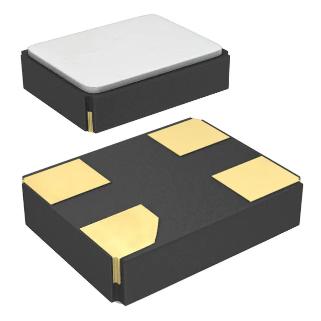

Specifications Drawing No. UKY1C-H1-16357-00[43] 1/12 Issued Date. Apr,13,2016 TO: KED USA Note:In case of specification change, KYOCERA Part Number also will be changed. Product Name Quartz Crystal Product Model CX3225SB Frequency Refer to UKY1C-H1-16357-00[43] 3/12 Nominal Frequency Customer Part Number - Customer Specification Number - KYOCERA Part Number Refer to UKY1C-H1-16357-00[43] 3/12 Nominal Frequency Remarks Pb-Free、RoHS Compliant、MSL 1 Customer Acceptance Accept Signature Approved Date Department Person in charge Seller KYOCERA Crystal Device Corporation Manufacturer (Sales Division) 6 Takeda Tobadono-cho, Fushimi-ku, Kyoto 612-8501 Japan TEL. No. 075-604-3500 FAX. No. 075-604-3501 Crystal Units Division Design Department 5850, Higashine-Koh, Higashine-Shi, Yamagata 999-3701 Japan TEL. No. 0237-43-5611 FAX. No. 0237-43-5615 Quality Assurance Approved by Checked by Issued by KYOCERA Crystal Device Corporation Crystal Units Engineering Section T. Noritake H. Shoji T. Nitoube Y. Kikuchi Crystal Units Division KYOCERA Crystal Device Corporation KBS-5079G Drawing No. UKY1C-H1-16357-00[43] 2/12 Revision History Rev.No. 1 Description of revise First Edition Date Approved by Checked by Issued by Apr,13,2016 H. Shoji T. Nitoube Y. Kikuchi KYOCERA Crystal Device Corporation KBS-5079G Drawing No. UKY1C-H1-16357-00[43] 3/12 [PART NUMBER LIST] Nominal Frequency (MHz) KYOCERA Part Number ESR (Ω) 12.000 12.288 13.560 16.000 19.200 20.000 24.000 24.576 25.000 26.000 27.000 30.000 32.000 38.400 40.000 48.000 49.152 54.000 CX3225SB12000H0FLJCC CX3225SB12288H0FLJCC CX3225SB13560H0FLJCC CX3225SB16000H0FLJCC CX3225SB19200H0FLJCC CX3225SB20000H0FLJCC CX3225SB24000H0FLJCC CX3225SB24576H0FLJCC CX3225SB25000H0FLJCC CX3225SB26000H0FLJCC CX3225SB27000H0FLJCC CX3225SB30000H0FLJCC CX3225SB32000H0FLJCC CX3225SB38400H0FLJCC CX3225SB40000H0FLJCC CX3225SB48000H0FLJCC CX3225SB49152H0FLJCC CX3225SB54000H0FLJCC 150 150 80 80 80 50 50 50 50 50 50 50 50 50 50 50 50 50 Nominal Frequency Code 12000 12288 13560 16000 19200 20000 24000 24576 25000 26000 27000 30000 32000 38400 40000 48000 49152 54000 KYOCERA Crystal Device Corporation KBS-5079G Drawing No. UKY1C-H1-16357-00[43] 4/12 1. APPLICATION This specification sheet is applied to quartz crystal “CX3225SB” 2. KYOCERA PART NUMBER Refer to UKY1C-H1-16357-00[43] 3/12 KYOCERA Part Number 3. RATINGS Items SYMB. Rating Unit Operating Temperature Topr -30 to +85 °C Storage Temperature range Tstg -40 to +85 °C Remarks 4. CHARACTERISTICS ELECTRICAL CHARACTERISTICS Items Electrical Specification SYMB. Min Typ. Max Mode of Vibration Fundamental Test Condition Unit Nominal Frequency F0 ※1 MHz Nominal Temperature Load Capacitance TNOM +25 °C CL 12.0 pF Frequency Tolerance Frequency Temperature characteristics Frequency Aging Rate Equivalent Series Resistance Drive Level df/F -10.0 +10.0 +25±3°C df/F -15.0 +15.0 -30 to +85°C Insulation Resistance Remarks PPM -1.0 ESR Pd 0.01 IR 500 1st year +1.0 ※2 Ω 100 µW MΩ +25±3°C 100V(DC) ※1 Refer to UKY1C-H1-16356-00[43] 3/12 Nominal Frequency ※2 Refer to UKY1C-H1-16356-00[43] 3/12 ESR KYOCERA Crystal Device Corporation KBS-5079G Drawing No. UKY1C-H1-16357-00[43] 5/12 5. Measurement Condition 5.1 Frequency measurement Measuring instrument : IEC PI-Network Test Fixture Load Capacitance : 12.0pF Drive Level : 10µW 5.2 Equivalent series resistance (ESR) measurement Measuring instrument : IEC PI-Network Test Fixture Load Capacitance : Series Drive Level : 10µW KYOCERA Crystal Device Corporation KBS-5079G Drawing No. UKY1C-H1-16357-00[43] 6/12 6. APPEARANCES, PHYSICAL DIMENSION OUTLINE DIMENSION (not to scale) 1 (TOP VIEW) (Connection) (Top View) 3.20±0.10 #4 #4 GND #3 2.50±0.10 ※ 3 K601Y #2 #1 #1 HOT #2 GND 4-R0.20 2 3 4 (Side View) 0.20±0.04 0.55±0.05 #3 HOT PIN NO. #1 #2 #3 #4 PIN Layout HOT GND HOT GND (Bottom View) 8-0.10±0.1 4-1.0±0.1 4-0.75±0.1 #2 #1 C 0.30 UNIT: mm #4 #3 MARKING 1 Nominal Frequency Move the number of maximum indication beams of the frequency to five digits,and omit less than kHz. 2 Identification [K] mark is surely 1Pin direction. 3 Date Code Year…LAST 1 DIGIT of YEAR AND WEEK (Ex)Jan, 01, 2016 → 601 4 Manufacturing Location Y…Japan(Yamagata) Z…Japan(Shiga Yohkaichi) T…Thailand ※3 Refer to UKY1C-H1-16357-00[43] 3/12 Nominal Frequency Code ※The font of marking is reference. KYOCERA Crystal Device Corporation KBS-5079G Drawing No. UKY1C-H1-16357-00[43] 7/12 7. RECOMMENDED LAND PATTERN (not to scale) 1.0 1.3 1.05 1.85 0.8 1.05 1.3 UNIT: mm 2.3 KYOCERA Crystal Device Corporation KBS-5079G Drawing No. UKY1C-H1-16357-00[43] 8/12 8.TAPING & REEL 8-1.Dimensions 4.0±0.1 φ1.55±0.05 Unreeling direction 1.75±0.1 2.0±0.05 (3.7) 3.5±0.1 3.5±0.05 (3.0) 2.8±0.1 1.0±0.1 4.0±0.05 0.25±0.05 8.0±0.2 φ1.05±0.1 8-2.Leader and trailer tape Components Empty compartment Empty compartment Leader END START 160mm or more 100~200mm 400~560mm 8-3.Direction(The direction shall be seen from the top cover tape side) Unreeling direction 12345 K123Y 12345 K123Y 12345 K123Y 12345 K123Y 8-4.Specification 1. Material of the carrier tape is either polystyrene or A-PET (ESD). 2. Material of the cover tape is polyester (ESD). 3. The seal tape shall not cover the sprocket holes and not protrude from the carrier tape. 4. Tensile strength of carrier tape: 10N or more. 5. The R of the corner of each cavity is 0.2RMAX. 6. The alignment between centers of the cavity and sprocket hole shall be 0.05mm or less. 7. The orientation shall be checked from the top cover tape side as shown in 8-3. 8. Peeling force of cover tape: 0.1 to 1.0N. 9. The component will fall out naturally when cover tape is removed and set upside down. . 165°~180° Cover tap Career tape KYOCERA Crystal Device Corporation KBS-5079G Drawing No. UKY1C-H1-16357-00[43] 9/12 8-5.Reel Specification t W C D E B A I m) n the case of Φ180 Reel (3,000 pcs max, every 1,000 pcs) Symbol Dimension Symbol Dimension A B C D φ180 +0/-3 φ60 +1/-0 φ13±0.2 φ21±0.8 E W t 2.0±0.5 9±1 2.0±0.5 (Unit : mm) In the case of Φ330 Reel (10,000 pcs max, every 1,000 pcs) Symbol Dimension Symbol Dimension A B C D φ330±2.0 φ100±1.0 φ13±0.2 φ21±0.8 E W t 2.0±0.5 9.5±0.5 2.2±0.1 (Unit : m KYOCERA Crystal Device Corporation KBS-5079G Drawing No. UKY1C-H1-16357-00[43] 10/12 9. Environmental requirements After following test, frequency shall not change more than ±10×10-6 And CI,±20% or 5Ω of large value. 9.1 Resistance to Shock Test condition Natural dropped from height 100cm onto hard wood board in 3 times 9.2 Resistance to Vibration 9.3 Resistance to Heat Test condition frequency : 10 - 55 - 10 Hz Amplitude : 1.5mm Cycle time : 15 minutes Direction : X,Y,Z (3direction),2 h each. Test condition The quartz crystal unit shall be stored at a temperature of +85±2°C for 500 h. Then it shall be subjected to standard atmospheric conditions for 1 h ,after whichi measurement shall be made. 9.4 Resistance to Cold Test condition The quartz crystal unit shall be stored at a temperature of -40±2°C for 500 h. Then it shall be subjected to standard atmospheric conditions for 1 h ,after whichi measurement shall be made. 9.5 Thermal Shock Test condition The quartz crystal unit shall be subjected to 500 succesive change of temperature cycles ,each as shown in table below,Then it shall be subjected to standard atmospheric conditions for 1h,after which measurements shall be made. Cycle :-40±2°C(30min.)to +25±2°C(5min.) to +85±2°C(30min.)to +25±2°C(5min.) KYOCERA Crystal Device Corporation KBS-5079G Drawing No. 9.6 .6 Resistance to Moisture 9.7 .7 Soldering condition UKY1C-H1 H1-16357-00[ 00[43] 11/12 Test condition The quartz crystal unit shall be stored at a temperature of +60± +60±2°C wich relative humidity of 90% to 95% for 240 h. Then it shall be subjected to standard atmospheric conditions for 1h,after 1h after which measurements shall be be made 1.) Material of solder 1.) Kind … lead free solder paste Melting point … +220±5°C 2. Reflow temp.profile 2.) Temp [°C] [ Preheating +150 to +180 Peak +260 +260±5 Total ― Frequency shift : ±2ppm ± 3.) Hand Soldering +350°C 3 sec MAX 4.) Reflow Times 2 times Time[sec] 150 (typ.) 10 0 (max.) 300 (max.) Reflow temp.profile 9.8 Intensity for bending in circuit board Solder this product in center of the circuit board of 40mm m ×100mm, and add the deflection of 3mm as the bottom figure. Test board : t=1.6 t 1.6mm 20 PUSH 1.6 board 10 R5 Product 45 45 R230 press jig UNIT : mm KYOCERA Crystal Device Corporation KBS-5079 5079G Drawing No. UKY1C-H1-16357-00[43] 12/12 10. Cautions for use (1)Soldering upon mounting There is a possibility to influence product characteristics when Solder paste or conductive glue comes in contact with product lid or surface. (2)When using mounting machine Please minimize the shock when using mounting machine to avoid any excess stress to the product. (3)Conformity of a circuit We strongly recommend to make sure that Negative resistance (Gain) of IC is designed to be 5 times the ESR (Equivalent Series Resistance) of crystal unit. 11. Storage conditions Please store product in below conditions, and use within 6 months. Temperature +18 to +30°C, and Humidity of 20 to 70 % in the packaging condition. 12. Manufacturing location Kyocera Crystal Device Corporation / Japan(Yamagata) Kyocera Crystal Device Corporation Shiga Yohkaichi Plant / Japan(Shiga) Kyocera Crystal Device (Thailand) Co., Ltd / Thailand(Lamphun) 13. Quality Assurance To be guaranteed by Kyocera Crystal Device Quality Assurance Division 14. Quality guarantee In case when Kyocera Crystal Device Corporation rooted failure occurred within 1year after its delivery, substitute product will be arranged based on discussion. Quality guarantee of product after 1year of its delivery is waivered. 15. Others In case of any questions or opinions regarding the Specification, please have it in written manner within 45 days after issued date. KYOCERA Crystal Device Corporation KBS-5079G
1. 物料型号:CX3225SB,有多个频率版本,如12MHz、16MHz等。 2. 器件简介:文档是针对石英晶体“CX3225SB”的规格说明书。 3. 引脚分配:有4个引脚,#1和#3为HOT(热端),#2和#4为GND(地)。 4. 参数特性: - 工作温度范围:-30°C 至 +85°C - 存储温度范围:-40°C 至 +85°C - 负载电容:12.0pF - 频率容差:+25±3°C时为±10PPM - 频率温度特性:-30至+85°C时为±15PPM - 频率老化率:+25±3°C时为±1PPM/年 - 等效串联电阻(ESR):不同频率版本有所不同 - 驱动电平:0.01至100μW - 绝缘电阻:100V(DC)时为500MΩ 5. 功能详解:文档详细描述了频率测量、ESR测量等电气特性。 6. 应用信息:适用于需要石英晶体的电子设备。 7. 封装信息:提供了物理尺寸、外形图和推荐的焊盘图案。 8. 环境要求:包括抗冲击、抗振动、耐高温、耐低温、热冲击和耐湿性测试。 9. 使用注意事项:包括焊接、使用自动贴装机、电路设计和存储条件的建议。 10. 制造地点:日本山形、滋贺八日市和泰国南邦。 11. 质量保证和质量保证期:由京瓷晶体器件质量保证部保证,1年内发生问题将提供替代产品。
